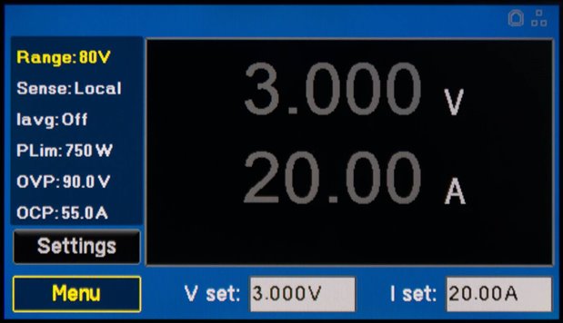

The home screen looks as above with the metered readings being large and dominating most of the display area. When displayed in grey, they read the set-point while the output is off. These turn yellow when the output is on, displaying the measured value with a small indicator showing the mode of operation (e.g. CV, CC, CP), any protection trips (e.g. OVP, OCP) and a warning symbol in case the 80V range is selected. Below that, the operating power is also displayed. When the output is turned off, the displayed figures will be in red, showing the metering as the output discharges (or if voltage is present on the output while the output is off). Entry fields for the voltage and current set-points are below the screen and can be edited by selecting them and entering values on the touch screen or by using the rotary encoder or keypad. This screen also allows you to invoke the main menu and the settings menu.

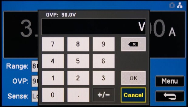

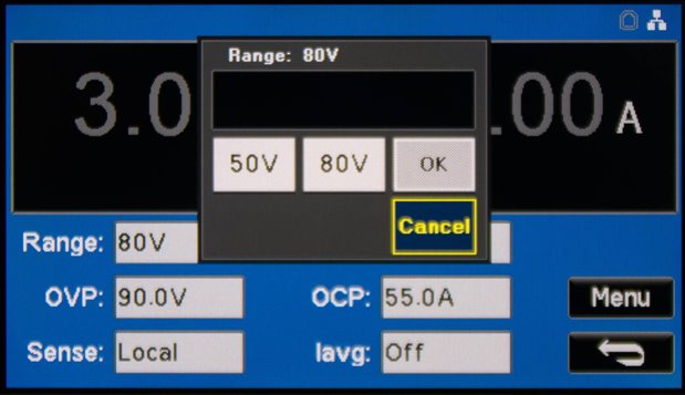

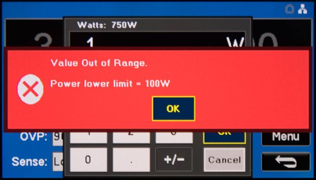

Changing values such as the OVP can be done by the on-screen keypad which looks as below. This is relatively easy to use, although to exit it, you must tap on Cancel as tapping outside the window does not close it. In case critical errors occur, a red pop-up box is shown which indicates the problem. This visual theming is consistent with all errors including OVP/OCP trips, hardware errors, etc.
The supply has two voltage ranges, a 50V range which is noted as SELV for safety, and an 80V range which provides the full capability of the power supply. In 80V mode, however, the voltage setting granularity is 2mV and metering accuracy is slightly worse. A warning is displayed when changing to the 80V range via the front panel.

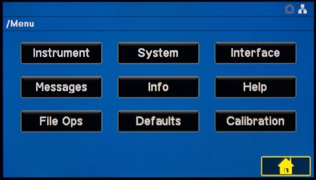

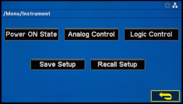

The main menu consists of a grid of nine buttons. Many of these buttons lead to sub-menus which allow for further configuration. As the number of options is relatively small, it doesn’t take long to work out which menus to invoke to get things done even if you have not used the instrument before. It is good to see that there is the capability to configure power-on state for use in unattended applications and the ability to save and recall set-ups.
These set-ups are saved to internal storage and can be managed through the File Ops area.

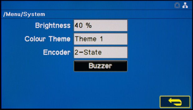

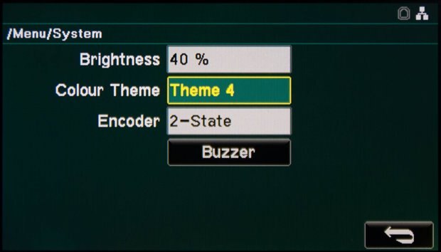

Configurability extends to selection of colour themes, which is a nice touch as some people may prefer slightly different colours, although it is not fully customisable as only pre-set themes can be selected. Rotary encoder operation can also be toggled between two-state and three-state which controls how many pushes are necessary to perform value manipulations (i.e. whether you have an additional step to select the place value to modify). There is no selection for knob reversal (as some users may have preferences in this regard).

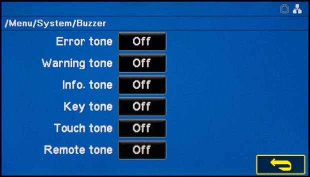

For those who like quiet instruments, the buzzer can be switched off for all categories of notifications. The granularity of selection is definitely appreciated as some users may want certain beeps to still occur while silencing others.

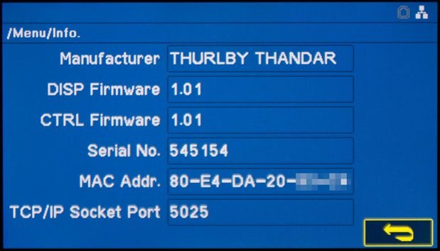

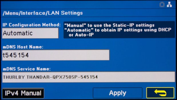

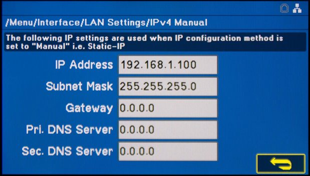

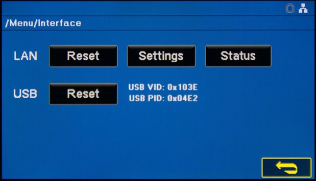

The Interface configuration menu allows for resetting the interfaces, setting the settings for the LAN interface and checking the status. It is noted that the USB connection does not have any configuration applicable. The Info screen allows for viewing the instrument information.
The LAN configuration includes the choice of DHCP or Static IP assignment and editing of the mDNS host and service names.

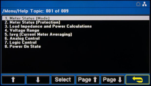

An onboard text help feature is provided, although I don’t see many people using it in reality.

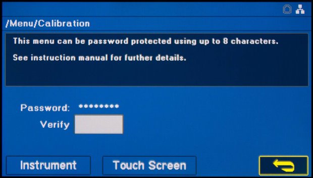

Finally, the Messages section allows you to recall error messages and read the state of the SCPI error queue which is useful in debugging remote-control programs, while the Calibration screen is password protected but allows for accessing calibration of the instrument and touch screen digitiser.

The user interface has a good variety of entry options including selection buttons and virtual keypads which were well sized for ease of use. Perhaps the only niggle, and a minor one at that, is that you are not allowed to exit from these entry boxes just by tapping outside of them as you might expect from a modern mobile interface. You must select the cancel button instead which did catch me out a few times, but it is an easy adjustment to make. I was thankful to see that the instrument had a lot of customisability with regards to its beeper – I prefer silent instruments, so I set all of mine to off. The theme option to change between pre-selected colour combinations is also good as some people may have a preference for different colours.

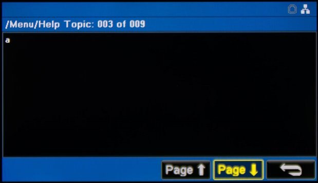

While testing the user interface and the onboard help feature which allows for accessing some limited text documentation through the touch screen, it was discovered that certain help chapters were not working as expected. They would display just one letter, then an error message of “Help not installed !!”.
My gut feeling was that this would be a Unicode UTF-16 issue where every second byte is 0x00 and in many languages, this is considered a string-terminator. I reported this issue to Aim-TTi who have indicated that it will be fixed for the next firmware revision.

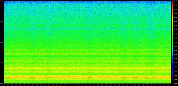

With regards to the acoustics, I would have to say that the QPX750SP performs rather averagely. While the unit does have a thermostatically controlled fan, as promised, the behaviour and tone of the fan does leave a little to be desired.
Upon plugging in the unit in standby, the fan does come on for a short period, probably for a self-test and goes off. When the unit is started up, even idling at the main screen with the outputs turned off, the fan is running audibly at a moderate pace. I would describe the sound as a relatively constant, low, resonant, blowing noise. I suspect it is generated by the turbulence between the rear fan grille and the cut-out in the rear plate of the unit, as if I cup my hand around the edge of the grille, the noise becomes much softer. Switching off the unit results in the fan running up to a higher speed for a few seconds, presumably to cool-off the internals before it shuts off. This is a technique perhaps more commonly seen in microwave ovens.
On loading, the fan speeds up as the unit heats up resulting in a louder, whinier characteristic emerging. While not as loud as my noisiest power supplies under full load, the noise is appreciable and the thermostatic control leads to a noticeable “hee-haw” oscillation of fan note, occurring in unpredictable intervals. This can be somewhat distracting if working in close proximity. However, thermally speaking, it seems the fan and extensive intake grille arrangement is very much sufficient in keeping the unit within operating temperature requirements.
Like other switching power supplies, some unavoidable acoustic emission also occurs from the supply, most notably on switching on loads which results in a high frequency “chirp”, or on cyclical hard-keyed loads which result in a noticeable “ticking” from the unit in-synchronisation with load changes. Under some light loads, sometimes a soft audible “hissing” is heard from the unit, but is relatively in keeping with the behaviour of other purely switch-mode power supplies I have used and owned.
