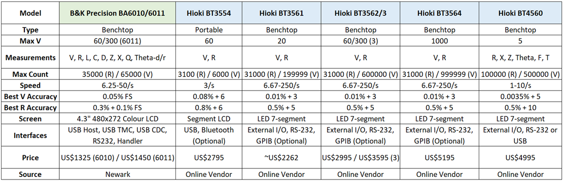

Stepping up the competition to the Hioki products, whose lineup consists mostly of bench-top units, the BA6010 remains the most inexpensive of the bunch. It offers the most measurement modes and still offers the superior user interface and remote interfaces. The Hioki equipment, however, achieves better voltage accuracy and resolution across the board. Considering the price differential, the BA6010 is still the value-for-money winner.

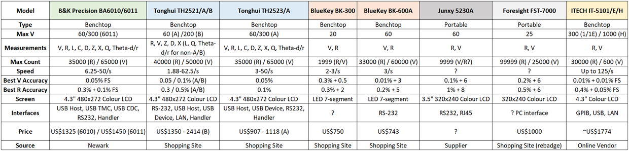

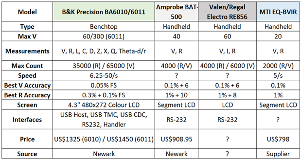

Comparing the BA6010 to lesser known systems from some other companies, it’s seen that some of these lower-cost handheld units are not anywhere near the BA6010 for specifications even though the BA6010 is only slightly more expensive. If you don’t need the portability, the BA6010 might be the better choice.
Finally, it’s probably worthwhile comparing the BA6010 to the numerous options from China. Prices for these may be somewhat unrealistically low, owing to taking the lowest cost from an online shopping site where you might be occasionally bitten by a scam or two. The bigger problem seems to be that the specs for some of these products change depending on who you buy it from even though it’s the same item, so take the specs with a grain of salt. However, because of the niche nature of the product, it seems that this is where the most variety of options to compare with.
Compared to the other Tonghui products, we can see the BA6010 is basically the TH2523, the latest of their offerings and the price that Newark is selling it for is actually not much more than the price offered from the “shady” shopping site. That’s a good sign, especially as that means you’re not paying much for the additional warranty, support and peace of mind. Compared with some of their less “reputable” cousins, it seems that the unit is quite competitive on specs. It’s occasionally beaten on voltage accuracy, but holds its own when it comes to resistance accuracy.

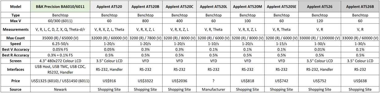

In being exhaustive, I’ve also compared the BA6010 to the Applent benchtop cousins. The results are very similar to that above in regards to the specifications, making the BA6010 a solid choice all-round especially considering that the majority of the Applent products use a VFD display and have more limited connectivity and lower accuracy.
