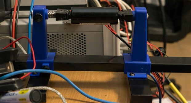

So I started with a scrap of vero-like strip-board (fibreglass type, very annoying to split). Using a track cutter tool, I isolated two tracks to allow me to mount four Pogo pins for four separate contacts at each terminal. They were very finnicky to solder with a fine iron and a set of tweezers, and some of them were ruined due to solder-splash. Luckily a bag of 100 of these cost next to nothing.
From there I chose the top pair to be used for the BA6010 for Drive and Sense with the bottom pair used for the  BK8600BK8600 for Load and Sense This way all instruments have a sense contact to the battery terminal that is completely load free to avoid any resistance-reading contributions from variations in current flow as much as possible. After some copious amounts of heatshrinking, I was able to produce some "terminals". I tried to mount them onto the jaws initially with some superglue but as the jaws on the Duratool stand are aluminium, that failed miserably. The stiffness of the wire also places strain on the terminal PCBs as the RG59 is solid-core, which is non ideal. After some tinkering, I managed to break the circlips that held the jaws onto the stand - so instead, copious amounts of electrical tape came to the rescue.
I shorted the terminals for shorting compensation and mounted some batteries for testing. I tested a Fenix protected 26650 Li-Ion battery from a flashlight and a Varta Longlife AA Alkaline cell. Due to some play in the plastic holders, I provided some additional contact force with an elastic band - not very scientific but it would do for now.
The test results were very impressive as the resistance is now measured much more accurately portraying even the very low resistance of a 26650 lithium ion cell Furthermore the voltage readings between the BA6010 and  BK8600BK8600 at this"low voltage range practically coincide(as the low range on my BA6010 tested well due to the use of sense lines on both instruments The measurement shows the internal resistance to be about 22.45mohms if we look at a datasheet for a random 26650 cell, we know to expect 23+/-1mohm. The result is hence spot-on.
Testing of the Varta Longlife Alkaline AAs showed some similar behaviour to tests before, but with a much more reasonable (lower) internal resistance.
Armed with this, I now needed to charge the Fenix 26650, so I rigged up a second PCB stand, this time using the Molex contacts with all contacts shorted together (as the pitch is not the same as the vero board, which is somewhat annoying and not all battery contacts will have the same area). Using copious amounts of epoxy resin, this time I did succeed in securing the connectors to the jaws after a day of letting the resin cure - so this one worked well. The best part is that one of the jaws is spring-loaded, allowing for quicker battery removal and replacement. I might revise my testing battery holder in the future using a similar technique.
I still haven't heard any further contact from B&K Precision, however.
