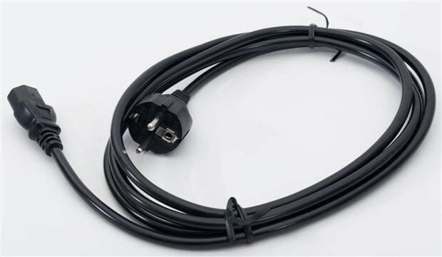

The supplied cable for the 220V version seems to be an EU plug cable. The cable itself feels to be of high quality – it’s a 3 x 1.0mm2 cable which is much better than the 0.75mm2 that we often get. As I’m in Australia, it was easier just to replace this with a local IEC lead, although the 220V did make me somewhat nervous as we are a 240V country (although, officially harmonized to 230V).

    Looks like they have moved to a soft mains key away from the old style mechanical latching switches on their AC source and electronic loads.
    The 230V harmonised standard has a +10% and -6% tolerance, that changed from the old 240V +/- 6%, to allow the countries to effectively keep their voltages at the same levels and remain compliant.
    Kind regards
  • Gough Lui
    Gough Lui over 8 years ago in reply to three-phase
    Sorry for forgetting to respond to this comment -
    Indeed, I'm aware that the 230V harmonization is more of change in name rather than in operation, but it does get a little unnerving especially in the case of:
    • A 220V appliance that claims it wants 220V +/- 10% (i.e. the BA6010)
    • A "230V" country that is supposed to be 230V +10%/-6%, but still actually runs with 240V +/- 10% in practice (i.e. myself in NSW, Australia where according to this reference, mains can range from 216-264V).
    • Knowing that my own mains through my own sampling with the PA1000 varies, but averages 245V with a range of 236.90 to 253.96V as measured over a week.
    While my own use has not seen the BA6010 seemingly suffer despite remaining powered for several days running, the accuracy of instruments sometimes cannot be guaranteed depending on whether the input voltage meets its requirements - in my case, it's clearly a bit higher than the 220V marked. As a result, I think the preference would be for the BA6010 to be made and marked for a harmonized 230V system to alleviate any doubt as to its applicability in certain countries (e.g. UK, AU).
