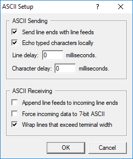

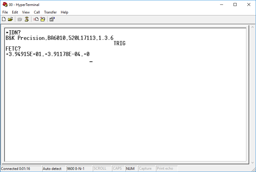

Interfaces: USB-CDC
The USB interface supports two modes of operation – CDC (or Communications Device Class) is used to emulate a USB serial port in a “driverless” fashion under modern operating systems. Operating this is much the same as if you had a serial cable attached between a COM port and the instrument, instead, it operates over USB.
The device installed automatically under Windows 10 with no problems. Trialling this using Hyperterminal, we have to set the correct line-ending characters to ensure commands are recognised.
After that, it’s as easy as sending SCPI commands down the virtual COM port which seems to work as expected.

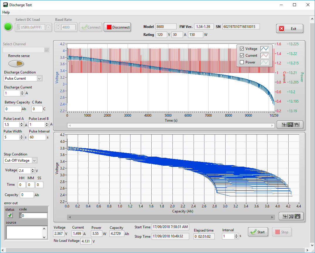

Experiment: AC Internal Resistance vs DC Internal Resistance
A point of confusion raised by some novices to battery testing is the difference in AC internal resistance versus the results obtained through pulsed-discharge (or DC internal resistance) test methods.
To examine this, I performed a pulsed discharge test using my B&K Precision Model 8600 DC Electronic Load on a Panasonic NCR18650B Li-Ion cell with spot-welded tabs. The discharge load was kept at 1A, cycling to 1.5A for five seconds in every one-minute period. The DC internal resistance was determined as the delta of the voltage between the two load levels, divided by the difference in current load (0.5A). The AC 1kHz internal resistance and voltage were recorded from the BA6010.
As can be seen in the graph, there is quite a difference between the internal resistance readings from the DC method versus the AC method. The trend of the DC method does show some slight discontinuities, likely because of my calculation method which has some time-alignment dependencies and does not account for the natural downward trend of voltage due to the effect of discharge. In general, the AC method produces lower internal resistance readings than the DC method – this is reflected in the datasheets for certain batteries where the internal resistance for both methods are mentioned.
As a result, it’s important to ensure that you choose the right method of testing to obtain comparable data values. However, it’s important to emphasise that the values obtained by both test protocols are valid – just under different conditions. The big advantage is the AC method does not require discharging the battery and can be performed rapidly.

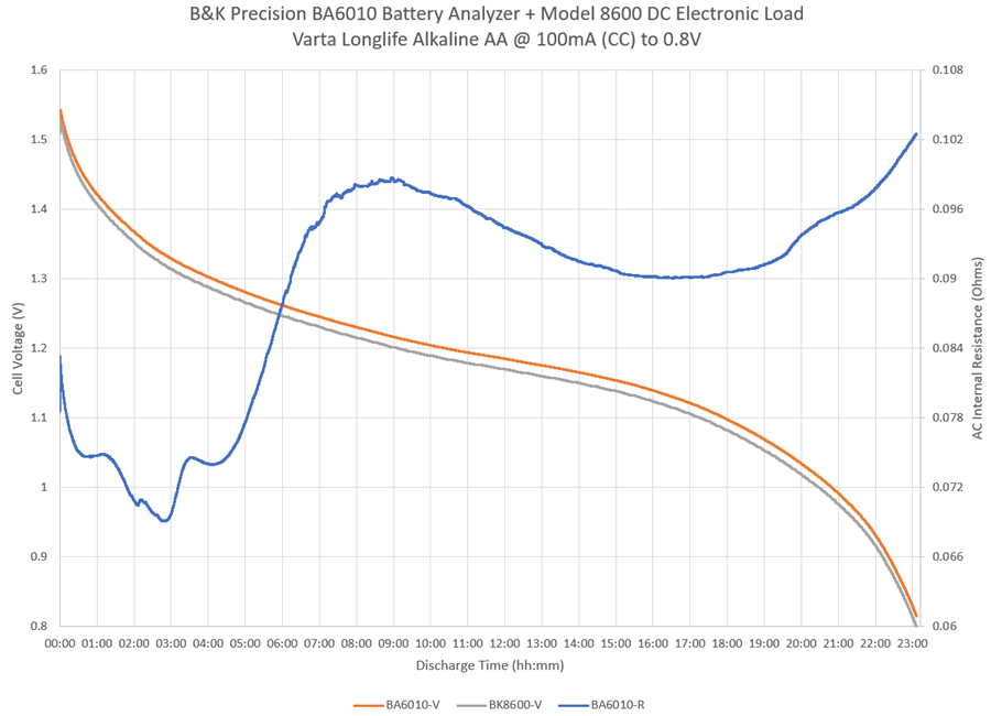

Alkaline
The first thing to test is the ubiquitous Alkaline battery, something that I am very familiar with. I got out one of my Varta Longlife AA Alkaline cells for a 100mA CC test (for speed).
The internal resistance of the cell showed some unusual variation throughout the discharge cycle, initially rising quite sharply. This may have been due to electrolyte diffusion-related resistance, but I’m not sure. The resistance then began to decrease, which might be a side-effect of cell heating due to the discharge process. Eventually, as the cell voltage began to plateau, the resistance began to increase and maintain throughout the rest of the discharge process signifying a sort of “equilibrium”.
I repeated the test with an element14 Proelec AAA Alkaline cell at 25mA CC.
The trend does show an initial sharp drop followed by a rise, although instead of plateauing, the resistance seems to increase nearly consistently over the discharge with minor variations possible due to changes in room temperature.

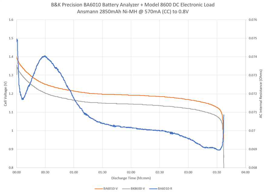

Ni-MH
This naturally led me to examine what the AC internal resistance behaviour of Ni-MH rechargeable cells would be like, as they are often used interchangeably with Alkaline cells. I tested my Ansmann 2850mAh cells under a C/5 load of 570mA CC.
The internal resistance again showed a sharp initial drop, followed by a rise and a nearly-continual decrease towards cell depletion. However, the internal resistance variance is extremely small – only six milli-ohms throughout the full capacity.

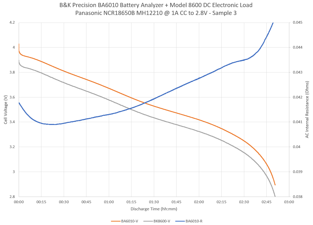

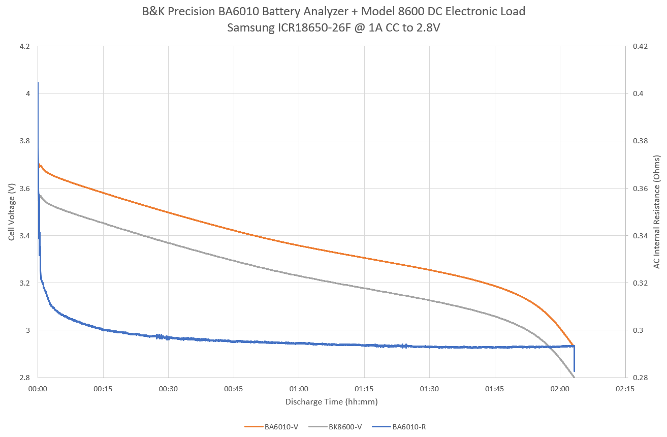

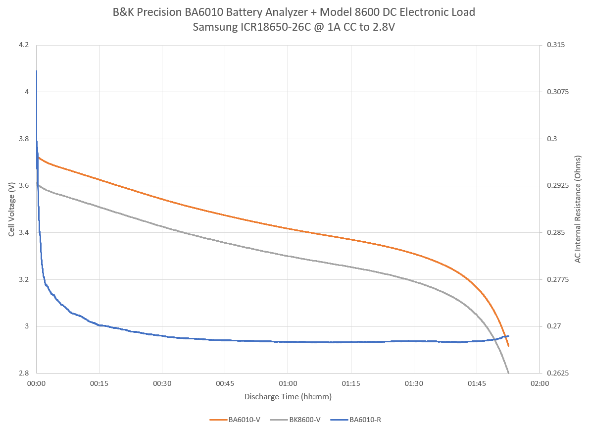

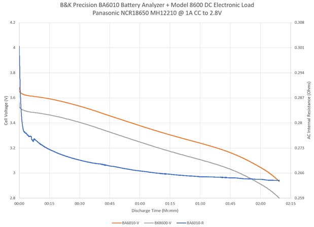

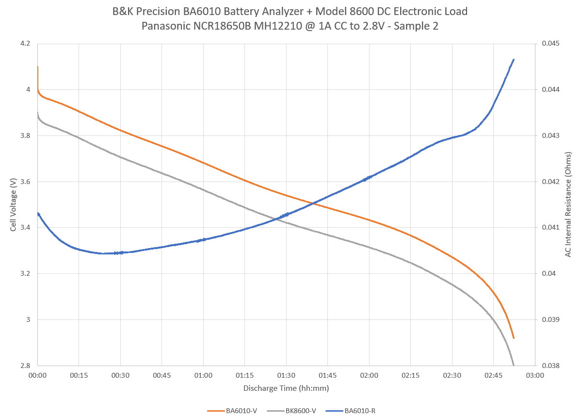

The next chemistry I had to hand was Li-Ion. My initial test of Li-Ion batteries focused on three Panasonic NCR18650B 3450mAh cells with solder tabs. These provided a good low-resistance point of connection to the cells. Testing was performed at 1A CC discharge rate.
In order of testing, each sample had slightly higher internal resistance than the previous, although the trends appear to be extremely similar – showing an initial fall, followed by a slow rise, only increasing as the cell becomes completely depleted.

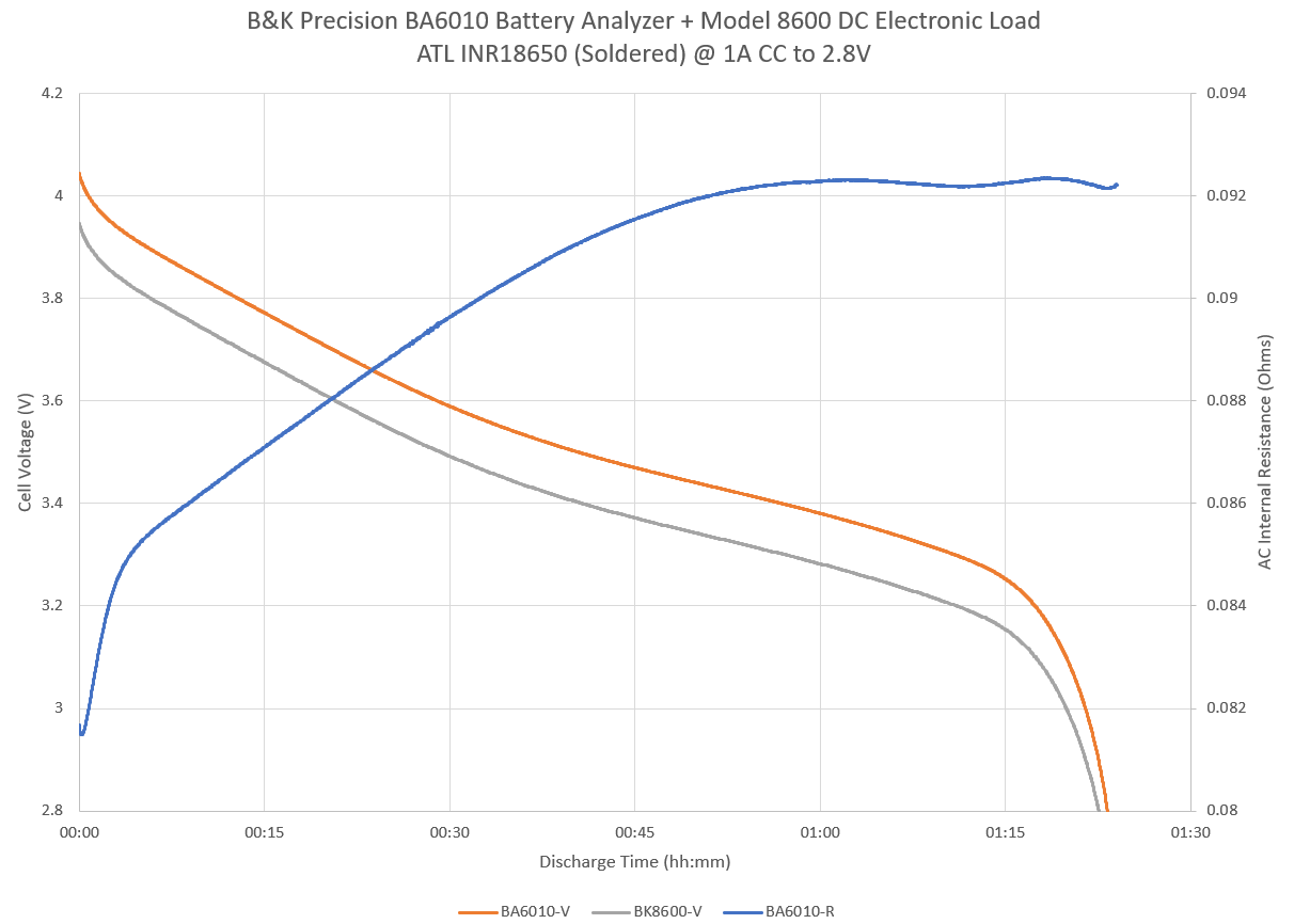

However, it seems that testing a number of other 18650 cells posed a problem since they were salvaged from laptop batteries in the past and I only had some cheap battery holders to use with them. The battery holders had such poor highly-resistive contacts to the batteries that it proved to be hard to get any good results. In fact, some of the change in resistance probably reflects the settling of the battery inside the holder rather than innate changes in AC resistance of the cell itself.
The easiest way to see the influence of the battery holder is to compare these two results of the same ATL Li-Ion cell – the first one is with it inside a battery holder, the second with soldered (not-recommended) leads to the terminals.
It seems that for most Li-Ion cells, the internal resistance decreases for a little at the beginning of discharge, increasing throughout the discharge but not varying by a large amount. This means that AC internal resistance testing can be used for Li-Ion cells over most of their state-of-charge range without too much influence on readings.
As a result, for accurate results, it is imperative that users build their own test jigs to ensure consistent contact area, contact geometry and contact pressure to cells/terminals to ensure repeatable comparable results. Low-cost commercially available battery holders are, for the most part, only suitable for low current appliance use, rather than for metrology purposes.

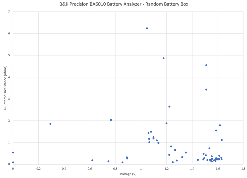

Experiment: Testing New vs Random Old Batteries
Another experiment I ran was a simple screening experiment, testing new AA batteries fresh from the packet and testing AA batteries in a “random batteries” container whose status was unknown. Using the R-V mode and the manual data sampling mode, the cells were placed inside a low-cost battery holder which undoubtedly contributed slightly to the internal resistance reading.
With the fresh batteries, the open circuit voltage was consistently good with the internal resistance mostly clustered below 200mΩ which does correspond quite closely with the expected values of anywhere from 150mΩ to 300mΩ.
With the set of random batteries, we can see how much the internal resistance can increase with different chemistries (zinc chloride vs alkaline) making them unsuitable for use with higher drain devices, as well as a spread in open circuit voltage (representing various levels of battery depletion). There are even some rechargeable cells that had become completely flat measuring practically zero volts, but with an acceptably low internal resistance that suggests the cells may be healthy. In one case not shown here, a shorted cell was also identified.
As a result, the BA6010 shows its advantages in that it can be used to quickly screen batteries to pick out faulty or underperforming batteries within a pack or collection of cells. The use of the 1kHz AC impedance test is an established screening procedure within battery manufacturing plants with datasheets often providing information about the expected value for good cells. This method is rapid, taking less than half-a-second per battery and causes no damage to even primary cells.

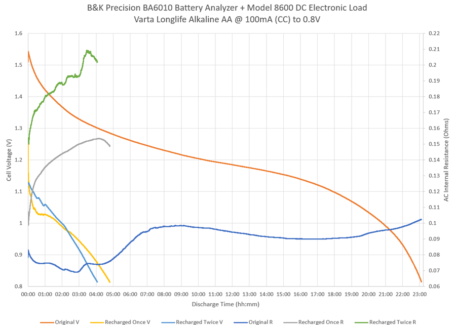

Experiment: Testing Recharged Alkaline Batteries
Warning: You should not try this at home – if you choose to attempt recharging primary cells, you do so at your own risk. No responsibility will be accepted for any loss or damages howsoever incurred.
Seeing as I already had some depleted Alkaline batteries from my earlier experiment and I spent quite a bit of time looking at whether recharging Alkaline batteries even worked, I decided to see what the AC internal resistance behaviour of such batteries would be like. In theory, the internal resistance would be expected to rise significantly as the cells started to fail, as the voltage dips quite strongly under load.
It is noticeable that the internal resistance of the cell increased by around 50% each time it was recharged. Despite this, the AC internal resistance change was not quite as large as I had expected, which may be related to how the battery responds to high frequency loads rather than low-frequency loads where DC internal resistance is expected to show even greater change. However, the actual cell performance under the 100mA CC test load was quite poor after recharging, which suggests that the Varta Longlife Alkaline AA cells are not highly amenable to recharging.
