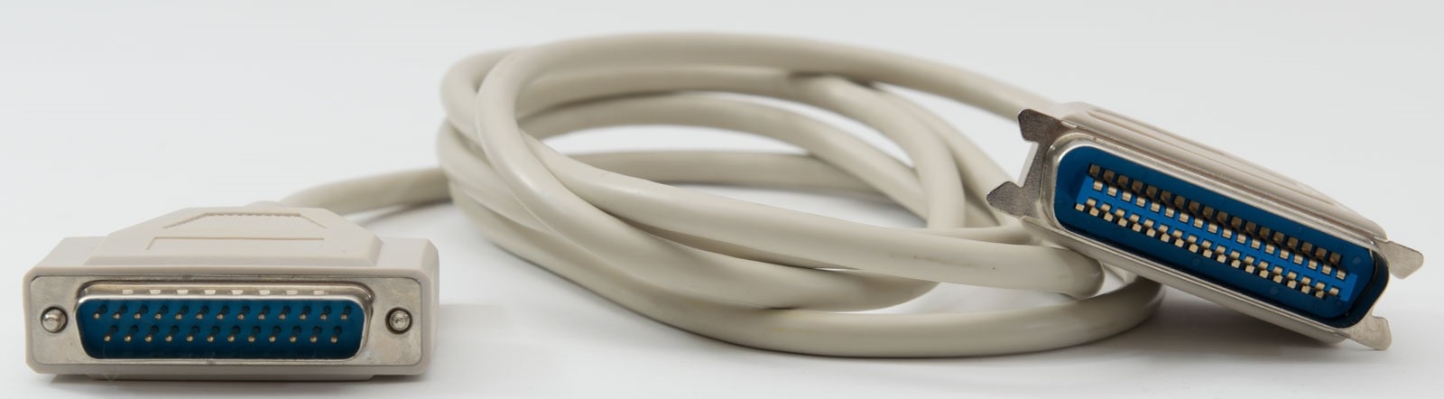

One of my bigger frustrations with the BA6010’s design is the choice of the Centronics 36-pin connector for the handler interface. While this could be a standard interface for cell handler equipment (I really don’t know if it is), this connector has become very much obsolete and difficult to obtain even from most of the big-name component distributors.
The last thing to use the Centronics 36-pin in any great capacity was the humble IBM-compatible parallel port printer. As a result, I hopped down to my local thrift shop to grab one … for its connector.
It was not an easy job to open up the moulded plug assembly without damaging the connector. Once it was freed, the next step was to desolder all of the wire remnants as the pin-out of the parallel port is significantly different from that of the handler interface.

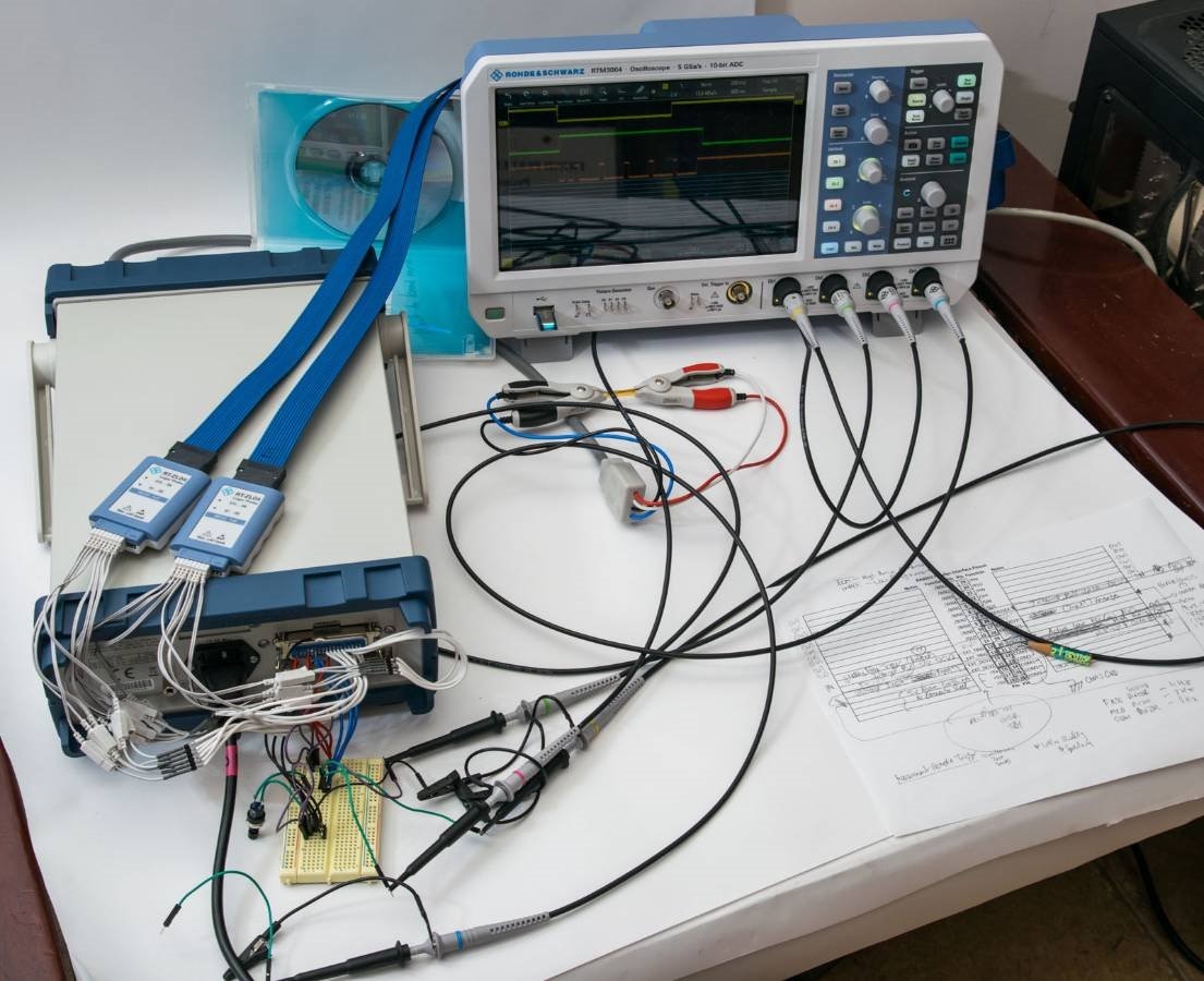

From there, in order to check all of the necessary signals, I had to break out the important signals into header pins to plug into a breadboard. Red leads were believed to be positive power, black leads for negative power (using thicker wire for both). White leads were used for bin outputs with blue leads used for inputs/status signals. Note that this was soon altered as I understood that the connector frame ground is important and I had also misplaced one blue wire (one position to the right of shot) and corrected this. This was a relatively time-consuming process - but I was willing to do it. I guess that's why I'm chosen to do RoadTests image.
Handler Interface Signals
I spent some time observing the handler interface under a number of different conditions using my Rohde Schwarz RTM3004 and my Keysight  U1241BU1241B multimeter I determined that EXTDCV1/2 are sources for the high-level output for the logic output pins whereas COM1/2 are the corresponding sources for the low-level output Due to not being too worried about accuracy and out of convenience I had tested the interface with EXTDCV1/2 jumpered to the 5V line and jumpered COM1/2 to the frame ground thus turning everything into a 5V logic level interface

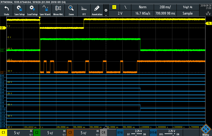

In the above graphic, C1 represents EXT_TRIG, C2 represents /EOM, C3 represents /INDEX and C4 represents one of the bin output lines that change. On the whole, this is what is expected.

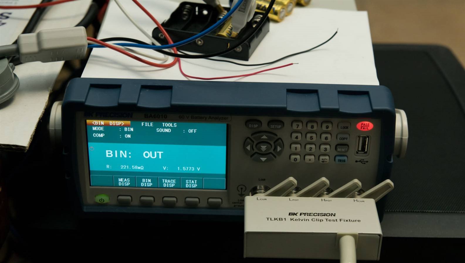

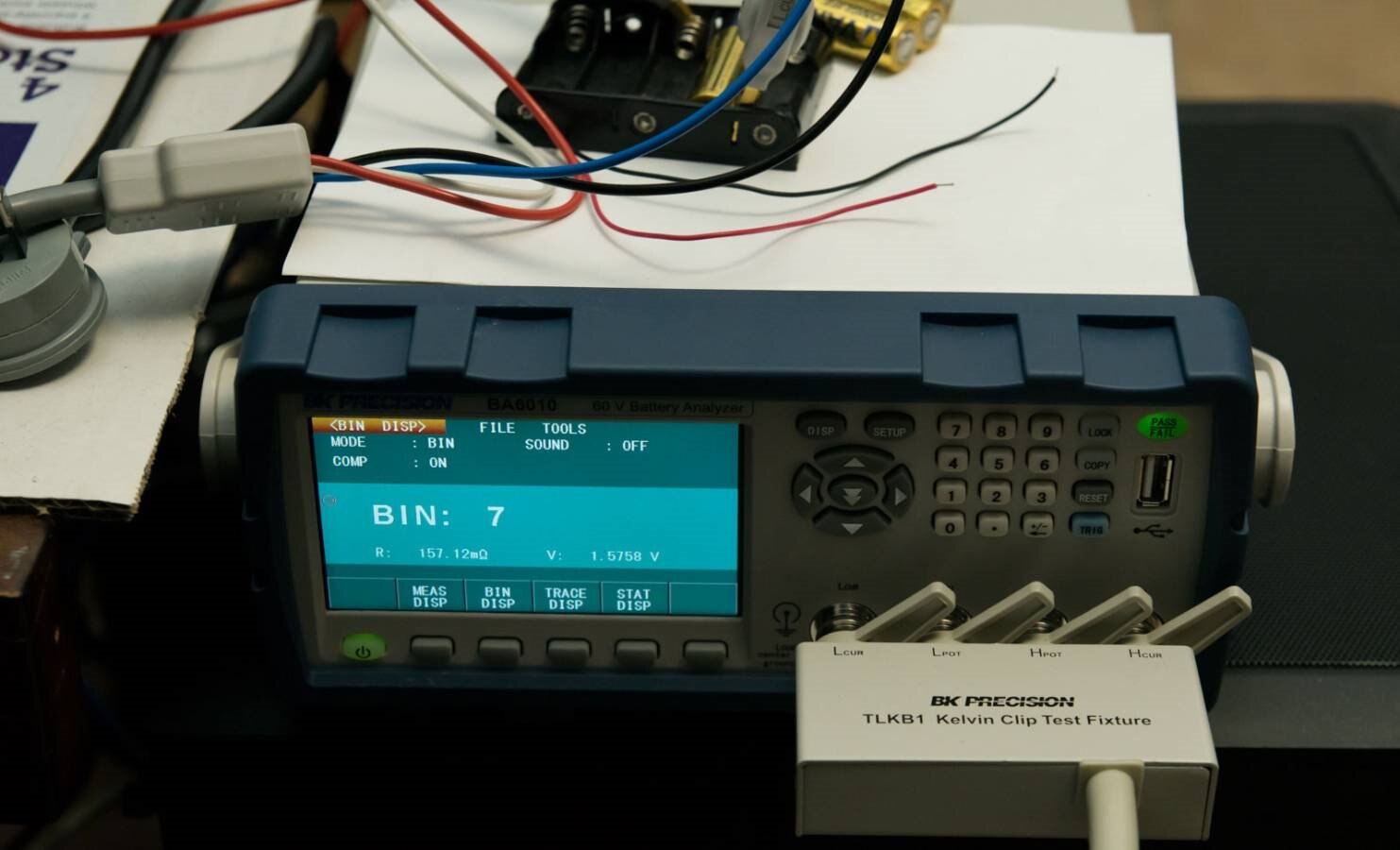

A selection of Varta Longlife AA Alkaline cells were put through the bin data as set above, using COMP_A only. This allowed the cells to be sorted into bins based on the measured internal resistance.
Further to this, the BA6010 also illuminates its bi-colour Pass/Fail LED indicator to reflect whether the result is within any one of the nine configurable bins (Pass, Green) or whether it is out of all bins (Fail, Red).
The internal beeper can be configured to sound if the item passes or if the item fails.

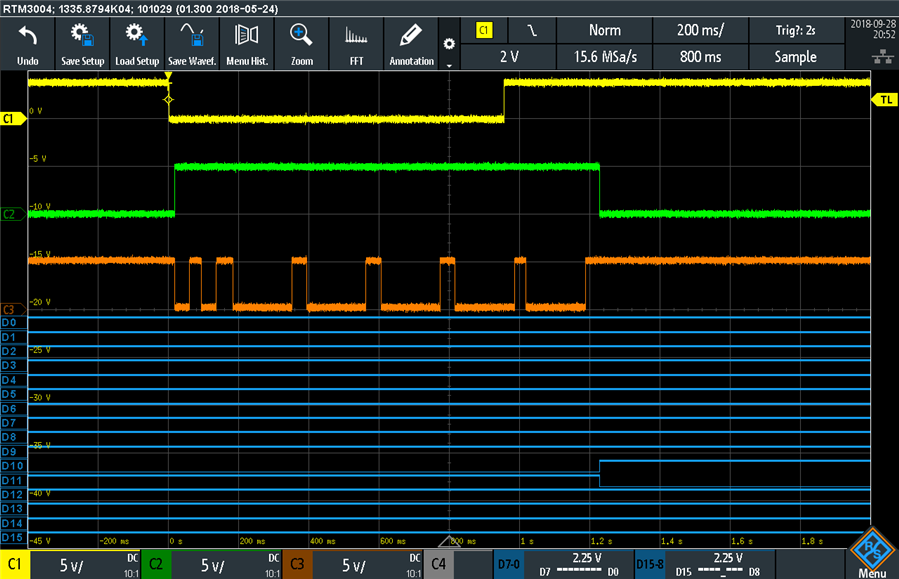

With the use of the digital channel inputs on the Rohde & Schwarz RTM3004, it is possible to understand how the handler interface bin outputs operate on my Alkaline binning example comparing just “A” readings. I have connected D0-D9 to /BIN1-/OUT signals, with D10-D16 covering /PHI–/SLO. In the above example, we can see that a trigger is input (C1 – EXT_TRIG), which causes the unit to perform a measurement (C2 – /EOM). During the measurement, the A/D converter is used a number of times (C3 – /INDEX) due to a number of range changes and the measurement of both voltage and current. Finally, once the measurement is completed, EOM goes low and the bin outputs are updated to reflect that the primary measurement value is low (D11 – /PLO).
In this second example, the binning process is successful, sorting the cell into Bin 5 (D4 - /BIN5 goes low). The /OUT (D9) line also goes low to indicate the cell is within one of the nine bins, whereas the /PHI (D10) signal goes high to indicate that the measurement is not out of range high anymore. I suspect the /PIN line did not change because this may only be used in the percentage comparison rather than absolute binning mode.
