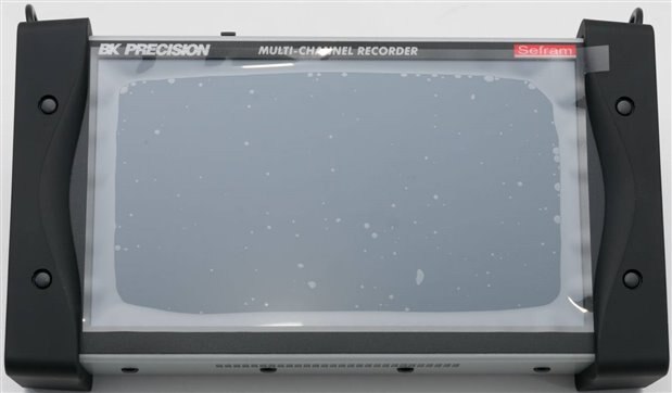

Main Unit
With the main unit removed from the bag, the screen is protected by plastic film.
Removing the film reveals the clean aesthetic of a 10” 1024x600 capacitive touch LCD screen that forms the front of the unit. This is surrounded by a black frame with the branding and rubber end-pieces that protect the unit from shock while in transit and when set down onto a work surface.
Connections are made along the top edge of the unit. From left to right is the power connection, charging LED, power button (and LED), two USB-A ports, Ethernet port, digital I/O port, earthing connector and analog channel module I/O port. It was nice to see that the ports arrived with protection covers, although the Ethernet one seems to have been crushed in transit.
The rear of the unit has a grey and white label which has the details on the ports. It also features a one-position fold-out kickstand which allows the unit to be propped up to a comfortable angle for use on a flat surface, with rubber feet acting as an end-stop when flipping the kick-stand back onto the unit. On the whole, the unit feels solid with an aluminium chassis that has no flex, although the seams of the chassis seem to have a slight gap with irregular and slightly sharp edges which do not provide the best quality feel.
The sides of the unit have holes for ventilation, with the product details on the left side of the unit. The eyelets for the shoulder strap are plastic, which is a surprise.
The bottom edge of the unit also has holes for ventilation.
The unit itself, without any attachments, weighs 1914g which is significantly more than the datasheet listed 1.5kg. I have contacted B&K Precision to find out why this is the case.

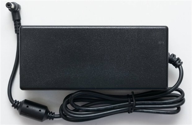

Power Supply
The power supply is a matte black rectangular unit with a single power indicator LED. The power cable has ferrite bead EMI suppression and terminates in a barrel plug connection. The unit is manufactured by Cincon Electronics Co. Ltd., model TRG70A150 with universal input and 15V 4.6A rated output. It appears to be dated Week 44 of 2018 with an efficiency rating of Level V.
This power supply uses a three pin IEC connection and unlike many switching power supplies, the negative outer-shell of the barrel plug shows continuity to the earth pin on the power supply. This ensures the unit is properly grounded when powered by the mains.
