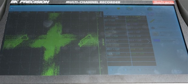

The 10” colour LCD with capacitive touch is large compared to its competitors and bright, although its glossy nature tends to show up fingerprints and glare more readily. The design of the user interface has paid attention to the potential difficulties in operating a touch-screen instrument, opting for large touch targets throughout to make it easier to use. A capacitive-compatible stylus is also included. Users are also provided with a “click” from the onboard beeper as user feedback of a registered touch event.
The main downside to the screen is the limited viewing angle due to the TN technology in use, which results in contrast reduction and colour shifts when viewed at an angle. This occurs especially when the one position kickstand on the rear is used.

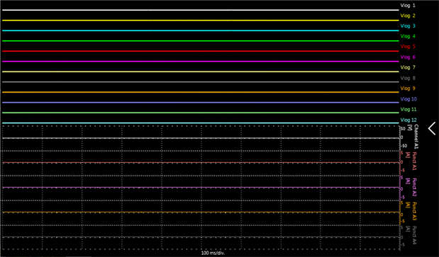

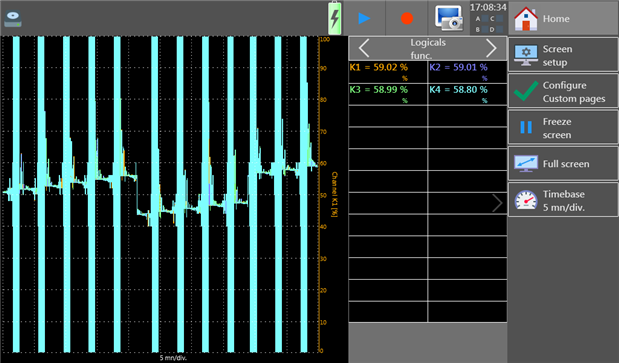

Ordinarily the unit will boot into the F(t) graphing mode, which emulates the display of a chart recorder scrolling new readings on the graph from right to left. The interface features a toolbar at the top with recording indicator, power, playback, record, screenshot, time and alarm channel indicators. Towards the right side of the screen are buttons including home and configuration for the display including screen setup, configure custom pages, freeze screen, full screen and timebase.
In this example, this screen actually shows a glitch where the values should be increasing step-wise but instead seems to arbitrarily “drop”. This seems to occur when changing screens and returning to F(t) mode and has been reported to B&K Precision.
Screen configuration includes the ability to change modes of display, hide numerical display and borders, put digital channels on a separate axis, use a custom grid and change colours. Configuring custom pages allows viewing only a subset of enabled channels where there are two custom pages. There is also the possibility of having multiple screens, but there does not seem to be a way to directly allocate certain channels to a given screen. Limitations in X-Y mode were also noted where dissimilar channel types could not be plotted X-Y (e.g. A channel versus K channel).

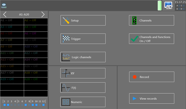

The home screen where all the functionality and configurability of the device can be accessed. This includes a summary of channel status on the left, with buttons for setup, trigger, logic channels, channels, channels and functions on/off, XY, F(t), numeric, record and view records. The labelling, especially surrounding channels, is already somewhat confusing as I find myself frequently pushing the wrong button for configuration tasks (i.e. channels instead of channels and functions on/off).

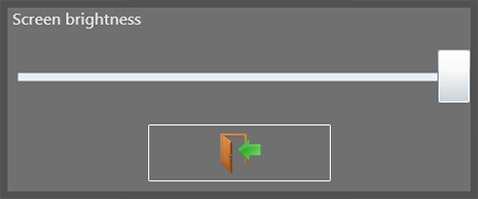

The screen shut off feature is particularly important as it dims the screen after a set amount of time to preserve battery and backlight lifetime. This is not a “shut off” as such. VNC allows for configuration of the VNC password which was initially a corrupted jumble on my unit. Additional option brings up another menu with more options. The software update feature allows for loading of new firmware from an attached storage device.

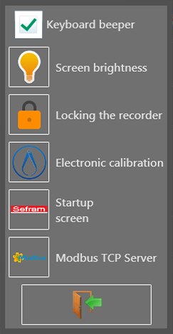

Nested in the additional settings are some arguably very useful features. One is to disable the “keyboard beeper”, which is in essence, a little speaker which provides touch feedback clicks and melodic tones on starting/stopping recording. Unfortunately, while this option does silence the beeper, it is automatically re-enabled if you run the electronic calibration or reboot the unit. Screen brightness can be adjusted using a slider. The slider is, however, very non-linear with the first half being very dark and ramping up rapidly to full brightness on the last few notches of the sider. Recorder locking allows for the touch-screen to be disabled and is locked several seconds after selecting the feature. It seems an unusual place to bury a useful feature – I would have preferred it to be on the toolbar. It was discovered that even if the recorder is locked, it is possible to do a shutdown, which seems unexpected.
Electronic calibration (or self-calibration) is used to tune out any offsets automatically and needs to be run prior to use after the unit has fully warmed up to ensure the unit meets datasheet accuracy. This menu allows initiating a new calibration or recovering the original factory calibration. This process takes many minutes, with the progress bar not indicative of actual calibration progress. Once completed, a message states “Adjustement completed”, noting the typo. The startup screen option just displays the splash screen.
The Modbus TCP Server options allows enabling or disabling Modbus TCP and configuring the port number. Modbus operation seemed to result in an occasional mouse pointer appearing and staying on the screen randomly, but otherwise worked as expected and is fully detailed in the next chapter.

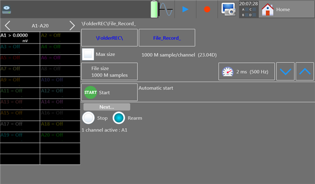

The trigger option from the home screen allows for the configuration of recording settings and recording triggers. Within the configuration settings include the ability to set a folder in which recordings are made and the file-name prefix for each file. Each file can be limited to a certain number of samples, with numerical input being made using an on-screen keyboard. Note that the number 2 on the keyboard is slightly out of alignment, which irks me slightly. The recording sample rate can be selected from a menu of options, with inappropriate values greyed out. The trigger options allow for setting of conditions on when to start a capture (e.g. on a date/time, on certain conditions of input) and what to do after the recording finishes.
Testing of the recording features and trigger options seems to suggest there is some rounding of recording file lengths, resulting in lengths such as 86400s (1 day) instead recording just 86000s. There is also no interval trigger, thus making regular length recordings starting at a particular time is not easily possible – date and time trigger fires just once at a set date and time and can’t be set to time-only. This issue has been reported to B&K Precision.

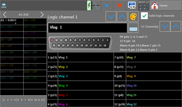

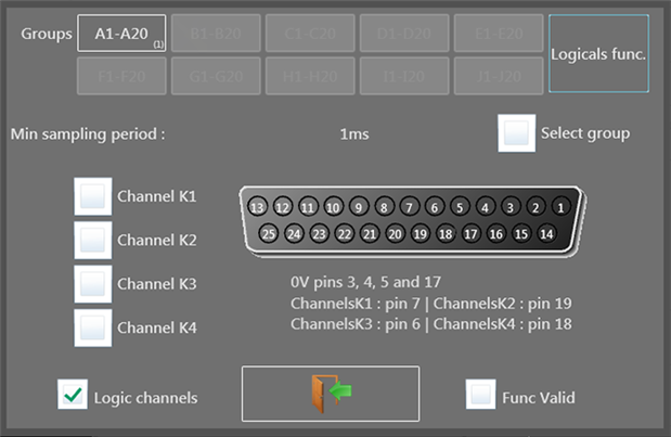

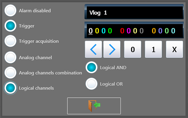

Selecting logic channels from the home screen shows a graphical representation of the DB-25 connector on the recorder and allows for the configuration of the name and colour of each channel. Of note is that the word “Valid” is used instead of “Enabled”, likely a carry-over from French which makes the interface slightly confusing in later sections. Note that this only covers the digital logic channels and not the timing channels (i.e. K-channels, confusingly termed logical function channels).

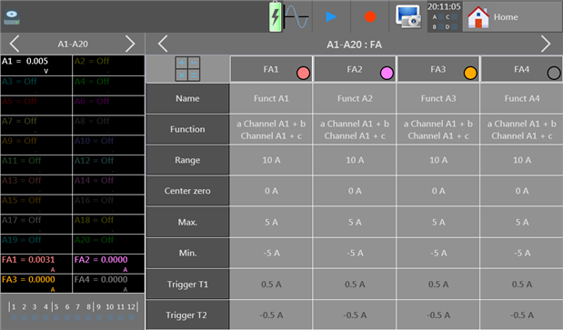

Selecting the channels button from the home screen brings up the channel table, where individual channels can be quickly configured for most parameters. The table displays ten channels at a time, with arrows to toggle between the various channels. Interestingly, certain combinations of features were found to cause corruption in channel configuration which led to unexpected results and recorder instability. Unfortunately, there does not seem to be an easy way to perform batch set-up of a number of channels with the same parameters, instead one has to configure a channel and use the detailed channel screen to copy to every other channel individually. Also, the free-selection of range, minimum and maximum values which determine the vertical plotting axis do not clearly correspond to the hardware ranges on offer, making it difficult to understand the expected accuracy levels.
For convenience, channel names can be changed using the on-screen keyboard which approximates a QWERTY layout. Channel functions are quite extensive, with Voltage, Current, Thermocouple, RTD and Resistance features. Current measurement relies on an external shunt resistor, with a configurable value. Thermocouple support is available for J, K, T, S, B, E, N, C and L type with switchable units and compensation. Channel math can also be applied to perform various functions to scale inputs from transducers into more human-friendly units.

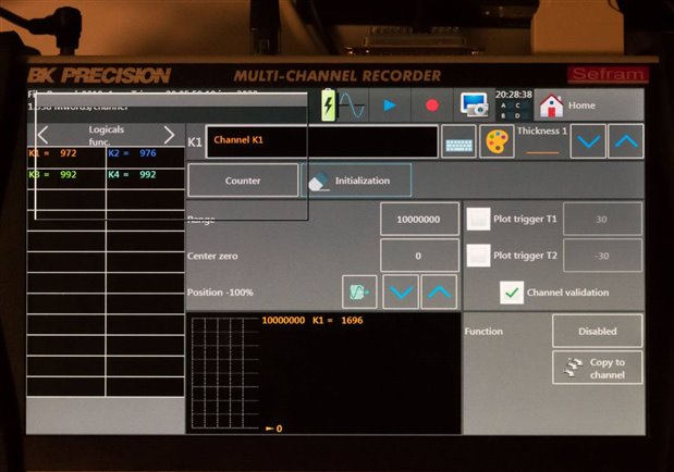

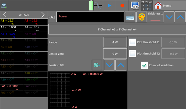

Tapping on a channel identifier itself allows for accessing a more comprehensive configuration menu which allows for setting plotting line thicknesses as well. This type of configuration menu can also be accessed by tapping on the channel name in the value table on the left of the home screen.
For certain features like mathematical function channels, the configuration table can only be accessed once the channels are first enabled via an extra button in the home screen. This allows for basic mathematical functions to be computed between channels. Combining these features with per-channel mathematical functions led to problems in testing, however.

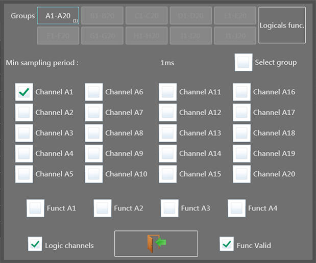

A separate set of menus is used to toggle channels on and off, with some options only appearing once the channels are enabled. Analog channels are grouped by the module, with the possibility to enable or disable a whole group. Logicals func. Button changes over to the second menu allowing for timing channels (K) to be enabled or disabled. The Logic channels tick-box at the bottom enables or disables digital input channels, while the Func valid checkbox actually enables or disables the mathematical function channels (which performs basic math between functions). Because of poor localisation, this was more confusing than expected.

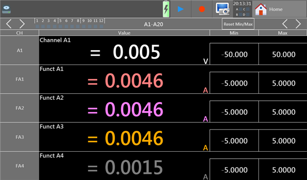

Aside from the F(t) and X-Y modes mentioned earlier, the unit also supports numeric display which turns the screen into a large multimeter-like display. All 20-channels of a single group can be displayed simultaneously on a single screen if desired.

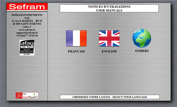

The DAS240-BAT comes shipped with a CD-ROM labelled “Notice, User Manuals”. As optical disc drives are starting to become rare, it’s good to see that relevant documentation is available online as well. The included CD had a volume label dating it to 23rd November 2018.

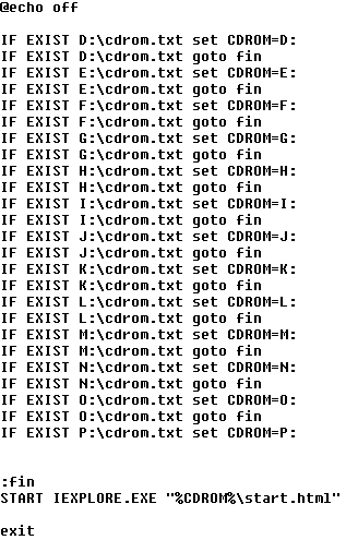

The disc did not actually run on my computer due to a curious way of writing the autorun.inf which calls RUN.BAT which contained this script:
As my CD-ROM drive is R:, it never found the disc. It would also falsely detect a drive if it had cdrom.txt in its root directory. It also attempts to call Internet Explorer, so I suspect there’s a lot of improvements that can be made – perhaps using fully relative drive paths instead.

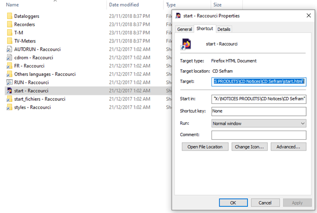

Exploring the disc showed that it has mostly manuals in different languages. Contrary to the user manual, I could not find any relevant software on the disc for the DAS240-BAT, so it’s probably best to skip using the disc entirely.
Curiously, the disc is also mastered with shortcut .lnk files on the disc in certain directories, which links to files on the X: drive on their computer. I suspect that not enough care went into the mastering of the disc, as it is also burned as a CD-XA (Mode 2 Form 1) disc rather than the more conventional Mode 1 format which is more compatible.
