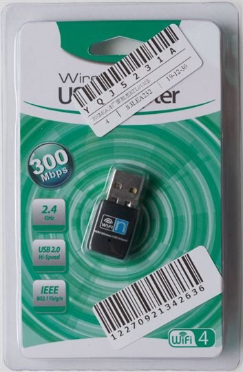

Instead, it is possible to purchase a Wi-Fi adapter option from B&K Precision / Sefram under order code 902402000 which plugs into the USB-A connector and connects the recorder to a network via 2.4GHz 802.11 b/g/n Wi-Fi. While the manual does allude to its Wi-Fi connectivity, it’s interesting to note that this option is not listed on the datasheet itself, as if the option may have been depreciated. Unfortunately, this item does not seem widely available, being on backorder at most distributors at an expensive price with none shipping into Australia to my knowledge.
I was able, after some work, to obtain a compatible Wi-Fi adapter from a third-party to test the Wi-Fi connectivity feature. For more information regarding compatible Wi-Fi adapters, refer to Ch7 – Teardown post.

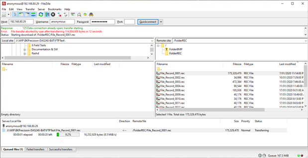

FTP Server

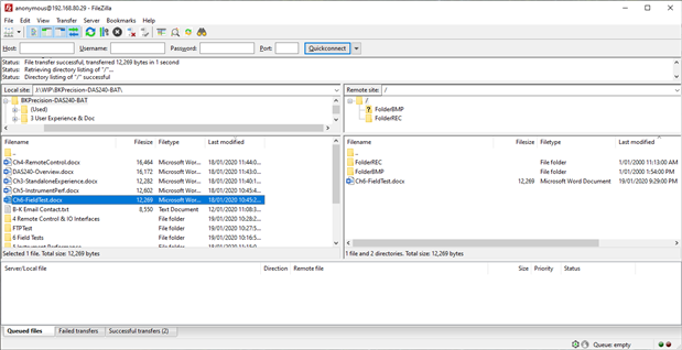

The device offers an unencrypted FTP server on Port 21 for more flexible file management, permitting the downloading, uploading and deletion of files via an FTP client or through the operating system. Testing of FTP functionality was done with FileZilla.
Anonymous login is permitted, with no checks on the password. No FTPS is offered.
Data transfer rate was much faster than via HTTP, reaching 8.5MB/s on Ethernet and 2.9MB/s on Wi-Fi.
It was even possible to upload files into the storage of the device. This is perhaps not optimal, as it means that anyone on the network can download the files on the storage, delete them or fill up the storage without any credentials.

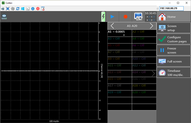

VNC Server
Virtual Network Computing (VNC) is a cross-platform remote framebuffer (RFB) protocol, ordinarily operating over TCP port 5900 which allows for sharing a remote screen while offering keyboard and mouse control capabilities. The DAS240-BAT offers a VNC server as a way to remotely interact with its touch-screen oriented interface. Access is secured by a password of up to eight characters. The server was tested with UltraVNC Viewer as the client.
Connecting via UltraVNC was successful, with the remote target reporting the name of “Colibri”. The device does not appear to plot its cursor, thus without a local cursor, it can be difficult to know where the mouse is. Screen updates come through fairly swiftly, with only a short delay and the occasional screen tearing. Long remote-control sessions were achieved with no problems.
The device itself displays the set VNC password when accessing the menu option to set the password. I don’t suggest setting a sensitive password, as it can be retried from the recorder. Initially, I received the recorder with a corrupted password that displayed as mostly squares – resetting the password to something sensible was necessary to allow VNC connections to be established.
If too many incorrect password attempts are registered, the VNC server will lock out any further connection attempts with a “Too many security failures” error until expiring its back-off timer or until the unit is restarted.

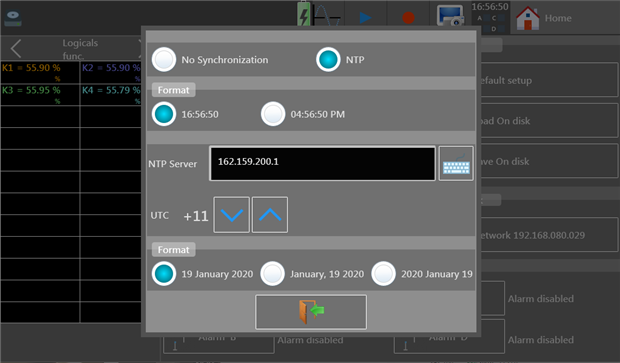

As an alternative to setting the time on the DAS240-BAT manually, it is possible to connect it to a network and synchronise time with an NTP server. To do this, an NTP server needs to be entered into the Settings of the recorder.
I found that this option seems to work fine, although only for NTP server IP addresses and not hostnames when used with a static IP configuration as no DNS configuration is accommodated within the recorder’s interface. I have noted this limitation to B&K Precision for potential improvement.

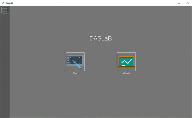

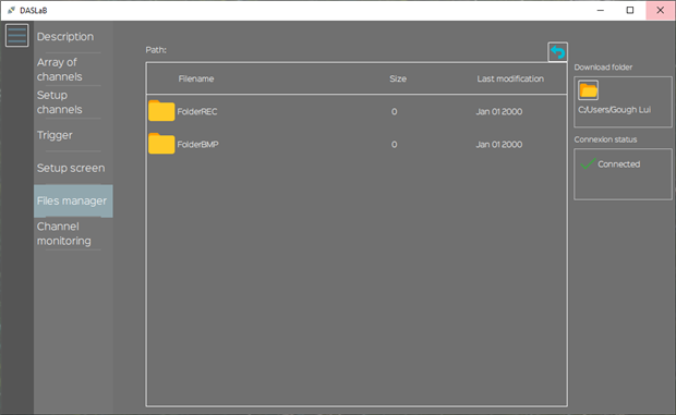

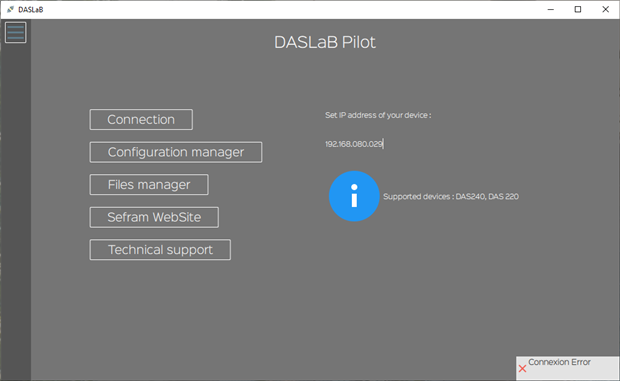

The SeframViewer / DASLab package is a combined package that installs both programs in the one installation. At the time of writing, the combined package is V1.2 from Sefram’s website and V1.1 from B&K Precision’s website. Looking at the Software Updates page on Sefram’s site, there is a newer version of SeframViewer (V3.0) available that can be installed afterward. I have asked them to ensure versions are consistent into the future.
Installation went smoothly on a machine running Microsoft Windows 10.

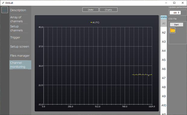

Opening DASLaB greets you with a screen that has two choices – Pilot and Viewer. Selecting Pilot keeps you in DASLab, allowing you to remotely configure, view measurements and manage files, while selecting Viewer will instead launch SeframViewer. On my first launch, it was in the French language, which can be changed to English by selecting Language in the side hamburger menu.

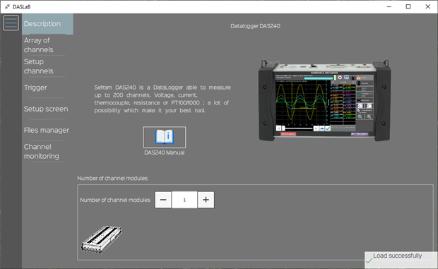

The first step is to establish a connection with the DAS240-BAT which requires setting the IP address of the device. Initially, I was entering the IP address using all three digits in each section resulting in a connection error (as the software interprets octets entered as 008-099 as octal and makes a connection to the incorrect address). I was then informed by another reviewer that they managed to get it to work by pressing the right arrow key to skip unused places and that made it work just fine. This has been reported to B&K Precision for improvement.
Once a successful connection has been established, we are greeted with a description of the unit with a link to the manual and an opportunity to configure the attached number of channel modules.

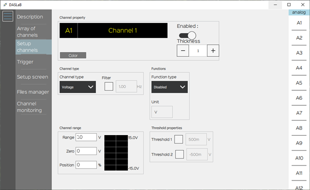

The next feature is “Array of channels” which allows you to configure channel set-up via the PC. Unfortunately, reconfiguration on the computer is a little less straightforward than expected, as not all channel features are exposed in this view (e.g. math features, max/min range) and some entry boxes have values that are hidden outside of the viewable area (e.g. the boxes with m are actually 100m). There is no way to commit a bulk set of changes to all channels or ability to select hardware-appropriate range numbers from a selection. Changes made in this screen and the others that follow are not made immediately and instead need to be sent to the DAS once ready using the selection in the left hamburger menu.
The “Setup channels” feature allows for more specific channel feature configuration on a channel by channel basis. The “Trigger” menu allows for configuring the sampling rate for recording and start/stop trigger features.

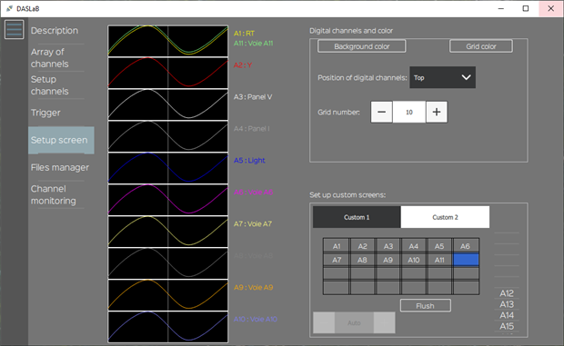

The “Setup screen” menu allows for the configuration of the number of display screens and the inclusion of a given channel onto one of two custom screens. The “Files manager” option connects to the unit via FTP, allowing for files to be downloaded to the computer.

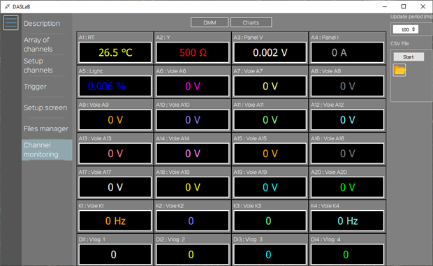

The “Channel monitoring” feature polls the recorder for values every update interval (set to 100ms by default) and either shows it on a numeric display (labelled “DMM”) or plots it locally on a chart. This is different to viewing the display remotely via VNC, as this retrieves the actual measurements and plots them rather than retrieving the screen as displayed on the unit.

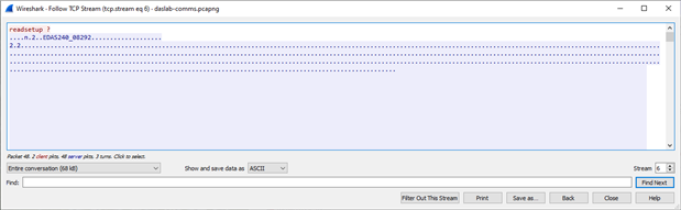

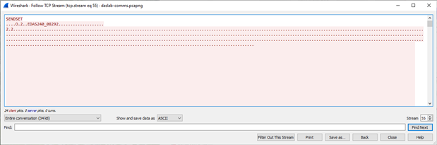

It was discovered that the process of reading and sending the setup to the unit uses the Telnet Port 22 server on the device, with the command readsetup ? and SENDSET being used without any authentication. This implies that anyone on the network that can identify the IP address of your DAS-device could rewrite the configuration remotely.
Unfortunately, I attempted some reconfiguration of channel parameters using DASLaB, but when making numerous rather complex changes, it seems possible to create a corrupted configuration that would not completely load onto the DAS240-BAT or perform as expected. As a result, the software feels somewhat unrefined and unfinished, especially when combined with the strange localisation and IP address issues.

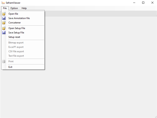

SeframViewer

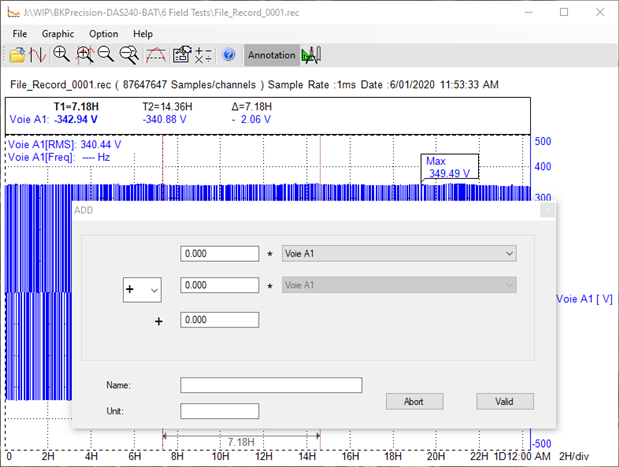

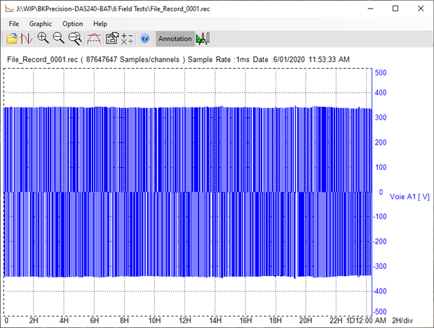

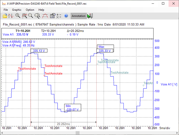

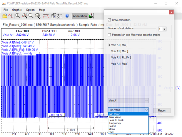

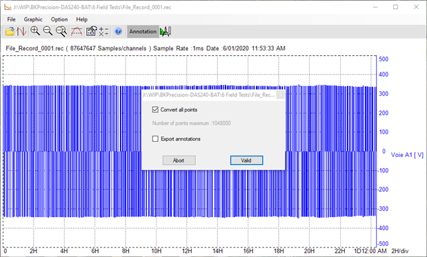

SeframViewer is the other half of the software provided by B&K Precision / Sefram and is used for working with the .rec data files generated by the DAS240-BAT.
For testing, I used both Version 2.8 (as packaged with DASLaB V1.2) and Version 3.0. The software has poor English localisation throughout, resulting in “Contactener” instead of concatenate or join for example.

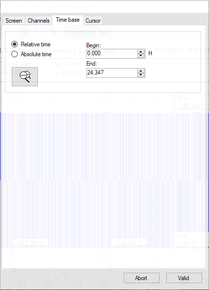

While loading a file, it is possible to configure several options including the range, whether each channel is plotted overlaid over another or on an individual plot and the ability to “undersample” the input file (i.e. decimate) to reduce the data volume. Note the extensive use of “Abort” and “Valid” instead of cancel and OK. The loaded data is displayed in a scope-trace like display.
It is possible to make measurements on the data using cursors and calculation features. It is also possible to add annotations to the graph, which can be saved and exported. Some of the menus are oddly transparent for some reason.
It is possible to perform basic mathematical operations on traces as well. A HTML help is included, although it is very basic and contains copious translation issues as well.

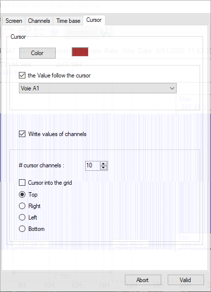

The display can be further customised through the tabbed dialogue of options. The screen can be printed or exported to bitmap through the menu.
Export to a number of formats including Excel, .csv and Text is available, which takes a while on longer data files. The recorded .rec files appear to be encoded or compressed in some way, thus cannot seem to be opened by anything else. Export to Excel is limited to 1048000 rows, although no warning is provided during export to indicate the export is incomplete.
Export to .csv under Version 2.8 were unusable, as the delimiter was a period ‘.’ while the decimal point was also ‘.’ thus making it impossible to distinguish. In Version 3.0, a feature was added to change the .CSV delimiter, although attempting to configure or export a .csv file would result in a crash. This has been reported to B&K Precision for rectification. Export to Text results in a tab-delimited file which contains the full array of data and can be imported to other software.

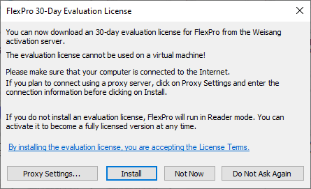

The Sefram website also lists FlexPro 2019 for download under the DAS240 page. This is a third-party data analysis package from Weisang GmbH.
The software installation does not come with a license, however, a 30-day evaluation license is available. I didn’t feel it was worth cluttering my system with yet another data analysis package that I would have to learn, as I am already quite happy with Microsoft Excel, MATLAB, Python and R-Studio. As this was not software from B&K Precision or Sefram, I did not do any further testing of it.

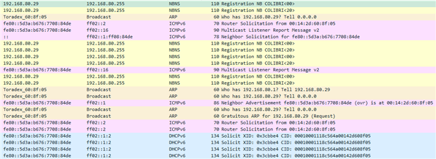

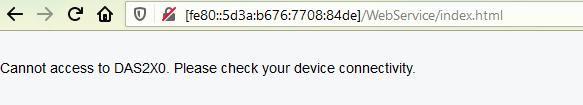

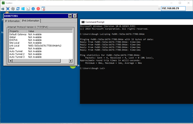

There, it was also determined that the device issued DHCPv6 address requests and configured itself for a SLAAC IPv6 link-local address, announcing this to the network, despite having no user interface choices for IPv6 capability or to disable it. This could lead to the device registering and obtaining an internet-routed address and being subject to attack via the internet.
Despite appearing to allocate itself an IPv6 address, many of the services were not available or operating correctly over IPv6. However, it became possible to crash the IP stack entirely via the network, knocking the recorder offline from both IPv4 and IPv6 networks until it is rebooted.

    Hi Gough, What's the chipset you've got for the WiFi adapter? I noticed you mentioned Realtek, but my Realtek adapters are not functioning with it, so I'm guessing I've got a different chip : (

    Gough Lui over 6 years ago in reply to shabaz
    The one I ordered that did not work looks like this - so if you're on eBay, avoid this one because it's not the chipset they claim it is and is an unsupported RTL8192EU:
    For your sake, I hope the one you get ends up working. The problem is that the list of PID/VIDs are very restricted and generally only the cheapest units without EEPROM or customisations from Realtek's default EEPROM settings would use the default VID of 0xBDA. Go a little too upmarket (e.g. TP-Link) and it might have the right chipset but the wrong PID/VID. Unfortunately, there doesn't seem a way to rewrite the EEPROM information of most Realtek-based dongles, but a few of them can be altered using iwpriv commands given the correct driver under Linux (something I didn't have any success with - see this article for an RTL8811AU for example).
    Bonus points if the one you ordered looks a bit like my one with the red plastic tongue. The first one I ordered should have worked, but the seller actually sent me a different chipset than the description and then offered me just a partial refund at the end. I was fuming. But it was only a few dollars ...
    Unfortunately, with the current COVID-19 situation, I don't know how long shipments will take nowadays. I've had another few products "en route" be delayed over a week now. But before I made the full regdump to figure the list out, I basically ended up using a Mikrotik hAP mini as a USB-powered Ethernet to Wi-Fi bridge similar to your setup. Nowhere near as convenient, but at least it worked while I waited for my dongles to arrive. The funny thing is, if it had been more secure, determining this information would have probably been rather difficult ...

    You should refer to Ch7 - Teardown for the full list of supported PID/VID and chipset models. It's a bit of trial and error with eBay shopping but I managed to get one that worked after the second try.
