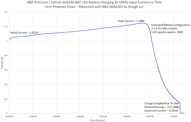

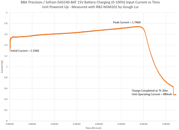

The DAS240-BAT is powered from a 15V 4.5A power supply, although the unit itself is marked as having an input of 15V 1A. It also has an internal battery which can be used to run the unit away from mains supply. In order to determine power consumption and charging profile, power was supplied from the Rohde & Schwarz NGM202 Power Supply through a home-brew banana to barrel plug cable so that the consumption of the DAS240-BAT can be measured continuously as the unit is running, charging or both. The battery was emptied by running the unit until it shuts down automatically prior to all testing.
With the unit powered down and plugged into the power supply on an empty battery, the battery takes 7 hours and 18 minutes to charge, delivering a total of 112.14Wh. I estimated the cell capacity to be approximately 10Ah based on these figures alone. Charging started with an initial current of 1.021A, peaking up to 1.248A.
With the unit powered up, the charge time was recorded as virtually identical at 7 hours and 20 minutes. The initial current was 1.336A with a peak current of 1.746A and an operating current of 484mA. This suggests the consumption of the unit is around 7.26W when operating with a fully charged battery, peaking at 26.19W while charging. A higher consumption may occur when additional modules and USB devices are connected – it seems that 2A or 2.5A is all that is necessary, so the power supply provided has plenty of margin which should mean it operates cooler and has a longer lifetime.

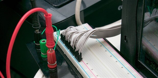

In order to do this, I used 28AWG ribbon cable with one conductor per connection, resulting in a total of forty wires – twenty positive and twenty negatives. Wire ends are screwed into the terminal blocks, while the other end is soldered to header pins in groups of four and heat-shrinked. A breadboard power bus is used to distribute the test signals to all channels equally.

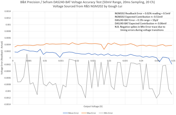

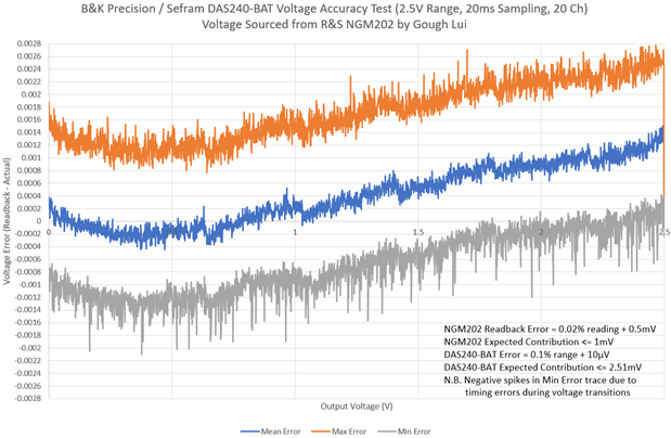

Accuracy

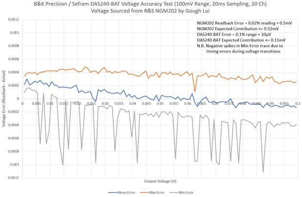

To determine accuracy, testing was performed with voltages generated at 1mV intervals by the NGM202 with the readback value being taken as the “true” voltage with its noted tolerances. The DAS240-BAT results were read across all 20 channels, repeated 32 times for a total of 640 readings at each voltage point. The average, maximum and minimum error values were computed across all 640 readings and thus represent an aggregate across all channels. Please note that due to timing issues, the first readings from the first channel sometimes reflected the voltage from the previous step, resulting in minimum errors which are 1mV below the actual performance and are to be disregarded! As the mean is computed over so many values, the stray outlier values do not have a significant impact on the measured average error. The experiments were repeated across the 50mV, 100mV, 500mV, 1V, 2.5V, 5V, 10V and 25V ranges only, due to the limitations of the NGM202’s output capability in terms of its resolution and output range. Prior to each test, an automatic calibration was conducted on the DAS240-BAT after observing a minimum 30-minute warm-up to ensure that readings should meet specifications.
50mV Range
The first test was at 50mV where the expected error is below 0.06mV. As mentioned above, there will be spikiness in the minimum error due to timing errors – the higher reading is the correct one. Unfortunately, this test is rather inconclusive as the NGM202 is expected to contribute up to 0.51mV of error thus we cannot be sure where the source of the reading error is. The mean reading error is in a range of about -0.2mV to +0.3mV.
100mV Range
The test at 100mV has an expected error of below 0.11mV, although the NGM202 would be expected to contribute up to 0.52mV of error. The test is not very conclusive, for similar reasons. The mean error is between -0.2mV to +0.3mV.

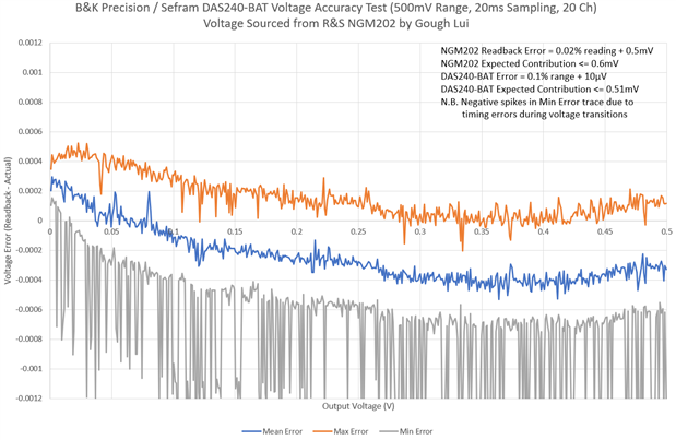

500mV Range
By 500mV, the expected error of under 0.51mV is comparable to the contribution from the NGM202 of 0.6mV. The mean error ranges from -0.5mV up to +0.3mV, which now falls inside the expected margin of error even though the error contribution is likely to be spread across both units. Based on the maximum and minimum error, individual readings may be up to 0.4mV in error compared to the mean.

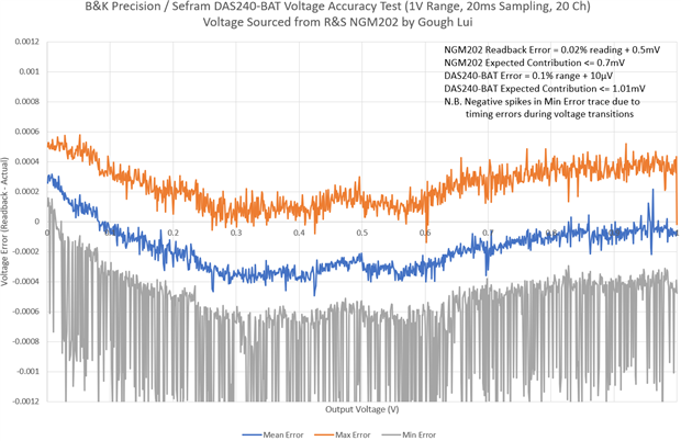

1V Range
As the voltage increases, the error contribution of the NGM202 reduces. The DAS240-BAT is expected to contribute up to 1.01mV of error with the NGM202 contributing up to 0.7mV. In this case, the whole range (individual and mean readings) fit within the expected error range which confirms the unit meets and likely beats the accuracy specifications as the mean error is still very similar to previous ranges.
2.5V Range
Expanding up to 2.5V, the DAS240-BAT is expected to have up to 2.51mV of reading error with the NGM202 contributing up to 1mV. This time, the max error peaks just exceed the DAS240-BAT specification ever so slightly when ignoring the NGM202’s contribution. The mean error seems to have an upward trend towards the higher end of the range, reaching close to 1.3mV. It is concluded that the DAS240-BAT is likely to have met and beat the accuracy specifications.

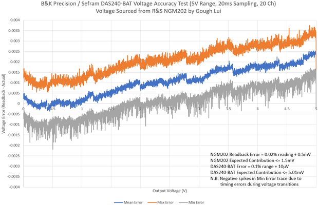

5V Range

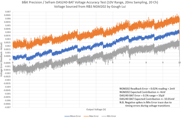

This trend continues up to the 5V range with an expected error up to 5.01mV with a 1.5mV contribution from the NGM202. In this test, all of the readings fall within the expected DAS240-BAT error range, but there is a continuing upward trend in errors. Towards the end, the offset of the reading causes the upper values to be read as the maximum value as the unit does not correctly report over-range over Modbus TCP, hence causing the “drop” in error at full scale.
10V Range
The 10V range is a carbon copy of the 5V range, with the resulting error readings fall completely within the DAS240-BAT error range, indicating the instrument beats the accuracy specifications.

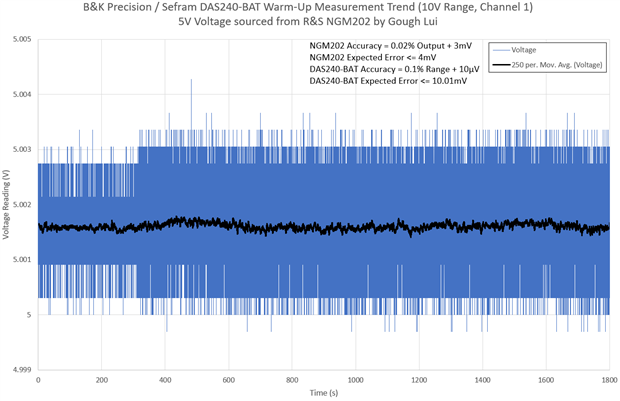

Warm-Up Profile
To assess the drift in analog channel performance with regards to instrument warm-up, the instrument was pre-configured for a single channel active on the ±10V range at the shortest sampling interval (1ms) and shut down for six hours. During this time, a fixed 5V output from the Rohde & Schwarz NGM202 was generated throughout all six hours with the room temperature remaining stable at 23°C and within specifications. The DAS240-BAT was then powered up and acquisition was performed for 30 minutes.
The graph seems to illustrate there is not much of a warm-up trend at all, with readings seemingly stable from cold. There is a certain amount of reading noise, so a moving average of 250 samples (0.25s) was taken to try and detect any underlying trends, but whatever is present appears just to be a random walk noise. This illustrates that warm-up impacts appear to be negligible when the instrument is used at room temperature.

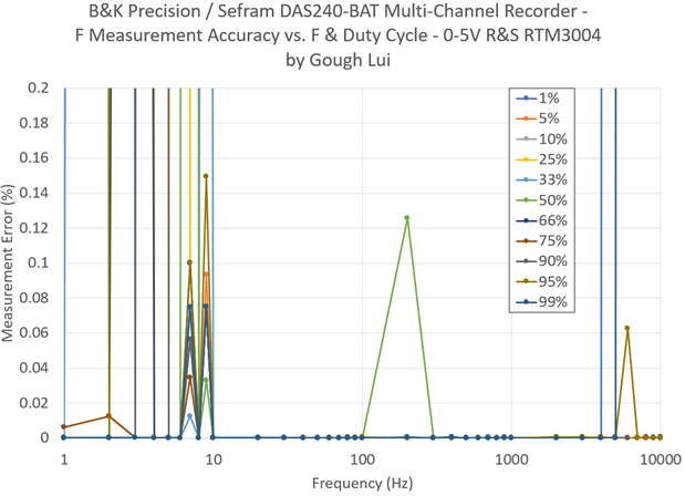

The DAS240-BAT has four digital timing channels, labelled K1 to K4, tolerant of voltages up to 24V. Timing functions include frequency (or RPM), PWM and counter functions. Testing of the first two were undertaken by using the Rohde & Schwarz RTM3004’s onboard function generator to provide test signals under SCPI remote control with results collected via Modbus TCP. Testing is performed on a range of signal frequencies with a 0-5V logic level. The counter function appeared to operate satisfactorily, although the minimum pulse width was not specified and in some borderline cases, it is possible to have the occasional erroneous value, but on the whole it usually operated flawlessly. The other functions, however, deserve much closer inspection due to the complex number of variables at play.
Frequency

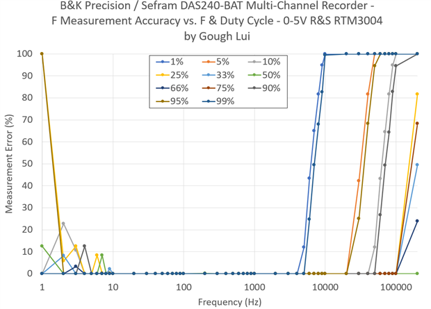

Surprisingly, the DAS240-BAT allows for setting the frequency measurement range far wider than the claimed 10kHz in the datasheet, allowing up to 200kHz. I suspect this is not warranted, although it was also worth testing.
It seems that measurements above 4kHz are not reliable, but the error is dependent on the duty cycle of your input signal, with the inverse duty showing similar characteristics (i.e. 1% vs 99%, 5% vs 95%, etc). Measurements at the low-end are also unstable.
Zooming into the specified range of the DAS240-BAT, it can be seen that the frequency measurement is not without issues. The area from 1 to 10Hz seems to result in rather unstable values that exceed the stated 0.1% error, whereas at 200Hz/50% duty cycle there is an outlier. At 4kHz and above, there seems to be challenges with properly measuring 1%/99% duty cycle signals.

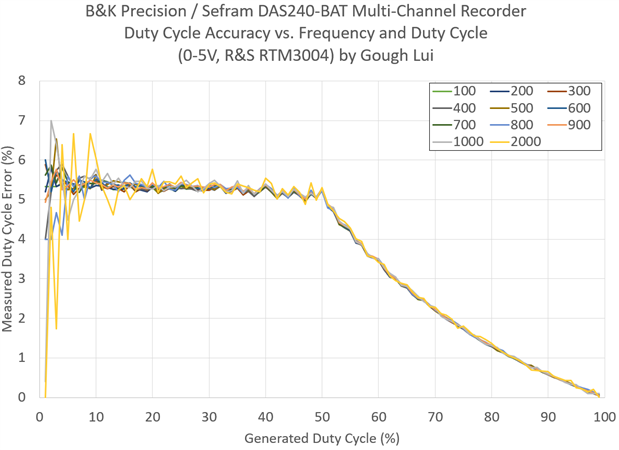

Duty Cycle

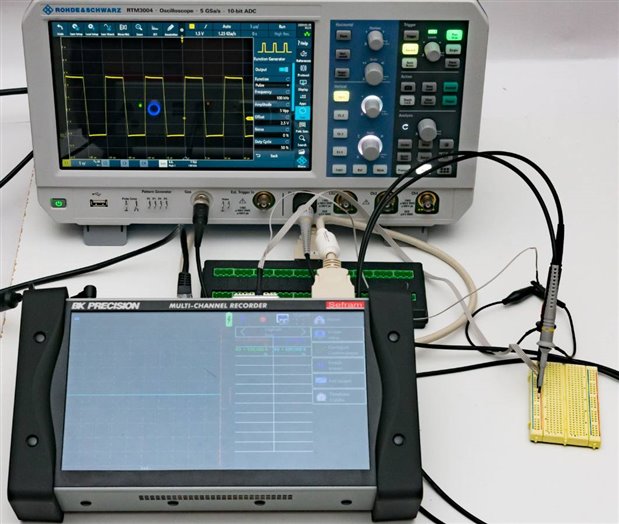

The duty cycle was measured at 100 to 2000Hz at each 1% step from 1 to 99%. The measurement errors were much greater than the 0.1% specification, reaching about 5-6% for readings below 50% and decreasing as a curve towards 100%. This suggests to me that there may be something wrong with the internal calculation of duty cycle, as the error is mostly independent of frequency especially above 20% duty cycle. Low duty cycles and high frequencies also seem to pose challenges for the DAS240-BAT. This has been reported to B&K Precision for improvement.
One possibility is that the RTM3004 could have contributed to error, so I tested the generated output from the function generator on one of the analog channels of the RTM3004 and the measured duty cycle matched the setting within 0.1%, indicating the error was with the DAS240-BAT and not the RTM3004.

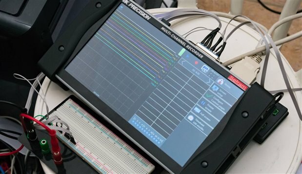

The DAS240-BAT has twelve digital logic channels which are tolerant of voltages up to 24V. Testing the logic channels required the construction of a wiring harness to access all the channels.

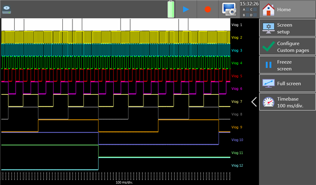

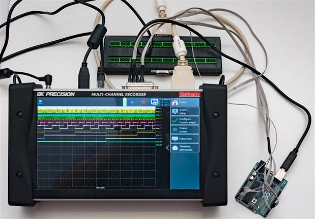

Counter Test
A simple test of all the logic channels can be achieved by inputting a digital counter that iterates over all possible 12-bit values at the maximum supported 1kHz rate. I achieved this using an Arduino Uno with the DirectIO Library. The code is as follows:

Once loaded onto the Arduino, I used a USB port on the DAS240-BAT to power the Arduino.

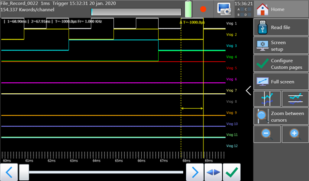

The signal was correctly shown on the display and resolution of the counter even at the lowest bit was acceptable with only a slight occasional jitter visible on the trace when zoomed into the maximum level. The interface is not optimised for searching through for events on a given logical combination, however.

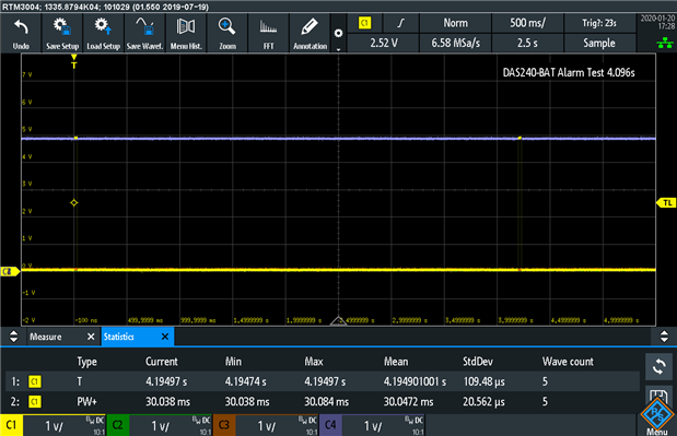

Alarm conditions using all digital inputs were also tested. The expected period of alarm is 4096ms based on singling out one unique 12-bit value, however, the recorded time is longer. It seems that alarms are sometimes missed, perhaps as the system cannot handle such rapid input changes.

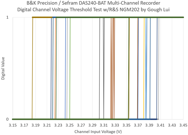

The digital signal threshold is the point where the channel “decides” between a logic zero and a logic one and determines the compatibility of the input with various signalling schemes.
In order to test this, all logic channels were fed by the Rohde & Schwarz NGM202 power supply and swept at 1mV intervals both upwards from 0V to 5V and downwards from 5V to 0V. Values were recorded remotely, as similar with the prior experiments.
Each channel appears to have a slightly different threshold, but it averages around 3.3V. Reliable zeroes are achieved below about 3.18V and reliable ones are above 3.41V. This makes it compatible with 5V TTL and high-level (up to 24V) signalling, but 3.3V TTL is insufficient to reliably drive the inputs.

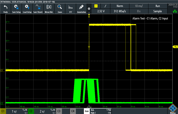

Alarm Outputs

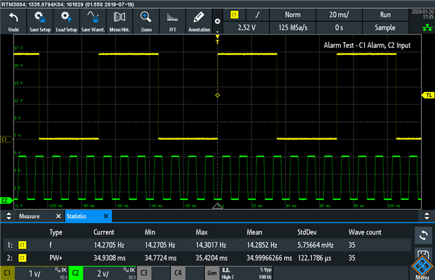

The DAS240-BAT is capable of generating up to four independent alarm channel outputs at 5V TTL levels subject to various combinations of analog threshold or digital logic states. Testing of these outputs was achieved by using the Rohde & Schwarz RTM3004’s inbuilt signal generator to produce input signals which could be used to trigger the outputs.
With a 100Hz signal input and a condition which should result in the alarm output following the input, it seems that the alarms are only updated at a rate of about 14Hz with a pulse width of about 35ms. This makes it less suitable for applications generating a high-frequency of alarms.
The propagation delay of the alarm signal is variable between around 4 to 10ms, which is probably fast enough for most expected applications, except for the most demanding requirements.
