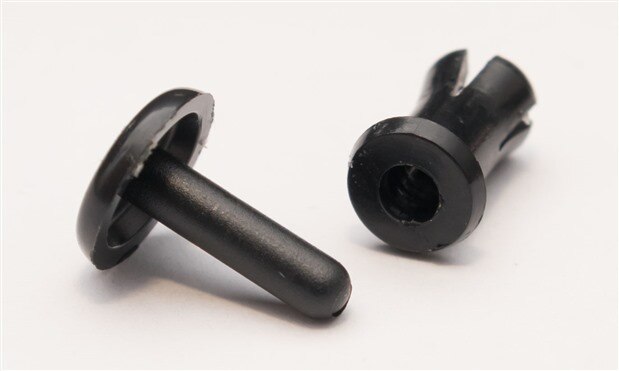

Surprisingly, the main unit is held together mostly by using plastic rivets which makes disassembly very easy.
Removal of the plastic rivet is done by prying on the head, removing it, then removing the collar from the hole. Once all of the plastic rivets securing the rubber ends and strap eyelets have been removed and the rubber ends are removed, it’s interesting to see that the weight of the device is still 1.653kg which is above the claimed 1.5kg in the datasheet.
Opening the main unit requires breaking a warranty seal that is placed over the two metal halves of the case.
Removing the remainder of the plastic rivets allows the case to come apart.

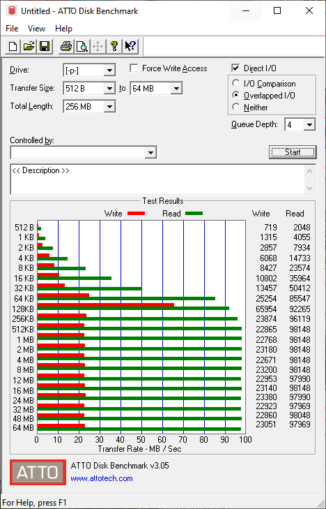

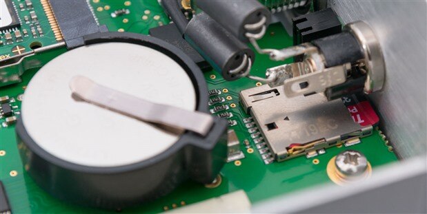

The onboard 32GB memory storage is a microSDHC card that lives in a socket on the main PCB. As there is no slot in the case, the card cannot be reached externally – this may be due to design as the unit could malfunction if the card is removed during operation.

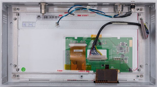

Removing the PCB from the chassis requires removing six screws. This reveals the LCD screen assembly from Ampire (AM1024600L-series).

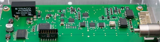

We can take a closer look at each section of the main PCB to understand which components are used in this solution. We begin with the analog section of the PCB.
There is one tall component, a Traco Power TMV 0505D EN +/-5VDC 100mA 1W DC-DC converter.

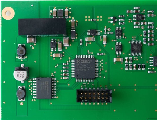

The analog section consists of the following identified components:
  • Analog Devices ADuM1401CRMZ Quad-Channel Digital Isolator
  • Xilinx XC2C64A CoolRunner-II CPLD
  • Analog Devices AD7694 16-Bit 250kS/s PulSAR ADC
  • Analog Devices ADR02 Ultracompact, Precision 5.0V Voltage Reference
  • Texas Instruments TLV2372 500uA/ch 3-MHz Rail-to-Rail Input and Output Operational Amplifiers with Shutdown
  • Vishay Siliconix DG412LE 16-ohm Low Parasitic Capacitance and Leakage Quad SPST Switches
  • Analog Devices AD622A Low Cost Instrumentation Amplifier
  • Ixys OAA160 250V Dual Normally-Open Single-Pole 8-Pin OptoMOS Relay

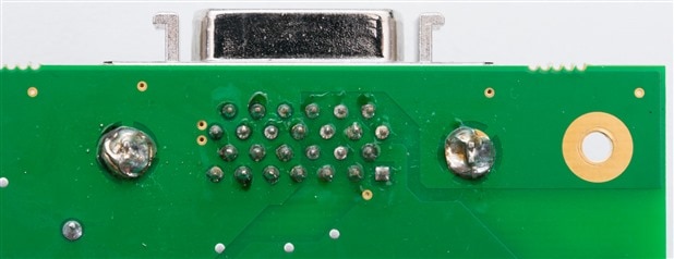

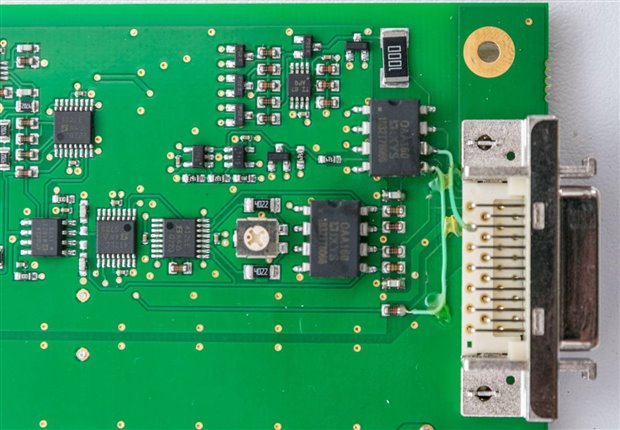

It seems the board has two errors in this section, with two of the traces manually cut and patched with Kynar wire. Perhaps this is an early revision of the design.
Furthermore, a look underneath the board shows that the channel interface connection to be likely hand-soldered with some flux residue and untidy soldering of the retention pins.

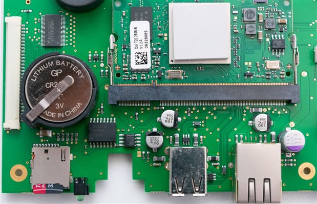

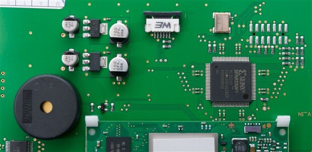

The area near the System-on-Module has the following identified components:
  • Toradex Colibri T20 256MB System-on-Module (Nvidia Tegra 2, Nanya 256MB DDR2, 512MB (or 1GB) NAND Flash)
    • Asix AX88772B Ethernet Controller
    • Cirrus Logic/Wolfson WM9715L Audio and Touchpanel Codec
    • Texas Instruments TPS658643 Advanced Power Management Unit
    • SMSC USB3340 Enhanced Single Supply Hi-Speed USB ULPI Transciever
  • Maxim Integrated DS3231S Extremely Accurate I2C Integrated RTC/TCXO/Crystal
  • Texas Instruments TPS2042B Current-Limited Power-Distribution Switch
  • Texas Instruments (formerly National Semiconductor) DS90CF363B +3.3V Programmable LVDS Transmitter 18-bit Flat Panel Display (FPD) Link 65MHz
  • Golden Peak (GP) CR2430 Lithium Coin Cell 270mAh
Above the SoM, there is a Xilinx Spartan XC3S200 FPGA and Murata piezo-speaker.
The microSDHC card is a Transcend Premium 32GB Class 10/U1 with UHS-I interface, Made in Taiwan. This appears to be a consumer-grade card, although I suspect the large capacity should mean that the amount of write cycles accrued in regular usage should not exhaust the card’s endurance.
When inserted into a regular card reader, the card is found to be FAT32 formatted. The performance appears to reach up to 98MB/s read in a card reader, with writes about 23MB/s except for an odd spike at 128kB accesses. This seems to be a fairly average result for a modern Class 10/U1 card.

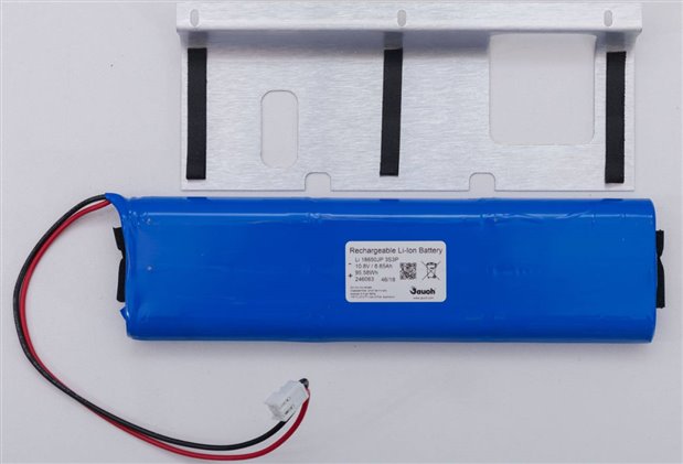

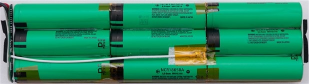

Battery Pack
The battery pack is restrained into the rear casing of the device with a cage. Removing the bolts allows us to free the pack from the case for further analysis.

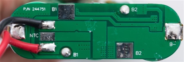

The battery pack is a Jauch Li 18650JP 3S3P rated at 10.8V / 8.85Ah for a total capacity of 95.58Wh with a date code of Week 46 of 2018. As the pack is terminated into two wires into a plug, replacement of the battery is not difficult. However, this does not appear to expose any “intelligence” to the host system to accurately determine state-of-charge.
Slitting the heatshrink open and examining the pack inside shows that the unit is made of Panasonic NCR18650A cells which are rated minimum 2950mAh each with a typical capacity of 3070mAh. The configuration is 3-series, 3-parallel with balancing connections to ensure safety.

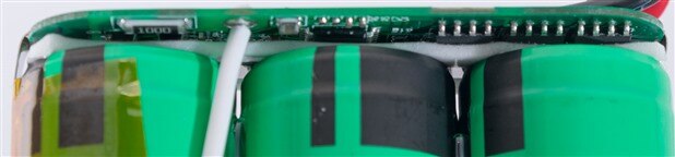

The PCB at the top takes care of protecting the battery pack and balancing the cells. I did not further disassemble the pack to avoid damaging the pack beyond repair as it requires some desoldering.

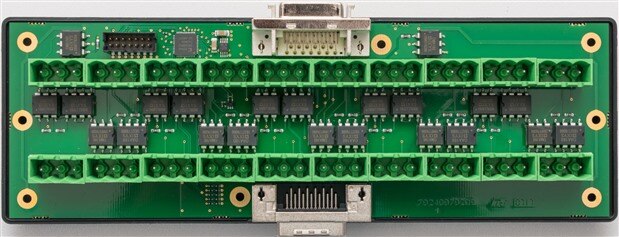

Channel Module
Unlike the main unit, the channel module is held together with six Phillips screws, one at each corner. Removing the rear cover gives a clear view of the insides.
The rear casing features plastic “boxes” around each of the sets of three connections to the pluggable terminal blocks for each channel as a form of extra safety isolation. The PCB itself is seen to contain a whole bunch of IXYS OMA160 Single Pole, Normally Open OptoMOS Relay and OAA160 250V Dual Normally-Open Single-Pole 8-Pin OptoMOS Relay and an ST 24C64WP 64kbit EEPROM.
The OptoMOS relays use a package similar to a DIP that is surface mounted. That was a bit of a surprise to me.
The top side has the remainder of the OptoMOS relays, with an Xilinx XC2C64A CoolRunner-II CPLD. The connectors appear to belong to the Phoenix Contact SM STB 2,5/5,08 series based on the markings on the terminal blocks.

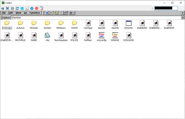

The Software
Using the right techniques, it is possible to close the operating software without causing the unit to shut-down, allowing for exploration of the operating system that powers the device. It is running a Toradex-prepared Windows Compact Embedded (CE) 7.0 image from 2010. This is not a particularly recent operating system, so I would not be surprised if it has a number of security vulnerabilities (including a potential issue which allowed me to access the OS in the first place).
Interestingly, despite its age, the configuration of the Ethernet adapter seems to suggest the device has an IPv6 stack installed which may mean that the device could be reachable over an IPv6 address even though the device does not normally graphically offer any means of configuring the address. The devices mounted can be seen in the background - \FlashDisk, \SDCard, \USB HD.
Because of the system architecture, it seems the flash boot image that contains the software is mounted at \FlashDisk and as it is part of the ROM image, it is not directly modifiable. The software starts via the \FlashDisk\Autorun\demardas240.exe file which appears to be a stub that calls the main \FlashDisk\DAS240.EXE. The software itself has a name of ‘SilverlighttoCpp’, which is suggestive it probably was developed in Silverlight. The VNC server is provided by \FlashDisk\WINVNC.EXE which is “Efonvnc Server WinCE Edition”. Within the root of the image is XCDAS240.BIT which appears to be an FPGA bitstream file and various configuration files. The \FlashDisk\System folder contains netrtwlanu.dll which is a Realtek driver for Wi-Fi which suggests the ability to support certain USB Wi-Fi adapters. This is hinted in the manual, but no further information is provided. A look through the registry hives allowed me to extract the PID and VIDs for which this driver is registered against (no guarantees that the driver will actually work however):

Unfortunately, if you attach another adapter which has the same chipset but incorrect VID/PID, a box pops up stating that it is an unrecognised USB device and to provide the name of the driver. I’ve tried many variants of the driver name but with no success. It is also not possible to modify the registry to accept new PID/VIDs as it is part of the ROM image that is read-only. I decided to order a pair of cheap Wi-Fi adapters which claim to have compatible chipsets in the hope of finding one with a compatible PID/VID combination. The first one that arrived was an RTL8192EU rather than the CU that was ordered, but the second was an RTL8188CU with the right PID and VID for a cost of under AU$4 delivered. Plugging this into the DAS240-BAT enables the Wi-Fi connectivity which appears to function just fine (although manual address configuration is not possible). Considering the fact the official Wi-Fi option is not available in Australia and is on backorder with a high price overseas, this was a good find.
Some odd files I spotted include files named ‘POLICE.BIN’ and ‘Sniffeur.bin’ whose purposes are unknown. It appears that HTTP, FTP and SMBv1 is served by the inbuilt Windows CE server. The SMBv1 connection is protected by a password which is not provided.
