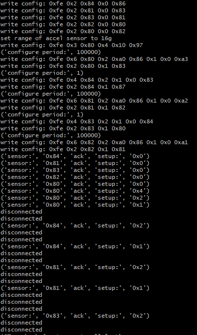

My experience with the Harting MICA and Bosch CISS was not without fault, however. In fact, a number of issues had cropped up during testing which required contact with Harting’s support team to troubleshoot and resolve.
After getting the system working, I noticed issues with spiking in the data from the humidity channel. After examining the data log, I found strange incidences where duplicate humidity values were being reported, with one of the two being erroneous.
Upon reporting this to Harting, they were not able to duplicate the issue immediately, which led to a wild-goose-chase of troubleshooting. I tried older versions of CISS Gateway to no avail, eventually convincing myself that was something wrong with the USB as it was clear that the dmesg log showed issues with the USB connection dropping out, reconnecting under a different device name and logging MUSB driver issues.
In troubleshooting, it was suggested that I try the Bosch CISS Python sample code, which set off a new wave of troubleshooting. Initially, I got no response from the CISS with the code whatsoever despite configuring the sensor configuration correctly. Testing on Windows with WinPython worked fine with no duplicate values. Eventually, after some work, it was determined that after uninstalling CISS Gateway container (not just stopping it), that it would work in Debian too.
This resulted in the discovery that there were no humidity spikes with the Bosch code despite running for almost 12 hours. But then … I couldn’t get the Bosch code to run again.
After a long chase, helped by Jan Cumps and stevesmythe, it was determined this was a case of mea culpa – I had added a UDP output to an IPv4 address in the Python code for logging, but because of the container restoration not restoring the configuration of the IP addresses, a network unreachable exception was being thrown. Because the Bosch code traps the exceptions as “disconnected”, I thought the sensor was dropping out but instead, it was because the UDP packet could not be sent. D’oh.
The good news was that Harting was able to reproduce the issue at last, and supplied a test version of the CISS Gateway that resolved this issue.
Unfortunately for them, the solution to one problem proved to unmask another issue. While the humidity channel was behaving itself, now the light channel is exhibiting spikes rather than duplicate values. Some of these spikes are outside the sensor’s reporting range as well and do not occur with the Bosch code. Support was again contacted, who spun up a new test version for me. Unfortunately, the first version did not fix it, and I provided the feedback to them, thus another version was created which finally did. Ultimately, through this RoadTest, I caused them to create three new CISS Gateway packages, but this should fix the issues found. I’ve also requested that they add additional features such as enabling/disabling sensors, changing report intervals and enabling/disabling the BLE radio.
This also fixed another issue with the prior CISS Gateway versions which resulted in the sensor failing to initialise with a moon icon if the sensor was plugged in during boot-up. The only way to initialise the sensor correctly would be to unplug and replug the sensor while hot, which was a ripe inconvenience.

[    8.673769] hub 1-1:1.0: USB hub found
[    8.678629] hub 1-1:1.0: 2 ports detected
[    8.790878] usb 2-1: new high-speed USB device number 2 using musb-hdrc
[    8.941141] usb 2-1: New USB device found, idVendor=2b9d, idProduct=8000
[    8.948188] usb 2-1: New USB device strings: Mfr=0, Product=0, SerialNumber=0
[    8.971506] hub 2-1:1.0: USB hub found
[    8.975583] hub 2-1:1.0: 2 ports detected
[    9.280987] usb 2-1.1: new full-speed USB device number 3 using musb-hdrc
[    9.404169] random: rngd: uninitialized urandom read (4 bytes read, 61 bits of entropy available)
[    9.414324] usb 2-1.1: New USB device found, idVendor=2b9d, idProduct=8001
[    9.421567] usb 2-1.1: New USB device strings: Mfr=1, Product=2, SerialNumber=3
[    9.429232] usb 2-1.1: Product: MCP2210 USB to SPI Master
[    9.435183] usb 2-1.1: Manufacturer: Microchip Technology Inc.
[    9.441579] usb 2-1.1: SerialNumber: 0000414035
[    9.490833] random: rngd: uninitialized urandom read (4 bytes read, 62 bits of entropy available)
[    9.513593] random: rngd: uninitialized urandom read (2500 bytes read, 62 bits of entropy available)
[    9.600833] usb 2-1.2: new high-speed USB device number 4 using musb-hdrc
[    9.611239] random: rngd: uninitialized urandom read (2500 bytes read, 127 bits of entropy available)
[    9.631001] random: nonblocking pool is initialized
[    9.708318] hid-generic 0003:2B9D:8001.0001: hiddev0,hidraw0: USB HID v1.11 Device [Microchip Technology Inc. MCP2210 USB to SPI Master] on usb-musb-hdrc.1.auto-1.1/input0
[    9.725141] usbcore: registered new interface driver usbhid
[    9.731000] usbhid: USB HID core driver
[    9.751263] usb 2-1.2: New USB device found, idVendor=0424, idProduct=9e00
[    9.758494] usb 2-1.2: New USB device strings: Mfr=0, Product=0, SerialNumber=0
[   10.122741] smsc95xx v1.0.4
[   10.223625] smsc95xx 2-1.2:1.0 eth0: register 'smsc95xx' at usb-musb-hdrc.1.auto-1.2, smsc95xx USB 2.0 Ethernet, 1a:e0:d9:d0:a5:de
[   10.236150] usbcore: registered new interface driver smsc95xx
[   10.411611] smsc95xx 2-1.2:1.0 eno1: renamed from eth0
[   12.132812] IPv6: ADDRCONF(NETDEV_UP): eno1: link is not ready
[   12.256766] device eno1 entered promiscuous mode
[   12.539080] ip6_tables: (C) 2000-2006 Netfilter Core Team
[   13.540046] Ebtables v2.0 registered
[   16.210786] usb 1-1.1: new full-speed USB device number 3 using musb-hdrc
[   16.342359] usb 1-1.1: New USB device found, idVendor=108c, idProduct=01a2
[   16.349590] usb 1-1.1: New USB device strings: Mfr=1, Product=2, SerialNumber=3
[   16.357306] usb 1-1.1: Product: CISS
[   16.361063] usb 1-1.1: SerialNumber: CB:05:56:6C:EC:C7
[   16.472727] cdc_acm 1-1.1:1.1: ttyACM0: USB ACM device
[   16.895158] usb-storage 1-1.1:1.0: USB Mass Storage device detected
[   17.060889] scsi host0: usb-storage 1-1.1:1.0
[   17.066027] usbcore: registered new interface driver usb-storage
[   18.071561] scsi 0:0:0:0: Direct-Access              CISS             1.00 PQ: 0 ANSI: 5
[   18.113160] sd 0:0:0:0: [sda] 4096 512-byte logical blocks: (2.10 MB/2.00 MiB)
[   18.194632] sd 0:0:0:0: [sda] Test WP failed, assume Write Enabled
[   18.253042] sd 0:0:0:0: [sda] Cache data unavailable
[   18.258277] sd 0:0:0:0: [sda] Assuming drive cache: write through
[   18.408152] sda:
[   18.423278] sd 0:0:0:0: [sda] Attached SCSI removable disk
