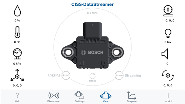

Bosch Virtual CISS App
The more exciting part of the offering, perhaps, is the ability to use the Bosch Virtual CISS app to work with the CISS over BLE. In this way, there is no need to connect to the CISS physically to read sensor values although USB power is still necessary to run the sensor. It seems that Bosch are also working on a model of the CISS with an internal battery to allow for cable-free use.

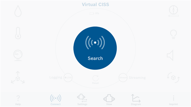

I had no problems installing the app via the Google Play Store onto my phone. Upon opening the app, we are greeted with this screen:
In order to begin using the app, we must search for and connect to our CISS device. Initiating the scan, my Bosch CISS unit with the default name has been found.

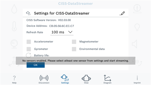

Once connected, the sensors need to be configured. Report intervals and sensors active can be configured – in fact, the CISS also permits disabling the BLE radio entirely, but the CISS Gateway package does not currently expose any of this functionality.

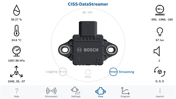

Once the sensor is configured, it won’t seem to be doing anything. That’s because we need to put it into streaming mode first.

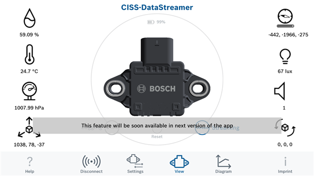

Once in streaming mode, the values for the sensors will show on screen. Unfortunately, logging is not implemented in this version of the software and appears to be a requested feature judging by the reviews on the Virtual CISS app.

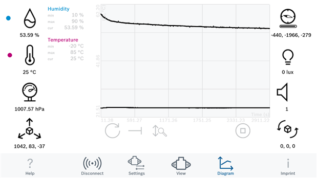

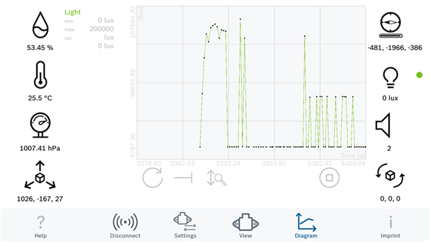

In the diagram view, we can get a plot of the values over time which can be scaled by pinching in the graph. Plotted values can be changed by pressing on the icons on the sides to add or remove them.
The app itself is quite a basic app without the ability to log, but it does serve to allow you to remotely connect to and visualise the data coming from a CISS sensor in real-time and over the shorter term. It’s also good for testing and checking that your CISS sensor is working, although for more serious applications, it would probably make better sense to write your own app.
