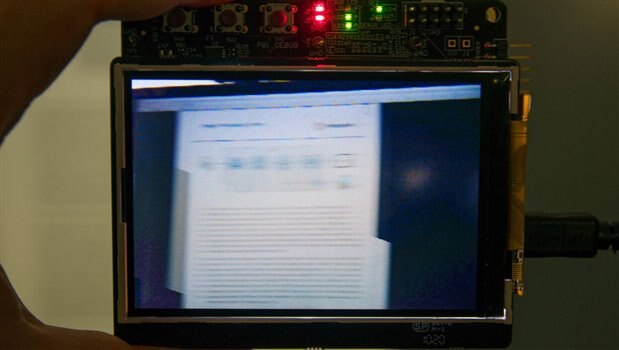

The second demonstration is a simple video processing demonstration which allows for slider control of brightness, contrast and colour levels. While this was more exciting as there is something to see and play with, functionally it did not seem all that complex to me as it is a mixture of mathematical operations (scaling, interpolation). But if there was something I noticed, it was diagonal tearing of the image on the LCD as if things were not well synchronised between the camera and LCD. Whenever the camera was panned, a clear diagonal tear line was visible on the LCD. Perhaps this is because processing is not done based on having a full frame-buffer and instead done live on dual-ported RAM? The demonstration also had a habit of going "green" when areas of the image were overexposed. This isn't what I'd expect to see from a real product.
