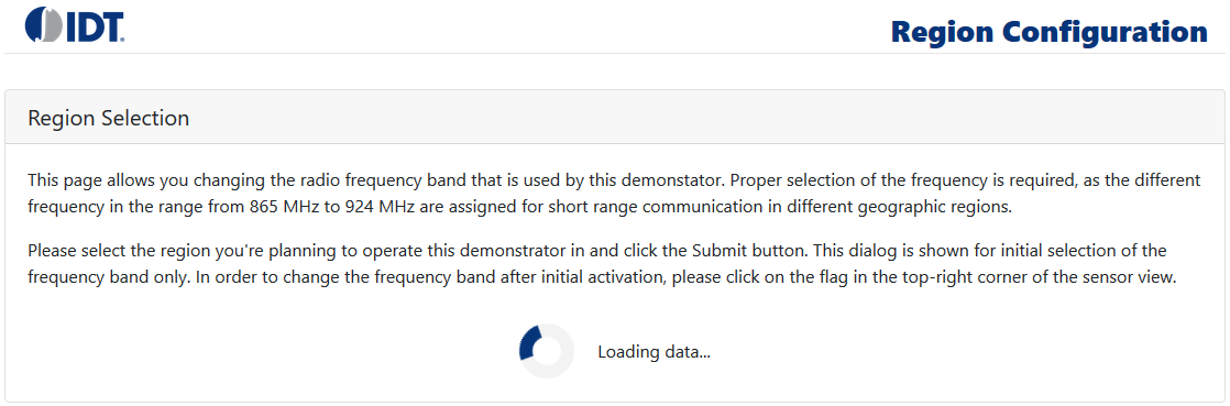

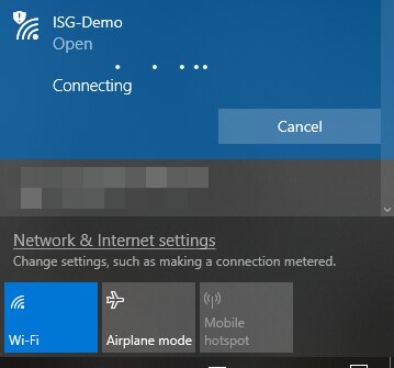

The setup process begins with plugging the power supply into the wall and the hub into the power supply, waiting three minutes for the system to complete the boot-up process. At this time, an unencrypted Wi-Fi network named ISG-Demo will appear.

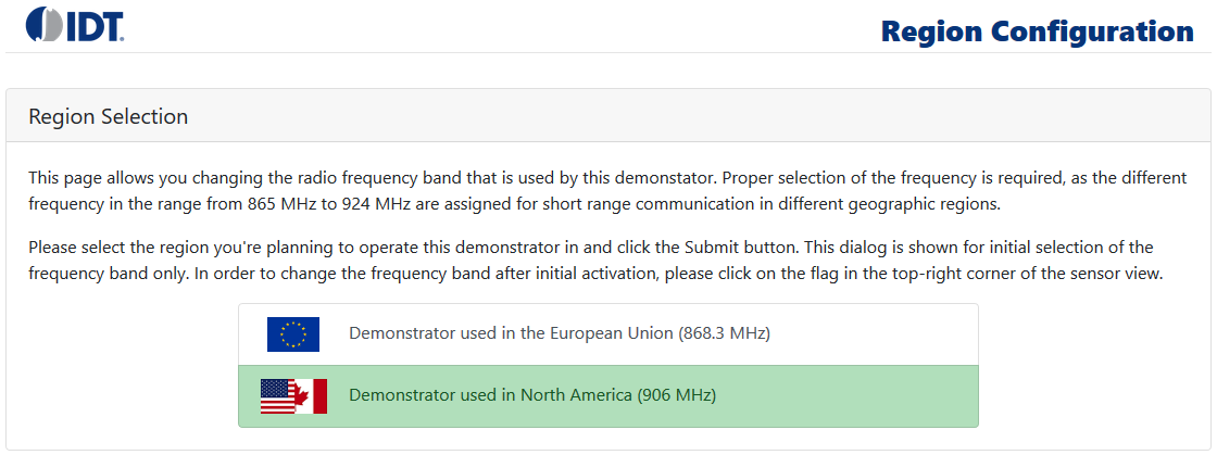

Once joining the network with a computer or mobile device, navigating to http://demo.isg will load the home page. As the unit has never been set-up, we are prompted to select either EU or US region. Note that there are only two selections (more about this in the Radio Testing section). Applying this setting can take half-a-minute or so.

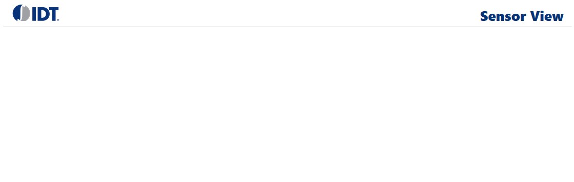

By now, you reach the home screen, which is likely to be blank, as follows.
This is because no sensor cube has registered with the base. The other menus are accessible by hovering over the top.

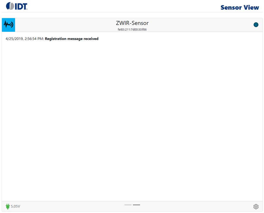

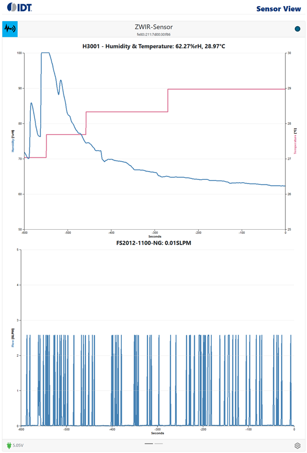

Plugging in another power supply into the wall and plugging it into the cube with the power source set to USB will allow the sensor to connect and data plotting will commence. The sensor graphs can be zoomed in and out with the scroll wheel, with a maximum plot time of 600 seconds.
Interesting to see that they even have the model number of their own humidity and temperature sensor wrong - it should be HS3001 rather than H3001.
Toggling to the second page on the Sensor View shows the list of events.

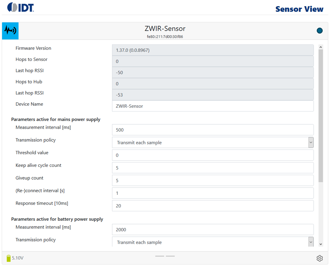

The sensor settings can be configured using the cog button, which allows for renaming the sensor and setting the transmission policies for USB and battery operation. When operating by battery, the plug icon is replaced by a battery icon.

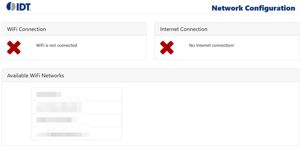

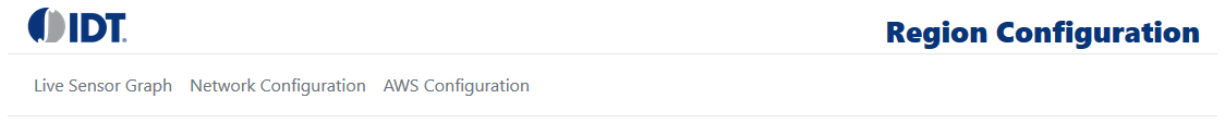

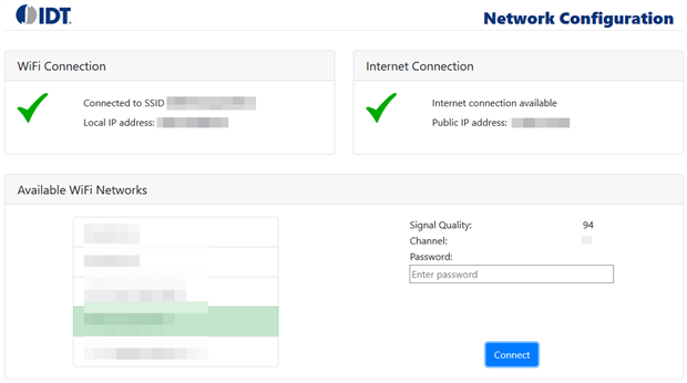

The Network Configuration page shows the network connection status and allows you to configure a connection to a Wi-Fi network with internet access. This is necessary for the AWS system to work and also allows for accessing the HTML pages via your own network.imageimage

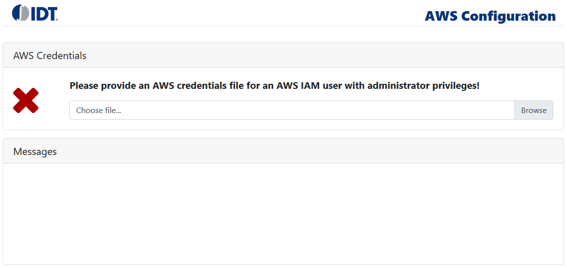

Finally, there is the AWS configuration page which is used if testing the AWS capabilities. As this review is not concerned with the AWS functionality, this page was not used.

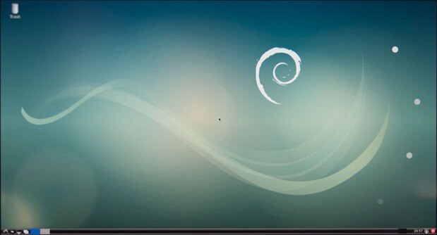

Of note is that connecting the hub to a display and keyboard/mouse does not provide much that couldn’t otherwise be done via the Wi-Fi. The unit boots into a plain graphical desktop with no special IDT-specific programs installed that I could see. There is an installation of NodeRED but there is no flow pre-configured. Use of the device head-less is all that is necessary – there is really no need to attach a display or keyboard/mouse.

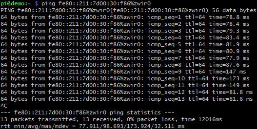

One of the advantages of 6LoWPAN is its “transparent” IP-based nature. In order to test this, I decided to try pinging the sensor. Initially, this did not succeed as it turns out that the radio needs to be in “always on” mode (e.g. powered via USB) for this to happen and the ping needs to be addressed to the IPv6 address with the link identifier appended (%zwir0).

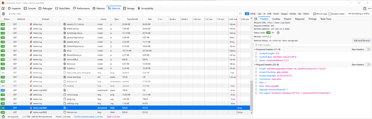

It seems that autobahn-python is used to serve the data as a Websockets server running on port 8888.

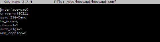

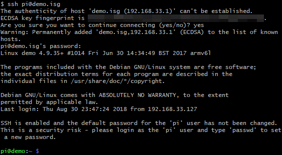

Care should be taken with the services running, as the SSH still uses the Raspberry Pi default credentials.
This seems particularly dangerous, as even after joining the unit to my personal Wi-Fi, the unencrypted ISG-Demo continued to be broadcast and could still be accessed. If the SSH credentials were not changed, there is a potential for the system to become a network relay. I suggest changing /etc/hostapd.conf from the illustrated defaults to add a password.

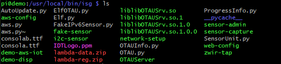

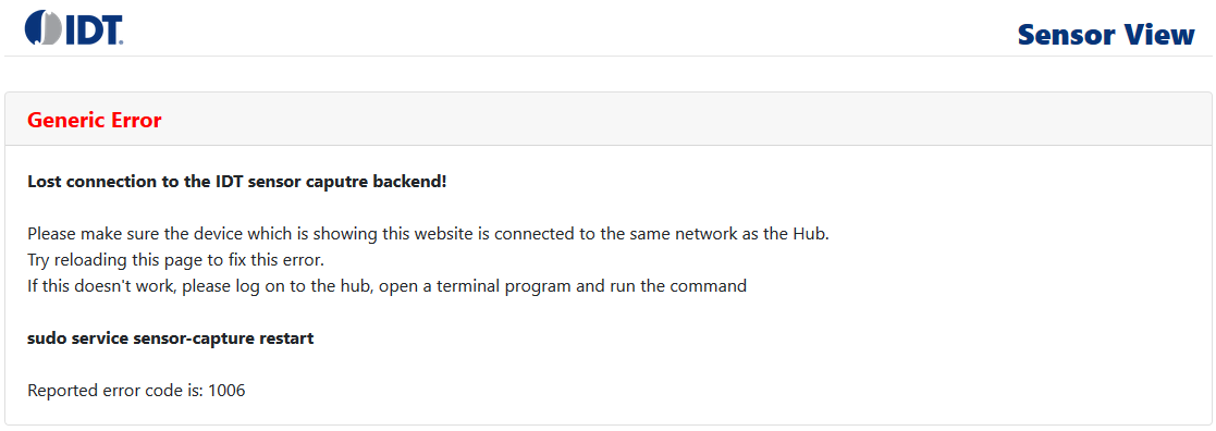

With the provided HTML interface, there is not much that can be done with the data as a plot of only the previous 600 seconds of data can be made. As a result, I decided it would be worth exploring how to export the data from the sensor. This led me to find a number of important programs in /usr/local/bin/isg including the main sensor-capture program. By modifying the sensor-capture Python program, I added a UDP output of the raw sensor JSON to my desktop allowing me to capture the data from the demo kit without using the Amazon AWS connection.
Modifications will require a restart of the service with sudo service sensor-capture restart, although if you made a mistake, the service may not be able to start resulting in an error displaying in the HTML interface. Instead, it may be worthwhile to run the process interactively in the terminal so that exceptions are printed. Note that the word "capture" is misspelt in this error message.
