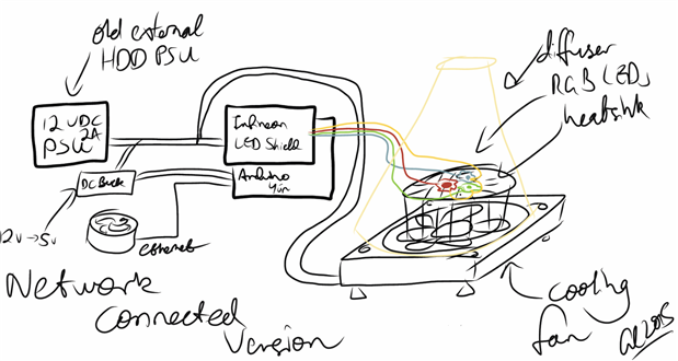

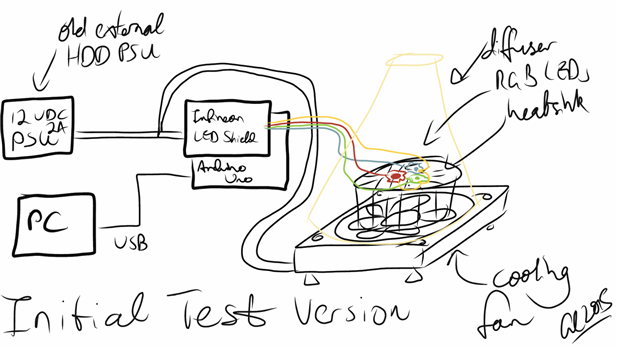

Several key points needed to be kept in mind:
  • The Infineon shield natively supports up to 700mA per channel. In reality, this means you should use LEDs with 700mA or greater forward current ratings to ensure that even when the maximum brightness is mis-configured, there is no way the LEDs would be blown. I suppose, with appropriate care, you could use lower current rating LEDs if you ensure that your dimming values are set correctly.
  • With 700mA of drive current available, it doesn't really make sense to run low-current 20mA 5mm LEDs. You would need at least 35 of them in parallel to sink the 700mA current, and then you have issues of ensuring current balance (e.g. via feedback resistor) to ensure that you don't get one LED taking the majority of the current.
  • The voltage, however, is more flexible with the shield being able to run off 6 to 48V DC. Because of the buck DC-DC architecture, your input voltage must be at least 2V greater than your output voltage. Having more input voltage than is strictly required isn't much of a problem as it is "transformed" into output current. The outputs are strictly current-driven. As a result, in order to get your 100W (33W/channel) output, you would have to series-up enough LEDs to equate to 46V voltage drop, all of them rated at 700mA, with 48V into the shield.
  • If you don't care about getting the most from the shield itself (and believe me, 100W of LEDs is expensive and a heat problem), then you can choose to drive less LEDs. In my case, I settled on one LED per channel, 700mA current rated or higher. Commercially, these would often be marketed as 3W LEDs, so I'd have a total of ~9W of LEDs. Because the voltage drop of a single LED is not very great, you can probably get away with running at 6V input, but since I had a 12V 2A power supply left over from an old external drive, I decided to use that. As the PSU's capacity is 24W, that's plenty more than the LED consumption, meaning that we have some room to run the Arduino Yun and a cooling fan as well from the same PSU.
  • LEDs get hot - at 700mA, you can expect your "average" 3W LED to put out about 1.5-2W of that in heat. If you don't get them some sort of heatsink, they will overheat and damage themselves. As a result, I decided to grab a heatsink as well - but you will need to think about size, shape and customizing it too.
  • Using a 2W per LED figure, the array is likely to put out about 6W of heat. As LEDs run best below 85 degrees C, with an ambient of 25 degrees C gives a thermal rise of 60C. As a quick back of the envelope, your heatsink needs to have a thermal resistance of 10C/W (or 10K/W) or less to ensure the LEDs don't overheat. That normally means it's not going to be some thin metal stamped unit. In reality, it will need to have a thermal resistance slightly less, because the junction to case, case to MCPCB, MCPCB to heatsink junctions all contribute additional thermal resistance which you need to account for.
  • You can significantly improve the thermal resistance to ambient if you use a fan with your heatsink - while I might not need it, I decided to go with one for additional safety margin. Running LEDs cooler will result in a higher lifetime.
  • Buying LEDs on bases or with easy to mount packages is generally advisable, otherwise you will have to devise ways to do surface mounting of the LEDs with the additional challenge of thermal management of the LEDs. Many of them cannot be sensibly mounted to regular PCBs and need specialized aluminium core MCPCBs to ensure the heat can be dissipated fast enough.
  • Staring at these bright LEDs directly is potentially going to cause you eye damage - so something to diffuse the light, and combine the light to create a homogenous colour is necessary. For now, I've just settled on a sheet of paper, wrapped around into a "cone" shape.

Getting the necessary parts was a great cause of delay, with a little more than one week spent waiting for backordered parts from element14 to arrive. But since they all arrived just this week, I could finally prepare the hardware and get it to a stage where I can confirm the hardware actually works.

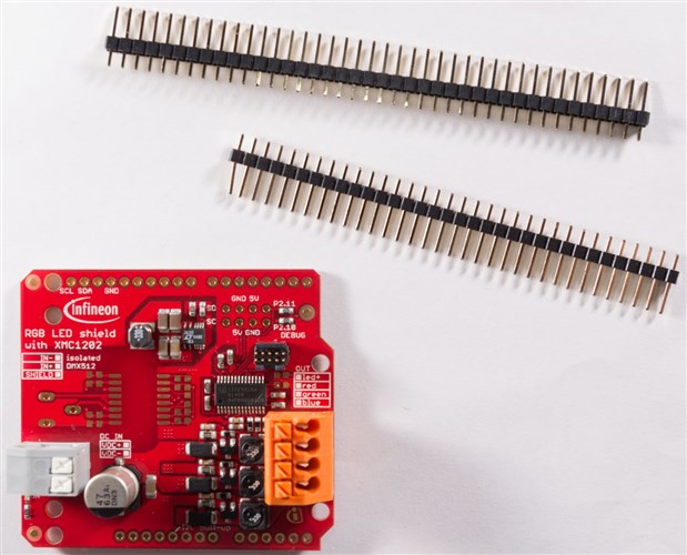

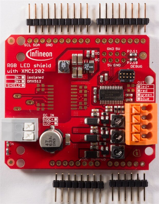

The Infineon shield comes "naked" and the first thing that you will need to do is solder on some header pins to make the connection to the Arduino. In general, I would recommend tall stackable header pins, but since I didn't have any on hand, and I was pretty eager to get going, I decided to grab some spare standard header pins I had spare.
With the header pins, it's pretty simple to snap them to the right lengths in preparation for soldering.

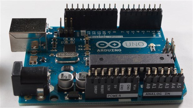

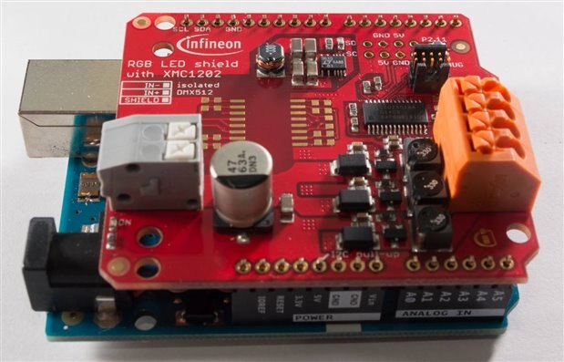

It's at this point that many novices make a mistake - they try to solder the pins on with the board standing free and then find that their pins are skewed at strange angles and don't want to plug into the board. As a result, here's a tip that I've heard - you should just plug the pins into the Arduino itself, using it as a holder, then you put the board onto the pins.
People with more advanced soldering skills can go on and solder all the pins in sequence, but more novice people should just solder the end pins on each header segment, remove it from the Arduino and then solder the rest of the joints to avoid overheating the header sockets on the Uno and damaging it.

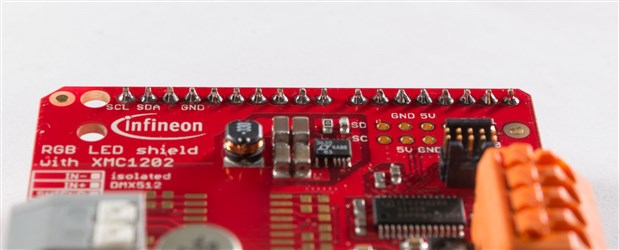

Because of the nice ENIG finish on the PCB, and the red solder resist, the board is very easy to solder to. The joints look pretty good for hand-done image.

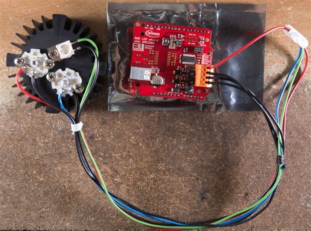

Now, the more difficult task of preparing the LEDs. The LEDs have very intricate internal grid structures and wire-bonds - it's quite nice to look at.

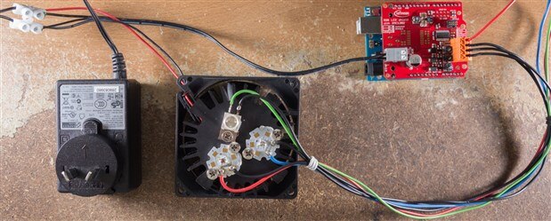

I didn't take pictures of the initial stages, but suffice it to say, it's necessary to solder leads to each LED unit first. If mounted to the heatsink, the heat from the iron will be drawn away and it's not possible to make good joints. Once leads are soldered, the heatsink has to be marked out for drill holes, the holes drilled, thermal paste applied, and the screws tightened to secure the LEDs on the heatsink. Then the wire connections can be made - for something that looks something like this ...
I didn't pay attention to my own diagrams, so I totally forgot this connection scheme is common anode. I colour coded the anodes nicely, but for no good reason! I used a terminal connector block to common-up all the anode leads. The connection blocks on the Infineon Shield are of a type I haven't ever encountered before, and using them is a bit of an unusual experience. Provided you strip the end of the wire, insert it in far enough and push down on it, a connection is made. Unfortunately, I'm not sure if the connections can be undone afterwards - so consider these "one shot" punch-down blocks. If worst comes to worst, I suppose the connectors can be de-soldered.
The final step is to prepare the power supply leads, and fan leads - another terminal connector block is used to make the wire connections for additional flexibility in reconfiguration later.
Add a USB lead, and now we're ready to prepare the PC-side of things.

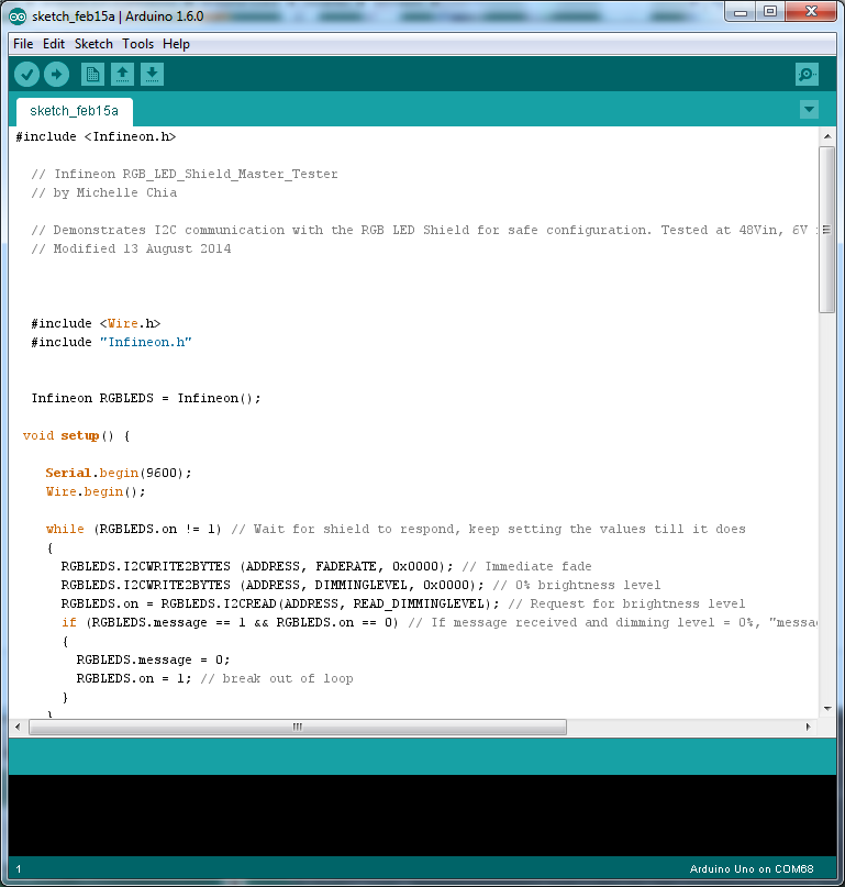

I hadn't updated my Arduino IDE for a while, so I downloaded the latest version and unzipped it. It's necessary if one is to have any chance of programming the new Yun later on. The IDE still cosmetically looks the same as before. I then downloaded Robert Peter Oakes library from here and unzipped the files to a new folder called Infineon under the Library folder.

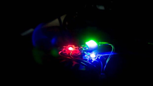

I ensured the board was powered - the Uno via USB, and the LED Shield via the 12v DC PSU. Opening the IDE, copying the code in the RGBLED.ino demo file into a new sketch, allows you to compile and load it onto the board for a test to see whether it works.
The sketch begins running immediately upon upload - success! It works! We see first light from the LEDs.
Here's a quick (not so very nice) video of the endless loop running with a sheet of paper as a crude diffuser.

    clem57 - now that you mentioned it, I did notice that the 5vDC and GND pins (not pictured) were slightly different to solder and this has to do with the fact that the PCB has a ground and power-plane.…

    clem57 - now that you mentioned it, I did notice that the 5vDC and GND pins (not pictured) were slightly different to solder and this has to do with the fact that the PCB has a ground and power-plane. That does make the soldering a tad more difficult, especially with a fine iron tip (as I was using my Tenma Rework station just out of habit), so I probably didn't do the best job there.
    Most of the other pins are just "dead" in the sense they are not-connected to anything on the shield, so the pads heat up nice and quickly and the soldering is done with ease. The power pins are connected to large copper areas which suck away the heat from the soldering iron tip, making it a little more challenging to solder. The two GND pins, although next to one another, aren't separated into "donut" pads with a thin-trace to the plane (likely to ensure the lowest resistance connection) so it sucks the heat away - using a donut pad with thin traces was a way to make them a little more "solderable" as the thinner trace doesn't pull the heat away as much.
    If you were referring to the pins above the debug port silkscreening - that's more of a human imperfection on my part with feeding the solder into the tip. You know, shaky hands image.
