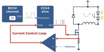

The board itself uses a buck converter architecture, but the actual details as to its implementation only become clear with further examination of the board manual. In this posting, I will excerpt many relevant block diagrams from the manual - these are made by Infineon.
Each channel has a topology as shown above, somewhat simplified. The top part forms the current freewheel loop, with a sense resistor to ground and a MOSFET to control the on-part of the cycle and provide feedback. The current control loop has a counter which controls the off time and can be configured, and the reference current value can be configured to accommodate different forward current needs. A sigma delta block generates the pulse-density modulation which is combined to drive the MOSFET.

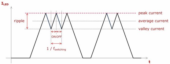

Because of this control loop, there is a problem of stability and propagation delay - which is why some optimization is required to ensure the best results (i.e. less overshoot, lower ripple).

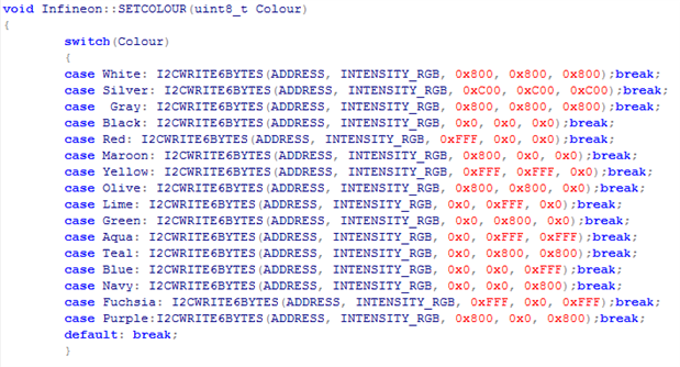

Of course, part of the optimization process involves setting a given colour channel to fully on. You can use RGBLEDS.SETCOLOR, but be warned, as red and blue are the expected values, green is not 0x0fff for the green channel! It took me a moment of going through the library to work out that you need to use Lime if you want 0x0fff on the green. Alternatively, you can just directly specify the R, G, B values, with a dimming value of 0x0fff to ensure they get passed "as is" to the channel.

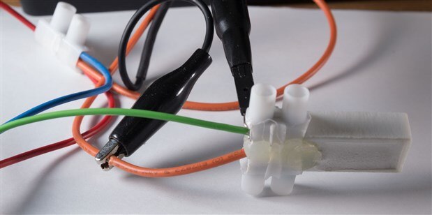

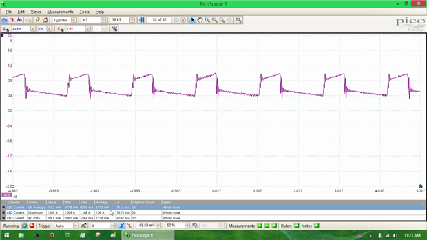

Of course, to do the optimization, you will need to have a current probe and an oscilloscope. I decided to use the Picoscope 2205A that I had been awarded in a prior RoadTest as the oscilloscope.
In a hack, I grabbed a spare 0.1 ohm wire-wound resistor from the shelf and added some terminal connector blocks to it. I'm sure the more experienced guys will be jumping up and down right now going don't do that - and I know what you're thinking. I just had to do it for myself to see why.
For those who haven't had the lightbulb moment, the problem is that wire-wound resistors are themselves inductive and will severely affect the operation of the circuit by adding inductance to the system. Also, not to mention, the thing has 10% tolerance for values. Initially, I thought that it would only induce a small error into the result, and it would be better to get a reading than none. I filmed a whole video, and in it, we get rather strong ripples and strange behaviour. I didn't expect it to be that bad. This is a frame grab from the original video.
Of course, there was no way the shield was performing this poorly after optimization. I really needed to get a non-inductive shunt of some sort. I scoured my room for some composition resistors, and I found 11 metal film type 1.1 ohm 1% precision resistors. Whacking them all in parallel for another ugly hack, and we have a 0.1 ohm shunt with a (likely) <1% tolerance (statistically speaking).
If you looked at the topology above, you might just think "why not measure across the feedback sense resistor?" The thought did occur to me, but there's actually an issue. If you look at the PCB itself, the sense resistor is paralleled with a capacitor to smooth out transients and stabilize the feedback system. As a result, it's not possible to capture the ripples accurately if you use the feedback resistor, and you won't capture the freewheeling current part of the cycle either.
There's another complication with measurement as well - as the Infineon's power supply ground is connected to the Arduino ground, and the Arduino ground's connected to the USB ground, and the USB ground is connected to the Picoscope's ground, to perform the measurement would require using ground as the ground, and measuring one side of the resistor with Ch A, the other with Ch B and doing the subtraction, multiplication (for scaling) to get your values. This is possible, but not my favourite way.
I decided to get lazy, knowing the potential difference is 12v with 2A current (from the limited power supply), so I used a laptop with the PicoScope, unplugged from the mains, and not plugged into the Arduino either, so it was operating floating. I connected the ground of the Ch A to the 12v + side of the LED drive, and the negative side to the other side of the sense resistor so it would read an inverted value. This was done purely out of habit - I could have hooked it up the other way, but I generally like having either + or - as a ground, rather than an intermediate node. I set up the Math channels to read -10*A to provide the current in Amps.
In fact, it was such an interesting experiment on its own that I spent the time to recreate the video with the less-inductive resistors after I had spent a few hours uploading the first one with the inductive resistor problem. This one is a little more concise, but leads you through the optimization process and provides some basic measurements of waveform frequency and modulation which is related to flicker. I hope you enjoy, and it comes in useful. You might want to view this one full-screen so you can read the values.
After I had hand optimized the channels, I made a few discoveries which corroborate well with the lessons taught by the manual. For one, if your input voltage is > 4x the voltage drop of the LED, you will have difficulty achieving good ripple performance. This was an issue to some extent on the red channel, where according to the datasheet, my LED was specified for 2.5v typical forward voltage drop at 1000mA (less for 700mA of course). The values I got for the green and blue channels were fairly similar, and on checking, their forward voltage must have been as well with the green specified for 2.7 to 4.25v at 700mA, and the blue specified for 3.3v typical at 1000mA. The final measured ripple values were about 30-50mA, which corresponds to a ripple percentage of 4% to 7% which is generally considered good! I suppose 12v would better suit pairs of these LEDs in series.
The shield is capable of driving almost any LED current value up to 700mA, but because of the ripple, it's not advisable to use any LED with less than a 350mA forward current rating, as the maximum current could be exceeded during optimization to the point of damage. Safe values from the datasheet are actually lower than the ones in the sketch, so it may pay to replace the values in the sketch with the ones in the manual first before trying it out.
All in all, I was able to show that the worst case flicker is a 1khz flicker at the lowest brightness - well above the flicker fusion threshold. The ripple from the buck topology was reduced to nearly insignificant levels, and itself cycles at 2.2Mhz which is exceptionally high.

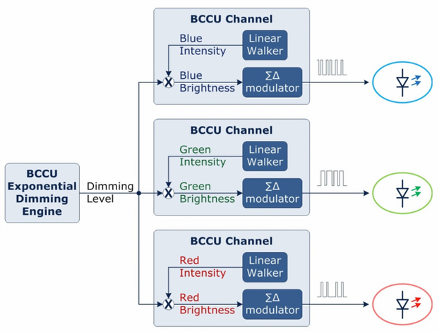

In fact, you probably don't even need the first three, as INTENSITY_RGB can perform the same function. WALKTIME, DIMMINGLEVEL, FADERATE are global to all channels. CHANGEADDRESS is only necessary if you wish to run several boards on the same I2C bus, or you have a conflict of address for some reason. Full details are in the board manual, of course.
The global dimming level function deserves a little mention here - it's an interesting function because it's exponentially weighted, and it affects all channels at once, allowing you to keep a constant colour while reducing the brightness by scaling each of the channels by the global dimming value / 4095, so you don't have to do it by yourself.

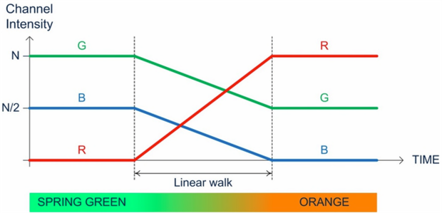

Another nice function is the walk-time which allows you to set the amount of time, in 0.01024 second units, that the board takes to transition to the next colour value.

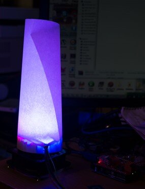

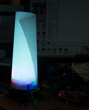

Needless to say, now I have a colour changing desk lamp which changes colour every 3 seconds to a random colour with a 1 second "transition" period (value 97 * 0.01024 = 0.99328s). I added a pad of white gauze over the LEDs which makes the colour mix a little better but does cut down on the light significantly. I might need to find some opalescent perspex or something better ...
