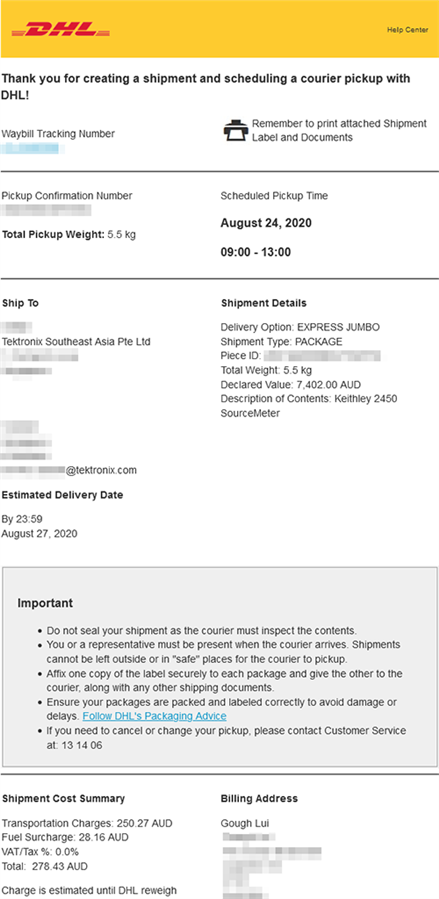

I mentioned in the previous post that shipping expensive items overseas can be a customs and courier-selection nightmare but I had settled on DHL after some research of my own.
The return postage, using the DHL Express Jumbo service cost AU$278.43, which I thought to be expensive but reasonable given the “hassle” involved with such shipments. As promised, the pick-up driver turned up on 24th August 2020 in the appointed time-window to inspect, seal and pick-up the SMU.

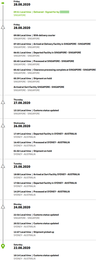

The package sat in Sydney until 26th August when it finally found some capacity on a plane – air cargo demand frequently outstrips supply due to the COVID-19 situation and a lack of international passenger flights. By 28th August, it had reached its (first) destination in Tektronix Singapore – five days from door to door, which is not bad given the circumstances.

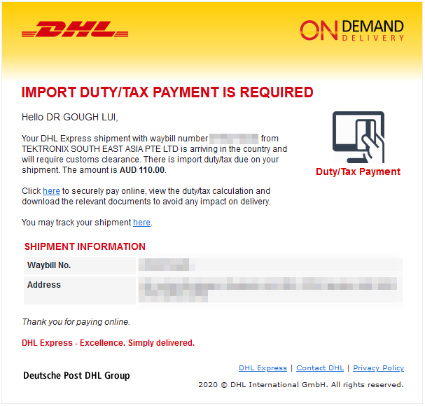

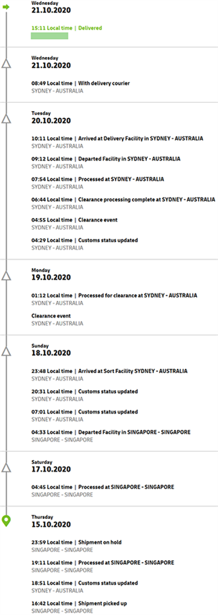

It wasn’t until around 14th October that I was again contacted to confirm my shipping address for the SMU’s return. However, the saga wasn’t over just yet, as the inbound customs wanted to charge duties on the package which caused a slight delay. After responding with the fact it was a no-charge warranty service return and the necessary paperwork, I was given a waiver on the SMU’s value, but the cost of the shipping service and paperwork fees were still due, costing another AU$110.00.

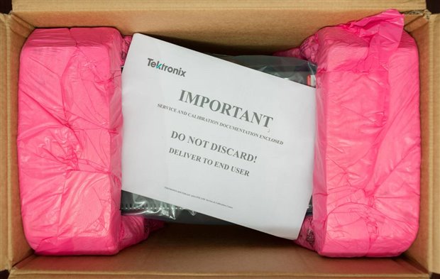

The SMU was returned into my hands on 21st October, spending 58 days out of my hands for the RMA process at a cost of AU$388.43. While this is not a typical RMA (due to the technicalities of RoadTest items and how service is handled for them), it was an experience nonetheless and I was relieved to see the unit back in my hands.
Unboxing & Preliminary Checks
The first thing I noticed was the unit was returned in a different box to the one I shipped it out in. I suspect the original box had seen enough torture, having been shipped several times already (from the factory to Keithley to element14 to me to Tektronix Singapore to Keithley). The pink foam end stops are also different – so I wonder whether they have several different packaging alternatives.

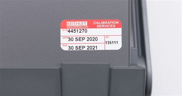

The document enclosed provides a statement that the unit is calibrated, with the specific procedure being named as “MANIFEST:Product_SMUs_2012-KE2450_Full VERSION:66”. The document does not contain any specifics regarding calibration data points and the before data is “not possible due to condition of unit.”
Visually speaking, the SMU looks the same as it did when it left (as it should), but it now wears a badge of its tour around the world –
The calibration date is marked as 30th September 2020 with calibration due in a year - thank you 135111!

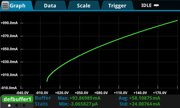

Now, for the million dollar question – did it fix the problem? A preliminary check consisted of me connecting a 25W 230V-rated “retro” filament light globe to the SMU’s outputs and running a very fine I-V curve over the range of 0-200V with 100001 steps, taking a few hours. This would be the closest load that would match the SMU’s 20V/200W output while also potentially provoking any issues within the 200V range.
I’m glad to report the modifications were successful and the unit is now capable of operating across the 200V range without the issues noted in the review. I also noted general improvements in the stability of readings from the SMU – where before I would see values jumping strangely as the unit changed ranges, this behaviour is completely absent after its return from repair and calibration. It seems the RMA process was worth the wait!

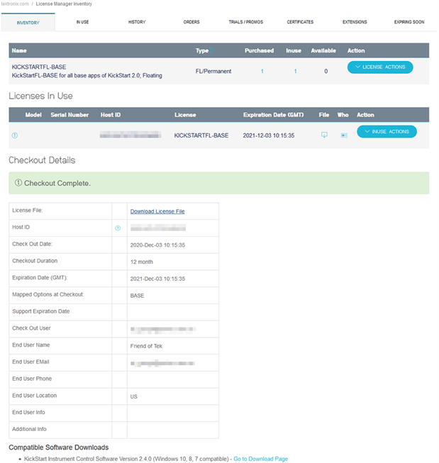

KickStart 2 Licensing & New Version

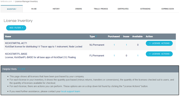

My original RoadTest involved the use of KickStart 2 in its 60-day trial mode, which had since expired. As a gesture of goodwill, Tektronix were willing (after we had sorted through the issues) to offer me a license for KickStart 2 so that I could re-run some tests and continue reviewing the unit after its return from RMA.

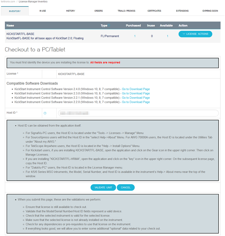

Interestingly, it seems that TekAMS has been completely revised since my review. Now, it looks much more in-line with Tektronix websites in terms of its visual style and it is a little easier to navigate. In all, I like the new look! In my case, I had the license populated into my License Inventory and I had to check it out with my Host ID.
Once the data is validated, you have a choice of license check-out length. I decided to set 12 months, but I think you can make it as long as 4-years. At the end of the period, you can check out a new license file, but I suspect it should help in case the license is bound to a machine that has a hardware failure – that way the license should “time out” and you can issue another.
Once that is complete, you can download the license file and install it into KickStart using the “key” icon in the upper right corner.

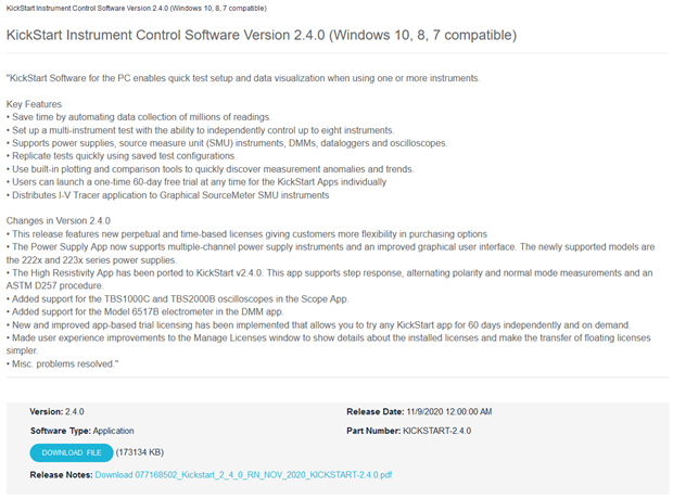

Since the original RoadTest review, there has been a new release of KickStart 2 as well which also teases the potential for time-limited licenses, along with a number of improvements. There are some outstanding issues noted in the release notes – one of which to do with the graph updating (needing to hit autoscale as points were not being plotted properly during subsequent runs) which I have run into, causing a minor inconvenience. But it’s good to see the software getting some active development.

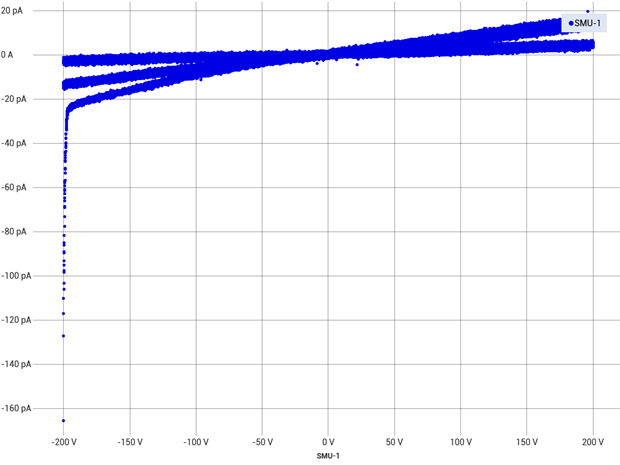

Putting the SMU and KickStart 2 to the test, I set up a dual-direction sweep from -200 to +200V in 100001 steps, repeated four times at 10 PLC with auto-zero ON and the SMU having nothing connected to its inputs.
I noticed that initially, there is some rather quick changes in the current readings – perhaps to do with warming-up and/or dielectric charging of insulators, but as the test progresses, the slope reduces. But if we look at the current magnitude – the maximum reading is in the range of 170pA, with subsequent runs easily sticking within +/- 20pA. Given the datasheet specifications for the 10nA range claims an accuracy of 0.1%+50pA for rear Triax connections only, this result with the front panel connections selected, open to the environment and the potential for noise, seems to be excellent!
