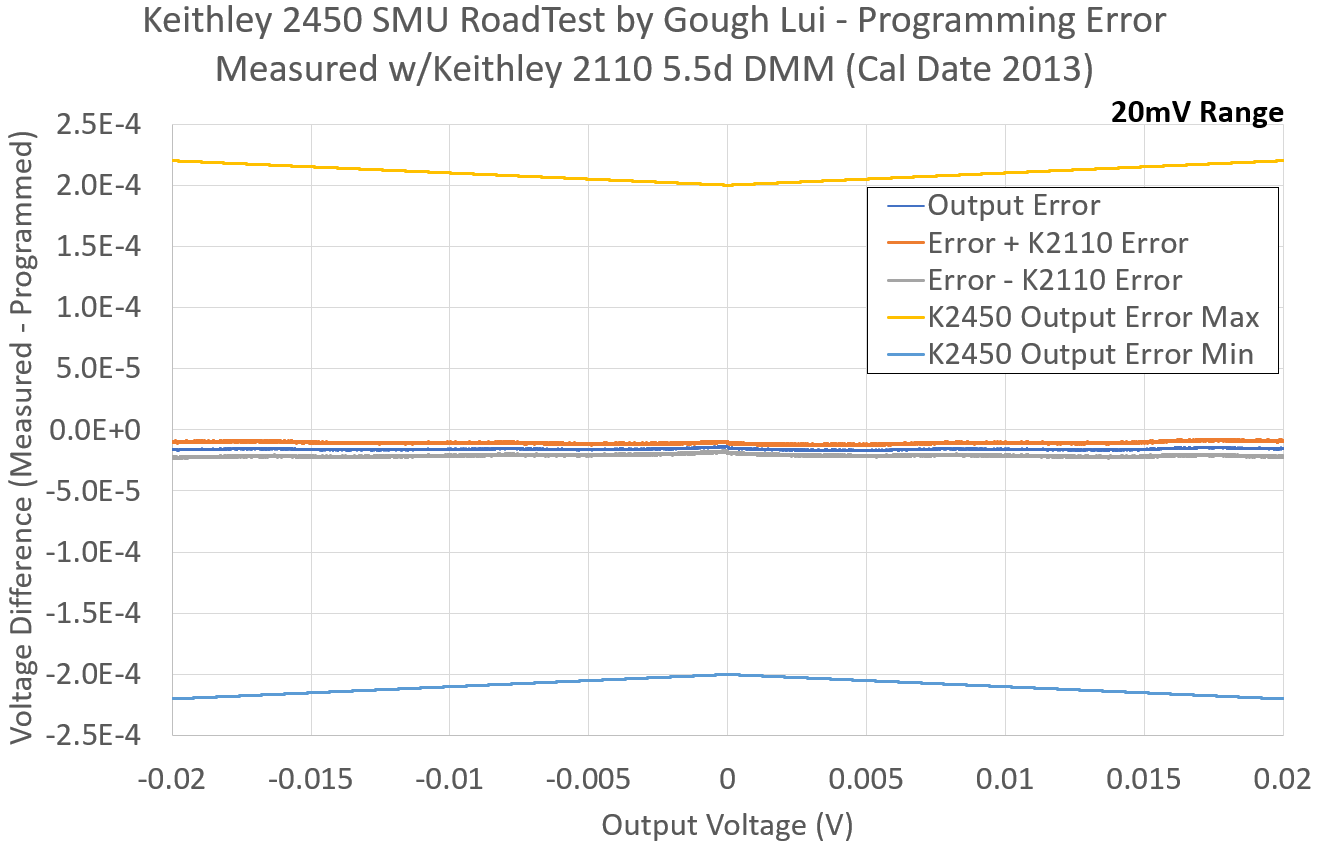

In the 20mV range, the 2110’s readings are again relatively flat and well within the 2450’s error margins. The reading is offset down in the same way, which is likely due to thermal EMF contributions (as the test leads were not anything special, although the temperature difference should have been rather small).

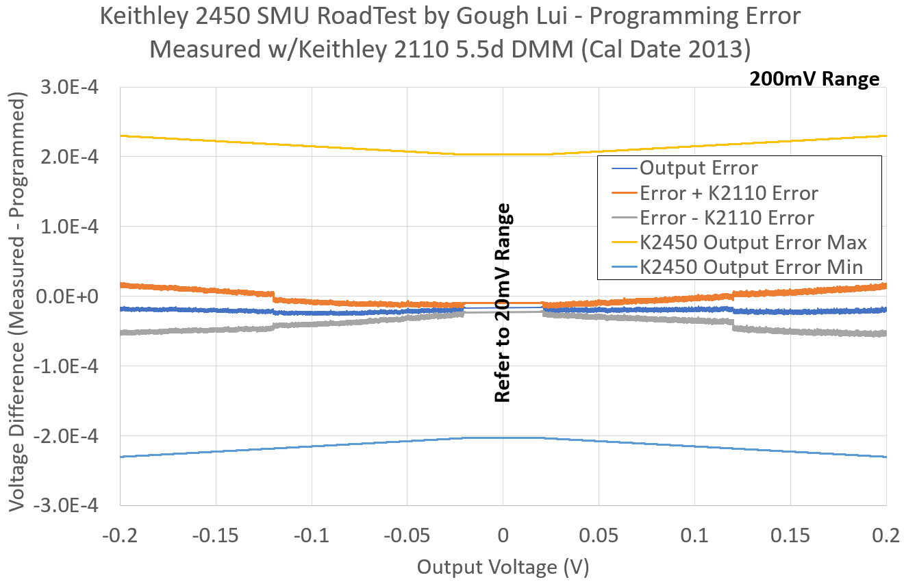

In the 200mV range, under this test, the readings are again well within the output error expected from the 2450, although the 2110 again shows a small offset. So far, the instruments are in agreement, at least to the extent of their claimed levels of accuracy.

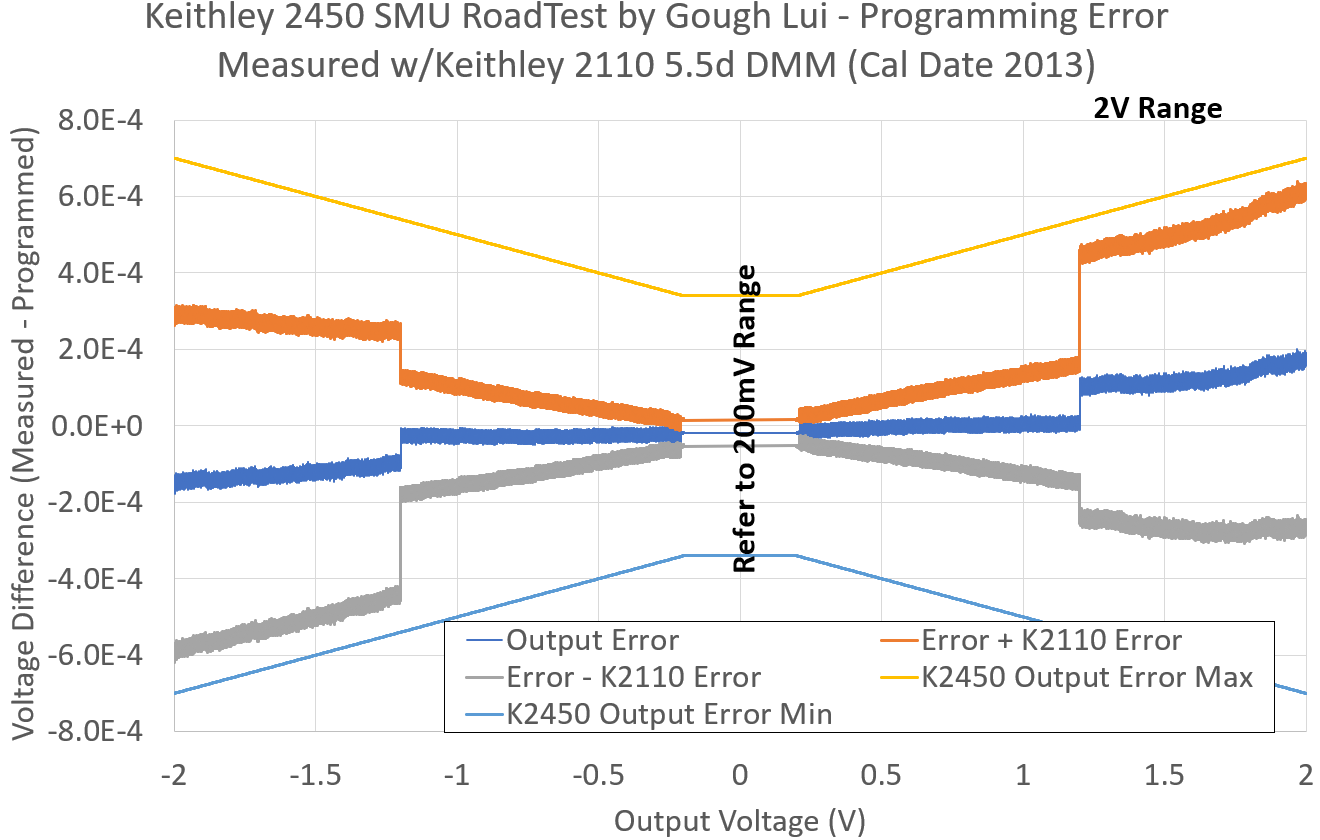

Stepping up to the 2V range, this time, the gain error “slope” is less pronounced compared to the previous test, but when considering the claimed accuracies for both instruments, this shows both to be within specification.

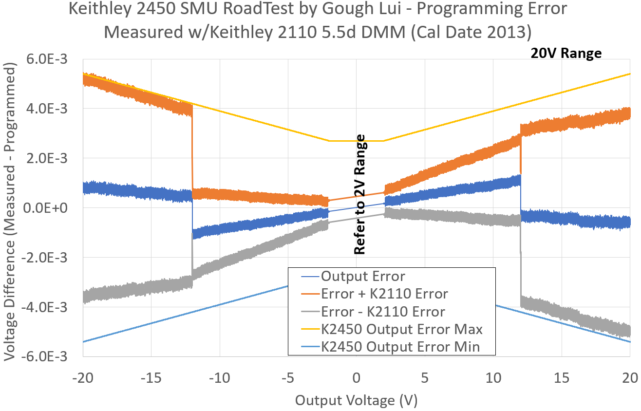

At 20V, a carbon-copy of the previous result is seen, although the negative portion upper error limit lines are now just about touching. This is not a major issue, as this still provides confidence both instruments are within their claimed accuracy. Perhaps while the 2110 may have passed its initial calibration, it may not have been as “close” to zero for error as it could have possibly been.

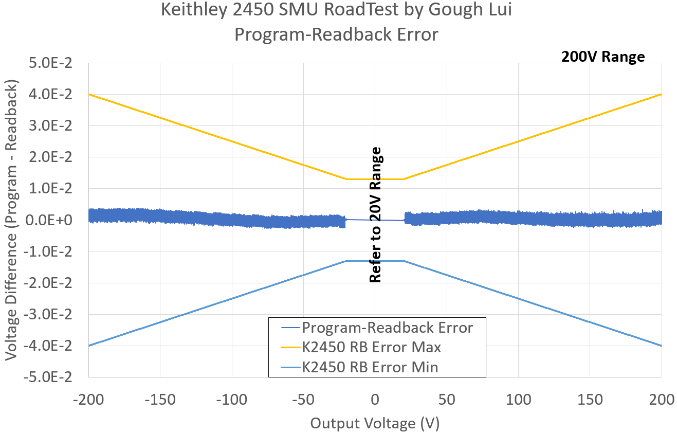

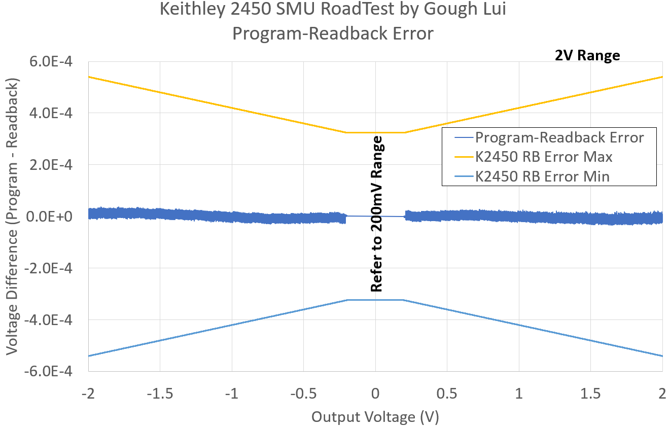

Combined Voltage Programming & Readback Accuracy
Combined programming and readback accuracy tests are performed with the 2450 generating an output and measuring that back, so are an accumulation of both programming and readback error.

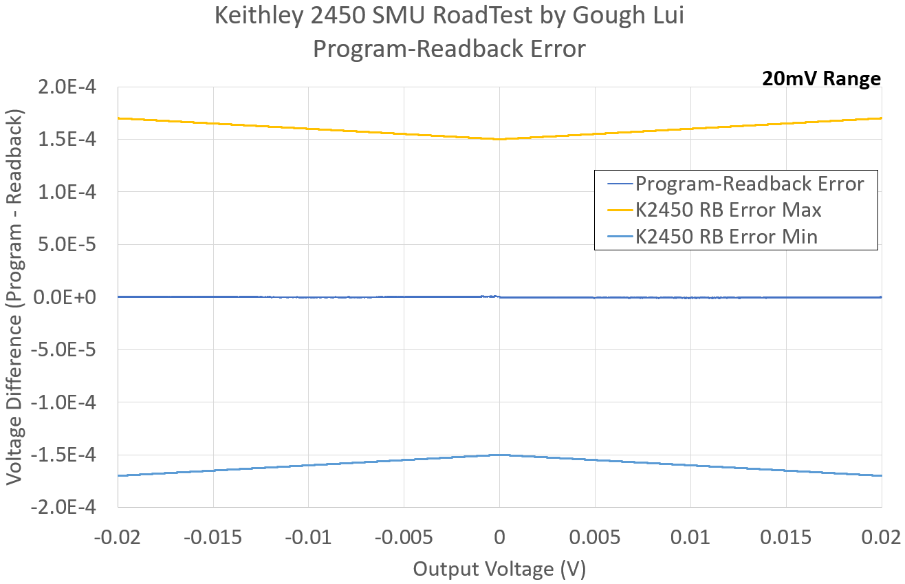

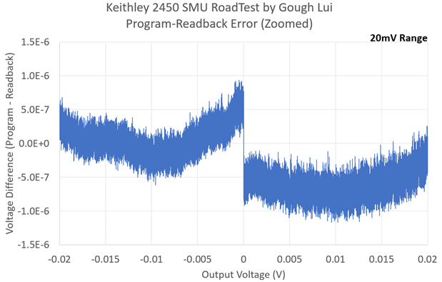

The 20mV range shows very small levels of error, with the errors within about 1.2uV. The reduced spikiness compared to previous tests may be due to the “averaging” effect of 10PLC measurement.

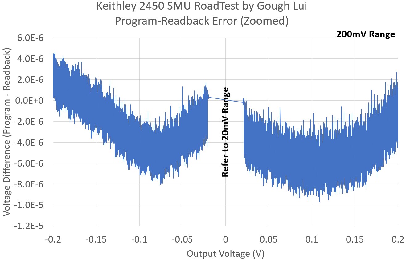

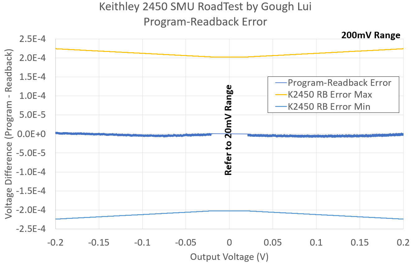

The 200mV range is well within the expected error with a slight curve to it just as before. Error is within about 10uV. The previous curve exhibited a small bump while this curve is more smooth – perhaps this is the effect of thermal changes in the test room.

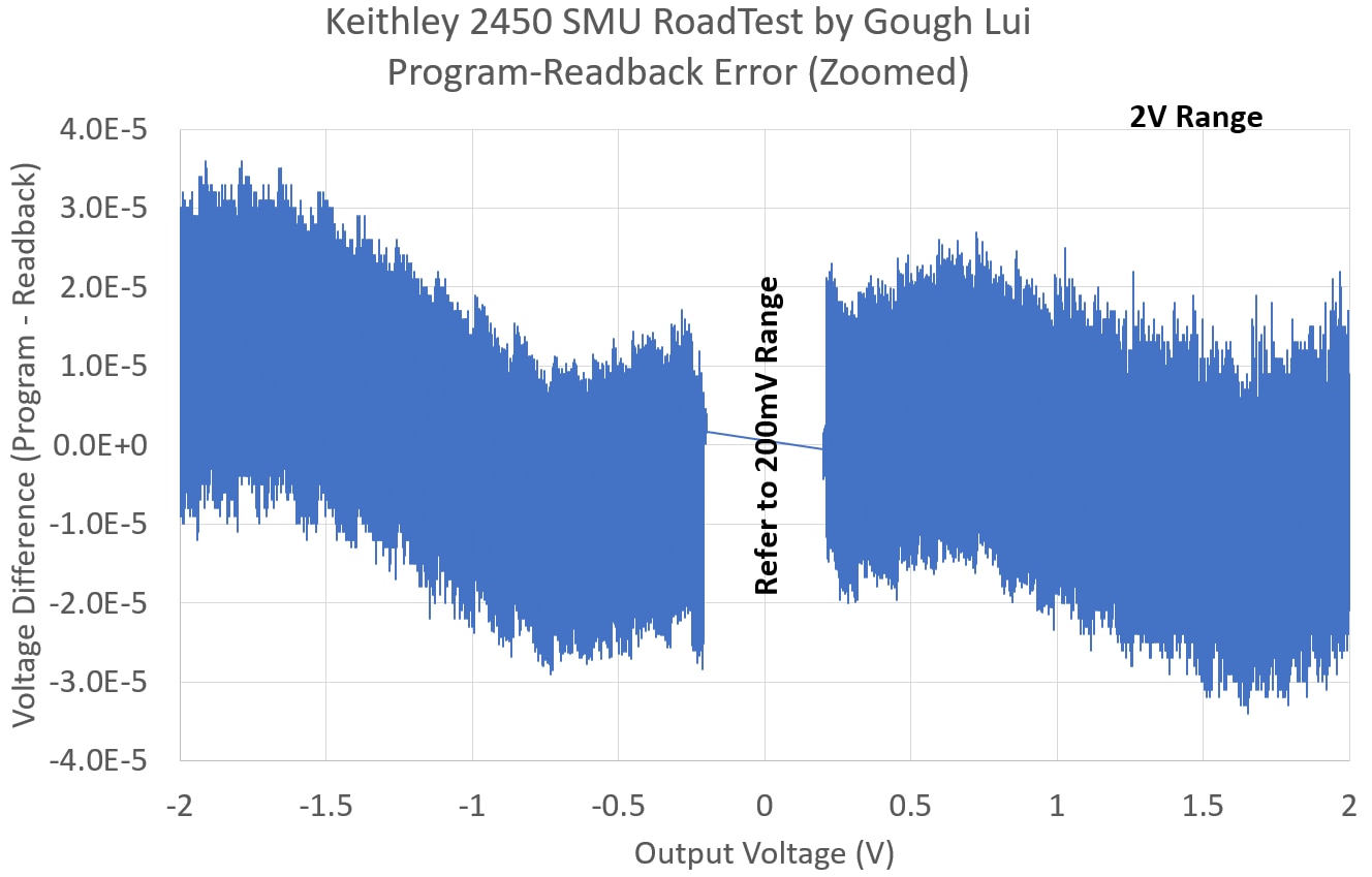

At 2V, the results again impress, showing the error to be well within the specifications. When zooned in, the “wavy” error characteristic shows a deviation of about 35uV.

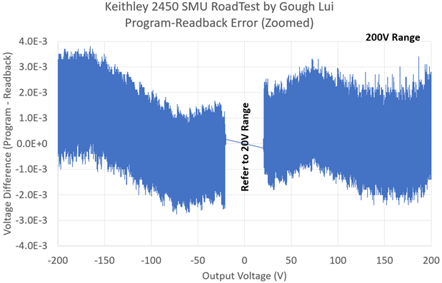

Finally, in the 200V range, the error reaches about 4mV. In all cases, the combined programming and readback error of voltages is less than the readback error value alone, meaning the instrument is likely to be more accurate than stated on the datasheet as tested. Most reputable manufacturers are conservative to account for changes in environment (e.g. power, temperature, humidity, drift, worst-case calibration errors), so this definitely shows. But the results seem consistent with prior tests which is good.

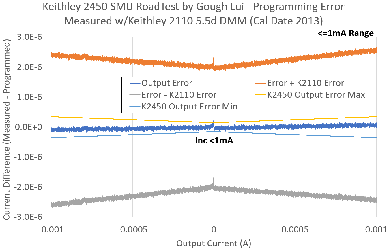

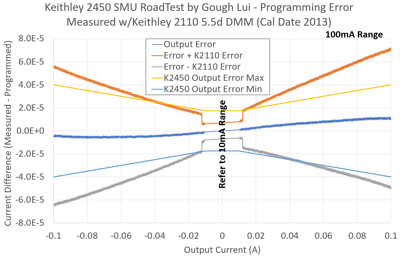

Performing the same tests for current, but only in the ranges where the 2110 would have enough resolution, we start at the 1mA range. In this test, around the zero-current area, there is a slight deviation on the negative side which wasn’t present in my initial test, but given the broad error of the 2110, the result is inconclusive. Most of the reading difference value sits within the 2450’s programming error specification, which is a great outcome.
In the 10mA range, a carbon copy of the previous test results is seen with the same sloping offset, although the magnitude of the slope has reduced from ~1.8uA of error at 10mA to ~0.9uA of error at 10mA. This could be thermally related or a difference in calibration but again, the error of the 2110 is greater than the 2450’s specifications, so the test is inconclusive.
Testing at 100mA showed a slight “curve” to the reading difference line, but no significant differences from the prior result, which show the instruments to be likely in agreement.

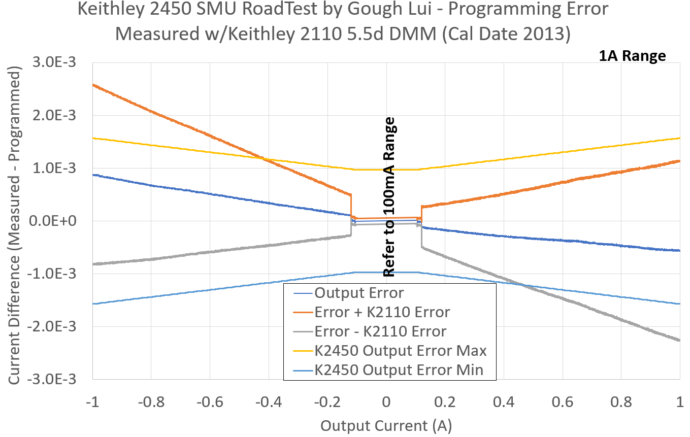

In the 1A range, the gain error of the 2110 shows itself quite clearly, but almost identically to the previous test. Again, this implies the calibration before and after repair are consistent. The margin of error for the 2110 encompasses the zero-error line in all cases, so despite the noticeable disagreement, the instrument is still within its claimed error specifications as a “basic” 5.5-digit DMM.

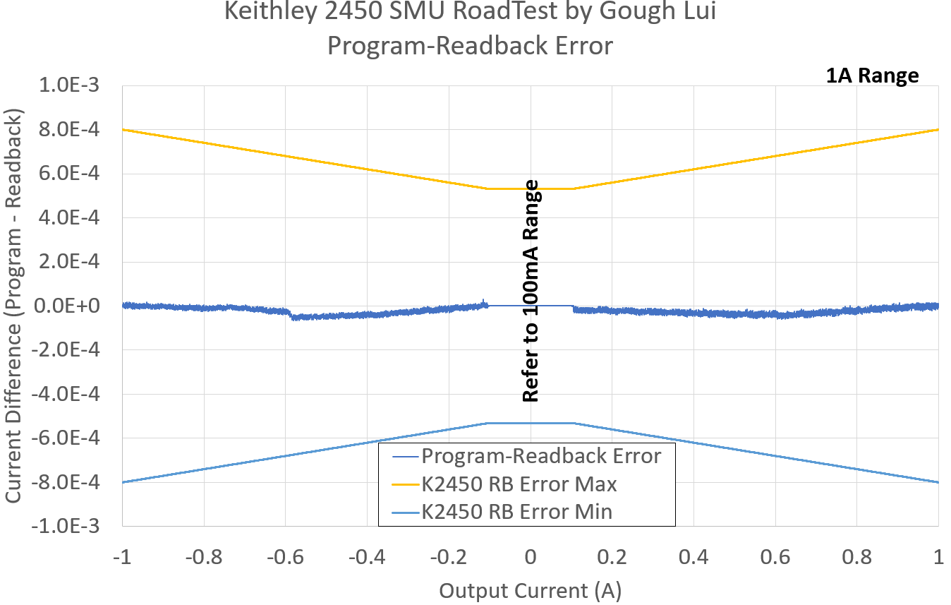

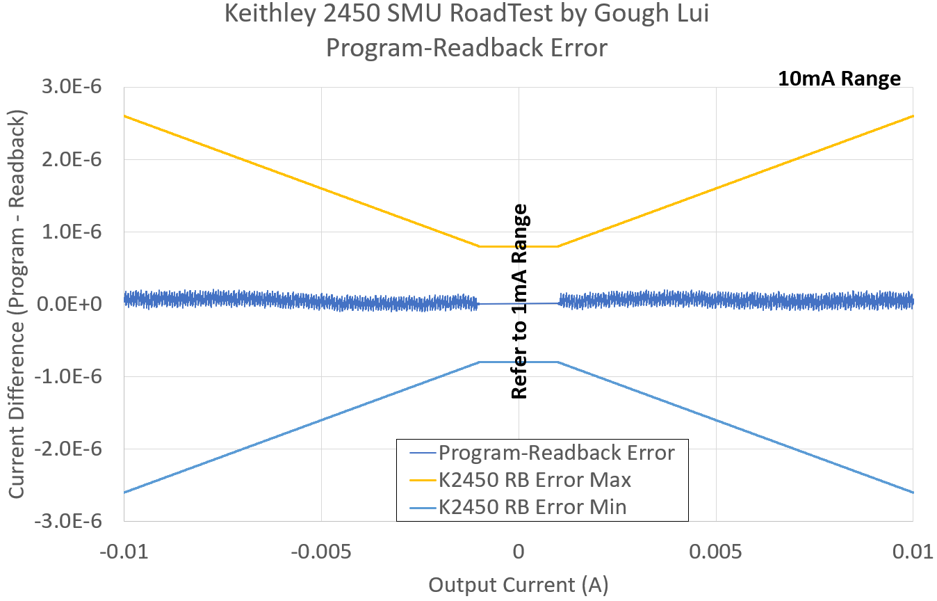

Combined Current Programming & Readback Accuracy

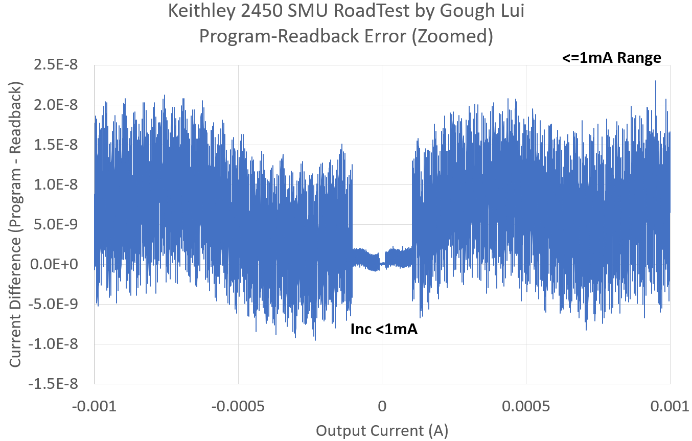

At <=1mA, the current error is within about ~24nA – consistent with previous testing which is an excellent result.
At 10mA, the error is within about 210nA, again well within the claimed read-back error.

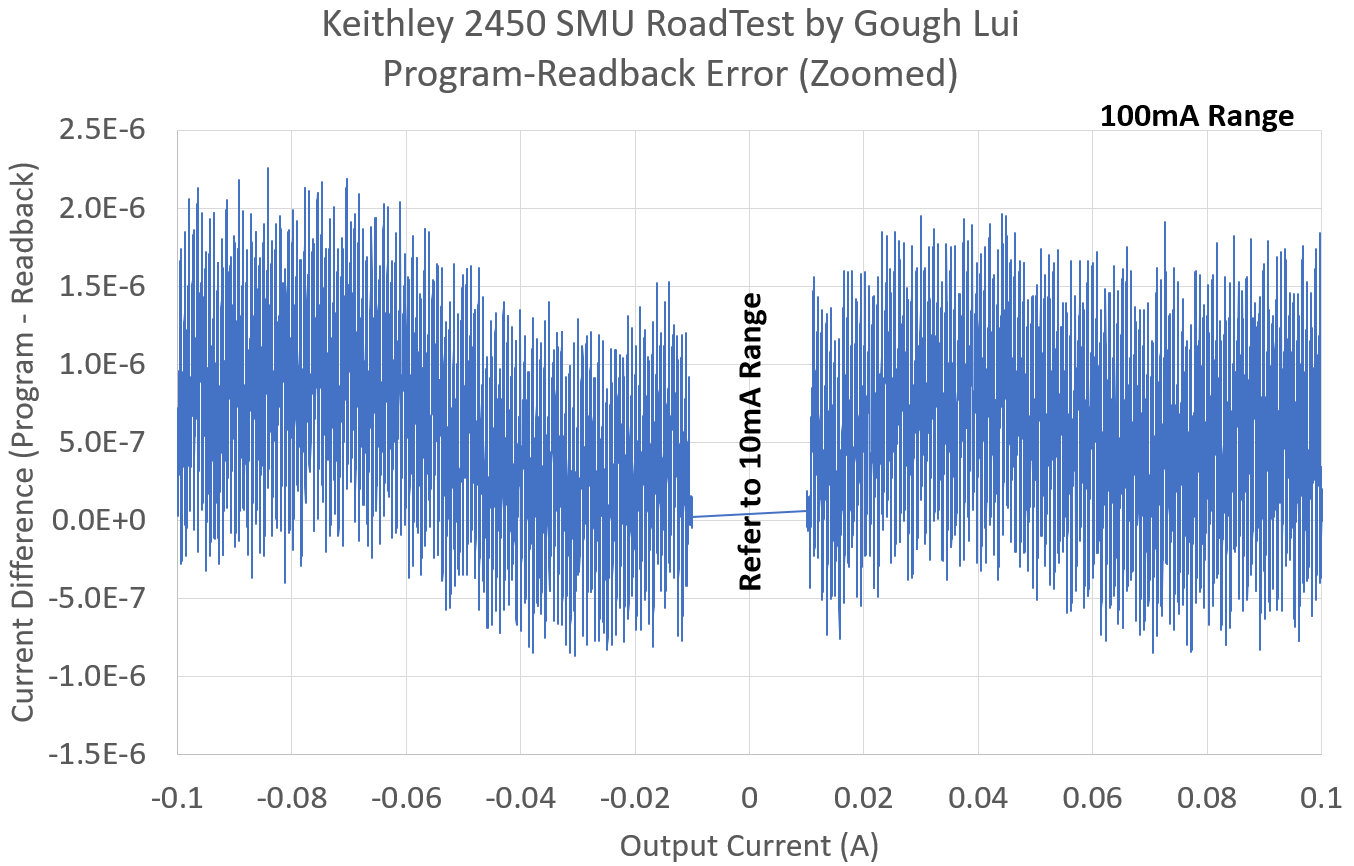

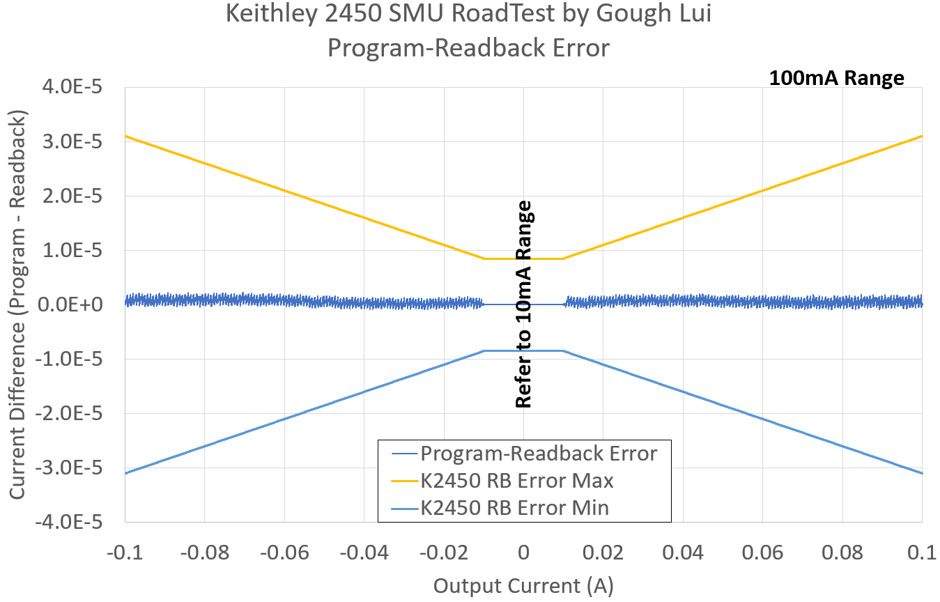

In the 100mA range, this increases to about 2.3uA, in all cases, appearing to be a “scaled-up” version of the “wave” characteristic seen prior.

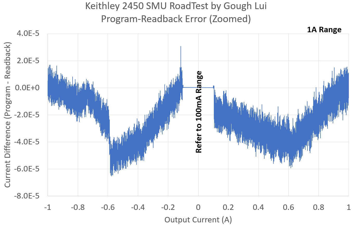

The 1A range shows more deviations than the other ranges, however, is still well within the claimed accuracy limits. Specifically, in the sinking mode of operation, there seems to be a significant dip around 0.6A which seems a little steeper in this test than in the past. A shallower dip is seen around 0.6A sourcing. This corresponds to my experience that the 2450 exhibits its maximum heating around the 400-600mA level, thus the internal temperature of the instrument may be affecting its output.
In all cases, the resulting characteristics are consistent with the SMU’s performance prior to repair.

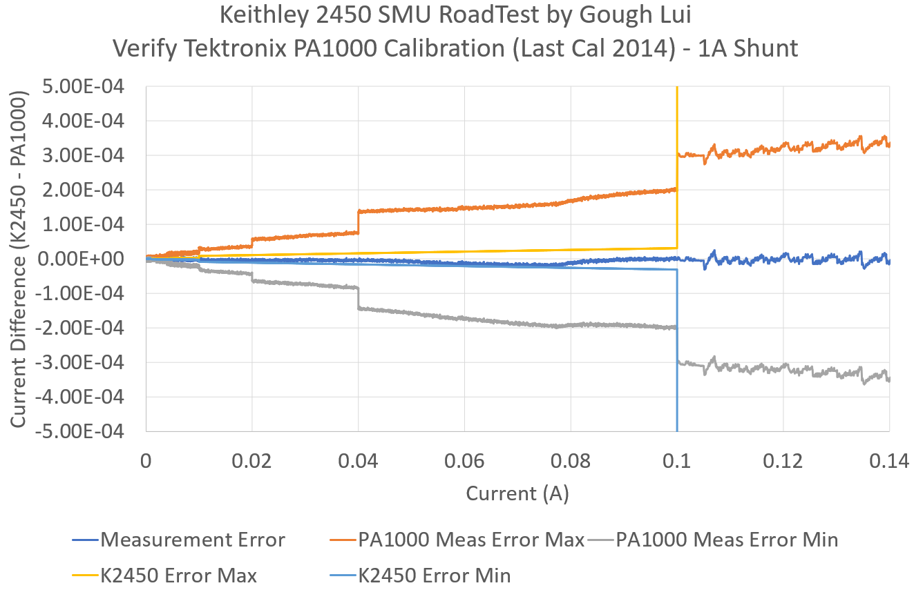

The Tektronix PA1000 Power Analyzer is another RoadTest item, this from 2014 which hasn’t been recalibrated since manufacture. This unit has the ability to measure up to 1000V (of which we can test to 200V with the SMU) and two current shunts of 1A and 20A (which we can test to 1A) all of which have multiple ranges. While primarily intended for AC applications, it is also capable of DC measurements with a basic accuracy about 0.1%.
Testing the voltage accuracy, we can see that the PA1000PA1000’s error margins are quite a bit wider than the 2450, making the 2450 a good candidate for testing. The absolute reading difference sits very close to the zero-difference line and mostly sits within the 2450’s error margin, so it seems both instruments are in agreement and the PA1000PA1000 is still well-calibrated. The error reaches about 30mV at 120V.

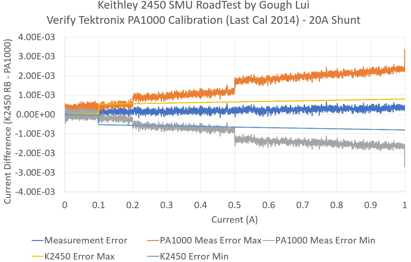

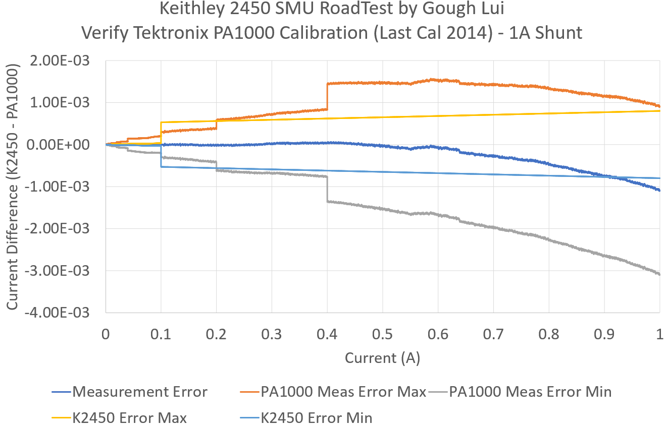

Testing of the 1A current shunt shows the PA1000PA1000’s low-current shunt intended for higher accuracy measurement of low-current loads (e.g. for standby power compliance applications). As a result, the accuracy of the reading from the PA1000PA1000 is actually better than the 2450 but only for a small range (0.1-0.2A), otherwise the PA1000PA1000 is the less-accurate instrument. Up to about 0.5A, the current readings are very consistent, but above that, it seems that shunt heating causes drift in the measurement resistance, resulting in the PA1000PA1000 over-reading current. However, even at the full 1A, the SMU’s error lines are enveloped within the PA1000PA1000’s margin of error, so we have confidence that the unit is still well calibrated and its performance should meet the datasheet specifications.
The 20A shunt suffers from a lot more reading noise due to the higher ranges and limited resolution of the converters. As the shunt is designed for much higher currents, we don’t see the same curve in the results – in this case, the reading errors stay within the SMU’s margin of error where the reading noise is low enough, indicating a good result – namely that I can trust my Tektronix PA1000PA1000 Power Analyzer to deliver me results within datasheet-levels of accuracy.

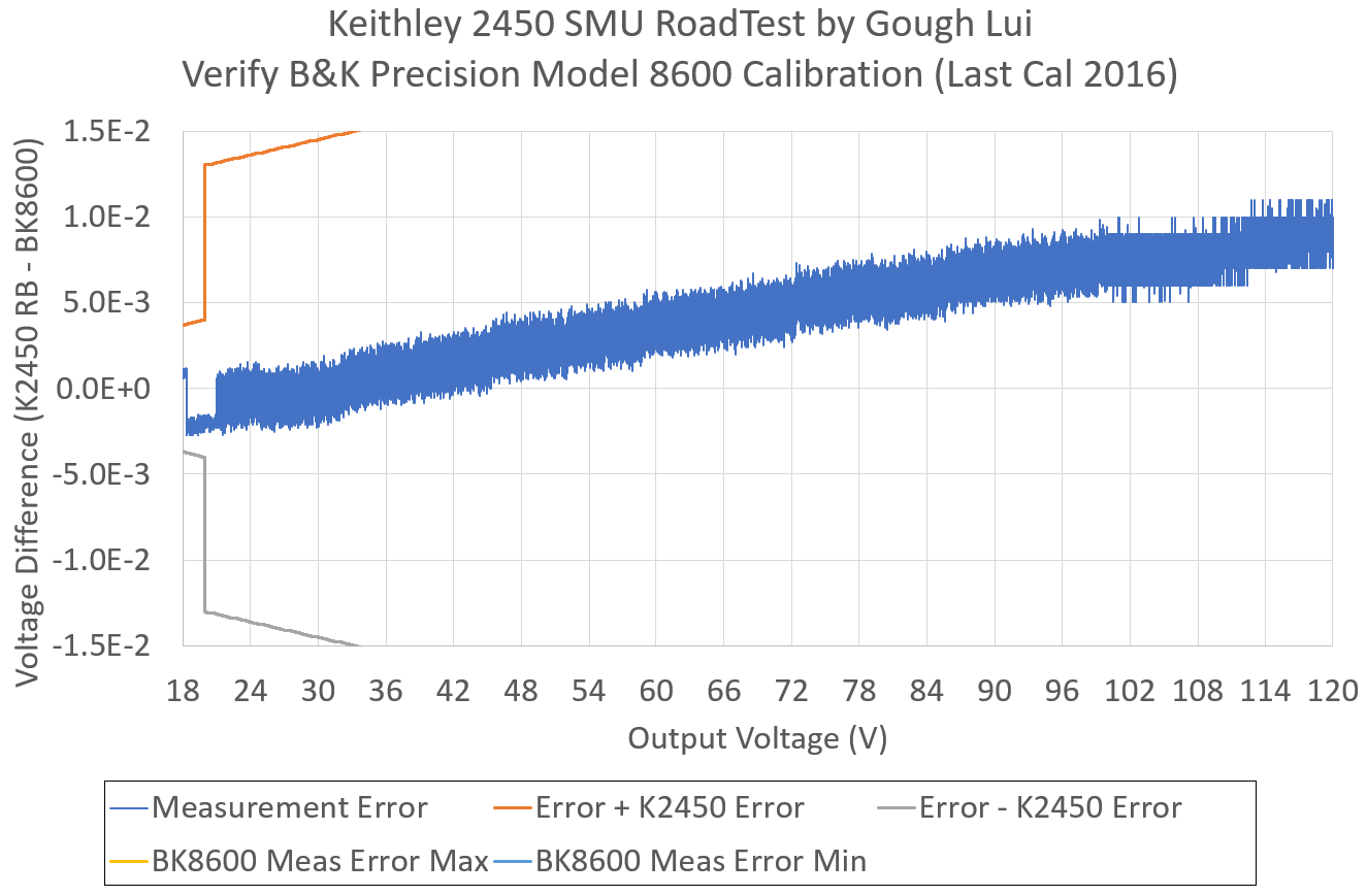

Testing the B&K Precision Model 8600 DC Electronic Load (2016)
The next item on the list for testing is the B&K Precision Model 8600 DC Electronic Load, another RoadTest item, this time from 2016. This unit supports an input up to 120V (which we can fully test) and current up to 30A (which we can check up to 1A).
Looking at the voltage first, we can see how wide the BK8600’s tolerances are – it encompasses the full SMU error margins so we should be able to have good confidence of our check. The difference line seems to lie within the SMU error band, so that’s a good sign.
In the high voltage range, we can see the voltage reading is slightly high initially, but then becomes a little low, reaching a difference of about 10mV at 120V. This is well within specifications.
At low voltages, it seems there is an offset of about +0.5mV, reaching -1mV by the time we get to 18V (the limit of the low range). That’s well within specification for the BK8600BK8600, but both may illustrate gain and offset error which may affect the underlying A/D converter set-up as they are seen in both ranges. While the SMU’s natural error tendency is a “curve” which is different from the straight line characteristic seen here, since the readings are within the SMU’s margin of error, we cannot conclude too much from the result.

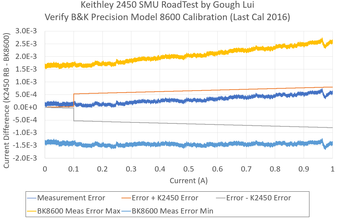

While the SMU can only be used across a small amount of the current capability of the BK8600BK8600, it was still worth a check. On the whole, there is a slight under-reading of about 100uA at the low current end, but errors were well within specifications and mostly within the SMU’s margin of error. Another good result that shows confidence that the B&K Precision Model 8600 DC Electronic Load can still achieve the datasheet-level of reading error.

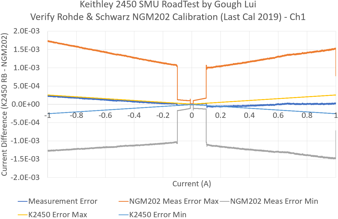

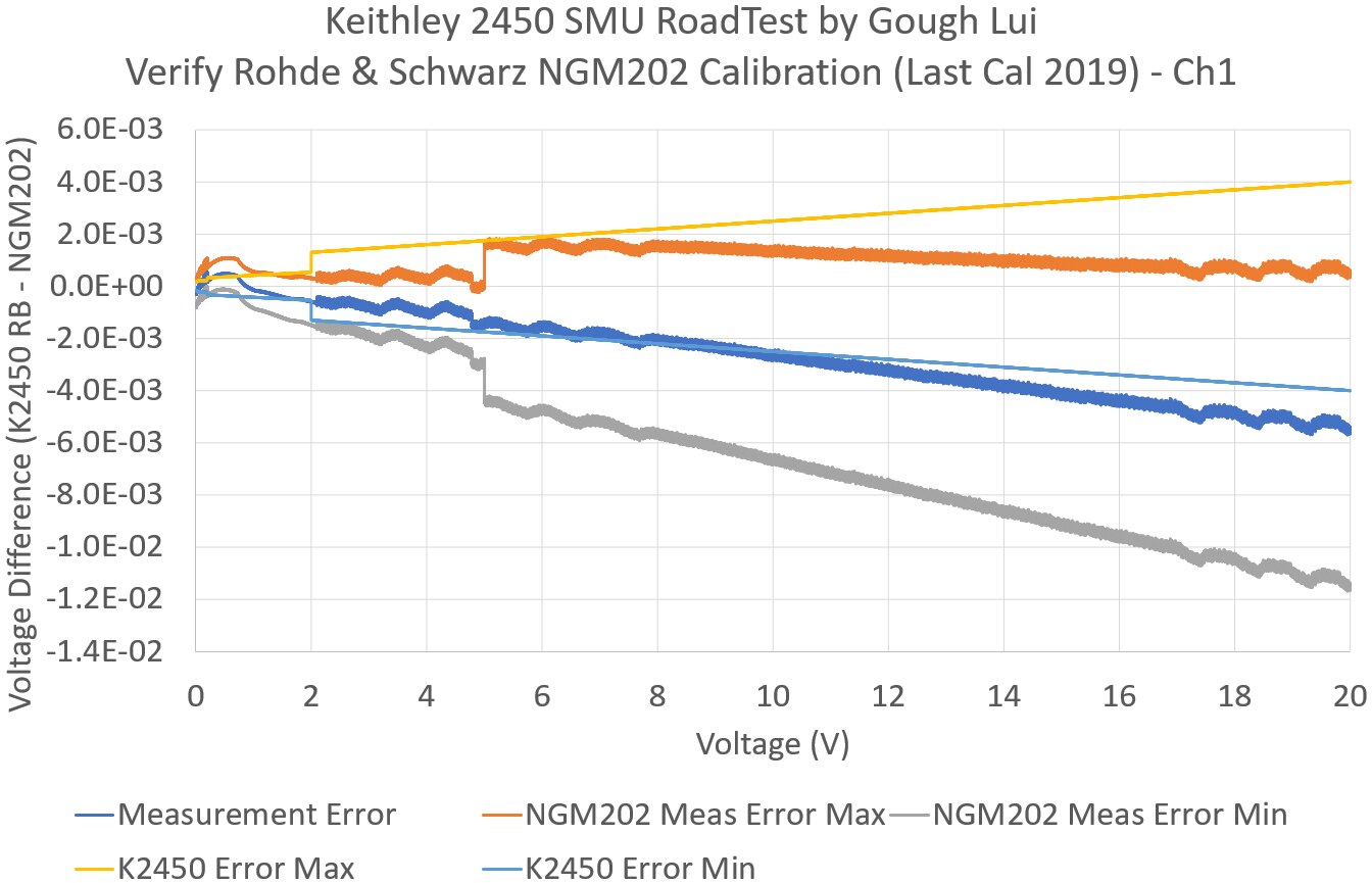

Testing the Rohde & Schwarz NGM202 Power Supply (2019)
Finally, it’s time to test one of my more recent items, the Rohde & Schwarz NGM202 two-quadrant programmable power supply which I generously received pre-launch for review directly from Rohde & Schwarz. This unit has internal metering which is in the 5.5 to 6.5-digit class with multiple ranges, with advanced FastLog capabilities, making it suited for development of IoT/embedded devices to analyse sleep-mode currents as well as for use with battery simulation and battery testing. Its calibration was checked using the 2110 DMM on receipt with some interesting discoveries including “humps”, but otherwise was well within specifications at the time. Now that a year has passed and I have a more accurate way of testing it, I thought it would be good just to check. The unit has two channels, each of which can handle up to 20V of which we can test the full range, and 6A (source) or 3A (sink) which we can test 1A.
Checking the voltage calibration gives an interesting result. It seems the NGM202 has a gain error that causes it to over-read voltages by about 3-6mV at 20V. It also exhibits “ripples” on Ch 1. The lines do stray out of the SMU margin of error, so there is definitely some error contribution from the NGM202, but interestingly both the ripples and “hump” near the low voltage end were measured in my initial performance testing. The amplitude of error was not measured as high – around 2mV before, but this small error is not unexpected as the disagreement between the 2450 and 2110 is probably about that amount. As a result, I would say the results are consistent and the NGM still very likely in calibration as the zero-error line still almost entirely fits within the NGM202’s error margins even without considering the SMU’s output error.

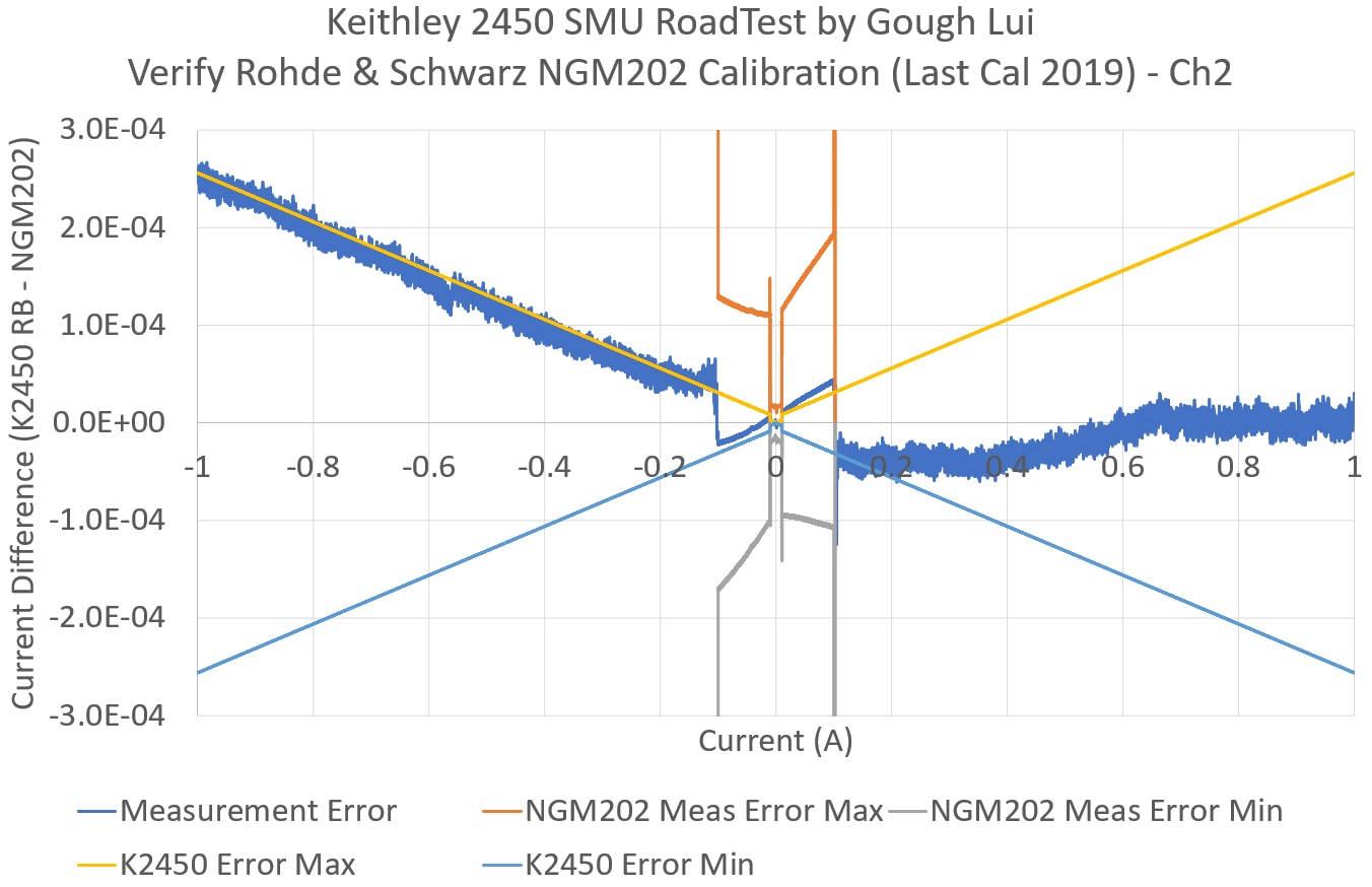

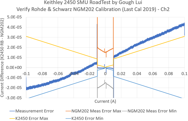

As the unit is a two-quadrant unit, we can test both positive and negative currents. Interestingly, it seems that there is an under-reading gain error on the sinking portion of the test, while sourcing is much closer to zero error. In all cases, the errors are close to or within the SMU’s error margin, meaning we have good confidence that the current is well calibrated.
The effect of range changes on the error can be seen clearly in the zoomed-in graphs for Ch1 and Ch2 which show very similar trends. While the voltage is perhaps slightly less accurate, the current measurement on the NGM202 appears just fine.
