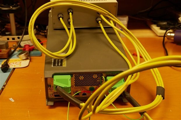

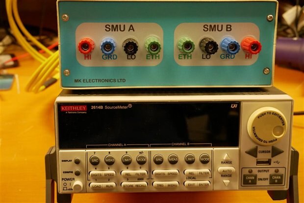

Polyester Film Capacitor Leakage Current?
Being ever-so-curious, I wondered what might happen if I attempted to measure the leakage current of other types of capacitors. The only other sort of capacitors I could find in my stash were polyester film types, one of which is a 20 to 30 year old greencap (i.e. dipped) capacitor recovered from surplus and the other an MKT (i.e. boxed) capacitor from five years ago. Both capacitors were rated at 100V, but polyester film capacitors are reputed for being “low-leakage” and to some extent, over-voltage tolerant up to 2.5-times their rating.
To maximise the chance of measuring something given the use of front-panel banana jacks (i.e. no triax connections here), I decided to bump the test voltage up to 200V and chart the results over an extended period (~24h) using KickStart 2.
As the capacitors were small, the test current was set to 10nA and the full current was flowing until the capacitor reached 200V. The greencap measurement shows something similar to a leakage current trend – falling to about 1nA but then rising slightly. The MKT on the other hand saw its current plummet dramatically when fully charged, reaching about 350pA but then the curve goes and “wanders about”.
This illustrates the perils of making precision low-current measurements using standard test leads connected to the banana jacks. Almost certainly, we are not able to resolve the leakage current (especially for the MKT case) as we are measuring the insulation resistance of the test leads themselves. Likewise, other influences need to be taken into account – while the capacitor was inside a glass jar with lots of air around it, changes in temperature and humidity are likely to have caused the “wandering” readings as that evening as the day was relatively warm and humidity was increased due to rain. Finally, the geometry of the test leads also played a role – I deliberately set it up in a quiet corner of the room, as any movement of the leads caused spikes in the graph. This is because the leads themselves form a capacitor and the dielectric gets “charged”. Changes in the geometry of the test setup cause currents greater than the steady state to flow, obscuring the actual data.
This is why the Keithley 2450 SMU features triax connections on the rear with guarding to remove the influence of insulation resistance and ensure high precision. The use of the triax connections is required to meet the stated accuracy claims in the datasheet when using the 10nA/100nA ranges. Unfortunately, such connectors, cables and test fixtures are quite expensive and as this is not my primary line of work, I can’t justify the expense. But it’s good to know that such an option is available, as some of their competitors don’t offer this on the unit itself (e.g. the Keysight B2900A series which relies on an adapter).

    Good stuff, thanks. I've got an older Keithley SMU, 2614B. I made my own triax lead set using cable from Farnell. I used the Belden yellow stuff (3854723) at £6.53 per m.. Checking this today I saw that…
  • michaelkellett
    michaelkellett over 5 years ago in reply to Gough Lui +1
    As you can see, I dodged the cost problem by wiring directly into a breakout box - the goal was to get the test device into the temperature cycler. I can live with a few inches of exposed wire. The green…
    Checking this today I saw that they have  much thinner and nicer looking Multicomp Tri-Ax cable at £2.25 per m.
    It's on "Available until stock is exhausted". (2678817)
    My big yellow cables are very hard to manage - so I've just ordered 25m of the Multicomp stuff.
    The green connectors for the Keithley are not too dreadful in price, and a pair came with my SMU.
    I'll do a blog about what I build when I get the cable. (Early 2021 I hope.)
