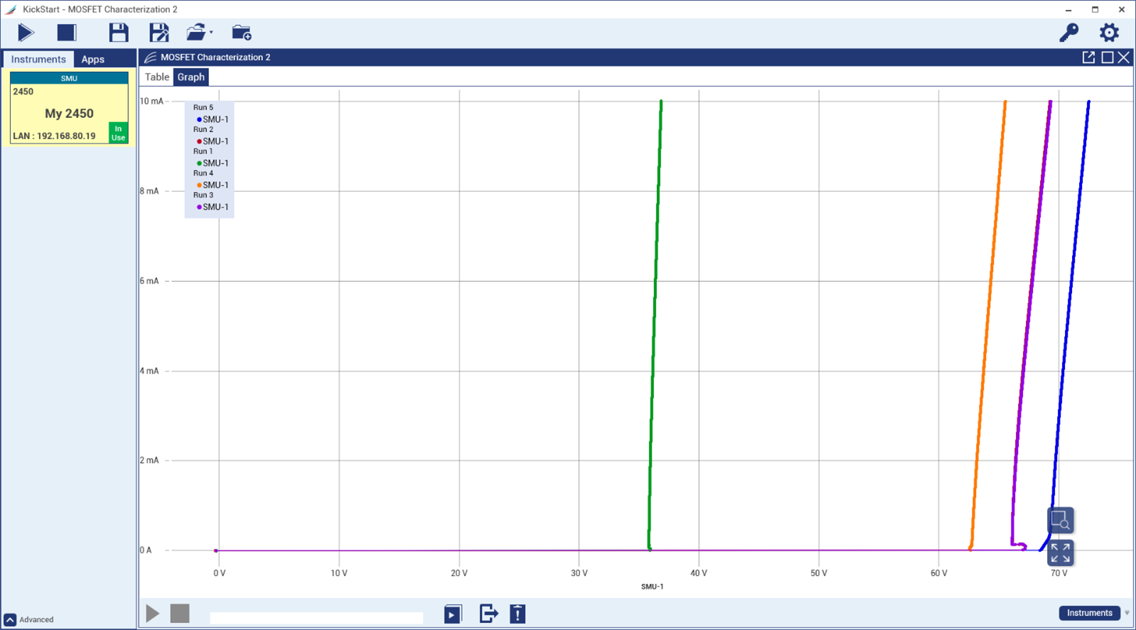

User Experience - Keithley KickStart 2
While in my previous review, I had touched on using Keithley KickStart 2 in the trial mode, I didn’t have much time to explore all of the features available. After performing this round of experiments, I became much more acquainted with KickStart 2 and its features, some of which are quite handy.
Some of the features are not immediately obvious – for example, in my last posting on capacitor testing, I made the discovery that the graph axes could be changed and graphing versus time with voltage and current was a possibility simply by hovering over each axis and the legend to change the parameters. This increases the versatility of KickStart 2 to handle some non-I-V tasks using the I-V Characterizer module.
But then I also got into the documentation features. For example, each project can be named and saved, creating a .ksp (KickStart Project) file which contains various settings in XML along with a subfolder containing an .hdf5 (Hierarchical Data Format) file that bundles together the raw data from each run along with the settings that were used to obtain that data. Each run can be labelled with a description post-run completion and aborted runs are still saved. Tabled data view allows “hiding” data points in case there are specific outliers. The export functionality allows one-click batch exporting of all runs to .csv or .xlsx with .png graphs in selectable resolution, gridlines and light/dark palette.
In all, this makes running back-to-back experiments and saving results easy, even if you do intend to analyse them with third-party software, as the .ksp and .hdf5 files hold all the data and metadata together. The downside is that you will need KickStart 2 to export them into formats for import to your other software and it seems the naming of the files is defaulting to <app-name> <run> <time>, so I can’t seem to incorporate the run description into the filename.
Another possibility once you have performed multiple runs within the same project is to select them to view them plotted together for visual comparison. This shows the later Vds Current Sweep and Vgs tests just directly plotted in KickStart 2.
While it is a software intended for no-hassle start-up use, the more I use it, the more I like it as I uncover its capability and flexibility. For example, if you just need a single voltage rather than an I-V sweep, there is the ability to run Voltage Bias or Current Bias mode. If you want to sweep through selected voltages or currents then there is a Voltage List Sweep and Current List Sweep option as well. If you’re doing a traditional Voltage Sweep or Current Sweep, it is possible to do a dual-sweep which allows for the value to be increased to maximum and decreased back to minimum. The addition of delay allows for waiting for the output to settle, while repeat allows for additional repetitions to be run automatically.

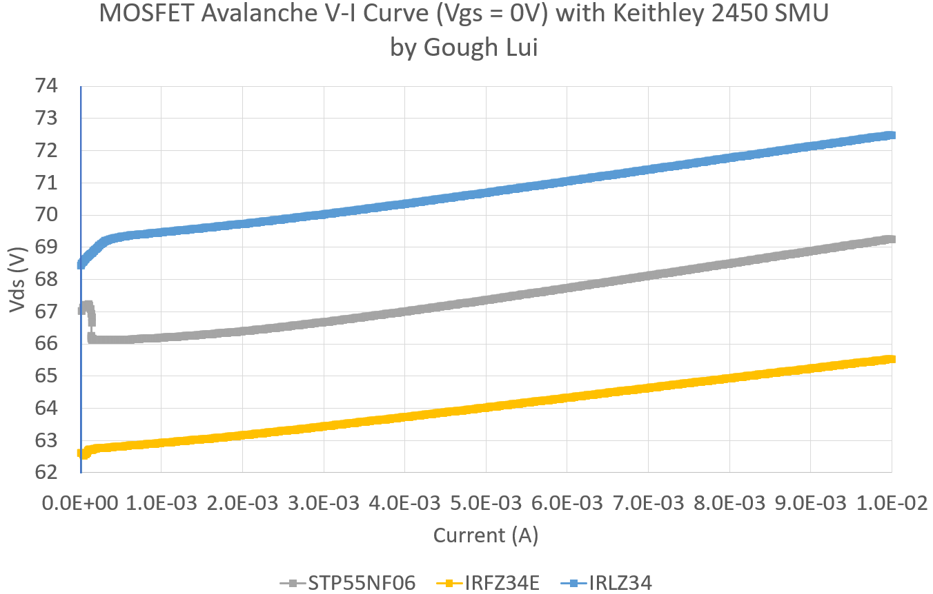

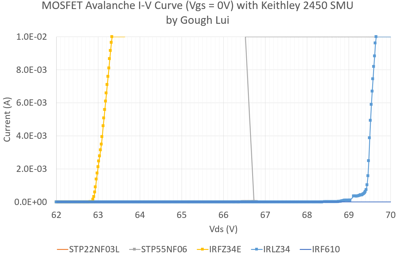

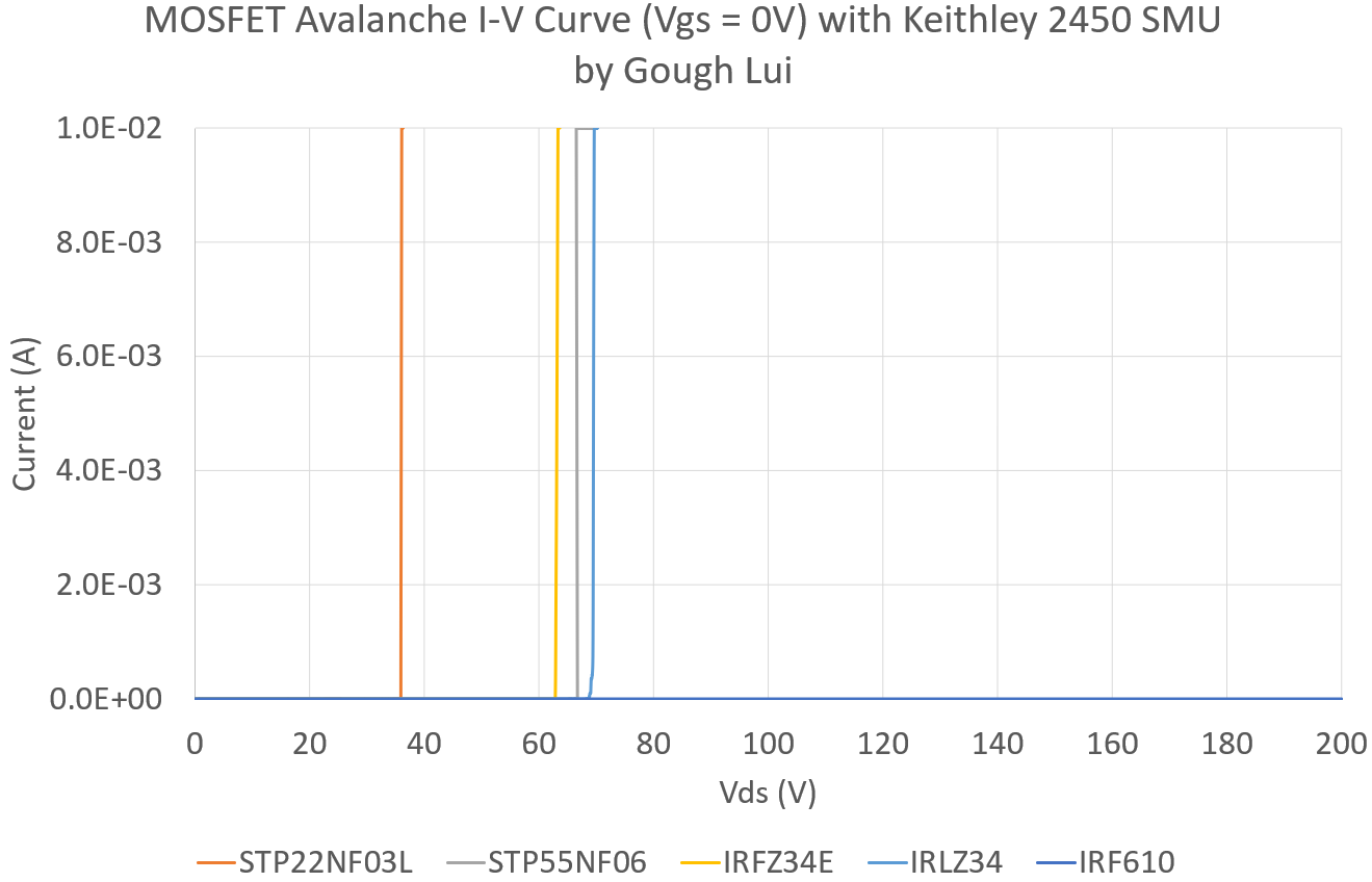

I-V Curves – Voltage Sweep
My first thought was to run a classic I-V curve on the MOSFET by sourcing voltage in steps between 0 to 200V with a current limit of 10mA set so that the dissipation in the MOSFET would not be enough to cause it to immediately catastrophically fail, although perhaps being a little “toasty”. This test took a relatively long time as I selected 10,001 steps for the voltage resolution and left the settings on auto-ranging which increased the test time, although many MOSFETs did reach the current limiter so the test could be aborted beforehand.
The results show the avalanche breakdown clearly for all MOSFETs except the IRF610 which has a Vgs rating of 200V (the set maximum limit of test voltage). In the linear graph, there’s not much detail visible in the avalanche at this scale, but the logarithmic scale graph shows some lower-level current detail. All tests are likely to be influenced by the test lead insulation resistance especially below the 0.5nA range. Interestingly, the STP22NF03L seems to be a bit “leaky” even when turned off.
In all cases, the measured values exceeded the rated values by anywhere from 4.8% to 19.7%, depending on the particular make of MOSFET.
Zooming in to the 62-70V region, we can see the relatively limited resolution in the avalanche range due to the fixed size of voltage steps. In the case of the STP55NF06LSTP55NF06L, there were no datapoints during the avalanche range as the device “snapped” into conducting 10mA in-between two voltage steps and is hence stuck in constant current from there.
Obviously, while this achieves the aim of identifying the voltage level at which avalanche occurs for these MOSFETs without destroying them, it is relatively slow and still doesn’t provide much resolution in the avalanche region.

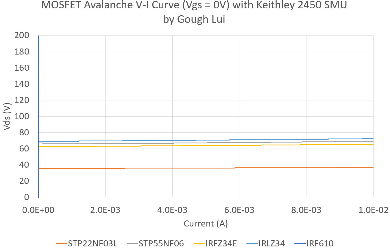

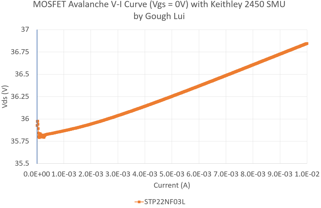

I-V Curves – Current Sweep
One of the advantages of the 2450 SMU is the ability to source current rather than voltage. This means we sweep current, rather than voltage, so we can immediately see what it takes to push a certain level of current through the MOSFET. In this case, I set the current limit to 10mA with just 1001 steps for a much faster test that should hopefully give me what I’m hoping to see – definition in the avalanche region.
The axes in this case are reversed from the traditional I-V curve, in this case, plotted as V-I instead. This perhaps doesn’t look all that interesting, but zooming in provides a bit more definition.
In the case of the MOSFETs which did suffer avalanche breakdown, we can see that from ~0 to 10mA, the avalanche breakdown spans about two to four volts and there is some instability at the initial point of breakdown.

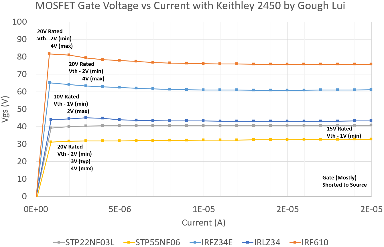

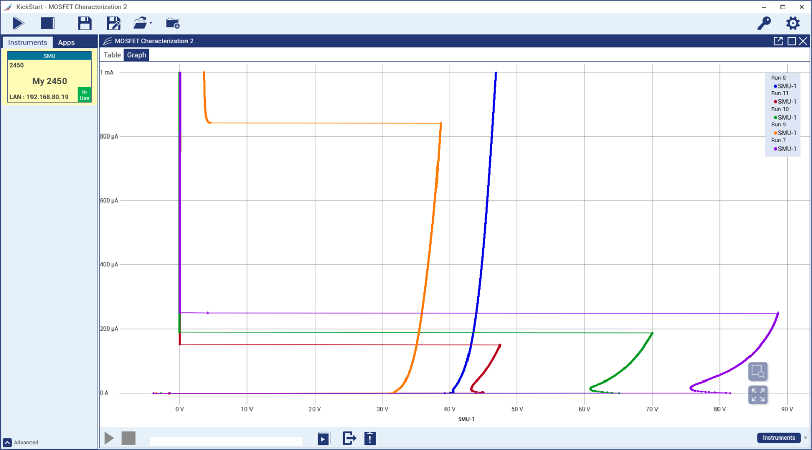

Gate-Source Breakdown Voltage
In a MOSFET, the gate terminal controls the state of the channel through the field effect. The MOSFET is mainly a voltage-mode device, with the gate being a sort of “capacitor”, insulated from the channel with a thin layer of oxide. The geometry of the oxide can impact the sensitivity, reliability and performance of the MOSFET. This oxide layer generally is an insulator with a low leakage current, contributing to the efficiency of using MOSFETs over BJTs. However, the MOSFET can be broken down by overvoltage and this is one of the key reasons why MOSFETs are so ESD sensitive.
Most MOSFETs have absolute maximum Vgs ratings of around 10-20V, with lower ratings commonly observed for “logic level” drive MOSFETs. Again, I wondered how much voltage could a gate tolerate before it failed entirely and what would be the result. Instead of running an I-V curve sourcing voltage as before, I decided to start pumping current through the gate instead to get a “quick” answer, stepping the current at 1µA intervals with 1001 steps which is perhaps not the best way of going about it given the ordinary leakage is in the order of 100nA as I’d miss some of the lower-level results.
I suspect that pushing such current through the gate is basically setting a voltage that forces charges to tunnel through the oxide and any imperfections or weak spots within the oxide layer. Depending on the geometry, the behaviour of the MOSFET will differ. As I am not an expert in semiconductor device physics, the following interpretations will be based on my prima-facie assumptions, but on the whole, there didn’t seem to be any great correlation between Vgs rating nor Vgs(th) ratings with the points of failure or Vgs attained.
The STMicroelectronics StripFETs seemed to have lower Vgs voltages developed, but handled current up to 841µA before blowing through to a medium-resistance short to source in the case of the STP55NF06STP55NF06. The STP22NF03L managed the full 1mA current without failure, which was a surprise. The lower voltage I suspect indicates the presence of more leakage points within the oxide possibly reflecting a larger gate geometry, however, the lack of abrupt failure early in the test may indicate that the oxide was very homogenous so there was no weak spot to concentrate current flow and cause a thermal failure.
The Vishay Siliconix IRFZ34E and IRLZ34 are very much “related” devices, with the “L” device featuring a lower voltage threshold and lower Vgs as a result, but otherwise similar specifications. Indeed, both devices blew through their gate oxide at similar levels of 188µA and 150µA respectively which might reflect similarities in device geometries and oxide quality. The attained Vgs differed – in this case, the lower-level device had a Vgs that was about 18V lower than the higher level device, both higher than the STMicroelectronics devices.
The Samsung Electronics produced IRF610 oldest device in the bunch with a not-so-impressive Rds and intended for use with higher voltages (Vds = 200V) had an even higher Vgs, reaching above 75V while pushing current through. The oxide blew through at 250µA. In all cases of IRF failures, the oxide failure resulted in a much lower resistance short of the gate to source – usually <= 90 ohms.
As a result, it was interesting to see that there is a big variance – in the case of the STP55NF06LSTP55NF06L which is rated to 20V, it saw about 39V before it failed entirely. The IRF610 rated to 20V managed to reach 88V. While this test was the result of testing a single sample and you can’t depend on any MOSFET to exceed its datasheet rating, the margin seems to be highly dependent on the device design (e.g. geometry, materials, purity) and is very part-specific. The amount of current you need to blow the gate can be quite small - 150µA in the case of the IRLZ34, but the STP22NF03L proved to be the exception, tolerating even 1mA in this short-term test. But given the relatively low currents and voltages found in this test, it is clear that ESD definitely has the potential to destroy MOSFET gates.
