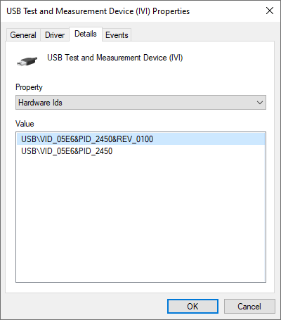

The rear USB connection allows the device to be commanded through an USB Test and Measurement Class (IVI) driver, usually supplied by the installed system VISA library (e.g. NI-VISA). This allows for connected direct remote control of the device using the SCPI or Test Script Processor (TSP) command-sets.
The Keithley 2450 identifies with a VID of 05E6, PID of 2450 and REV of 0100.

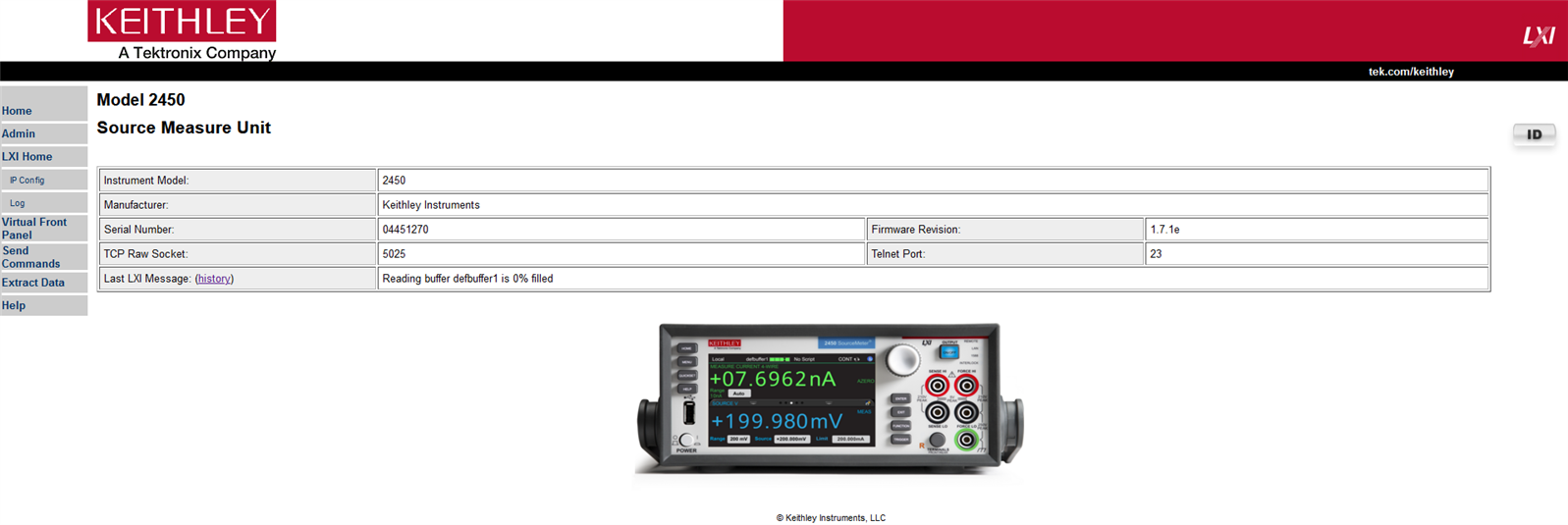

Connecting to the IP-address of the instrument in a web browser brings up the web interface.

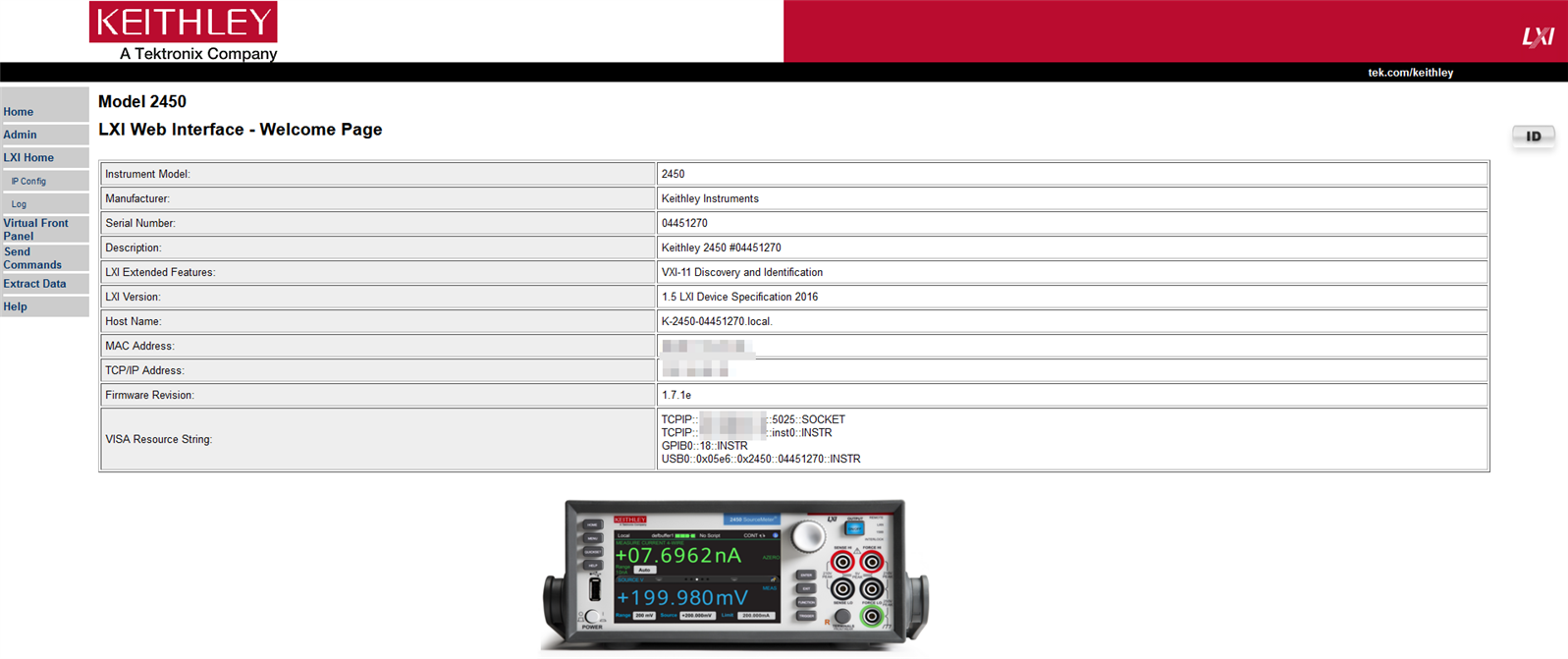

The homepage provides a simple summary of the instrument’s details and last LXI message. From this page, a number of options are provided along the sidebar navigation.

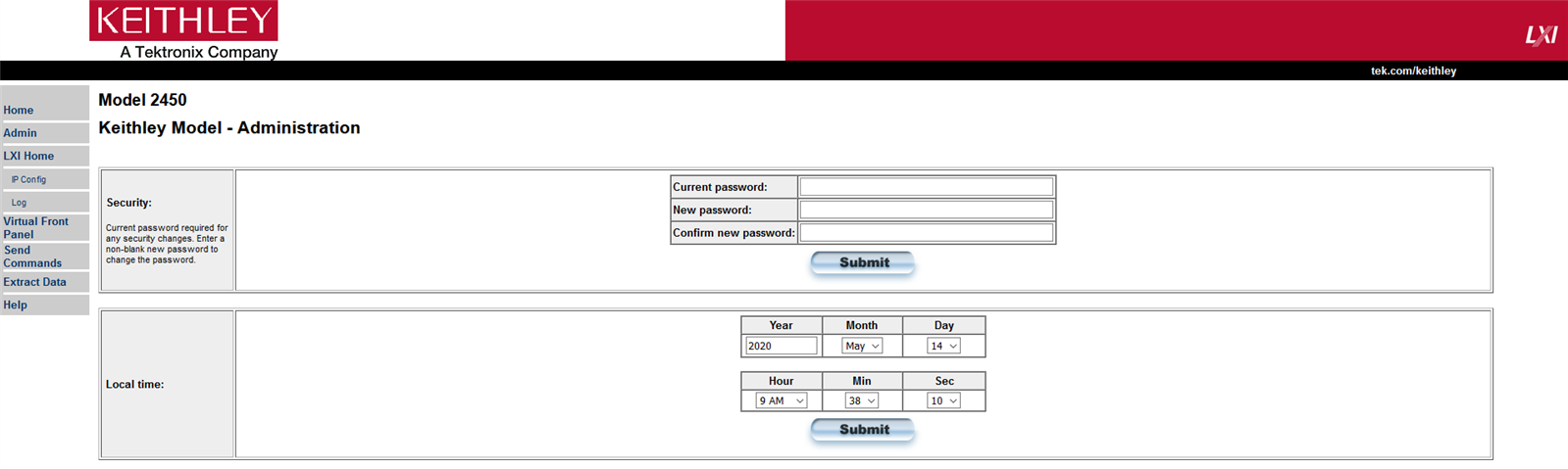

The admin section allows for configuration of an access password, date and time.
The LXI page offers a quick rundown of the instrument’s details including model, manufacturer, serial, description, LXI version/features, hostname, address, firmware and VISA resource strings. An ID button is also provided to make it easy to identify the instrument in a rack.

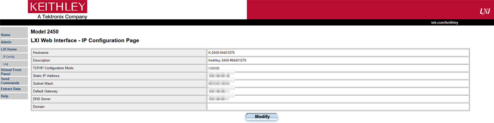

The sub-pages allow for checking and modifying the IP address configuration of the instrument and reading the error log.

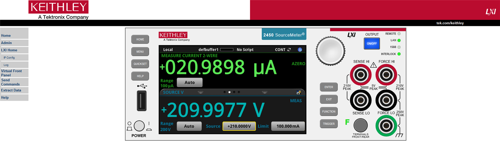

The virtual front panel allows for interaction with the instrument as if you are at the front panel. It also allows downloading screenshots by right-clicking the LCD area. The refresh rate of the web panel is relatively decent, managing a few screens per second, making it a very convenient way to interact with the front panel of the instrument in a remote setting or for use in educational or remote-support circumstances.

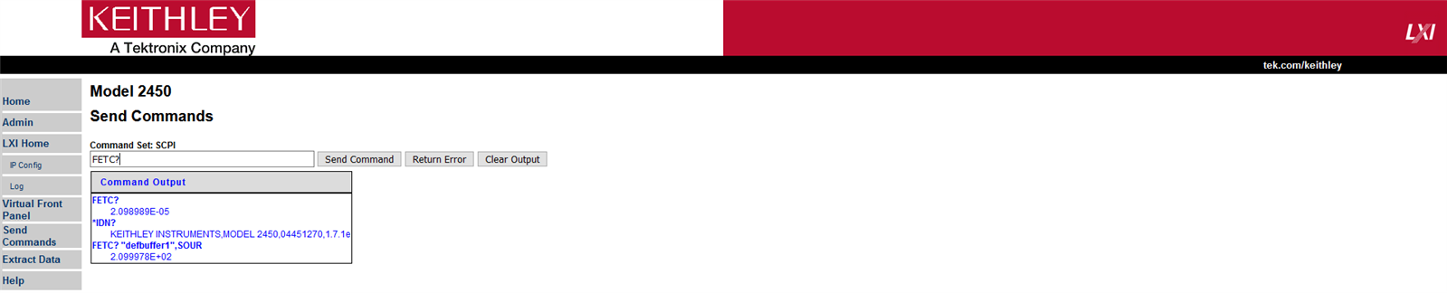

You can also send commands to the instrument from the web interface and view the output.

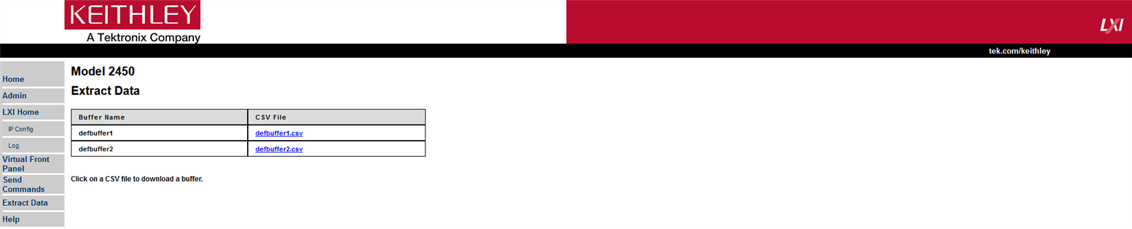

The web interface also supports downloading the contents of the memory buffers of the instrument directly. This means that you could avoid the “chore” of needing to plug in a USB stick or writing a program to download the recorded information – a very useful feature.

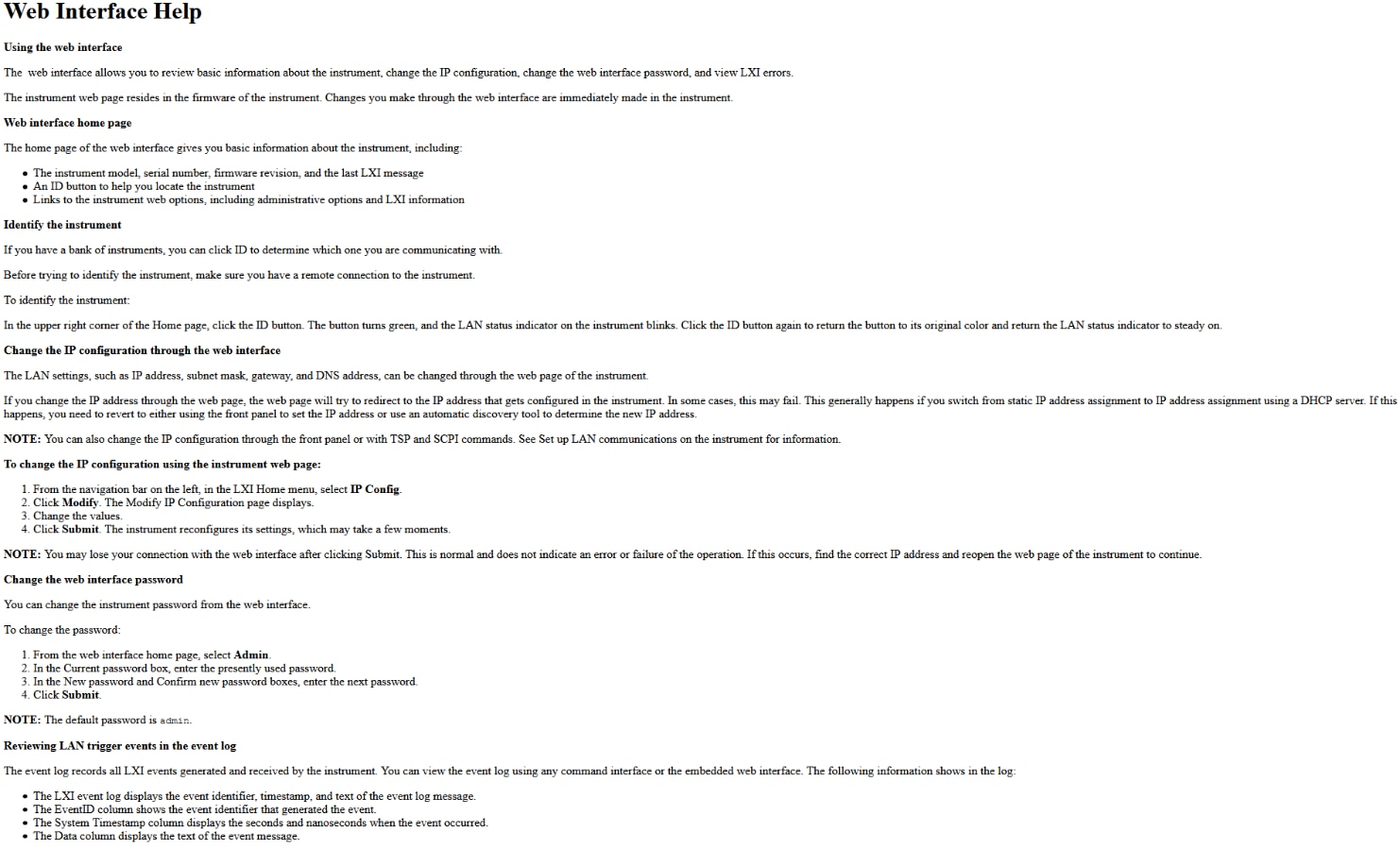

Finally, there is the help feature, which provides a basic HTML page of help, but is not particularly necessary as the web interface is very intuitive to use.
