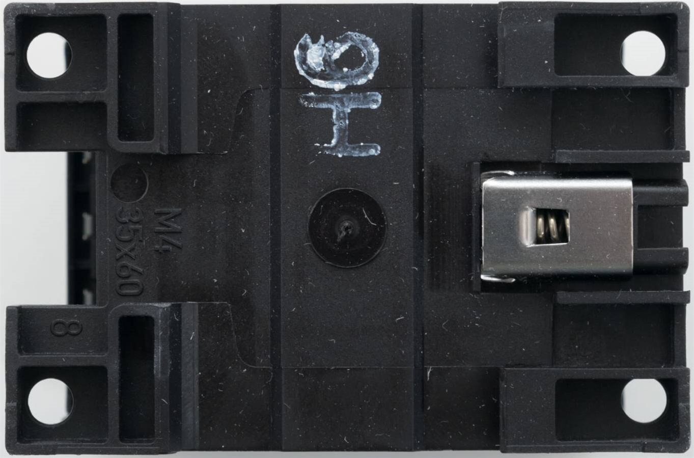

The contactor supplied is a DILM7-10 rated at 3kW/400V with a 24VDC coil manufactured 38th Week of 2012. The box is covered with the Eaton logo in blue, and a warning that only “skilled persons may install and commission the devices.” I guess I fit into that category now … *opens the box*.
The box internals are also printed and form the manual for the contactor, although the text is a little difficult to understand due to the lack of words in general.

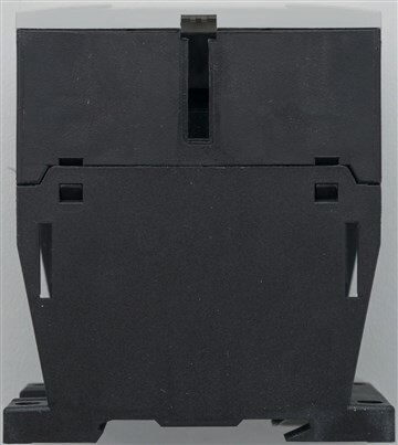

The contactor is DIN rail mounted with a spring loading clip and has a roughly boxy side profile.
Wires enter and exit from the top and bottom faces of the contactor.

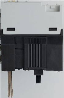

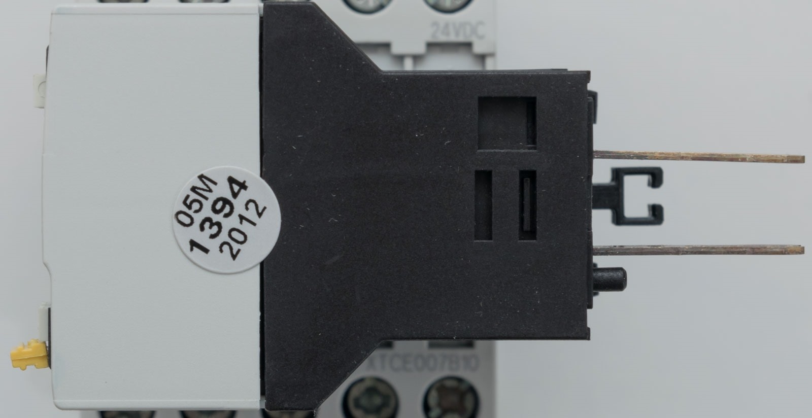

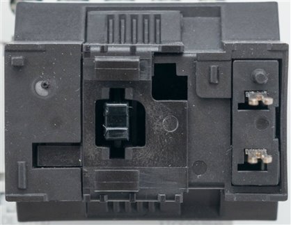

In order to transform the DILM7-10 into a SmartWire-DT device, a DIL-SWD-32-002DIL-SWD-32-002 is used. This has two “forked” contacts which go into slots on the contactor to directly actuate the coil and is held in place by the plastic latching mechanism.
We can see that the mating of the two results in a fairly “tall” profile device which does lever some distance away from the DIN rail.

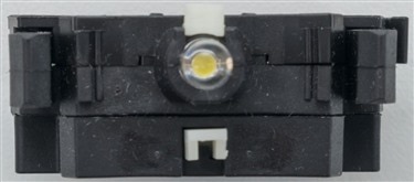

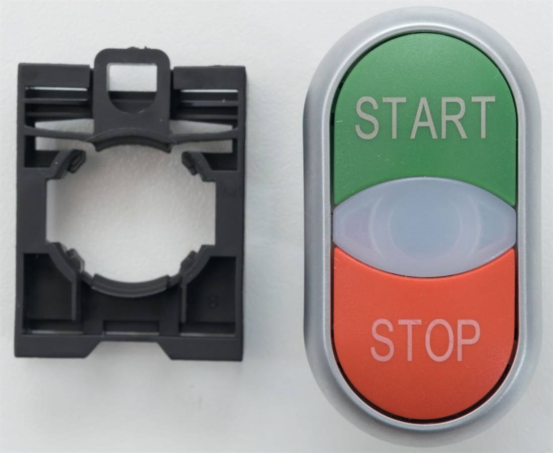

The M22-SWD-K22-LED-W switch modules from all sides.
The Pilot button module package.

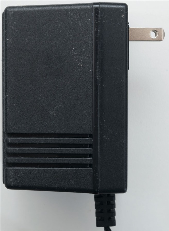

The supplied chunky US transformer which isn’t suitable for my use (unfortunately). Luckily, I have plenty of lab power supplies to use.

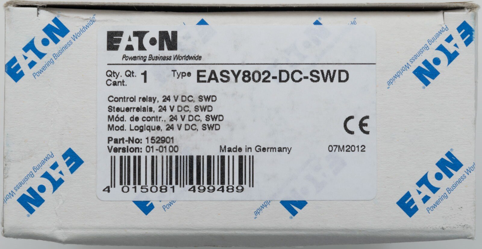

The EASY-802-DC-SWD comes in a very similar box, with a manufacturing date of July 2012.

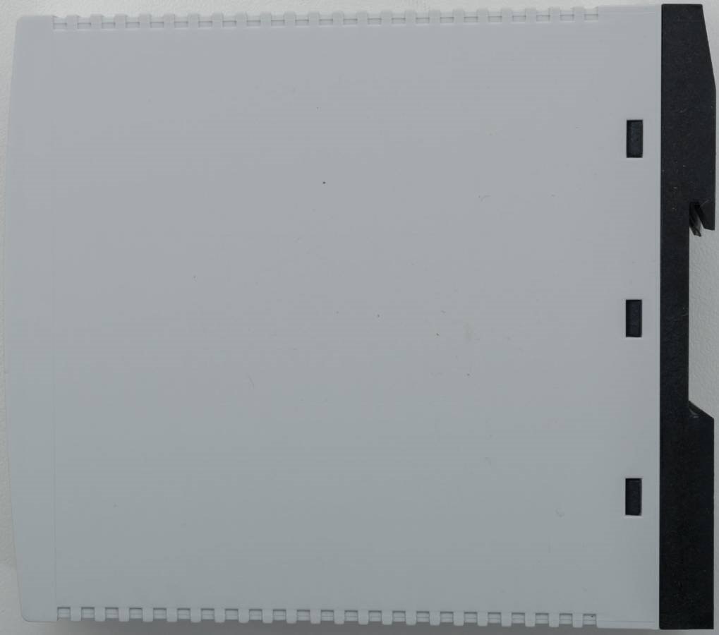

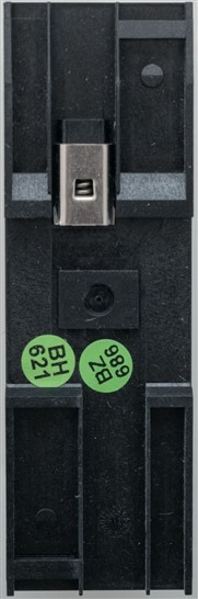

The unit is also DIN rail mounted, as expected, with a screwless design that has a plain cover on one side.

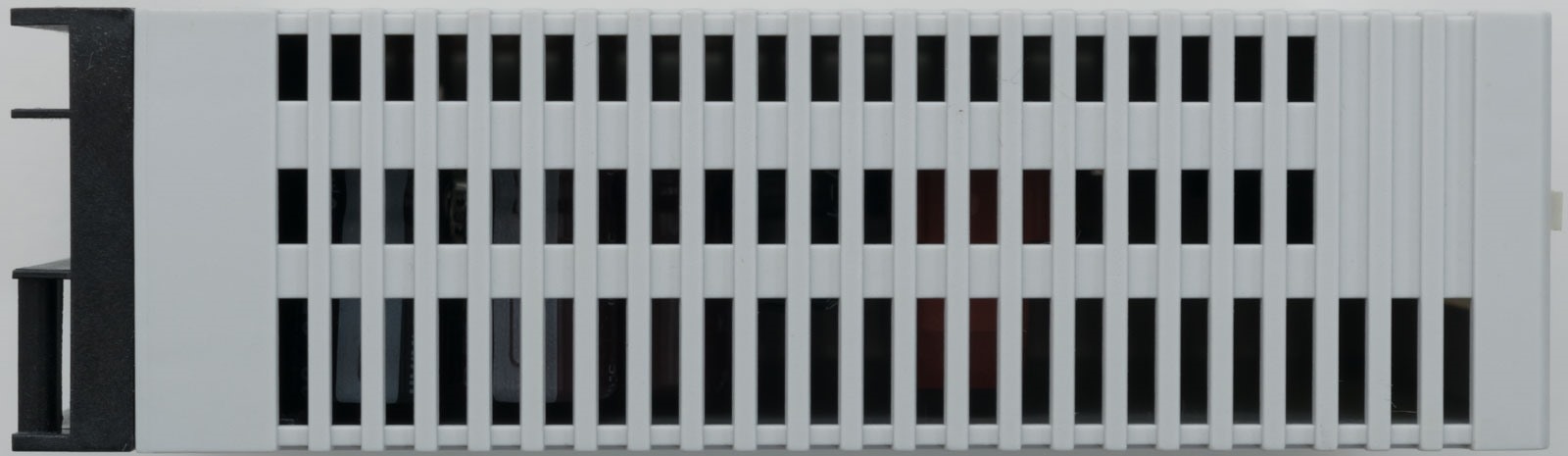

Top and bottom are vented with the SWD Out on the top and no interface on the bottom.

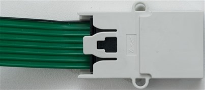

The cable ends are dressed in flat plugs which are IDC crimped. These plugs feature eight connections and the opposing end of the bus is connected to a terminator which absorbs signal reflections, allowing the bus to operate correctly.

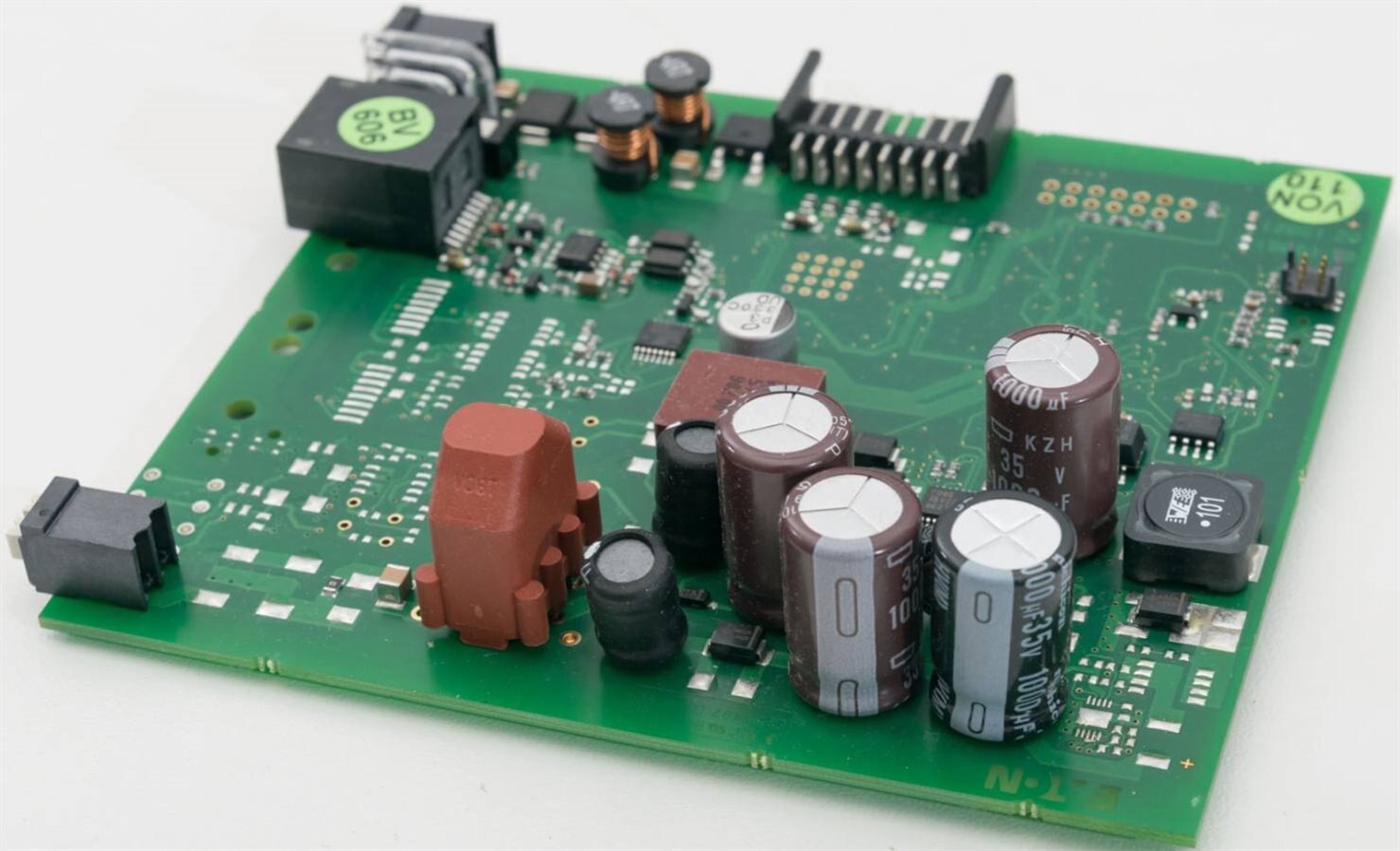

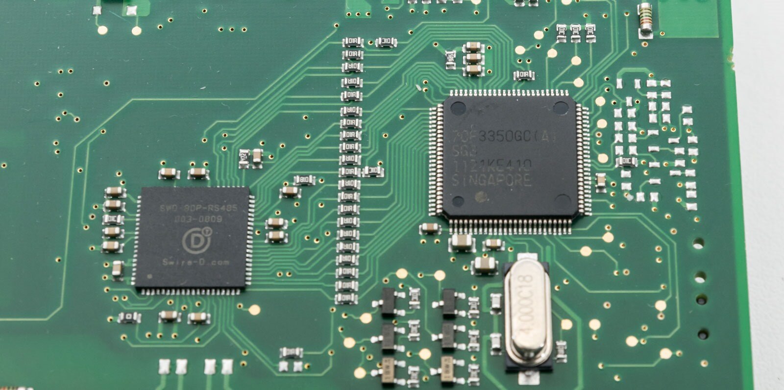

It seems that the PCB is rather sparse and is common to the 802/806 units. The difference is that the 806 has a SWD output as well as EasyNET capabilities and integrated digital I/O. From the top, the PCB has a rather clean look with a bunch of power-conditioning parts including capacitors and inductors and a supercapacitor for date/time backup. The programming interface can be seen from the top and it seems great care has been taken to ensure the interface is electrically isolated for safety – vitally important for the safety of the attached computer and human!
It’s a good relief to see that the capacitors are quality electrolytics from Nichicon and United Chemi-Con. The Eaton logo can be seen in the lower right corner.
From the underside, we see only a few ICs including what appears to be a custom ASIC marked SWD-80P-RS485 003-0809 with the address Swire-D.com. There is a main CPU with a 4Mhz crystal, covered by a label with indicating the V1.00 firmware revision.
The CPU is marked 70F3350GC(A) and appears to be an NEC V850ES/SG3 32-bit Microcontroller. According to the datasheet, it contains 512kB of Flash ROM, 40kB RAM, 32MHz maximum frequency, 1-ch CAN capability with on-board I2C, IEBus, 8 external + 51 internal maskable interrupts and 2 non-maskable interrupts.

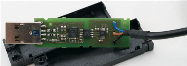

The next thing I tore down was the EU4A-RJ45-USB-CAB1 (01) programming adapter.

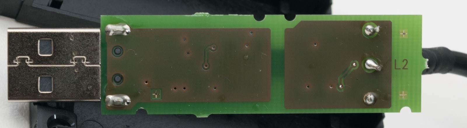

The adapter is based around a Silicon Labs CP2102 USB to Serial adapter, but protected by some isolation involving an ADuM5241 Dual-Channel Isolators with isoPower Integrated DC-to-DC Converter and ADM101E Craft Port Tiny RS-232RS-232 Transciever. Three wires go to the RJ45 plug. The PCB appears to also have ferrite bead suppression and 0-ohm links to the USB connection possibly as fuses of last resort. The board appears to be made and manufactured by Wurth Elektronik.
The underside is clear of components but has nice shielding and clear isolation. Because of the design of both the programming adapter and the PLC involving isolation, the design eliminates potential dangers to users and installers.
