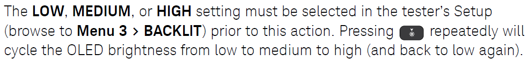

Another thing I’ve come to realise is that the three brightness steps of low, medium and high aren’t working correctly either.
Low brightness is barely readable in ordinary room lighting.
Medium brightness is somewhat readable indoors, but not at all outdoors. Finally, high brightness wasn’t working at all! It would just remain just as bright as the medium setting.

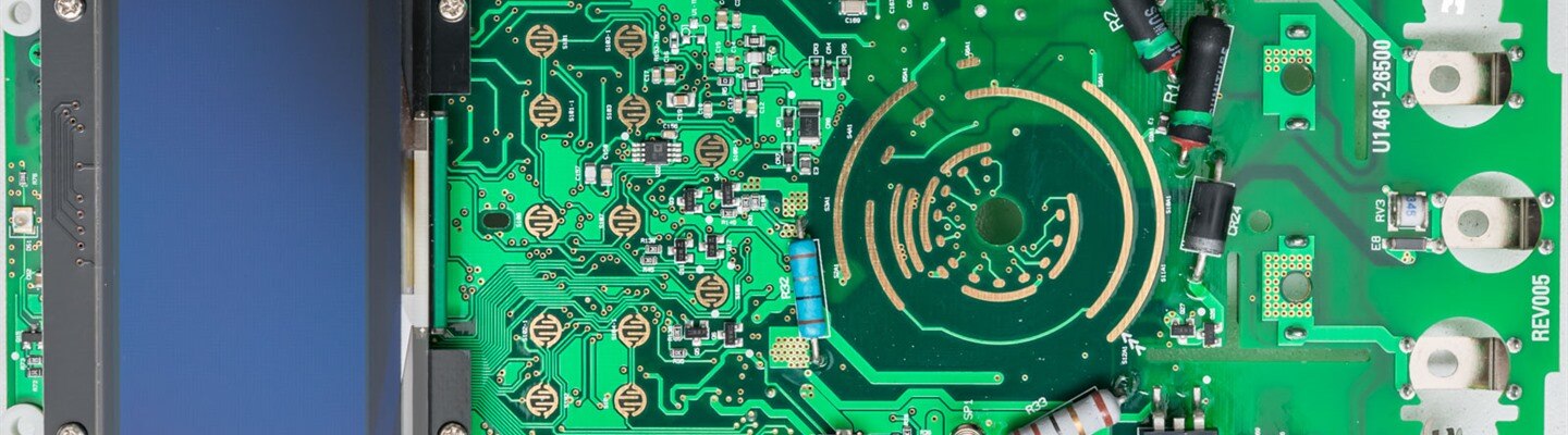

For those who like close-up images of boards, here’s the top section of the rear. The transformer at the top is likely used to generate the high insulation resistance test voltages. There is a shielded inductor near the unpopulated J4 that seems to have been manually siliconed to reduce acoustic emissions or increase physical shock resistance. Aside from that, there are a few ICs on the board, but I didn’t pay much attention to that aside from the Hycon HY3131 Analog Front End on which the DMM is based.
The lower section near the inputs has a lot more spacing and anti-tracking slots for improved isolation. There also appears to be a lot of safety features including MOVs and thermistors with protective heatshrink (perhaps for current limiting in case of transient impulses or faults). The function selector knob mechanism is particularly fiddly as it consists of circuits on both sides of the board (!!!). As a result, one has to be careful to remove the screw and this rear plate along with three tiny gold-plated spring contacts that aren’t held captive. To further disassemble requires unclipping the auxiliary input jacks by pulling back on the tabs and undoing the bolts for the banana jacks. It also requires taking another five screws out from the PCB. Of note is that the PCB silkscreen indicates this is U1461-26500 (which may be an assembly number) of which this is the fifth revision. There is a UF840L N-MOSFET in a D2PAK which seems to be quite chunky. Might be related to generating high voltages or the Earth bond test?
Oh, and behind this metal shield appears to be a precision resistor array that serves a key function in ensuring the accuracy of the meter. Don’t touch! Not like you can with the metal can around it anyway.
Now the board is out, the internals of the casing on the other side can be examined. It seems both front and rear have foil shielding to either reduce EMI emissions or improve EMI/EMC robustness in case of being used in a radio-harsh environment. The three springy contacts on this side of the function selector can be seen - while they slot into grooves in the selector knob, they actually sit freely, so just a slight bump and those contacts can go flying. Because of this, reassembly is going to be an absolute pain.
The PCB from the front - I’d say it’s interesting to see more protection in the form of fusible resistors. The IXTH3N120 High-Voltage N-MOSFET D2PAK on the back seems to be switching currents for discharging. I’m not really intending to analyse the circuit in any depth - the key reason for opening it up is merely to get at the OLED panel. This is on its own PCB daughterboard that is attached to the mainboard using four smaller Phillips head screws.
Looking underneath the OLED module, I suspect this is a NEC/Renesas D78F1168A 8-bit Microcontroller that runs the whole DMM. Next to it looks vaguely like an EEPROM which may hold the calibration data. The PCB is dated to Week 46 of 2013, which indicates just how long ago this unit was made. My best guess would be that Q23 is responsible for switching the waveform to generate the high voltage.
A little bit of a closer look at the input jack segments - some of those resistors are covered in heatshrink, perhaps to stop them from exploding in case of a drastic overload? There’s another MOV on this side too. There’s so much protection, it’s just night and day compared to the cheaper meters that I’ve seen. The assembly does leave a little to be desired - it seems the PCB is not exactly clean in the section where the mode selector rides on - thankfully the switch points are sufficiently “sharp” and have sufficient pressure to cut through the contamination, but ideally all residues should be cleaned off for the best performance and longevity.

But one issue remains - the brightness control still doesn’t work for high. I get low and medium … then nothing more (i.e. medium again). Looking back, I suspect this also means that there may be a failure in the supporting board in the switching converter that generates the OLED drive voltage. Perhaps it’s dipping under load, or not producing the right voltage in the first place. Was it responsible for the partial death of the first OLED display? I’m not sure. For now, I’d have to guess that it might be the switching converter chip, bad output capacitors (even though they appear to be tantalum, perhaps they’re leaky or have high ESR) or perhaps problematic feedback to the switching controller. But seeing that it’s improved, I don’t think I’ll take another risk to try and fix it - if I heat up the SMD components from the rear, the heat may well damage the OLED display.
