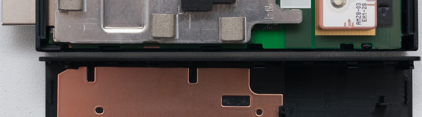

I always like to inspect electronics as soon as they arrive – if they don’t seem to be too hard to pull apart, I’d do it right away. Surprisingly, even though the FireTV Stick looked relatively solid, the plastic is pliable enough to disassemble simply using the power of my fingers!
Most of the PCB is covered with an aluminium heat spreader, and the inside of the case is covered with copper tape in that area. This keeps the heat in check – important for such a small device. Self-adhesive foam with conductive fabric is used to bond the heats spreader with the copper tape, likely forming a shield to ensure EMC compliance. Antennas for Wi-Fi/Bluetooth appear to be PCB-printed. But do you spot that rectangular thing? That’s a GPS antenna and they’ve wisely not shielded it. Now why would a TV-box type device need a GPS antenna? It doesn’t seem documented anywhere in their literature, and it is of concern to me.
I feel this is a bit of “overreach” – perhaps it’s to avoid NTP clock shenanigans for extending the validity on rented content, perhaps it’s to get location to break geoblocking circumvention mechanisms (e.g. VPNs). But I somehow don’t feel comfortable that Amazon can know the precise “to the 10m level” location of my device, along with whatever I’m watching.
That being said, there are many TV ports which are oriented badly for GPS reception and many sets are located in places where GPS cannot be received. I have a feeling that it is not absolutely required for operation, after all, people are not usually going navigating with their FireTV Stick and I can’t see Amazon asking users to “move their TV so they can get GPS” … so perhaps the best course of action is to desolder the antenna entirely. That will make it extremely difficult to get GPS – if it’s not powered, shorting the two pins may even be better.
Extracting the board from the rear case, we see the back is also covered with a heat spreader – it literally is a heat spreader sandwich!
The rear doesn’t have much, but it’s clear they really wanted the GPS to work by keeping all the noisy stuff away from the antenna. You could almost cut the PCB along a straight line and remove the GPS stuff … but given the antenna is soldered in through-hole, removal might be fairly easy.
Unfortunately, as the heat spreaders are not easily removed and there are cans below that, I decided not to tear it apart any further, especially as I haven’t even gotten any use out of it yet!

    Very interesting! I use them too, never suspected they housed a GPS antenna! As you say, it may be for timing purposes. Amazon products are interesting to tear apart! I disassembled an old Amazon Echo…

    I’m totally surprised by the GPS antenna too! What the heck!? Seems like a relatively expensive part to pop into a device that pretty much knows its location from internet connection - are there really that many people who use VPN location changes to thwart the system?
