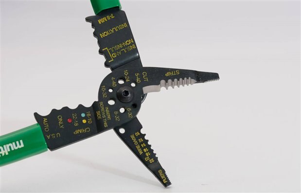

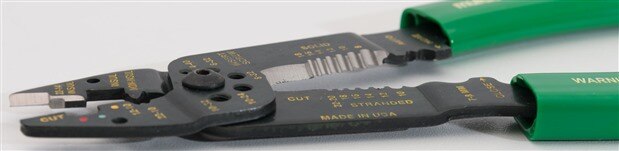

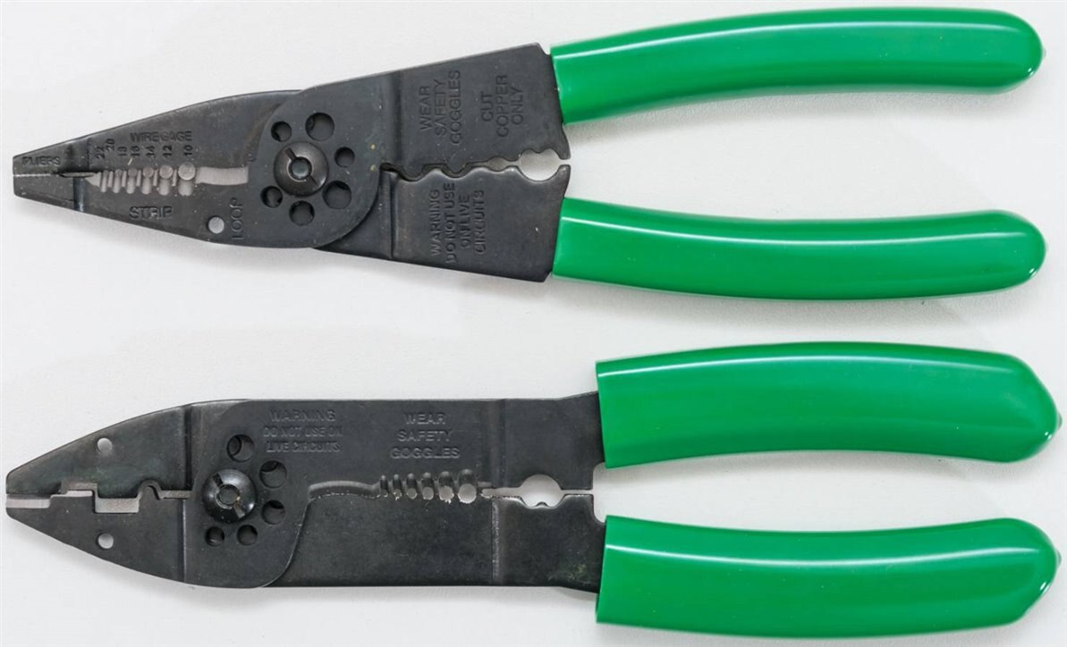

Both tools are shown above, with their characteristic green colour which is characteristic of Multicomp Pro. The MP700136 (lower) has a cutting jaw at the front, with crimping just behind, screw cutting in the centre, wire cutting and stripping at the rear and automotive crimping at the back. The MP700151 offers a similar array of tools, but instead of cutting, features thin nose pliers at the front, wire stripping and cutting just behind, screw cutting in the middle and crimping in the rear. Both tools claim to be Made in the USA, which is a little surprising given their price. I'm not sure exactly how much of it is made in the USA, however. The tools are clearly labelled in the tool itself with painted recessed labelling.
The rear of the tools have a limited amount of markings pressed into the metal of the tool. Copious safety warnings are printed in the tool handles and pressed into the steel, including "never use on live circuits", "wear safety goggles" and "cut copper only".
I've owned similar tools in the past and they have rarely ever been my favourite. My first one came with a box of crimps and never really did the job, being rather dull and stiff to open and close, with a very rigid uncomfortable handle. I'm pleased to say that these Multicomp Pro tools seem quite a bit above, as they open and close smoothly without any snags. Best of all, the handle grips are oversized, with an air gap in-between, to provide a subtle but noticeable level of cushioning between your hands and the hard steel arms of the tool.

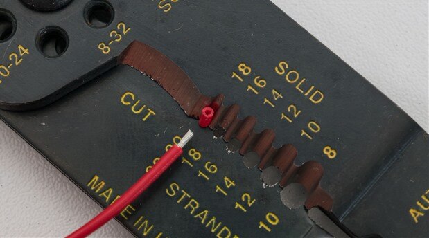

The stripping sections on both tools are quite sharp, while the wire cutting sections on both tools are slightly curved which helps prevent the wire being "squashed" into a flat piece, but also helps prevent the wire migrating as it is being cut. It was a breeze cutting through most forms of copper wire I had to hand. Of note is that the MP700151 opens wider until the screw cutting holes align, while the MP700136 opens up a smaller amount, which is more manageable for a single-handed use.
I had no problems stripping wire, even just a tiny bit off of the end, however it's important to note that the size of wires accommodated by both tools (~8-22AWG) are more suited to automotive use rather than for electronics hobbyists at the desk (which might be using very thin 24/28AWG wire).

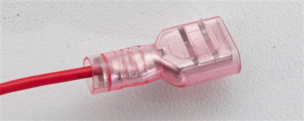

It seemed that I had greater success with crimping using the MP700136 rather than the MP700151, but that might also be because the crimps I was using were not suited to the tool or that I was not using it correctly. The crimping action does require a fair amount of force to achieve a crimp that can resist a good pull, so I wouldn't recommend the use of either tool in situations where a lot of crimps need to be made. It's also quite likely that you will make a number of bad crimps as you adjust to the amount of force required - it's basically "crushing" the crimp in a very uncontrolled manner, across a very thin cross section.

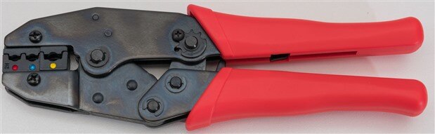

As a result, it's preferable that if crimping is your primary aim, you instead invest in a ratcheted die-based crimping tool -
This one just so happens also to be an element14 product, the Duratool D03009 which I purchased earlier, which is in a very similar price league as the multi-tools above (AU$28.64 including tax). While it won't do anything other than crimp wire, it's a much better tool for that job and would probably save you the tool costs in wasted crimps and potential failures from unreliable crimps into the future.
