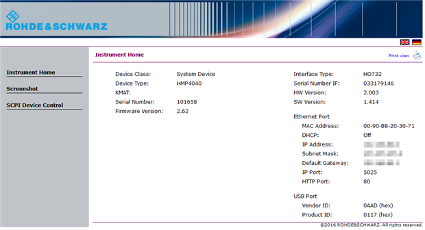

Web Interface
When connected via the LAN interface, the instrument can be accessed through a web browser at its IP address.
The basic configuration details are listed at Instrument Home.

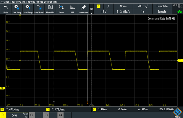

Connected via LAN, it took 470ms to complete the loop which involved two setting commands and two query commands. If you count this as four commands, then the command execution time is 117.5ms, but if you count it as six commands (queries return values which need to be read) then the execution time is 78.3ms. Of course, this is not a highly scientific approach to determining command rate, as the overhead of the LAN interface and the software itself will also affect the result.

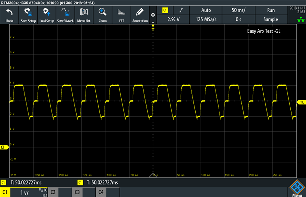

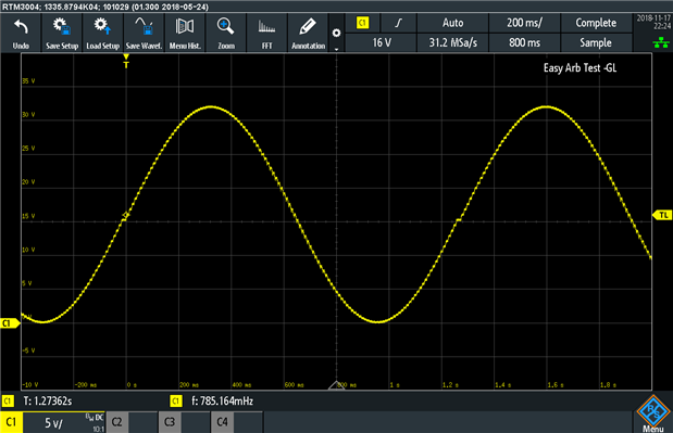

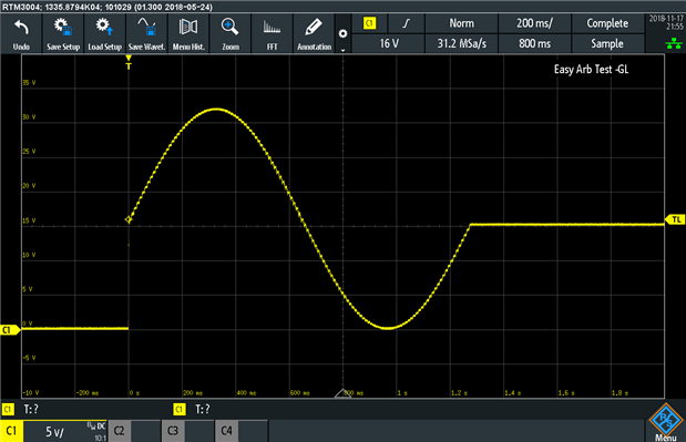

To test out the limits of the ability of the power supply, I used Excel to calculate 128 points of a sine wave centred at 16V, swinging between 0 and 32V, saved it as a CSV and imported it into HMExplorer with the minimum 10ms dwell time between samples. I uploaded this to the power supply and discovered a bug which is already known to Rohde & Schwarz and is scheduled to be fixed in an upcoming firmware update.
It seems that for EasyArb waveforms of 127 or 128 points, the unit will play them out only once. Once truncated to 126 points or less, the waveform can be reproduced continuously. A new sine wave with 126 points was calculated for demonstration purposes.

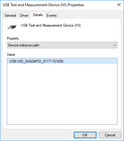

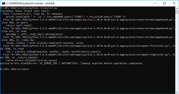

Using the HMP4040.04 in USB-TMC mode, I was able to send SCPI commands and receive responses using pyvisa running on Python 3.6. This made it possible to run automated test sequences, such as those necessary in the next chapter focusing on instrument testing. Basic instrument control, including cycling the channels, is demonstrated just fine based on the data within the user manual.
However, I did encounter some difficulties with the HMP4040.04 when it came to command synchronisation. This may be down to my naïve SCPI programming, but I noticed that programs which crash and leave a response in the buffer are not cleared when the device is re-opened which can wreak havoc or lead to out-of-sync responses to queries (e.g. an *IDN? returning a previous voltage reading). At times, reading a response will fail with an input protocol violation (extremely rare) which requires a command retry. While the manual suggests the use of *OPC? queries, I was not able to get this to synchronise my commands effectively as either it would randomly “hang” waiting for the response or it would get out of sync and the buffer would always have a response (although it was not the expected one).
The cause is not definitively understood at this time, but as a result, I fell back to “fixed” delays in the code to ensure command completion rather than through the use of polling the unit.

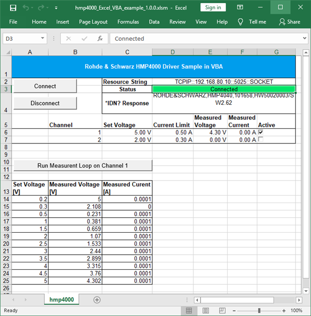

Seeing as R&S put in the effort to provide a wide range of different examples for different environments, I decided to give the MATLAB and Excel/VBA examples a try. In order to use them, the supplied VXIpnp driver has to be installed first to provide the hmp4000_32.dll that is required.
I had no problems running the MATLAB example using a LAN interface, noting that the Instrument Toolbox is not required for direct SCPI interfacing.
Likewise, the example worksheet seemed to work in Microsoft Excel, albeit with some apparent data synchronisation problem where the reading values are taken at the wrong time (off by one).image
