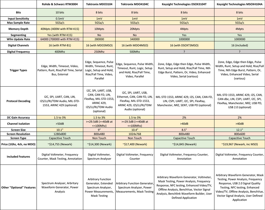

The first step is to compare it with the offerings from Tektronix and Keysight Technologies, two very recognisable names in the test equipment space.
The first thing to realise is that the RTM3004 trounces the others almost across the board - when it comes to ADC resolution, the RTM3004 offers 10 bits versus the 8 bits of the competition, which should mean four-times more vertical resolution. It also has the finer vertical scale of 0.5mV to make use of it. The 40Mpts default memory of the RTM3004 also well surpasses the competition – Keysight offering just 4Mpts and Tektronix offering 10Mpts and 20Mpts. The channel-to-channel isolation of anywhere from about >30dB for Tektronix to >40dB for Keysight is also an area where the RTM3004 is noticeably ahead, which should mean cleaner signals when dealing with multi-channel acquisitions. Even the screens of the competition don’t match the RTM3004 for clarity, offering anywhere between 800x480 to 1024x768 pixels, compared to the 1280x800 offered by the RTM3004. In fact, on this point, the differences are so vast that I’ve even made a separate comparison towards the end about screens.
Keysight’s instruments do offer segmenting by default and a higher waveform update rate of 1,000,000 waveforms/second which isn’t matched by the RTM3004 even with the added-cost RTM-K15 option. But between a choice of 400Mpts versus 4Mpts, I’d rather take the deeper memory even if that meant reducing the update rate to 700,000 waveforms/second. Tektronix’s MDO4104C with MDO4MSO claims to have a digital frequency up to 500Mhz, which is a little more than the 400Mhz offered by the RTM3004.
The RTM3004 falls behind when it comes to offering decode support for FlexRay, Manchester, NRZ, SENT, USB PD and USB 2.0. The options list for the Keysight products also seem to offer some more versatility, e.g. offline analysis and NFC testing.
As a result, I can conclude that the RTM3004 compares very favourably – the price seems quite competitive with the lower-end options from the two while absolutely trouncing them in the majority of important specifications on paper. When compared with the more expensive options from the other two, the RTM3004 still looks rather competitive, even though the RTM3004’s options list is a little shorter.

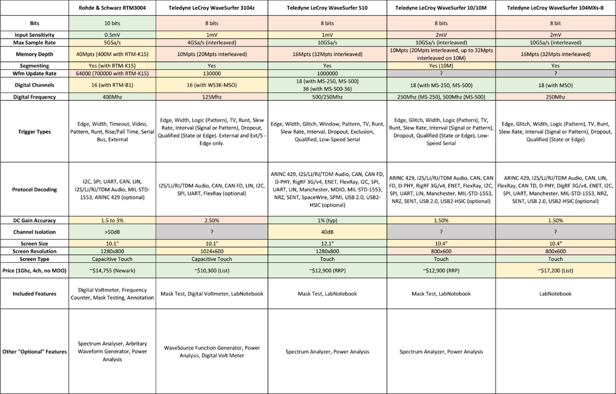

Moving over to another rather major competitor, this time we compare the RTM3004 with Teledyne LeCroy’s offerings – there are a lot of them. Generally speaking, the Teledyne LeCroy WaveSurfer offerings are all 8-bit with either 1mV or 2mV per division input sensitivity, offering either 10Mpts to 32Mpts of memory – on these parameters, the RTM3004 easily excels.
While LeCroy’s lowest-cost WaveSufer 3104z may appeal on price, its specifications seem rather compromised with just 4GSa/s interleaved for 1Ghz bandwidth which is a little low for comfort, a DC gain accuracy of 2.5%, a digital probe with just 125Mhz capability and a screen with 1024x600 resolution. When it comes to options, it is pretty sparse.
This leaves the WaveSurfer 510 and 10/10M as lower cost contenders. From what I’ve been able to ascertain, the 10/10M is nearly being phased out as the 510 offers better specs with the same price. The WaveSurfer 510 is actually quite interesting as it offers 10GSa/s sampling rate, a waveform update rate of 1,000,000 waveforms/second, 18-or-36 digital channels (depending on option) with a maximum frequency of 250/500Mhz (depending on channels) and extensive protocol decoding options available. The screen offers the same resolution at a larger 12.1” size. The DC gain accuracy of 1% may be a little optimistic, as it is a “typical” value. In these areas, the WaveSufer 510 is preferable to the RTM3004.
By comparison, the 104MXs-B doesn’t appear competitive, as it has some of the limitations of the older WaveSufer 10/10M and a higher list price to boot.
As a result, I’d have to say that the WaveSufer 510 comes the closest to challenging the RTM3004. It has a slightly lower RRP with a healthier list of options, especially when it comes to serial decoding, and offers a higher sample rate, higher waveform update rate, more optional digital channels with higher frequency and larger screen with equal resolution. However, the RTM3004 offers better vertical resolution of 10-bits, higher vertical sensitivity, more memory, better channel-to-channel isolation and the ability to be upgraded for arbitrary waveform generation/pattern generation. As a result, it’s a bit of a draw – depending on whether you have a preference for analog or digital.

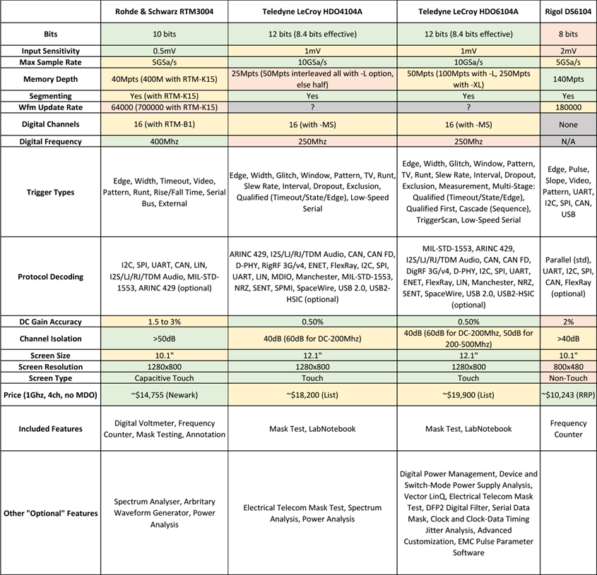

LeCroy also offer their HDO series, which offer higher vertical resolution of 12-bits, 10GSa/s sample rates and segmented memory with upgrades. The HDO4104A and HDO6104A both offer more flexibility with protocol decodes, better DC gain accuracy and have a larger screen with equal resolution. However, even with their memory upgrades available for the HDO, the RTM3004 offers a more total memory after being upgraded. The RTM3004 offers better channel-to-channel isolation across the full bandwidth and has a higher working digital probe frequency. Keeping in mind that the HDO series is significantly more expensive than the RTM3004, Rohde & Schwarz’s offering is still very attractive.
Last, but not least, I look at Rigol’s offering. Unfortunately, Rigol has no MSO offering, thus their “best effort” oscilloscope is being compared – the DS6104. In practically all points except price, sample rate, (default) memory and waveform update rate, it is notably inferior to the RTM3004. If you’re after an MSO, then that’s too bad.

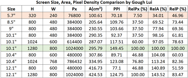

Screens: The Window into the Scope
While performing the comparison, I noted that there was a significant discrepancy in both size and resolution of the screens of the candidate units. Seeing as the screen is primary form of interface for someone using the unit interactively, having a good screen is of great importance. As a result, I compiled a table of sizes and resolutions and computed the total number of pixels, screen area and pixels-per-inch (PPI) density of the screen to better understand the relative sizes of screen and their sharpness.
For added fun, I threw in the screen specifications for my “entry-level” Rigol DS1102E two-channel 100Mhz oscilloscope that I’ve been using from time to time for a laugh. Note that the values for this screen (5.7” 320x240) are not included in the comparison in the commentary below.
By looking at the comparison, it’s clear that the 1280x800 resolution is the highest amongst the competitors, offering the highest resolution images. Some of the competitors with 800x480 screens offer just 37.5% of the pixels! With a screen size of 10.1” on the RTM3004, it’s not the largest screen of the set, but it offers the sharpest display at ~150ppi which is equivalent to a number of tablet displays. For reference, an average computer monitor has about 94-108ppi. The screen size of 10.1” offers around 30.5% more area than the smallest of the crop (8.5”).
While a 12.1” 1280x800 screen may have been better, offering more area to use the controls and an equal resolution, considering the positioning of the RTM3004 and its competitors, a 10.1” screen is still very much better than expected.
