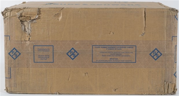

Rather interestingly, my unit arrived a day early by UPS having travelled half-way around the world from Newark element14 (USA) and enduring prior shipment from Rohde & Schwarz to Newark. It definitely looked a little tired from the journey, with all corners rounded and a few minor dents into the box. The box is sealed well using reinforced tape, so it doesn’t seem to have been tampered with, even if some tears are beginning to appear. Surprisingly, the box doesn’t seem as big or quite as heavy as I would have expected.
Looking at the underside, it looks like there is some more damage to the carton. I suppose that’s to be expected given the amount of handling involved in getting this particular unit to me – but I’m hoping it survived unscathed.

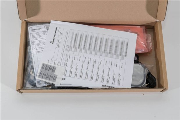

Going back to the cardboard box on the top, opening it up reveals all of the goodies – including the license keys (for reference) for all the options which are already pre-entered permanently into the unit’s memory (when ordered from the factory).
Once laid out, we can see there’s a few documentation items, four 500Mhz 10:1 passive probes, two RT-ZL04 400Mhz 8-channel logic probes, an accessory case and two IEC power leads – one for EU countries and the other for US. This might be localised depending on which country you order it from – in my case in Australia, I had to use my own IEC lead. Packing lists are included so you can check for completeness. You might have noticed a lack of certificate of calibration – this is because Rohde and Schwarz offers them by online download using the device ID of the instrument.

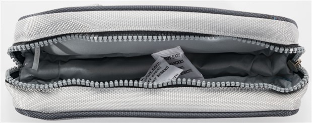

I thought the accessory case was a nice inclusion to have, especially since digital logic probes are known for having many small wires and clips which can easily get lost otherwise. They even went as far as to include desiccant packets just to make sure it’s “fresh”. Good work Rohde & Schwarz!

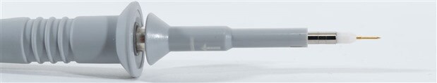

The probe itself feels solidly built with a thin and comfortable-to-use shaft. The tip itself has a wonderfully sharp tip, making it a joy to use for closely spaced connections and has a springy feel which makes it easier to keep the probe precisely positioned when holding it by hand. The shaft also has a marking to inform the user as to how far they need to push the pincer tip to get it to click into place.
The coax is also relatively flexible and easy to route. I can definitely feel the Made in Germany quality exuding from the whole probe assembly.

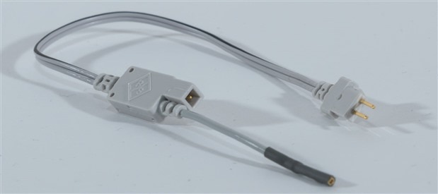

The channel break-out cable can be connected to a position (it’s keyed so it can only go in one direction) and provides a “socket” which can accommodate a standard header pin for the signal. The ground is provided via a standard header pin at the “bulge”, to which a “short” lead can be attached to the pin, leading to another socket for ground connection.
That’s what it looks like once plugged into the pod. The channel break-out cables did feel rather thin, so I think it’s best to take care when hooking them up or disconnecting them.

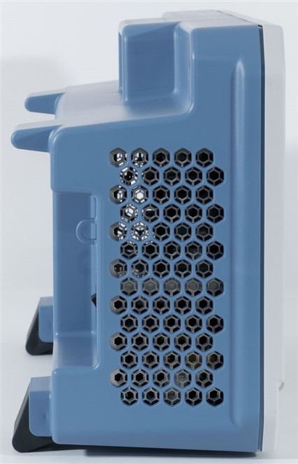

To the left, it’s just vents, whereas the right side has vents as well as the two logic probe pod connections. Of the whole unit, this is probably the only slightly weak part, as pressing on the plastic near these connections results in an audible creak, whereas the rest of the case is practically solid.

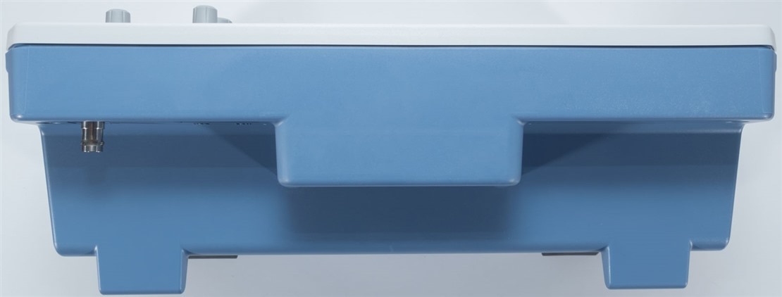

From the top, there’s not much to see – the handle is moulded into the case and doesn’t “swing out” as with some other units.

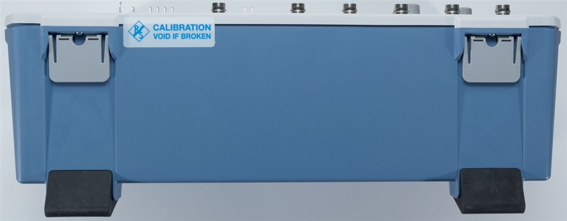

From the underside, we can see the rubber feet, two flip-out plastic feet and a calibration seal.

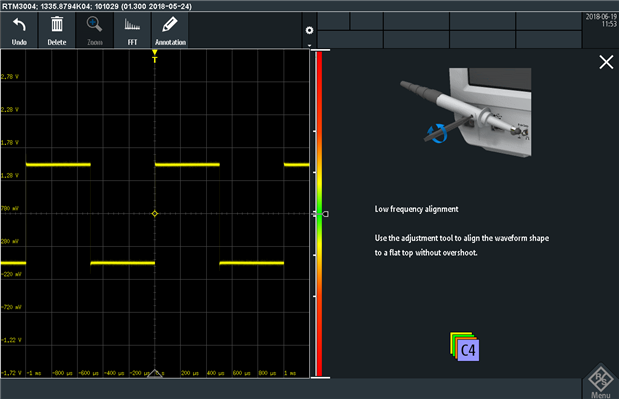

Another necessary task is usually to assign each probe to a channel, put on the coloured collars for identification and align them using the probe compensation output on the oscilloscope to ensure a proper response. For this purpose, I was quite impressed that the RTM3004 has an “app” to do this that guides you through the process.
Initially, the unit warned me that the alignment was not necessary – according to the probe manuals, they should be pre-compensated correctly to match, but as I wanted to be extremely sure, I decided to go ahead and give it a tweak anyway.
The alignment process was straightforward with a colour-coded bar in the centre and an indicator showing whether your probe is under or over-compensated. As long as the marker is within the middle two ticks, the probe is properly configured.
