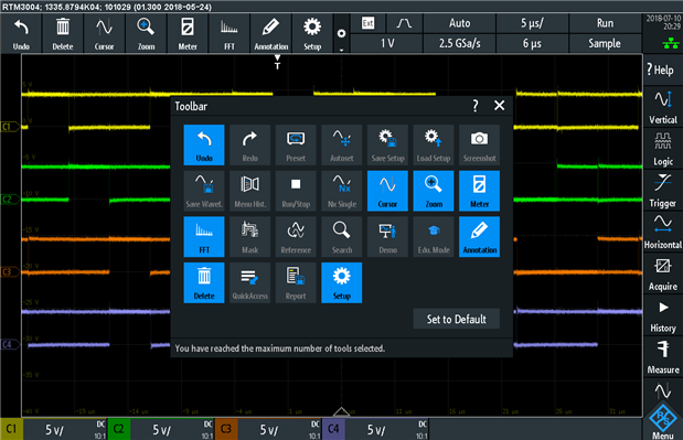

Almost of the oscilloscope’s operations can be achieved using the touch screen. The main menu is the rhomb menu in the bottom right corner of the screen, which brings up a sliding menu which can be swiped to select the function, calling up a submenu where options can be selected, toggled and values manipulated. For example, in this case the display settings are being configured, with clear toggles and values which can be manipulated by selection, direct entry or by turning the multi-function knob. In my experience, the menus were quite responsive, although swiping the main menu up and down did result in some jerkiness.
On-screen keyboards are available for entering numeric values and filenames. On-screen help is also available, making the operation rather intuitive. Aside from the rhomb menu, there is a quick toolbar menu across the top where you can “pin” up to eight quick buttons from a selection.
Something which wasn’t immediately obvious to me was that each of the channel labels in the toolbars and the sample mode/trigger icons in the top right area are actually shortcuts to a short menu for configuring the most commonly toggled settings that can also be used to quickly invoke the full menu for more advanced configuration.

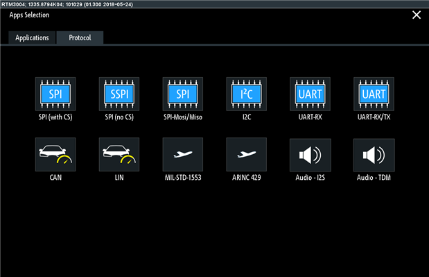

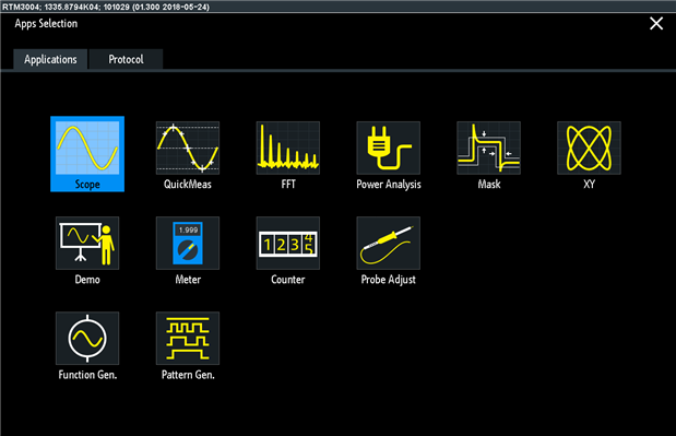

Other features are available through the Apps selection which can be invoked from the rhomb menu or via the dedicated front panel button, allowing access to installed options.

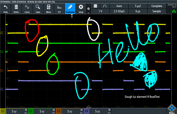

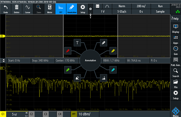

The touch-screen lends itself to a more intuitive note-taking process as well, with the inbuilt annotations tool allowing you to draw over the screen in a number of colours and add a single line of text to label your discoveries. This is potentially quite useful, although the single text box with a short line of text is somewhat limiting.

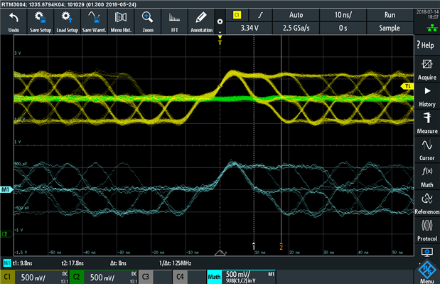

For example, the above is the 4-level signal from the magnetics of the Ethernet jack when a 100Mbit/s connection has been established. Unfortunately, the RTM3004 doesn’t have Ethernet decoding.

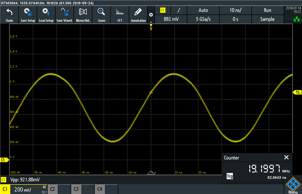

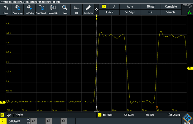

The above shows the two oscillators on the Raspberry Pi – one at 25Mhz and the other at 20Mhz. The hardware trigger counter gives us a good idea as to its frequency without using the measure tool.
The above shows an intermittent clock – the one used on the SD Card which is only active when the card is being accessed. A nice 25Mhz, as expected.

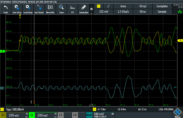

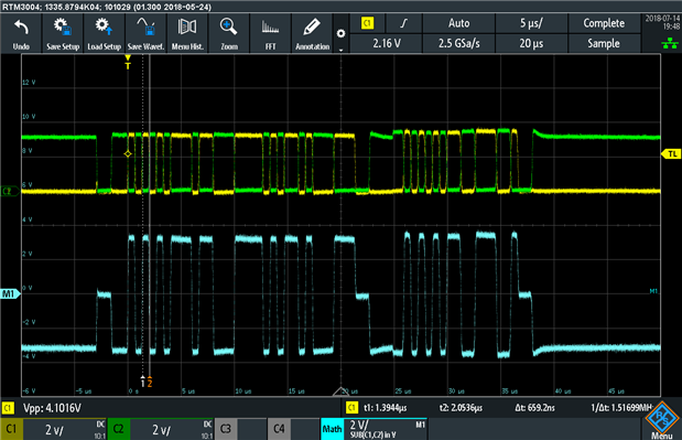

Finally, two traces – one showing a 1.5Mbit/s low-speed USB device (keyboard) and its D+/D- lines. The other shows the Wi-Fi adapter connected in 480Mbit/s high-speed mode, although the signal is somewhat noticeably corrupted by the influence of the long ground wire. Unfortunately, the RTM3004 doesn’t feature USB decoding.

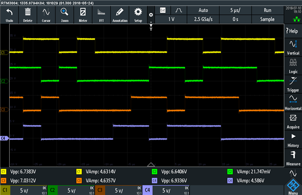

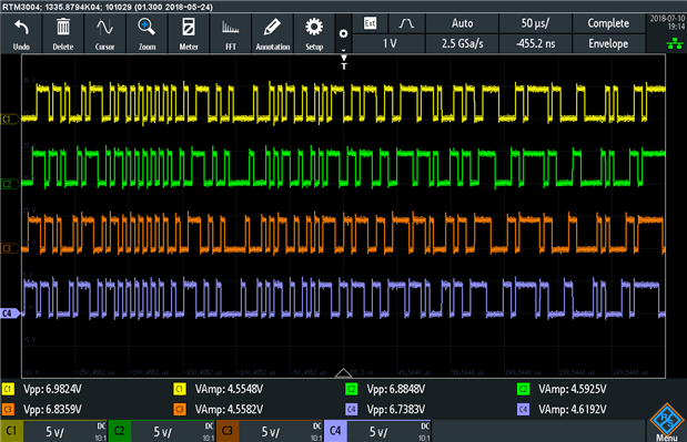

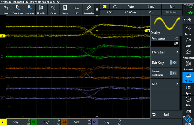

To test the external triggering facility, I used a VGA to RGBHV lead with the terminations set to 50 ohm (close enough to the 75 ohm expected) to plot the signals.

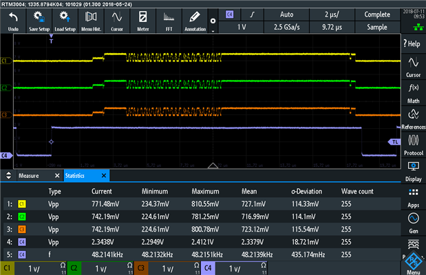

The RGB lines are connected to C1, C2 and C3 respectively. C4 has the horizontal sync signal, whereas the vertical sync signal is connected to Ext Trig. In this case, I have triggered on the horizontal sync, but it was also possible to change to vertical sync simply by changing the trigger source.

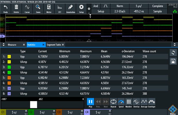

Eight measurement slots are available which support measurements such as burst width, pulse count, edge count, mean value, RMS value, peak value, frequency, period, amplitude, base level, overshoot, pulse width, duty cycle, rise/fall time, delay, phase, crest factor and slew rate. Manual cursor measurements are also available.
The active measurements can have the statistics mode turned on, allowing for means and standard deviations to be recorded across acquisitions.
An automeasure feature is provided which only operates on one channel but automatically chooses relevant measurement parameters and illustrates it visually on the screen.

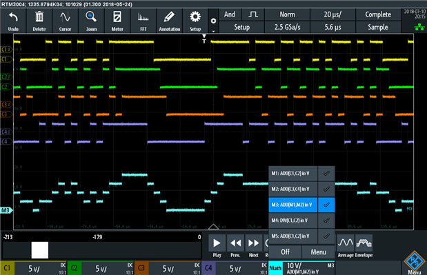

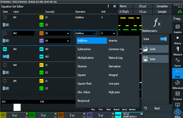

Math channels are available, up to five, with two oprands each and configurable operation and units.

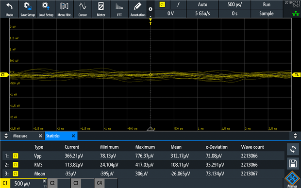

Given the ability to do basic measurements and statistics, I thought it’d be nice to just run a quick check of the channel input noise. I disconnected all inputs, set C1 to 1:1 at the highest sensitivity and shortest timebase and let it average for a while.
The channel input noise measured an average RMS value of 108.11µV which is rather unexpectedly low. Keep in mind, this was inside my room with RF interference, unshielded LAN cables, USB cables etc. The peak-to-peak voltage was averaging 312.17µV which isn’t bad either. I suspect this is why I found the instrument to give pretty “quiet” traces compared to other units I used in the past. In fact, it’s that quiet that sometimes I forget I’m measuring small signals at the end of a 10:1 probe!

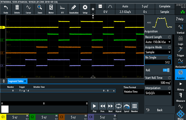

The oscilloscope offers four main sampling modes and other modes which are a combination of them. The default mode is Sampling, which takes a single sample to produce a reading on the screen. The High Resolution mode reduces the effective sampling rate for longer timebases by averaging a number of samples together to produce a more representative value. Unlike some of the other oscilloscopes I have used, there is no configuration options, so the trade-off between sample rate and resolution increase cannot be tailored. There is also Envelope mode which shows the highest and lowest values of the samples representing the signal on the screen and a Peak Detect mode which only shows the highest values. Examples of them and their influence on the signal from my Mega 1280 LFSR are shown below.

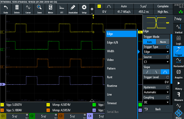

The RTM3004 is capable of triggering on a variety of conditions, including Edge, Edge A/B, Width, Video, Pattern, Runt, Risetime, Line, Timeout and Serial Bus. Most types also include a hysteresis setting. The serial bus trigger feature depends on the serial bus decode options installed and activated at the time. The trigger level can be changed by the dedicated knob which can be clicked to automatically set the 50% level, working quite well for most signals. Further details can be found in the manual.

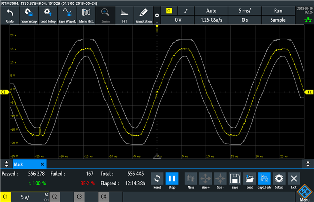

The Mask Test functionality is included as standard with the RTM3004 which is a nice feature to have. Masks can be defined from measuring a “golden template” waveform and scaling it in the X and Y axes, or through importing reference waveforms. The mask test can be configured to save failures to the segmented memory buffer, beep on failure, save a screenshot, output a pulse, etc.
Experiment: AC Power Line Waveform
A waveform that can have occasional “violations” is the mains power. Direct measurement of mains power is dangerous and the oscilloscope inputs are not rated for such operation, so I measured the output from an isolated AC step-down transformer. A mask was developed by scaling the “regular” waveform generously – in this case, a number of violations were caught over 12 hours which were stored in a memory buffer and output to screenshot. This was a case where a power transient was caught.
Such an interruption can occur due to a switching transient – imagine if this happened at the peak of a waveform, the voltage can be almost 30% higher than the nominal value.

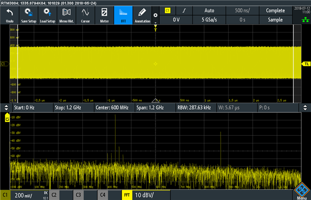

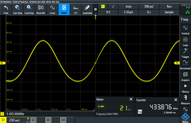

The RF domain is one space where FFT displays are commonplace, so I measured the signal from a “cheap” 433.92Mhz ASK transmitter module. This would be “close” to the 500Mhz bandwidth limit of the passive probes.
Using the more-accurate hardware counter, the frequency was 433.876Mhz (compared with the measurement report of 433.369Mhz), the signal showing a good 820mV peak to peak roughly. Because of the frequency limit of the hardware DVM, the reading was nearly zero.
Using the FFT mode, it is possible to see the signal in the frequency domain. The settings for RBW/Span/etc. are connected with the recorded signal length, so adjustment of the time-domain timebase to longer values is necessary to achieve narrower RBWs. In this case, we can see stray emissions about 16 and 32Mhz either side of the intended frequency.
Zooming out on the FFT also reveals a second harmonic emission at twice the intended frequency.

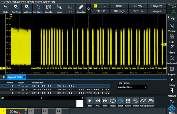

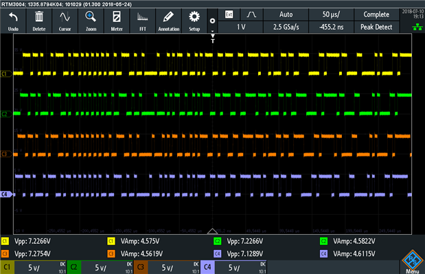

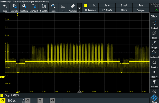

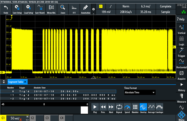

To illustrate the advantages of segmented memory, I set-up an experiment to look at raw infrared remote signals as received by an IR phototransistor. In this case, the oscilloscope triggered at the beginning of each signal and recorded the signal up to the configured sample length.
This allowed me to hit the “Single” button on the oscilloscope, mash every single button on the remote in sequence and have all the button data in the memory without having to do it one-button-at-a-time. This data can then be saved in a batch export as well.

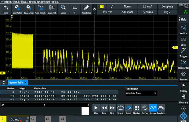

The history mode has a segment table which shows the time for each recorded segment in a number of different time formats. The segments can be explored one at a time, directly accessed by number or via the slider. Otherwise, they can be replayed either singly or in a loop.

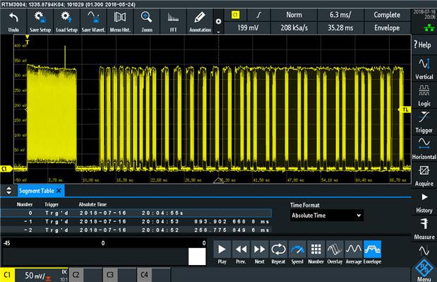

Three modes of basic analysis are provided – overlay, average and envelope. Using this, it is easy to spot “constant” parts of the signal between captures amongst other commonalities.

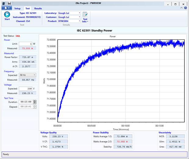

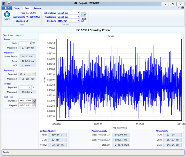

As I was formerly awarded a Tektronix PA1000 Power Analyzer, I thought I’d run an experiment just to check what the standby and operational power requirements for the RTM3004 are.
Using my test rig consisting of a “pure sine wave” synthesised mains source, Variac and PA1000, the standby power as measured to the IEC 62301 standard at 230V was just below the required 1W level, measuring 0.9745W. This meets the requirements but is still a little high for just powering a power LED – the USB and Ethernet interfaces are shut down. It suggests that maybe there is something else going on – maybe there is a processor running or some RAM being refreshed to enable faster boot-up times?
Turning the unit into active mode, the power consumption was measured using the same standby test to show power trends over time. The power consumption stabilised about 72.555W in operation, which is similar to that of a high-end laptop computer. Despite this, the large fan kept the unit at its operating temperature without making a distracting level of noise. The fan was only noticeable when the room was silent but did not have any strong tonal qualities. My Rigol DS1102E had a fan which is quite significantly louder.
