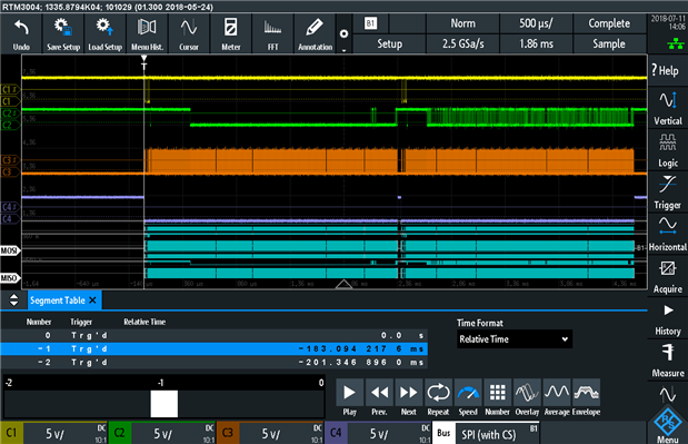

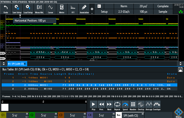

To explore the SPI protocol decode option, I used an Arduino Uno and Sparkfun microSD Shield with the Cardinfo sample code to generate some traffic. This should generate a series of SPI transactions between the Arduino (transmitting at 5V, going through a buffer as a level shifter) and the card (transmitting at 3.3V). All four lines were connected for decoding.
A decode with the unit starting off in the reset state shows the first data burst after a reboot. This appears in the bus table as two lines – one for each direction with a string of bytes sequentially shown, which is truncated.
It is possible to zoom into the display and shift the trigger point to see each of the bytes in the comb display. Using the history bar, several bursts can be analysed including a longer bi-directional transaction (note C2 which shows more activity) which is probably reading the file-system on the card.
An issue was identified in saving the bus table of multiple-data-line protocols (e.g. SPI with MOSI and MISO, UART with RXD and TXD) resulting in the oscilloscope locking up. This issue has been reported to Rhode & Schwarz for rectification. Furthermore, the issue in regards to the long data strings from SPI captures being cut-off in the bus table has also been reported for investigation.

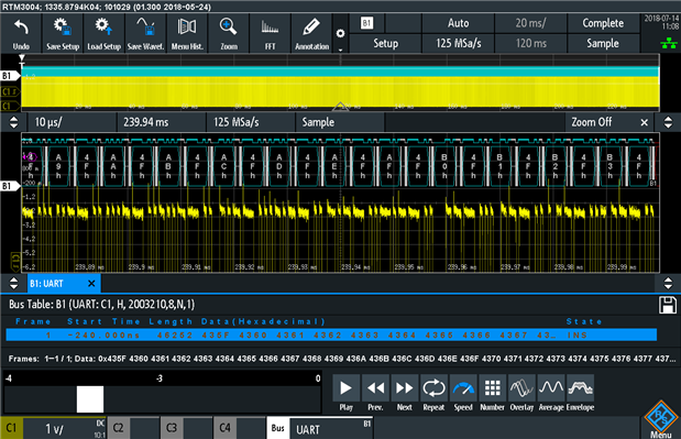

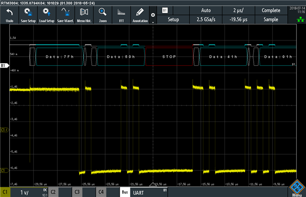

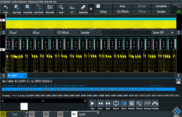

I decided to try and kill a few birds with one stone in this experiment – I was interested in what the maximum UART rate of an Arduino Uno was, whether the RTM3004 would work with fairly custom UART rates and what the “dead-time” or “blind-time” between acquisitions is. This is important especially for long or continuous data-streams where data can be lost between the memory buffer filling and the next trigger happens.
To do this, I programmed a simple program that constantly emits easily recognisable character sequences at the maximum rate the Arduino Uno is capable of which is 2Mbit/s. The sequences basically run as a pair of bytes – the first starts at A followed by a second byte which goes from 0x00 through to 0xFF. Then the first byte is incremented to a B, and this is repeated until we reach Z followed by 0xFF, which rolls back to an A. For more details, see Appendix. The trigger was set to serial trigger and fast segmentation was enabled.
It was determined that the dead-time was effectively almost zero, with part of the last byte in each capture “broken” but the next segment starting at the beginning of the byte that followed – e.g. 0x43 0x5D, 0x43 (broken between buffers), 0x43 0x5F in the first pair and 0x4F 0xB3, 0x4F (broken between buffers), 0x4F 0xB5. The only byte lost was the byte broken in-between buffers, which is good news.

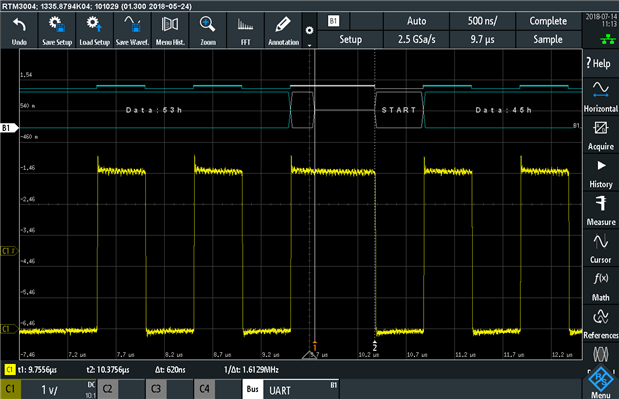

Most people have mentioned that the AVR isn’t really capable of doing the processing necessary to make proper use of the 2Mbit/s bit rate. While I’d be inclined to agree in some degree, this trivial program showed that the latency between emitted bytes only about 620ns.
An issue was detected where a false start condition was detected on a short glitch of the input, too short to be a reasonable start bit. I have suggested to Rohde & Schwarz that maybe some filtering of the pulse widths is necessary to determine whether it is an intentional “bit” or glitch to avoid the decode window being opened early as in this case.

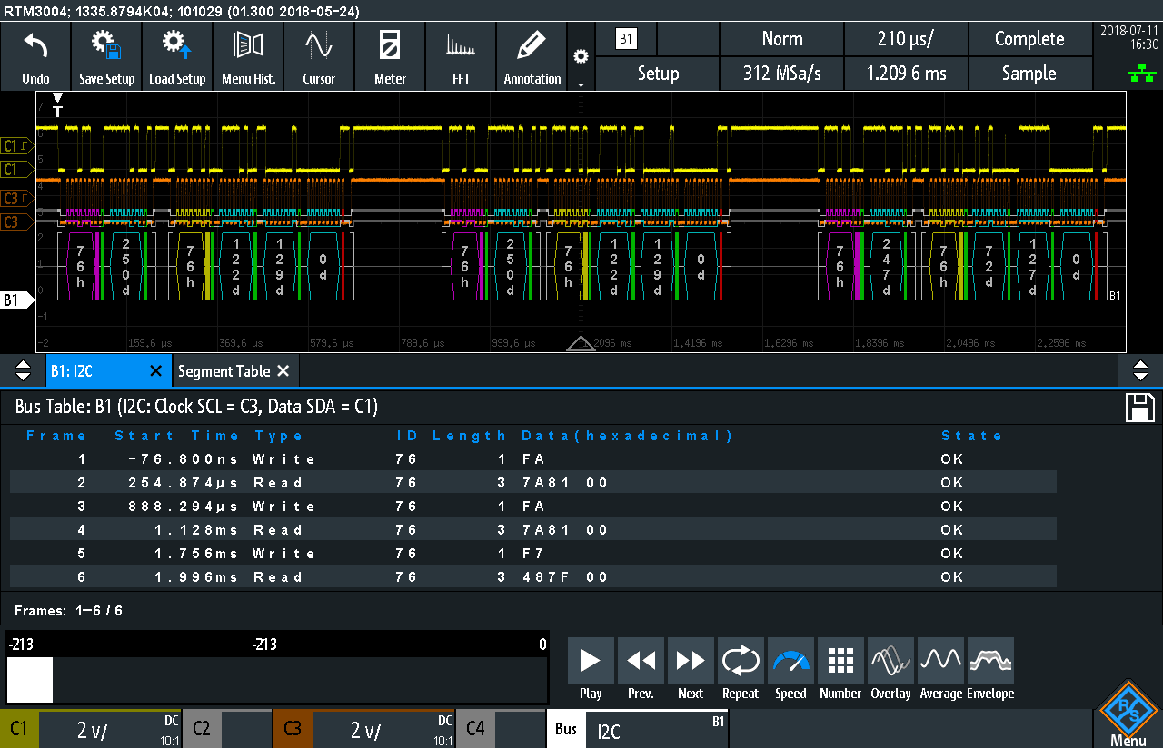

To test I2C decoding, I decided to co-opt a little project I’ve been building just for fun which uses a Bosch BMP280 sensor with the Adafruit library. This project basically just periodically reads the temperature and the barometric pressure from the sensor, resulting in an intermittent stream of I2C traffic which can be analysed.
With a few frames captured into the fast segmentation memory and analysed, a few timing variations between requests are visible, along with the changing values due to changes in physical parameters. The decode itself is colourful, indicating clearly which is the device address, register, access type and acknowledgement status. In fact, we can see that the first two transactions are usually the same, which indicates to me that there’s an inefficiency I can probably “code away” – requesting the barometric pressure actually requests the temperature as well (it seems). Because I had adjusted the time base and record length, it was possible to fit 213 records into the segmented memory, triggering just once every time the three I2C transactions were being run (once a second). This allowed for monitoring over the space of around three and a half minutes of values.

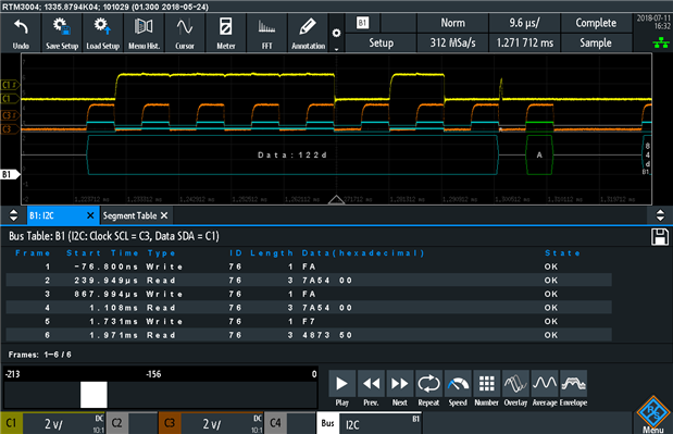

This is more clearly illustrated if I zoom in on just one transaction. I find that the labelling is very clear and easy to understand and unlike the SPI example, the bus table decode is very well presented due to the brevity of the transactions.
While reading about other people’s experiences with I2C debugging, I came across a discussion mentioning something termed an “ACK spike” by some people. This is a short transient glitch in-between when the sender “releases” the bus and the receiver “drives” the bus to acknowledge the transaction. It was good to see it for myself on the oscilloscope.

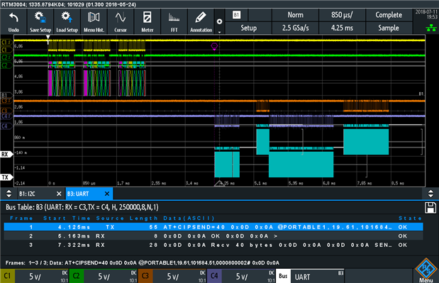

Experiment: Mixed I2C and UART Decoding of ESP8266 AT-Command Project
Well, the project involving the Bosch BMP280 actually involves an Arduino Pro Mini and an ESP8266 ESP-01 Module in AT Command Mode. The project basically reads the sensor and assembles a text string which is sent to the ESP8266 to send as a broadcast UDP packet. This provides a perfect opportunity to demonstrate the ability of the RTM3004 to perform multiple bus decodes in parallel. The RTM3004 offers four slots for decoding, but it’s important to remember that some modes require the use of two slots (e.g. UART with both RXD and TXD lines). This can be extremely useful when debugging unusual behaviour – e.g. was the sensor at fault? translation code? Wi-Fi module? etc.
It is possible to use a single capture to catch the I2C read from the sensor, perform the conversions and then send the necessary AT commands to the module to send the result. The UART link is operating at 250kbit/s, another custom rate which seemed to work without a hitch.
The labels inside the comb display can be changed to ASCII which makes interpretation of the data very easy. A slight violation is seen in timing, as I begin sending the data packet as soon as I receive “OK” from the module – but the module hasn’t finished sending its response. It doesn’t seem this causes any harm though. The turn-around from sending the command to send a 40-byte message to when the ESP8266 is ready to receive it is 746.4us.
It is possible to trigger on byte sequences up to three bytes long, so alternatively rather than triggering on a start-bit, I could have triggered on “AT+” so as to monitor every single request to the ESP8266 in AT Command Mode. As I realised it was a little wasteful to use an Arduino and an ESP8266 in AT Command Mode, I refactored the project to use ESP8266 Arduino Core to do the same thing but more efficiently. But then I wouldn’t be able to show off the mixed protocol decode feature …
