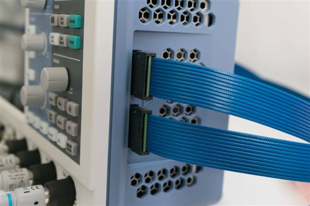

The digital logic channels are connected to the right-hand side of the oscilloscope through two coax-ribbons which connect to two identical pods hosting eight channels each. As for which pod is designated the “high” or “low” byte, this depends on which port it is connected to on the oscilloscope. The other sides of the pods are connected to break-out cables which allow for connection to individual bus lines and ground lines. Each signal line can be individually grounded for the best signal fidelity, with provision for each pod to be grounded through one or two connections for convenience. The relevant cables and test clips are included in the bundle. To see the hardware, refer to the unboxing in Chapter 2.
Each of the logic channels has an input impedance of 100kΩ || 4pF which is not as high as the analog channels but very sufficient for most digital signals. It is capable of up to 400Mhz input frequency and 0.5 to 40V peak-to-peak swing with configurable threshold ±8V in 25mV steps and hysteresis. The system is capable of measuring at 2.5GSa/s on both probes or 5GSa/s on one, with 40Mpts memory for every channel using both probes or 80Mpts memory for every channel with just one probe.
While some people seemed to have an objection to the channels coming out of the side of the oscilloscope, I didn’t find this a particularly problematic arrangement as there should be clearance of at least 10cm on all sides for ventilation anyway. The flexibility of the coax ribbons and their length provided versatility in positioning compared to some shorter digital probe cables connected to the front panel of other oscilloscopes. One possibility was to have the RTM3004 propped up on its front flip-out feet and thread the cable behind and underneath the unit for a relatively compact arrangement. Having two pods of 8-bits each allows for ease of positioning when probing two distinct separated buses. The digital channels can be used in parallel with the four analog channels for a total of 20 channels and protocol decoding is also possible on the digital channels.

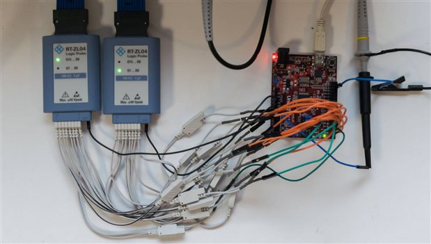

Experiment: Uno32 Linear Feedback Shift Register
For the first test, I decided to drive all 16 digital lines from the outputs of a Uno32 simulating a 16-bit maximal LFSR and one analog input with a toggle clock (more details, see Appendix). I used cheap no-name prototyping “Dupont wire” connections using just one shared ground for each pod. The colours were somewhat random, basically what I had at hand.
I had the logic probe ribbons fed underneath the oscilloscope, and the setup was quite neat given the number of connections involved.

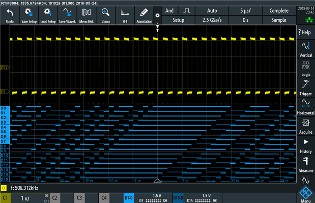

The digital channels are denoted in blue on the display and can be independently moved and scaled. In the toolbar at the bottom, the status of the channels is also indicated – in this case they are all denoted as toggling as expected. In this case, I also have an analog “clock” channel active showing how the channels can be used together. The trigger point is at the state where all ones are appearing at the output of the LFSR.

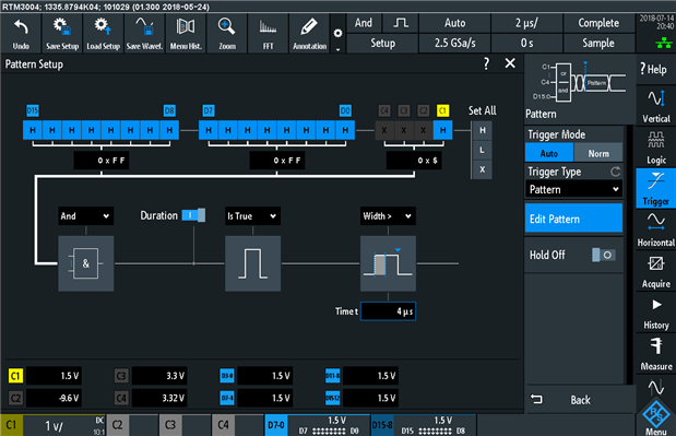

This was achieved by using the pattern trigger mode which allows you to specify a bit-pattern to look for combined with a particular condition – in this case, width.

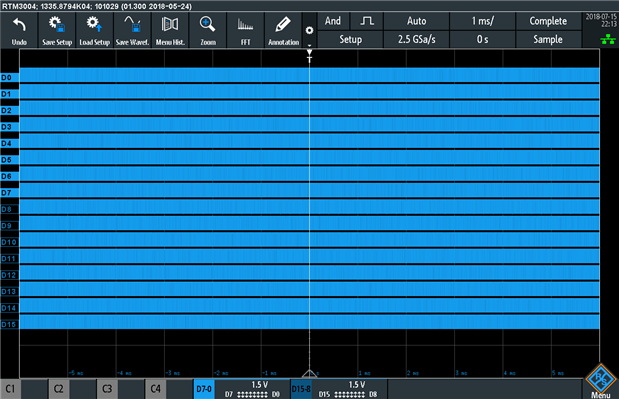

While the Uno32 only puts out about 1Mhz update rate, I wanted to test the RTM3004, so I set about doing an extended capture spanning about 60ms.
Zoomed in, it’s still easy to see the detail – the digital channels clearly show three distinct change times with correspond to the bit-arithmetic of three separate ports required to produce the output. Given that 625MSa/s was still being achieved, being able to see this detail is probably no great surprise but illustrates the importance of memory.

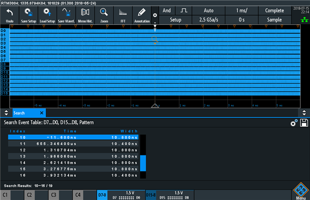

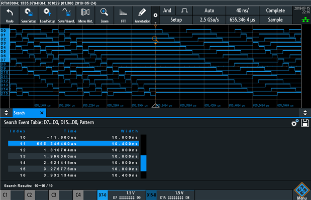

This time, I decided to repeat the same experiment, instead focusing on capturing 12ms of data and demonstrating the search function. Using the pattern search, it is possible to search inside the memory buffer for events.
As the LFSR has a total of 216-1 states (i.e. 65535 states) clocked at a rate of 100Mhz (10ns/state), we expect it to reach the all-ones state every 655.35us. Indeed, the event table says exactly that.
The event table allows you to select a search result and zoom in on it directly – we can clearly see that is the “event” we are looking for.
