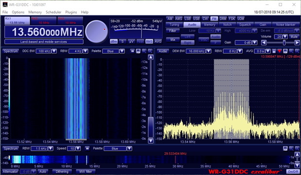

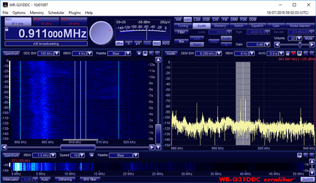

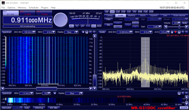

Experiment: A Radio Station
It occurred to me, with the modulation available, it is possible to use the RTM3004 to generate signals that could be received on a radio receiver. To do this, I chose an empty portion of the AM band (due to maximum frequency limitations on the generator) at 911khz. The only exception was for FM, due to spectral width, I chose to use the ISM band also used for NFC cards at 13.56Mhz to ensure no interference with licensed services. The signal was received using my Winradio G31DDC software-defined radio. The generator output was attached to a piece of loose wire.
Signals were successfully broadcast and received in AM with 1khz tone, ASK with 440Hz modulation, FM with 1khz tone and 5khz deviation, and FSK at 2Hz with a 500Hz shift frequency. This is illustrated in the waterfall diagrams above.
Unfortunately, as the modulation is not flexible enough to accept an input for modulating the generated function, it is only possible to transmit tones.
