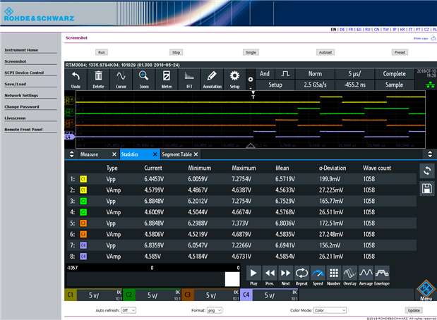

Web Browser (LAN)

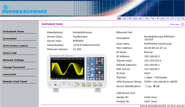

The simplest way of getting started is to use the LAN interface and hook it up to your network. Plugging the IP address into a web browser allows you to access the instrument. From this main screen, you can change languages, see the status of the instrument, use the “identify” feature to find the instrument by showing a message on the display and move through several other screens that allow you to reconfigure and remotely interact with the instrument.
The Screenshot page displays a screen image, allowing you to toggle some settings and have limited control of the oscilloscope. This may be useful for more basic browsers which might not be compatible with the more advanced features.
SCPI Device Control allows you to send single commands and read responses – nothing too special here.
Save/Load allows you to save or load data to or from your computer to the oscilloscope’s memory or connected storage.

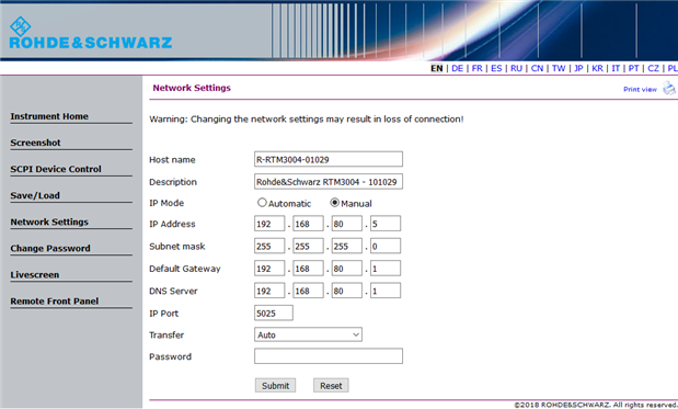

Network Settings allows you to reconfigure the RTM3004 Network Settings remotely. This is useful, but if you get something wrong, the unit may become unreachable until the settings are corrected using the front panel.

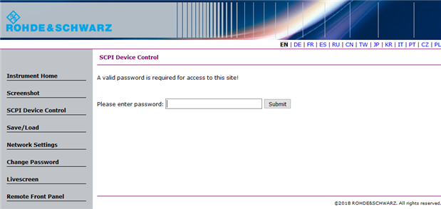

Change Password allows you to change the access password for the web browser interface.
Having a password on the interface is quite useful as it stops any passer-by from being able to manipulate your instrument without first keying in the password. The protection is, however, quite weak as the connection is plain HTTP and other ports are available on the instrument for direct access.
Livescreen provides a self-refreshing remote view of the screen without any control features. This is particularly useful if you just want to see the image remotely without clutter on the side or the risk of accidentally remote-controlling the instrument (e.g. for education to project onto the screen in an auditorium). The performance is quite good, as this 3-second-looped GIF shows (noting this is “at home” via software screen capture on Firefox – it could be even faster depending on the browser/computer).
The pièce de résistance, however, is the Remote Front Panel. This feature works extremely well and allows browser-based remote access to everything – you click in the screen, it acts if you’ve physically touched the screen. Drags, keyboard input and even rotating the virtual knobs are all faithfully relayed to the instrument. It is an absolute joy to use.

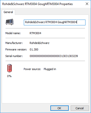

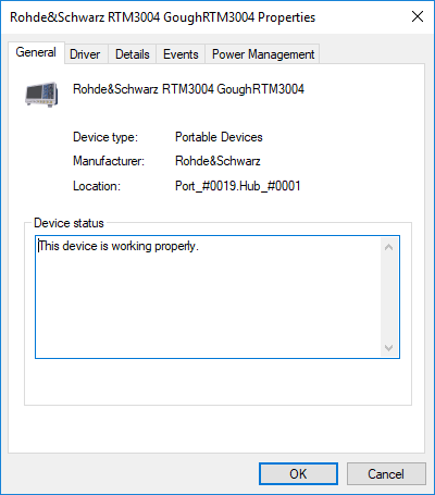

USB MTP Interface

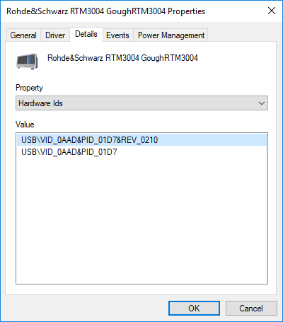

The default USB interface selection appears to be Media Transfer Protocol (MTP), which turns the RTM3004 into something more like a smartphone connected via USB. This does not require any driver installation and is detected as a “Portable Device”. The device has a VID of 0AAD and PID of 01D7.

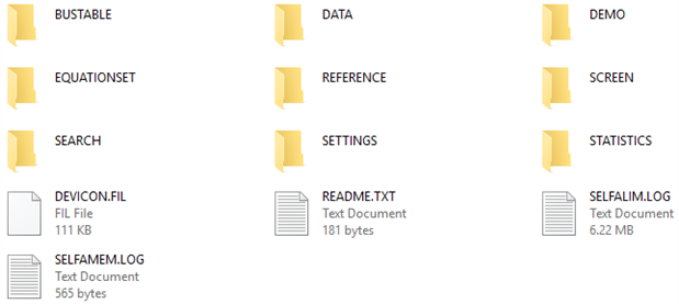

The device can be browsed through the file manager, exposing three different folders – Internal Storage, Live Data and Upload.
Internal Storage provides access to the data in the internal storage of the RTM3004, arranged as shown in the folder listing below.
Live Data is a virtualised filesystem with many files having a “dummy” size, allowing you to copy or view the files which are then live generated on request.
Finally, the Upload folder seems to be used to send data to the RTM3004 and is otherwise empty except for an explanatory document.
This is a rather interesting alternative way of using USB to allow for access to the oscilloscope data, but is rather limited, as it doesn’t have any capability for remote control via SCPI commands. Other than via LAN, only the USB VCP and USB TMC interfaces offer this possibility. In those modes, MTP access is not possible.

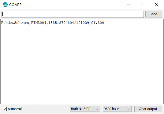

The USB Virtual COM Port (VCP) interface is a simplified way of being able to communicate with the instrument over USB. This presents a USB COM port based on the USB CDC class, similarly to how a USB to TTL UART adapter would work, thus meaning that communicating with the instrument is as simple as sending SCPI commands through to a COM port.
The device is recognised under Windows 10 with no additional drivers required, using a VID of 0AAD and PID of 013C.
I sent the basic *IDN? Command over using the Arduino IDE’s serial monitor and confirmed that this works, making it a good simple option for those who don’t want to bother with working with VISA libraries.

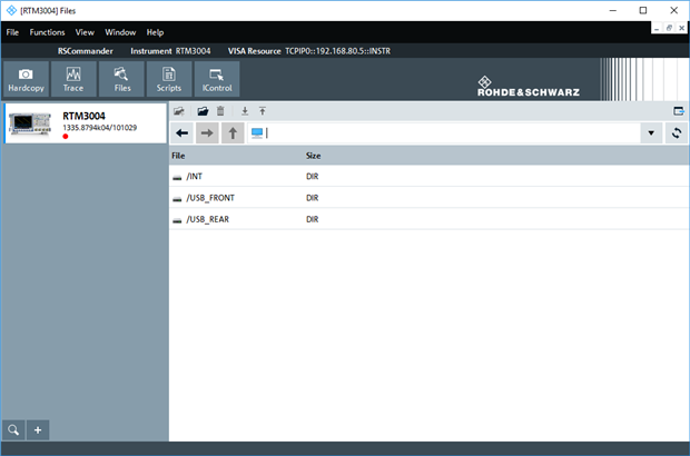

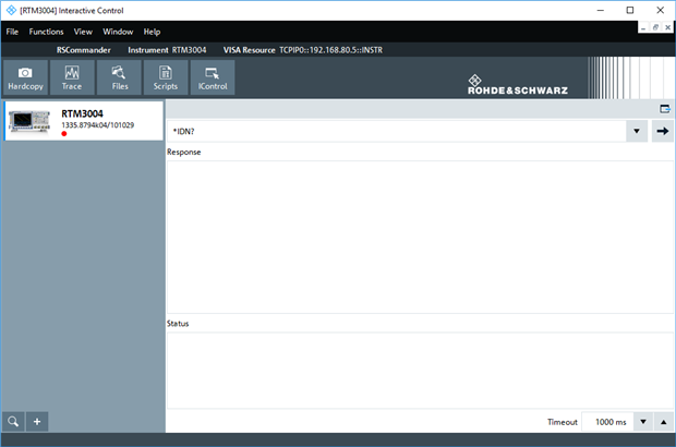

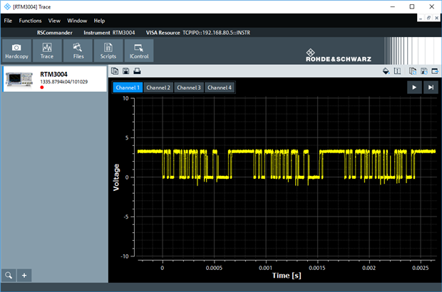

RSCommander
The RSCommander installation process was rather straightforward. Depending on the interface, in order to get it to work, you might need also to install a supported VISA library (e.g. R&S Visa), various IVI and IVI.NET Shared Components and the drivers provided by Rohde & Schwarz. In my case, it seems that getting it to work over Ethernet was the simplest and it seemed to operate properly even using NI-VISA.
RSCommander provides the ability to take screenshots and save/print a hardcopy. By default, it seems to change your screenshot settings to monochrome.
It also allows for plotting and saving of the raw trace data rather than looking at the screenshot. This is easier than
File upload and download is supported.
One powerful feature is the Scripts feature which allows you to do some automation using Python using PyVISA.
Finally, there is the IControl window which provides basic SCPI command sending and receiving.
While RSCommander is quite basic and mostly offers features which can be more easily accessed via the Web Interface, the trace data saving and script feature can be handy especially for those who don’t have more fully-featured test lab automation software.

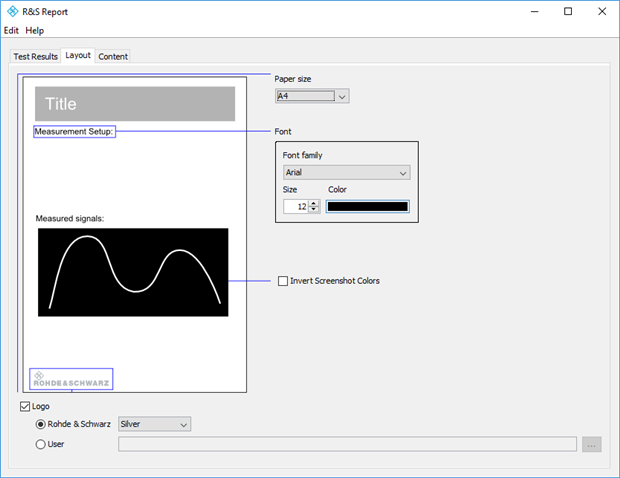

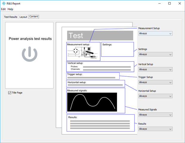

R&S RTx Report Creator
Installing the R&S RTx Report Creator was slightly less straightforward, as it seems that you need to manually run the installation program as administrator as it doesn’t request elevated privileges automatically and balks when copying the files to the target directory.
The software appears to be used to create PDF power analysis reports from data stored by the oscilloscope when using the RTM-K31 Power Analysis option.
The software has features to customise the layout and content of these reports. However, as mentioned previously in the Power Analysis chapter, the RTM-K31 option is intended for use with Rohde & Schwarz’s specialised active high-voltage/current probes and deskew fixtures and as such, I didn’t save any report data for testing the report creator with.
