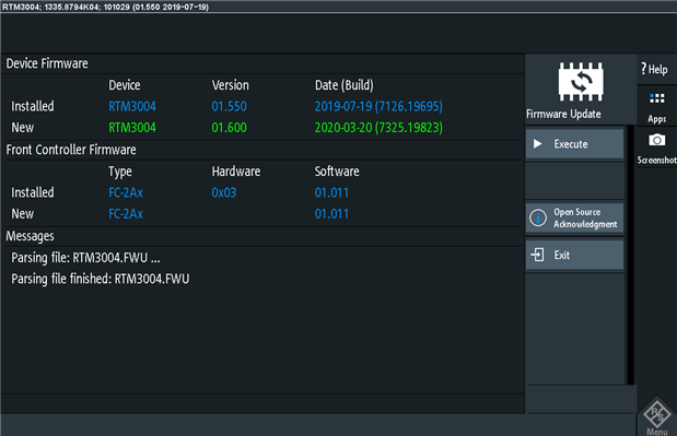

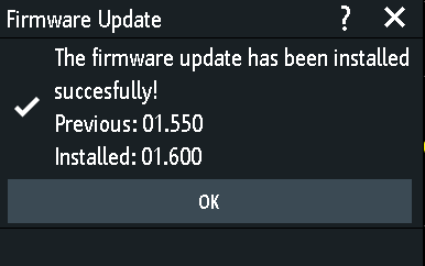

Installing the option begins with updating the firmware to 1.600. This is achieved by copying the correct .FWU file to a USB flash drive, inserting it into the oscilloscope and navigating to the Firmware Update page and executing the update. This process takes a few minutes, after which the oscilloscope reboots automatically.
After this, assuming you have a key for the option, you need to head to the Options page and Input option key manually. Assuming all goes well, the key will be accepted and the option will be added onto the list, unlocking its capabilities.

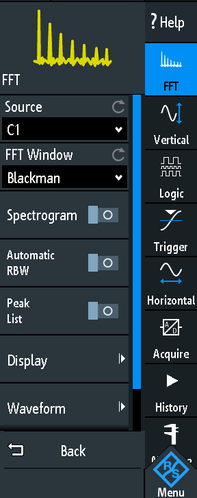

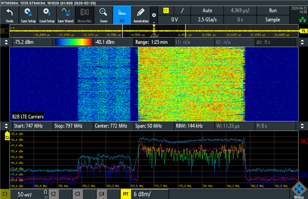

To access the Spectrum Analysis features, you need to open up FFT mode. There is no separate application for this mode, instead, it is enabled in FFT mode by the Spectrogram toggle. This also brings a number of other features including Automatic RBW, Peak List and Display configurations.

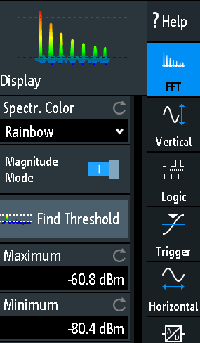

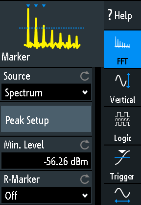

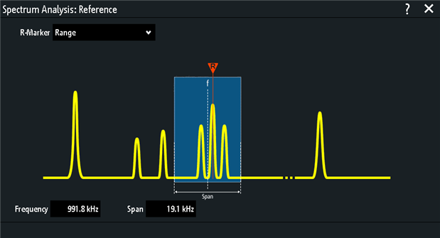

The display menu allows you to change the spectrum colour, toggle magnitude mode, automatically determine the signal thresholds for colouration (or manually define them below). The marker options allow for you to change the levels and marker types which are useful when using the peak list function.

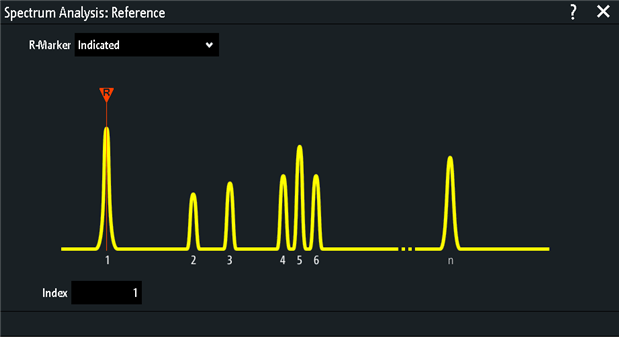

Different types of reference marker are available for selection, and other advanced peak list search options are also available. This is detailed in their updated User Manual, now up to V.08.

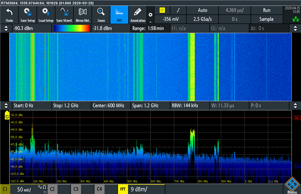

The various colour palettes are displayed above. Each pane can be moved using the drag handles, which means that you can have just the FFT, just the waterfall, just the time-domain representation or any combination of the above. The bars allow for access to the parameters of the FFT/spectrum, with new values keyed in using the on-screen keypad. The value ranges permitted are limited due to the sample rate, memory depth and processing power of the oscilloscope – a key limitation is the resolution bandwidth (RBW) which seems to be sample-rate dependent (and hence, centre-frequency dependent) and may reach only as low as 144kHz at the upper frequencies.
Magnitude mode allows for the FFT trace to be coloured based on the magnitude of the signal. A curious result occurs if you turn off magnitude mode – you can still select the colour for the trace but it is locked at the highest value (i.e. red, white or yellow). By default, when Magnitude Mode is on, you can adjust the upper and lower limits for the colouration using drag handles on the FFT trace which is quite convenient.

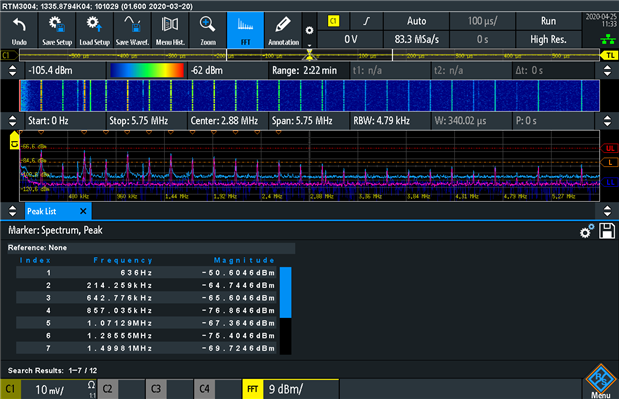

The Peak List function is also quite useful, allowing for automatic searching for peaks which meet a certain amplitude criteria and automatically listing them in the table underneath. Unfortunately, it doesn’t seem to respect the viewed frequency range and seems to always start from zero. I’ve reported this to Rohde & Schwarz, so hopefully an improvement may be in the works.

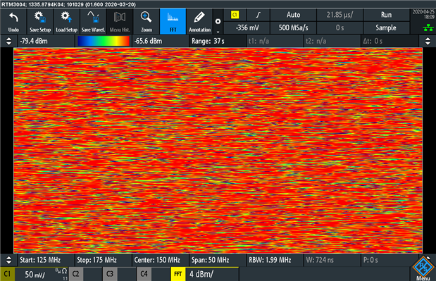

One limitation seems to be that the scroll rate for the spectrum doesn’t seem to be configurable. Depending on the RBW selected and the frequency, scroll rates for the screen could range from around 37 seconds to 2 minutes 34 seconds and in extreme cases, up to almost 4 minutes. This, along with the limited RBW selections, results in limited viewing resolution for transient signals with no other analysis tools being offered for signal characterisation.
There are time cursors available for use with the waterfall display, however, these are only accessible when the acquisition is stopped. This was not entirely obvious to me at first glance.

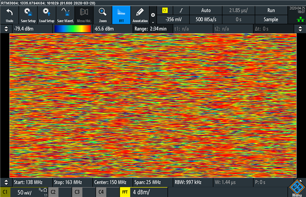

While testing, I was not able to get anything useable from a directly attached antenna, so I went to connect the oscilloscope to an amplified antenna source. While perusing the spectrum, I came across this incident where changing the central frequency by 1MHz resulted in the appearance and disappearance of a phantom aliased signal (an LTE carrier). After consulting with Rohde & Schwarz, I learned that the unit uses the regular oscilloscope input chain, thus when changing the centre frequency, the sampling rate may also change which may cause aliasing depending on the input. However, because the oscilloscope probe input goes through the input bandwidth filter before being sampled, it is sometimes possible to avoid aliasing by engaging the probe bandwidth filter at an appropriate setting. Otherwise, it is something that perhaps users need to be aware of and take steps to avoid (e.g. by changing the centre frequency and watching the behaviour of aliased signals).

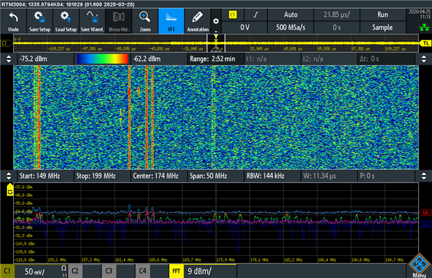

Perhaps this will be a good opportunity to take a “drive” around my RF neighbourhood using the amplified antenna input to see how various types of signals look on the RTM3004’s RTM-K37 option.

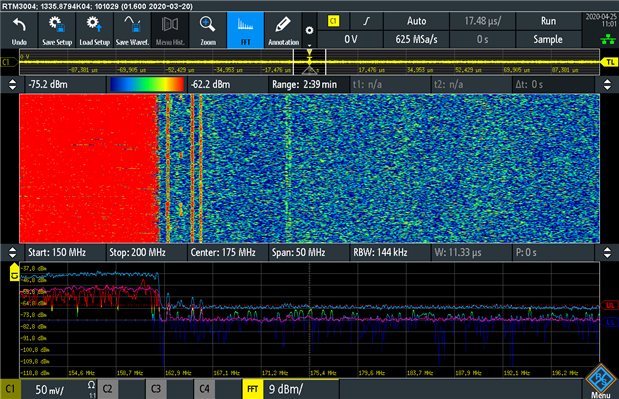

My local UHF DVB-T fill-in station broadcasts in the UHF band. Here, a number of 7MHz wide COFDM carriers can be seen side-by-side separated by guard band and an empty channel.

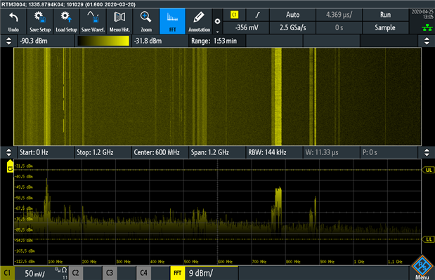

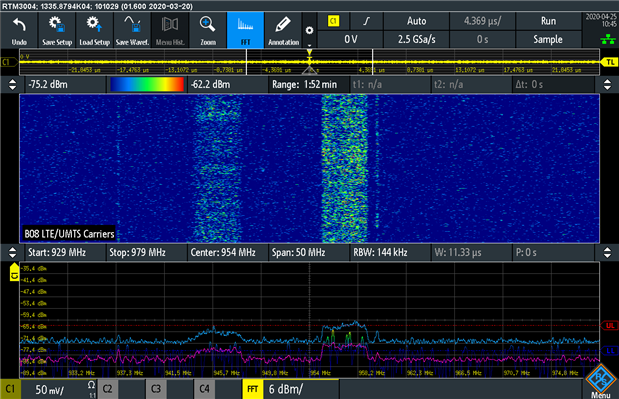

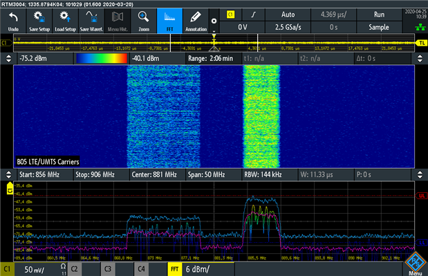

Various LTE and UMTS carriers below 1GHz can be seen – for example, in Band 28 (700MHz), Band 5 (850MHz) and Band 8 (900MHz).

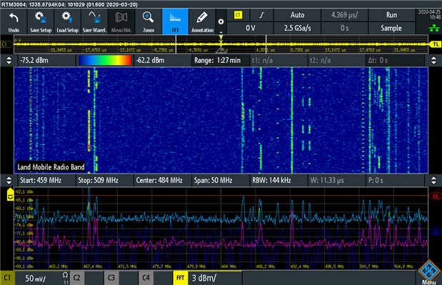

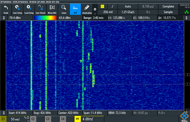

The 400MHz band belongs to various land mobile radio systems, mostly trunked digital radio with carriers of about 8-16kHz width. Unfortunately, the limited RBW means that these channels are hard to visualise and measure accurately.

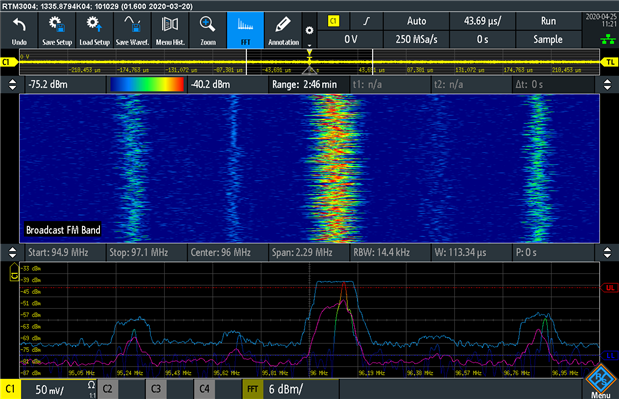

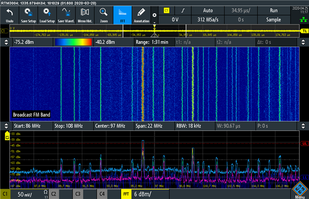

Finally, the broadcast FM band with wide FM carriers of about 200kHz width. At lower frequencies which results in lower sampling rates, a narrower RBW is possible, providing the ability to visualise the FM modulation directly. However, the scroll rate does not seem to be configurable and narrower RBWs typically result in slower scroll rates.

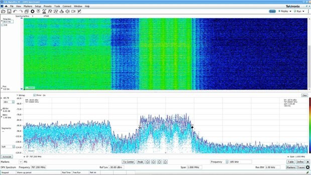

As a former RoadTester for the Tektronix RSA306 Real-Time Spectrum Analyser, I felt it would be a good exercise to compare the RTM-K37 option to what a dedicated RF spectrum analyser would be capable of.

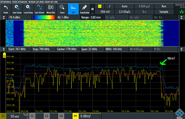

Given that I had just recently done a search for NB-IoT carriers on the air with the RSA306, it was probably good to try the same thing with the RTM-K37 to see how it would fare. Focusing on the Telstra NB-IoT carrier, we can see it to be the small “shoulder” on the right side of the LTE carrier. Not very clearly identified, in part, due to the limitations of the hardware – the minimum RBW was selected.

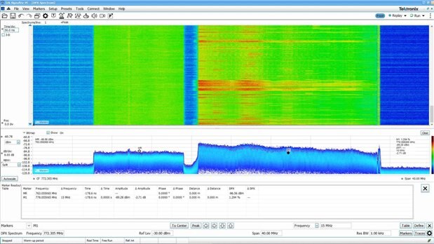

Contrast this to the RSA306’s performance which allows us to see the NB-IoT carrier clearly off the side of the LTE carrier, along with the Optus LTE carrier below. It was even possible to get “closer” as an RBW of 1kHz could easily be achieved in DPX view. As a result, it seems that the limitations of the RTM-K37 option makes it more difficult to analyse narrow-band signals due to the limited RBW capability. This can be seen in some of the screenshots in the previous section where land-mobile radios with 8-16kHz bandwidth emissions are hard to visualise clearly.

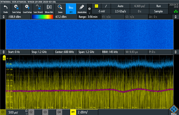

Another key metric that is used to compare spectrum analysers is the Displayed Average Noise Level (DANL) which represents the noise floor of the spectrum analyser. This is usually measured with the input terminated in a 50-ohm resistance at the narrowest RBW setting at the widest bandwidth with the lowest reference level. As a result, I used a 50-ohm BNC terminator on the input of Channel 1, set to 50-ohm termination, and the most sensitive setting of 500uV/div.
The average noise level is about -108dBm at an RBW of 145kHz. If my calculations are correct, the difference between 145kHz and 1Hz is a difference of 5.16dB, so the DANL is around -113dBm/Hz. This figure is probably not bad considering that it is from an oscilloscope input channel, but compared to dedicated spectrum analysers which often claim -150dBm/Hz to -160dBm/Hz, this explains why receiving off-the-air signals from an unamplified antenna was a bit of a fruitless exercise.
