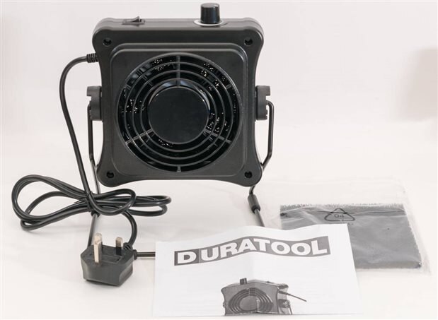

Inside the box, we have the fully assembled unit including its stand, a double-sided one page leaflet and a spare activated carbon filter pad, with one already pre-installed in the unit. The power cable is captive to the unit, exiting from the side.

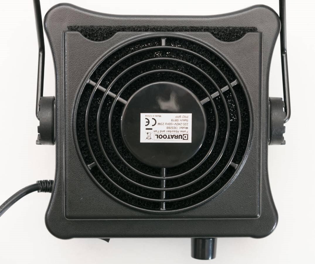

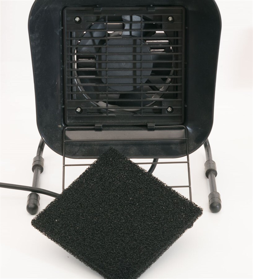

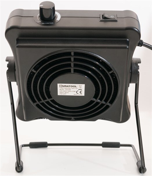

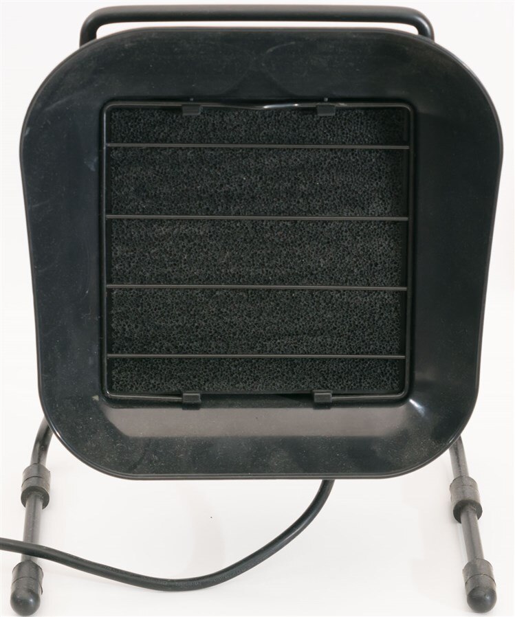

The design of the unit is such that the filters can be removed by sliding them out from the underside. This arrangement does hold the filters rather tightly, so removal needs to be done with care, otherwise the filter may come apart rendering it "stuck" inside the slot. It's not the best design, but it is very simple to manufacture. The appliance label is on the side which should be facing the soldering work, which is also slightly counter-intuitive, as most appliance labels are on the rear of the device, out of sight. The design of this unit has no "hood" or anything which might concentrate the suction of the fan and direct it to the working area, so keeping the fan literally next to the workpiece is advisable, otherwise the fumes may escape into the room.

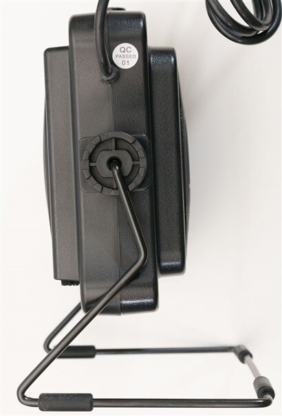

The unit itself has a QC label affixed near the power cord entry. The stand itself is made of a moderately thin metal wire with rubberised sections. This clips into the side pieces where there are several detents to keep the unit at one of nine angles. This offers a moderate amount of flexibility in positioning of the head - better than fixed units, but perhaps not as good as screw-set units which can be placed at any angle. Unfortunately, the stand was not "100% high quality", having a noticeable asymmetry and lean to one side, interfering with the positioning of the unit at certain angles. Bending the stand into shape helped improve the situation, but the stand did have a slight tendency to rock. This did not cause any audible acoustic noise in operation, which is good.

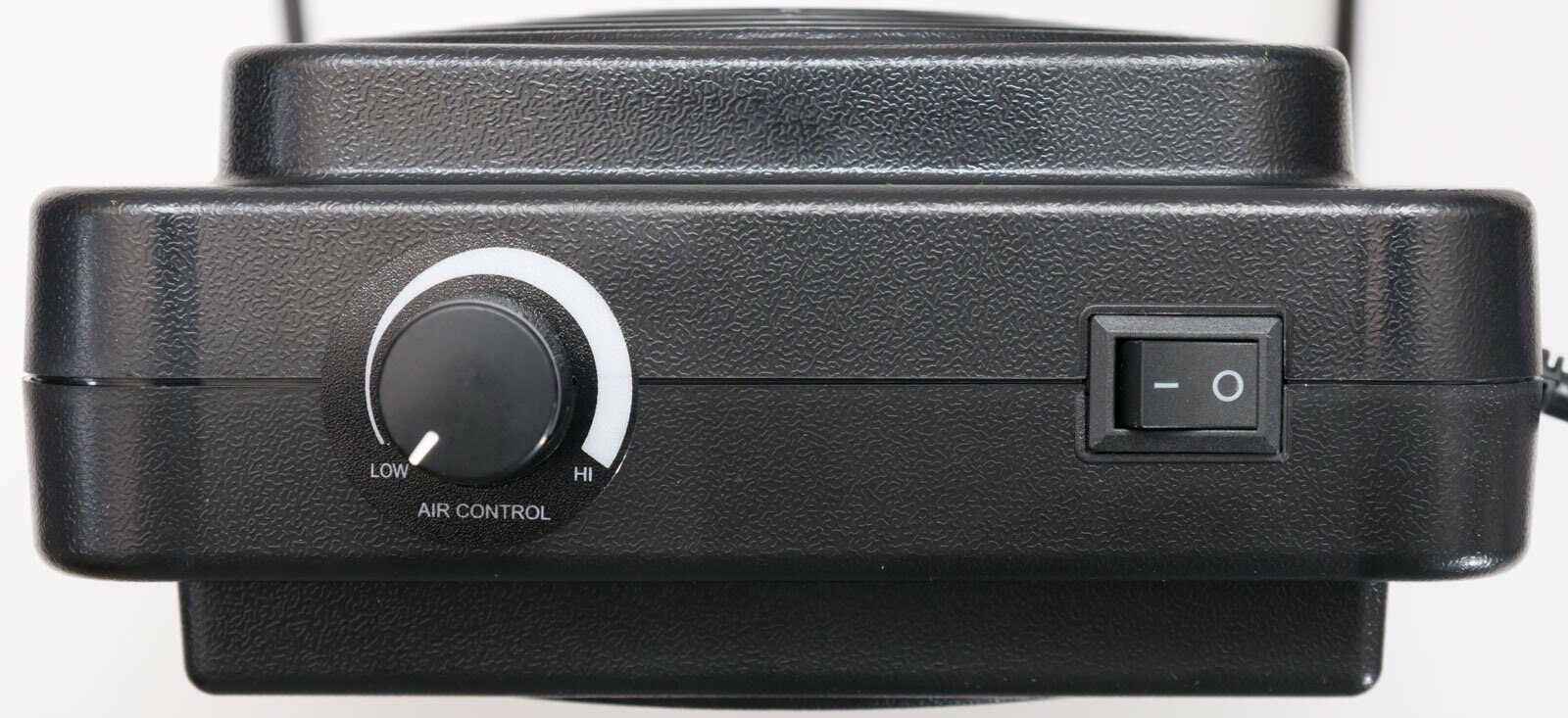

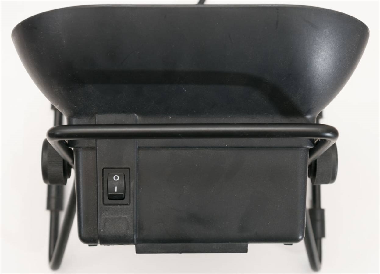

The unit has two simple controls on the top - a dial for speed which is continuously variable, and a power switch that turns the unit on and off. It's nice to see that the cable is terminated in a proper Qiaopu branded power plug, with a proper Bussman 3A fuse as required. Being in Australia, I used a plug adapter, but in the future, I could just rewire the unit with a local plug instead. I wonder how durable the speed control circuitry is in the long-run.

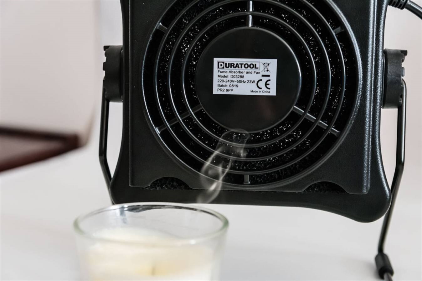

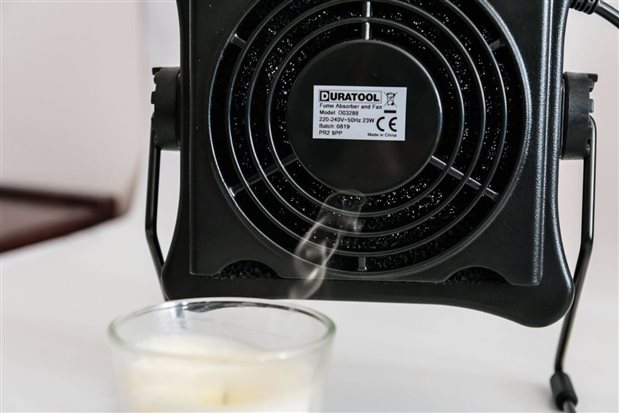

Does it work? Well, yes, it does! Which is no surprise at all, since it's quite a simple device in concept. The carbon filter does a decent job of eliminating some of the soldering fumes - to illustrate this, I've used the smoke from a blown-out candle. The unit definitely has a noticeable hum in operation, but is not too loud even at the high setting and is not particularly distracting. Fume absorption works best in the high setting - I found reducing the speed had too much of an impact on how far it could pull in the fumes from, so I'd recommend users keep it on the maximum. However, if you do remove the filter, you could use this as an ordinary fan as well, which works pretty well. Perhaps this would be the geekiest desk-fan or bed-side fan for the enthusiast - after all, having a speed control knob is not something you find on many such fans! So while the unit has a rather simple design and flimsy stand, it seems to do the job just fine and won't break the bank either.

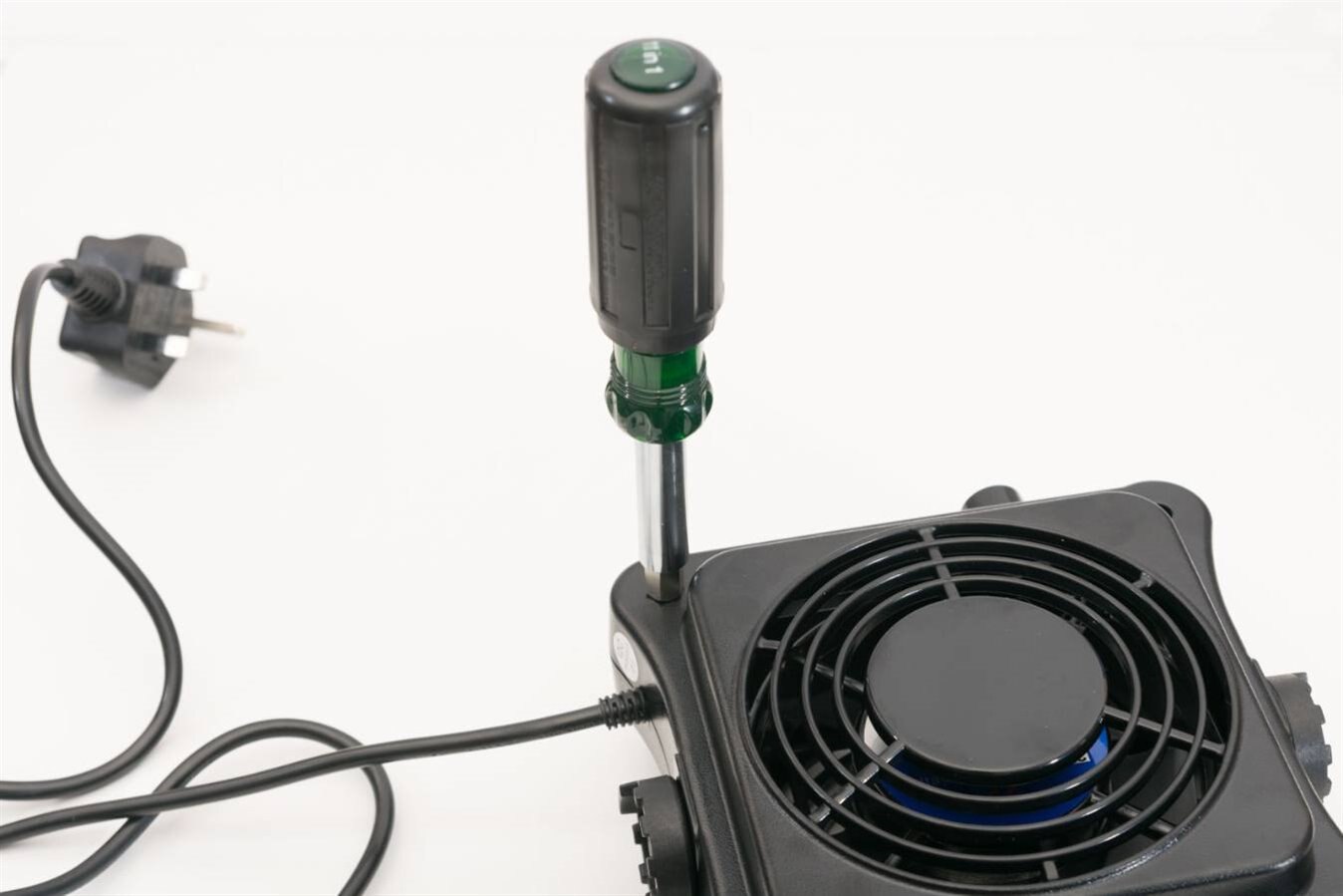

I think we can all guess as to exactly what is inside the unit - but I had to open it up anyway just to find out for sure. Oh hey, that's the screwdriver from my last post! Its tip only just reaches the recessed screws in this case ... lucky for me I'm not going to have to look for another screwdriver!

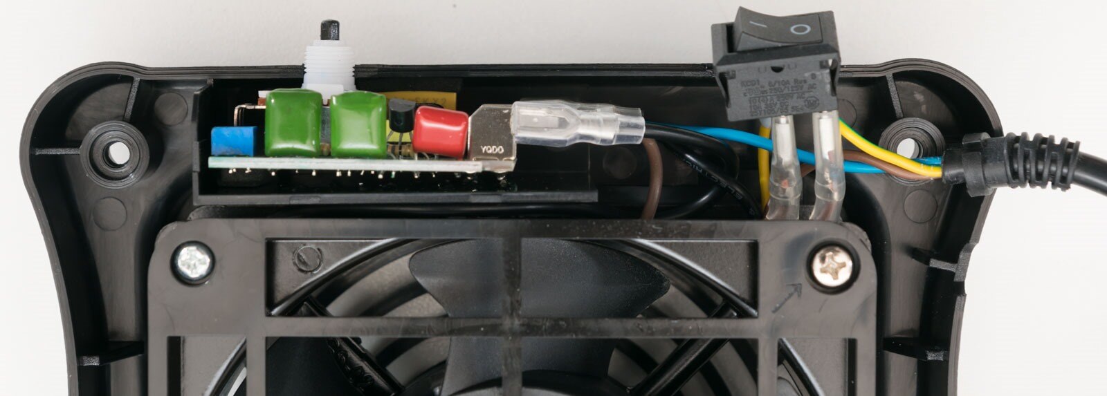

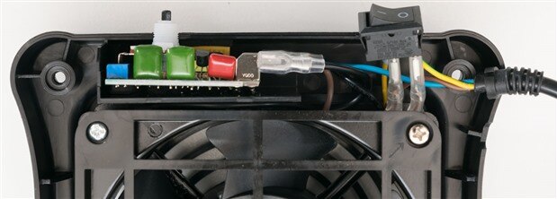

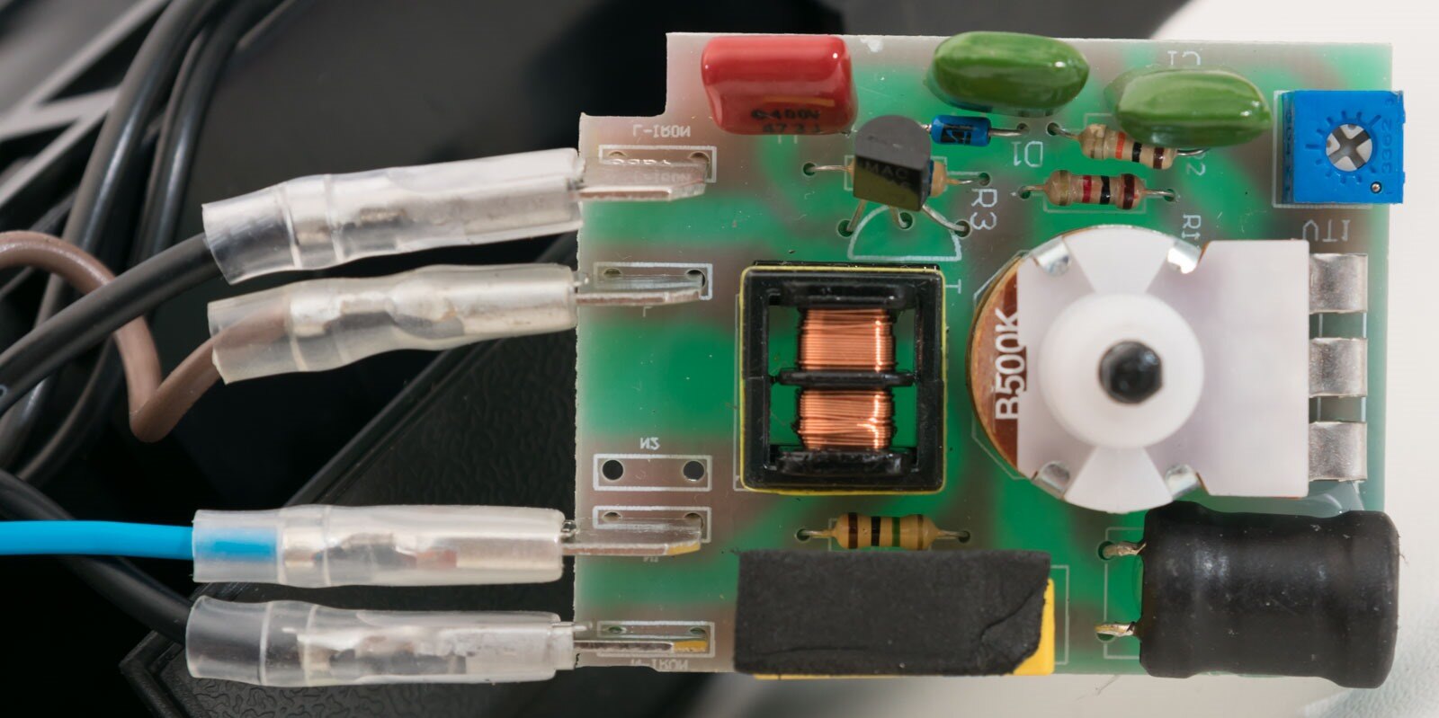

To fully open the unit requires taking off the knob and speed indication labels before the two halves of the case will separate. As expected, the power switch and a speed controller PCB reside at the top of the casing.

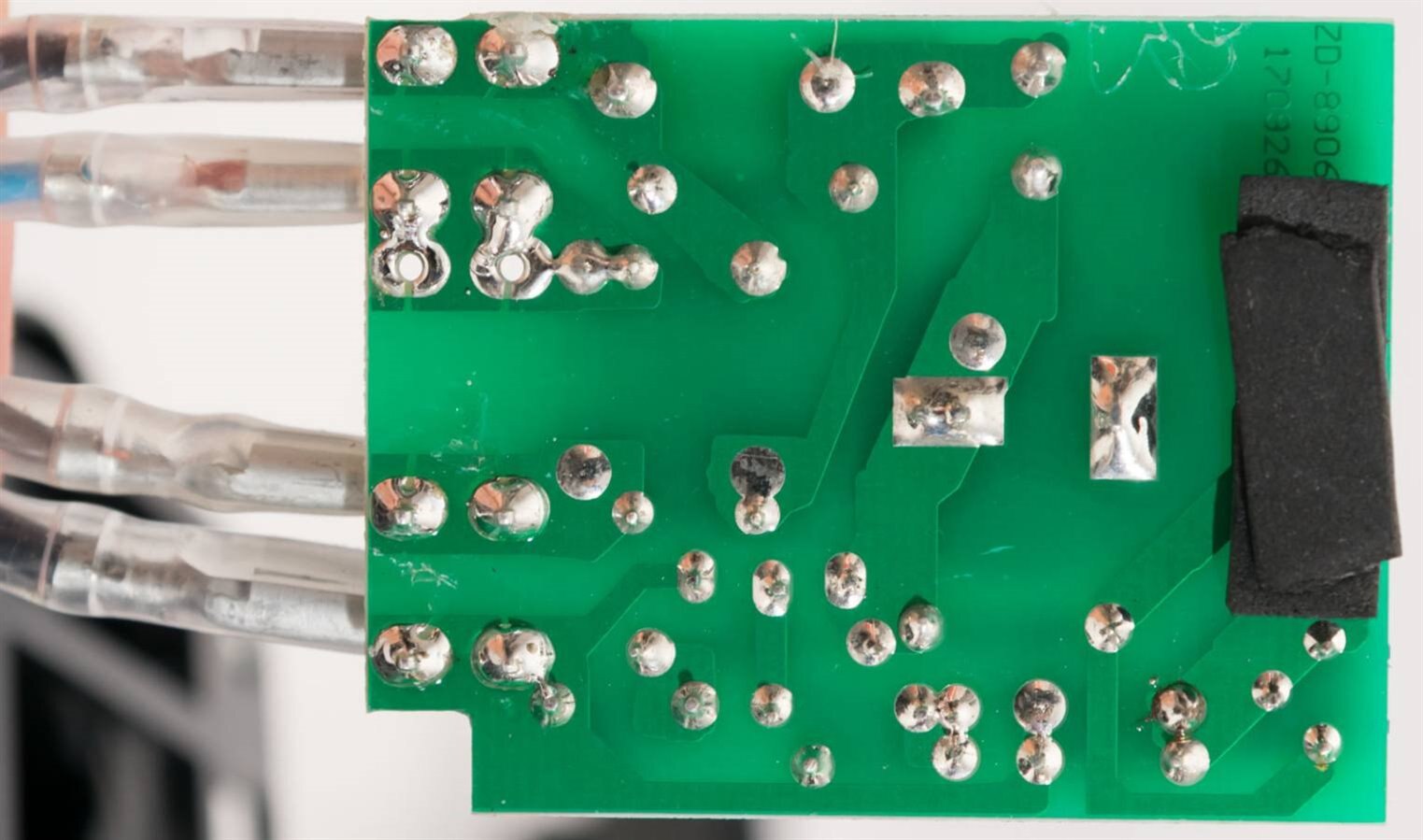

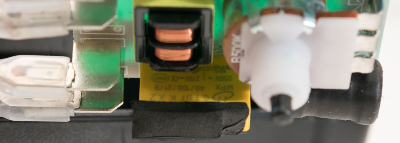

The speed controller seems to be a very simple single-sided PCB design with a single triac and some common-mode suppression to avoid interference.

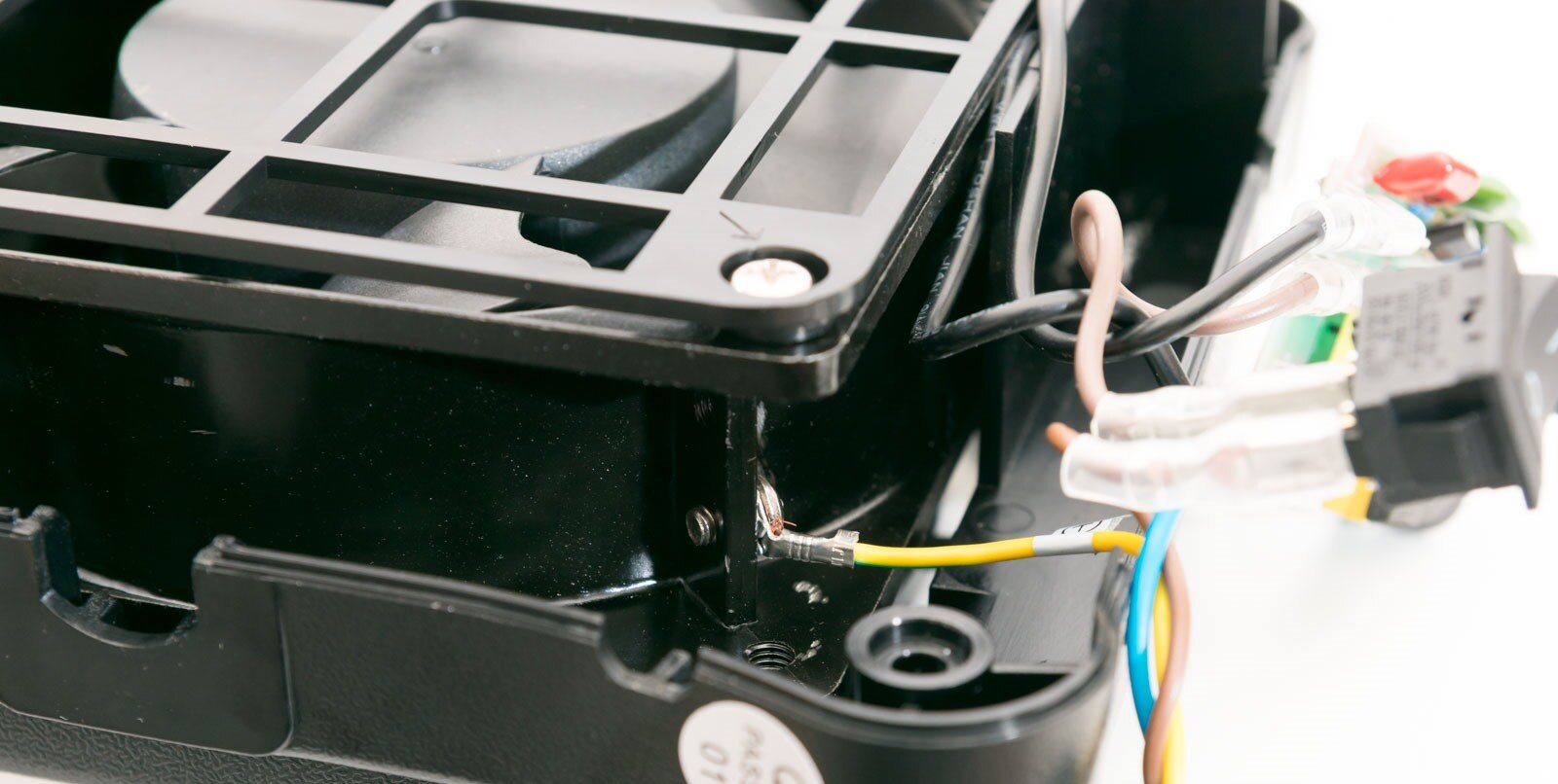

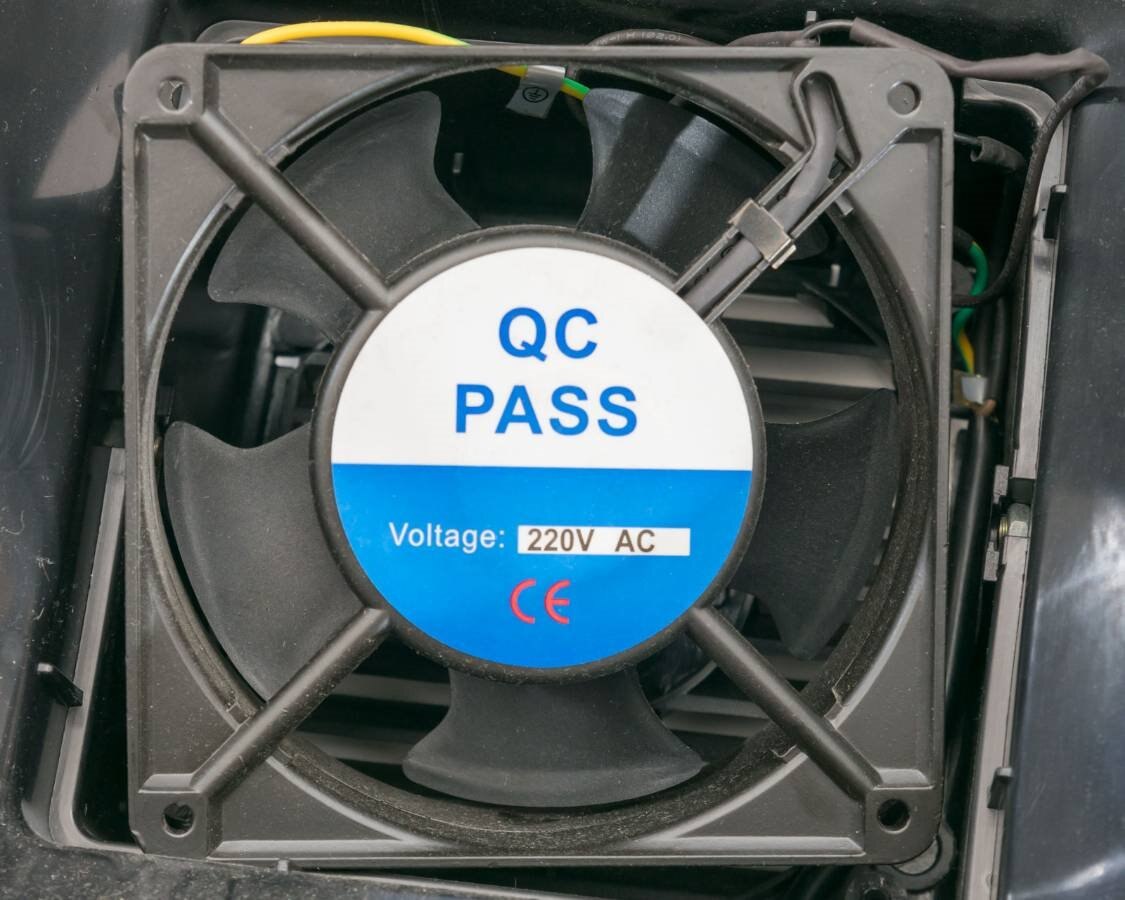

As it turns out, the Earth pin is necessary on the plug, and it is internally attached to the frame of the fan, which is made of metal. It is unlikely the user would ever contact it, however, as it is encased by plastic all the way around, but better safe than sorry.
As for the fan itself, it is a very anonymous unit with no branding, and just the 220-240V AC specification listed on the front along with the CE mark. Will this be reliable in the long term? I don't know for sure.

This unit was more expensive than the unit being reviewed, listed at AU$74.95 inc GST, however has a more sturdy stand that is open at the front, making it easier to get it closer to the workpiece. It looks visually identical to the Duratool D00374 which is available from Farnell in the UK for GBP 30.26. The intake is covered with a hood, while the outlet has a fixed louver directing airflow up, so the rear can sit much closer to a wall and still be effective. This unit also has a wire-cage retention mechanism for the filter, making it easier to replace the filter.
A downside is that it only has a power switch and no speed adjustment. This is sufficient for basic use and acoustically, both units sound similar in terms of their noise. The pivot adjustment is done via screws, thus this unit can sit at any angle.

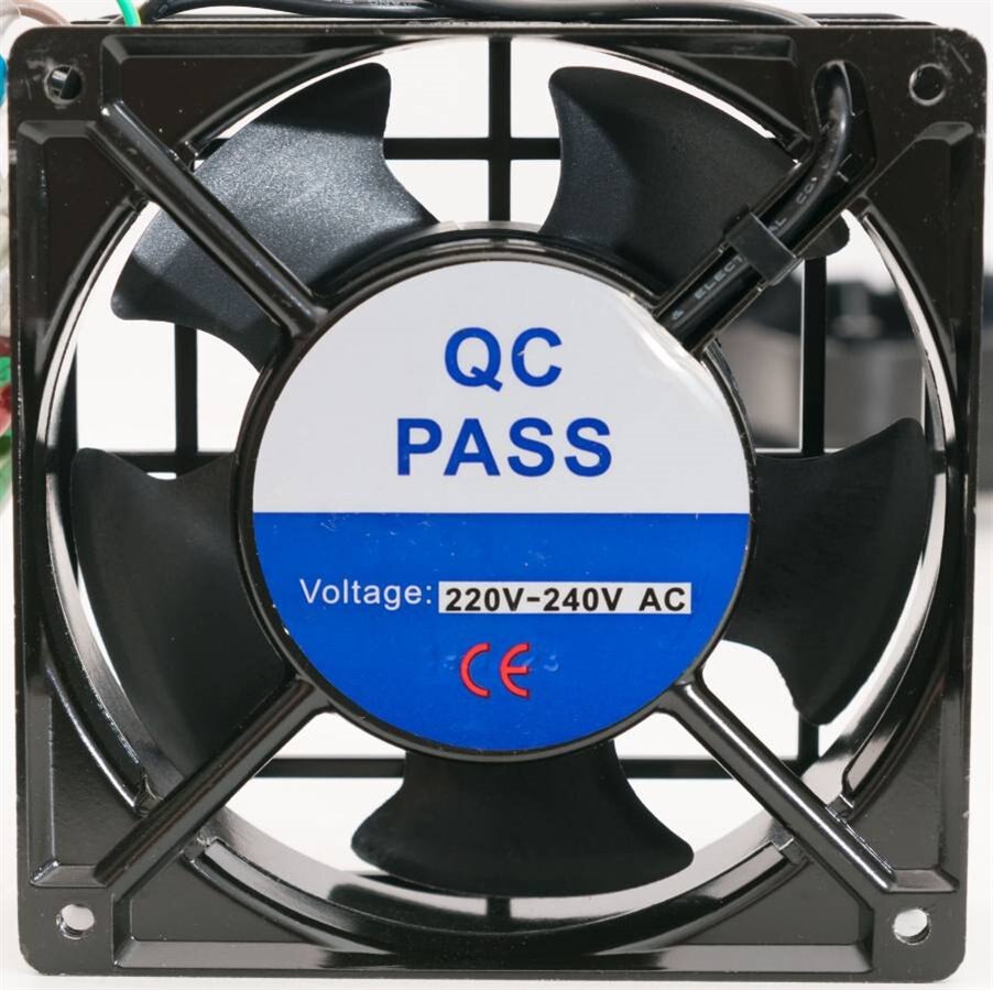

Taking it apart, it turns out the two units are probably more closely-related than I thought - the fan appears to have the same labelling that lacks any identification of manufacturer, although this fan only claims to be rated for 220V AC despite the unit being sold to me as being for 240V AC. So in terms of preference, I'd have to say both the review unit and this unit have their own merits and drawbacks, but I'd be happy with either one honestly.
