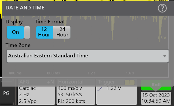

Another important setting is the time-zone setting. It seems the unit automatically sets its time from the network, but needs the time zone to be manually configured. This can be accessed via the clock in the bottom right of the screen.

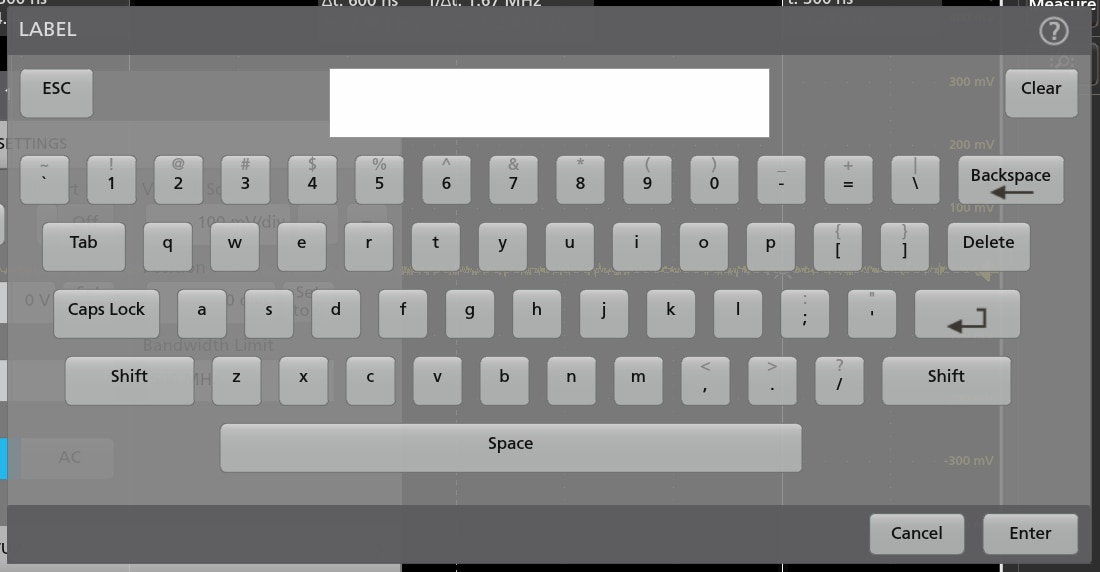

Depending on the entry required, on-screen keyboards and keypads are available to enter data. Alternatively, a USB-connected mouse and/or keyboard can be used to interact with these menus. The size of the touch targets are quite appropriate and easy to use.

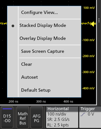

Perhaps less obvious are the menu options which can be hidden in “right click” (or long-touch) menus. There are other features which may require judicious tapping on the screen.

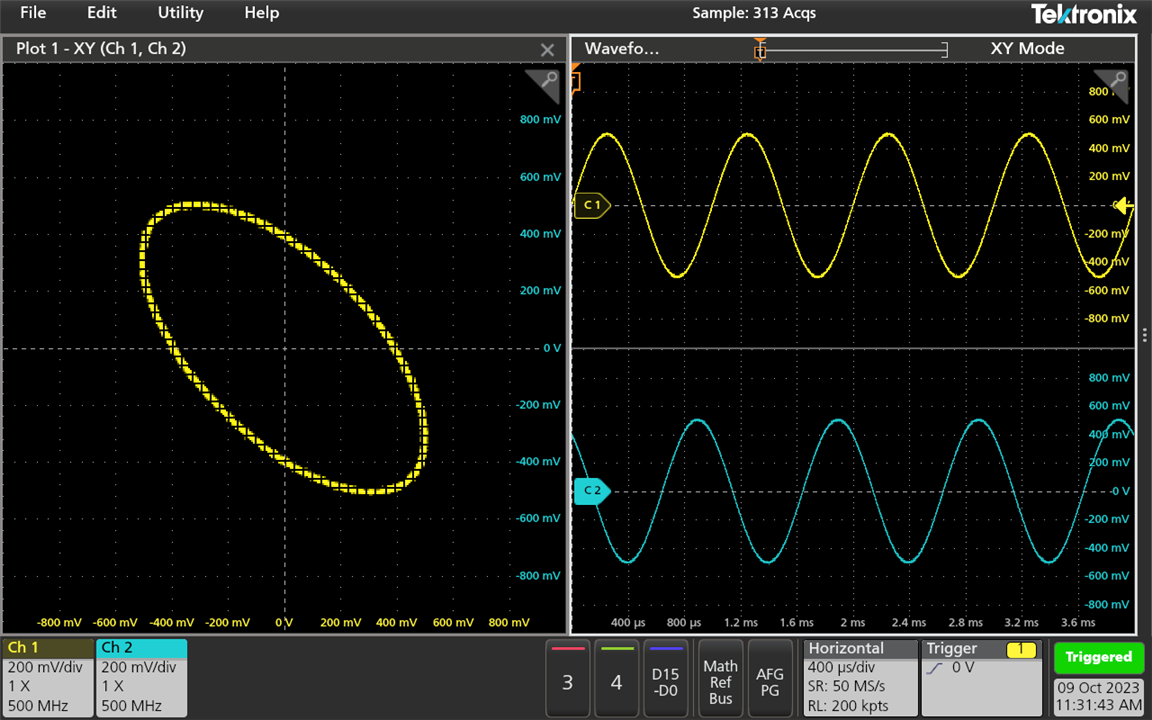

There is also the possibility to perform X-Y display using two channels.

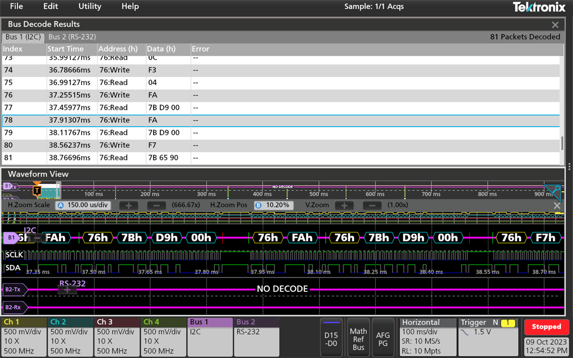

Serial protocol decoding is available with the 2-SERIAL option. As it just so happens, I’ve got a little project going on that is using both I2C and UART communications.
This would be a good test of the ability to decode serial buses.
For added realism, I’ve decided to probe nicely and use the spring grounds for this. This ensures we get a quality waveform without the influence of a long ground loop.
Serial decoding can be accessed through the badge for Bus. The MSO24 supports I2C, Parallel, SPI, RS-232, CAN, LIN and SENT only at this time.
image image
Bus decoding operated as expected and the data can also be exported from the bus table to .csv. The font for the bus trace is a bit big, meaning that it isn’t possible to see much when zoomed out unfortunately.

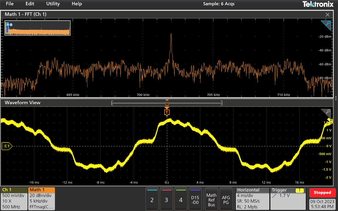

I also tested the FFT capabilities with the probe connected to some wire.
It had no trouble seeing local AM radio stations, ABC RadioNational 576kHz, ABC NewsRadio 630kHz and ABC Radio Sydney (2BL) 702kHz.
We can also see some of the AM modulation when zooming right in. As this is FFT rather than a proper spectrum analyser, the analysis width and resolution are related to the time-base/record length.
It is also possible to resolve FM radio stations as well.

A practical demonstration of the oscilloscope’s bench capabilities included the construction of a bode plot for a wide-band RF transformer on a PCB of my own design, decoding of serial buses on an embedded systems prototype, capturing of VGA signals using external trigger, testing of the arbitrary function generator and pattern generators, drawing on-screen annotations, collecting Ethernet signals and performing FFT analysis to detect AM/FM radio stations.
