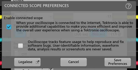

A common and convenient way to connect instruments for remote control is via Ethernet to a local area network (LAN). The MSO24 supports gigabit Ethernet connectivity with IPv4 addressing. The oscilloscope does have some “connected scope” features which rely on this connectivity. I did opt to disable usage tracking.
Unfortunately, the availability of Ethernet is not a given in all places. It would have been nice to see Wi-Fi being available, so that connected features (e.g. network storage, TekDrive, remote control) could be used in spite of this (e.g. via connecting to a mobile phone tethering hotspot).

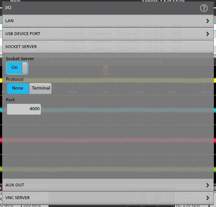

For example, SCPI commands can be sent to port 4000 socket server, depending on the setting of this toggle.

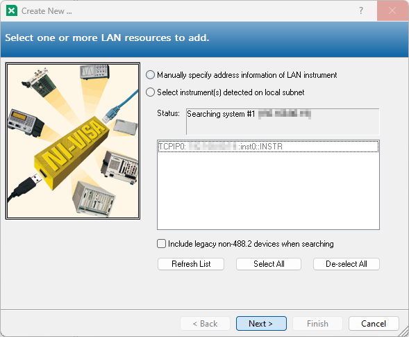

Most instruments I meet can be automatically detected on the network through mDNS, however, this instrument seems to be an exception. By default, opening NI MAX doesn’t list the MSO24 on the network at all.
I had to manually scan the network for instruments before the MSO24 was detected and added (manually) to the list of devices.
This is perhaps not as user friendly as detection through mDNS and does result in some instances (after rebooting the computer) of the instrument not being automatically detected until the VISA layer is forced to refresh and rescan the instruments on the network.
After manually adding it to the system, it does function correctly. This remote control interface was used extensively in performing the input error and AWG error measurements as part of the Instrument Performance Tests chapter of this review.

For remote control of the oscilloscope of the “remote screen, keyboard and mouse” variety, the MSO24 supports the VNC protocol. By default, VNC is disabled and when enabled, a password can be set but will only take effect after a reboot of the instrument.
This server proved useful in making some of the screenshots in this review. Its performance was quite good, reaching approximately 15fps (although this varies with the complexity of the displayed image). The performance is demonstrated in the below animated GIF image.
One downside of the VNC server is the lack of access to the front panel buttons and knobs. Some operations are difficult or impossible to do efficiently without this access (or knowing the relevant SCPI commands and issuing them directly to the socket server port).

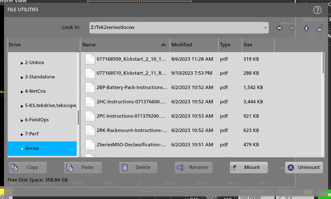

While the lack of a web interface was a bit of a downside, there was an unexpected find. The 2-series is capable of mounting network shares for storage of data (e.g. screenshots, settings and waveforms). This is a big convenience as it reduces the need to use physical USB storage media, although though the speed and reliability will depend on the network and the server at the other end.
It can be accessed through the “File Utilities” menu through the “Mount” button. Assuming you enter the details correctly, it will be mapped to a drive letter which is then usable throughout the oscilloscope’s UI. The mount details are remembered through reboot cycles.
I had no problems mounting a Samba share from a server running on Ubuntu Linux. Both storage and retrieval operations were reliable and seamless, allowing me to store screenshots directly into my “work-in-progress” folders.
