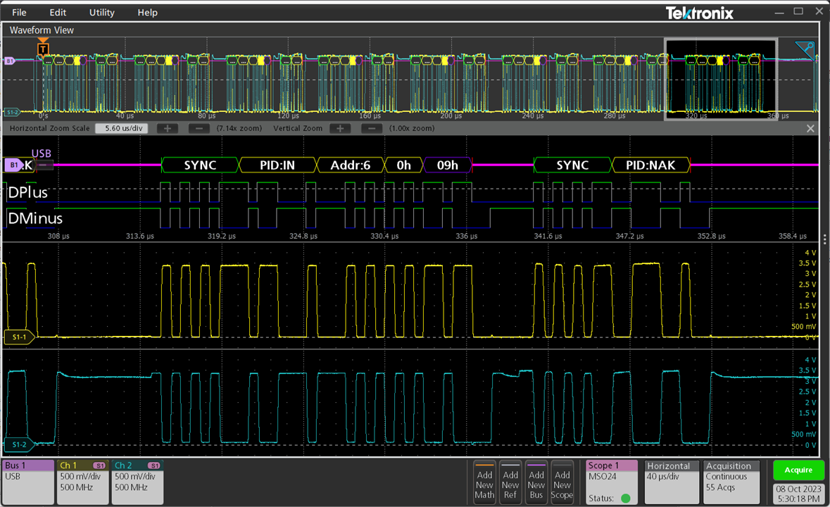

USB Low-Speed Decoding
When I saw USB decoding was available in TekScope, I thought I’d give it a go. Knowing that probing full and high-speed USB is not easy, I opted to use an old keyboard which should be a low-speed device. This would allow some lousy probing to produce valid results.
I enabled the decoder, noting that the source has to be “S1_Ch1” and “S1_Ch2” which denotes the remote oscilloscope 1’s channels. At first, I had Ch1 and Ch2, not knowing that those would be “local” channels despite the computer itself not having any native acquisition hardware.
It seems the results are valid and it is indeed possible to have USB decoding from the transferred waveform data, even though this is a capability that the MSO24 cannot do on its own.
It was possible to set a long record length on the oscilloscope and trade-off the sample rate a little bit to get a capture that covers a bit more of the initial hot-plug initialisation. It is notable that it is best to have the acquisition all set up and completed on the scope first, then pull the data and see the decoded result. The zoom feature is incredibly handy for this.
However, as the decoding isn’t occurring on the oscilloscope and there is no hardware trigger functionality – it is not possible to trigger on USB serial bus events, which is a key downside of doing analysis and decoding through TekScope on lower-end hardware.

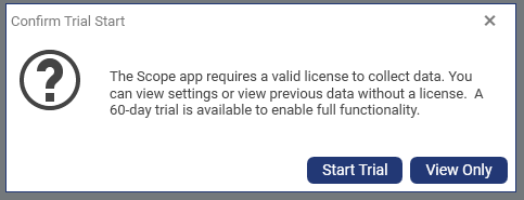

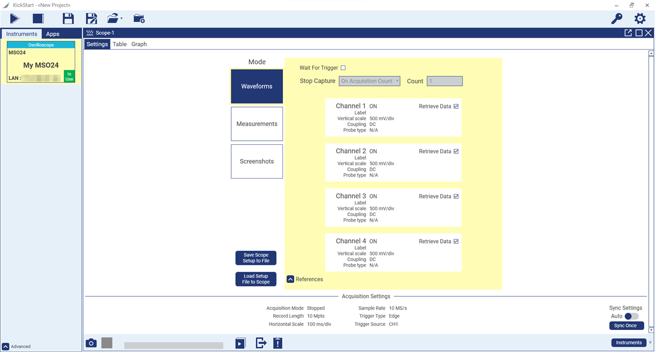

The Scope app is locked as no license is available. Attempting to start it will provide the facility to commence a 60-day trial.

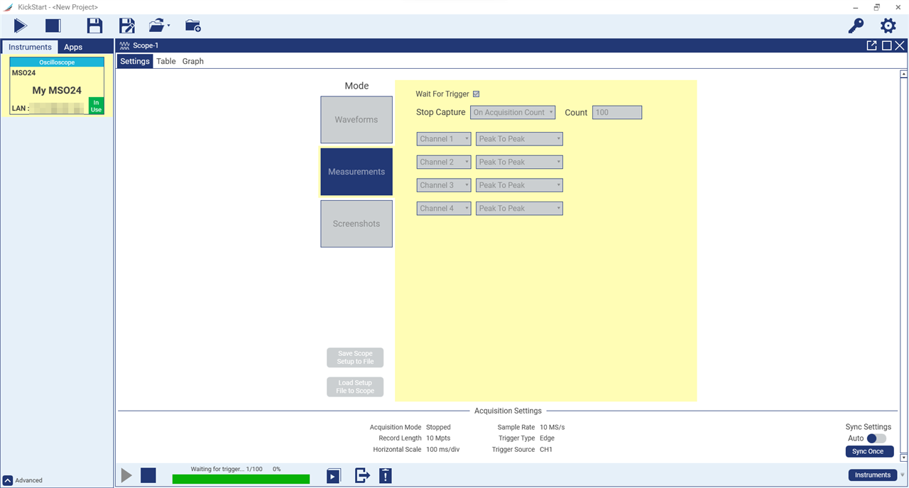

The functionality of the Scope app can be broken down into three main features – waveforms, measurements and screenshots. Waveforms acquires the raw waveform data from the oscilloscope, while measurements acquires the measurement readings and screenshots acquires image data. The oscilloscope has to be pre-configured (manually by hand, or otherwise by another form of remote access) before data is taken as KickStart doesn’t appear to be able to modify settings on the oscilloscope remotely.

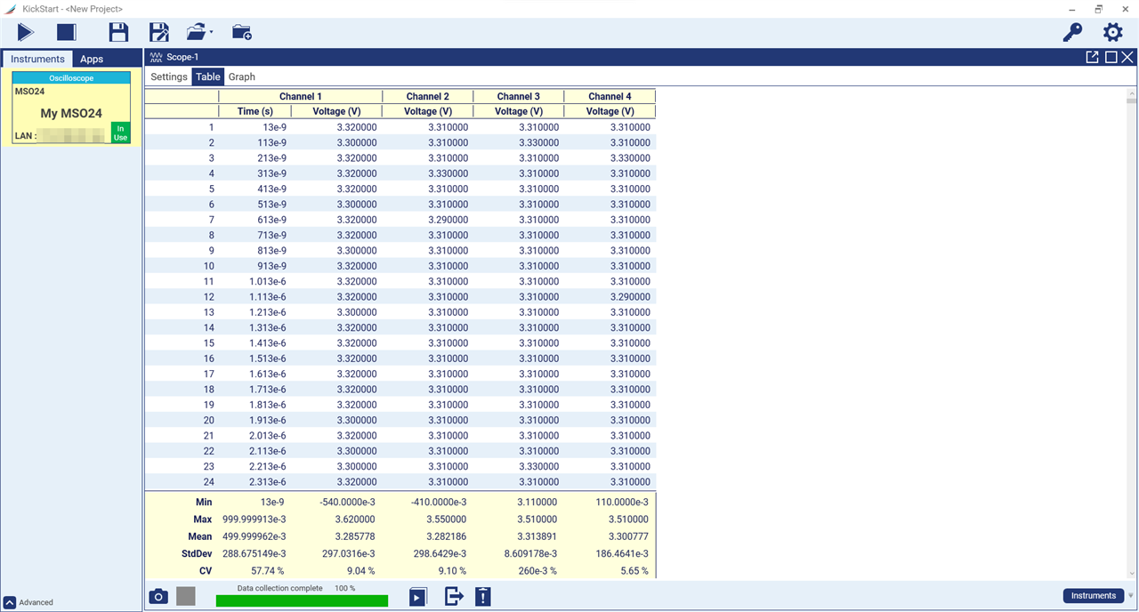

Retrieved data can be visualised as a table with statistical information.
Or as a graph with the flexibility to zoom in and out.
Retrieval of measurement data can be useful for watching longer-term trends in the measured values, where the individual waveform nuances are not of interest.
The screenshot feature allows for saving screenshot images. It reconfigures the oscilloscope’s capture filename, colour inversion setting and creates a temporary directory in internal storage – but does not undo these changes when closed, which is a bit annoying.
On its own with just the MSO24 and in isolation, KickStart does not seem as interesting of a software, however, its power grows when you have multiple instruments of different types, as they can be used together (provided some creativity in configuration is taken) to produce more sophisticated test sequences. It seems mainly to appeal to those who are unable or unwilling to develop their own automation programs.

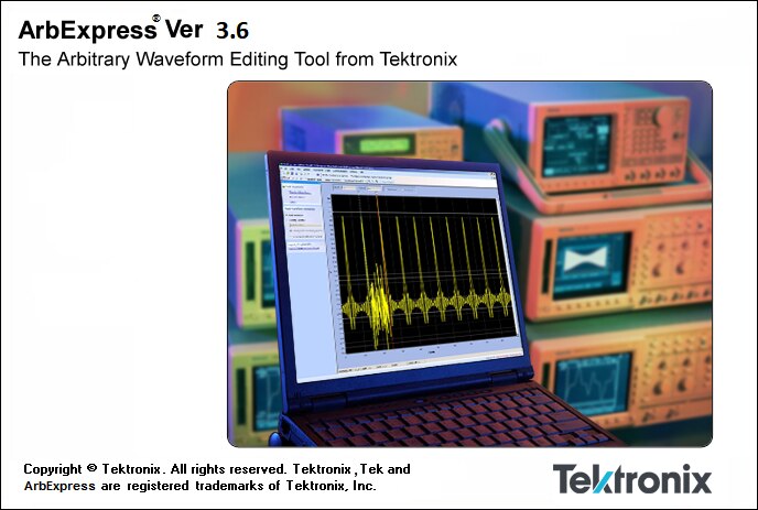

The only free software in this posting is ArbExpress. This is a program intended to help users generate waveform files for the arbitrary waveform generation feature and is named in the datasheet for the 2-series MSO.
The program can be installed by downloading it from Tektronix’s website and executing the file.
The current version appears to be V3.6 which is somewhat dated.
The user interface has an early-2000’s “Windows XP” paradigm to it.
Unfortunately, from what I can see, the available instrument selections do not include the MSO24. While the generated files may be compatible with the MSO24 if the correct option is chosen, there is also the potential downside of the length of the waveforms being limited by the shorter memory of most other instruments. As the MSO24 also supports importing .csv files, I did not investigate the use of ArbExpress further.
