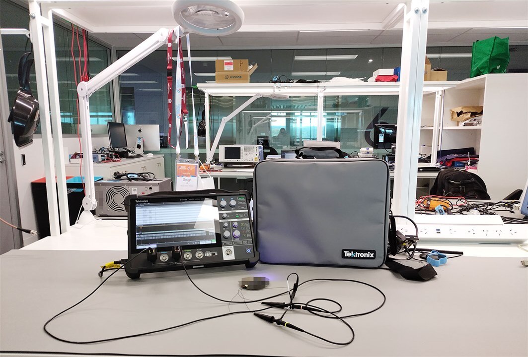

Scoping On Another Bench
While at work, I quietly took out the unit to do some scoping about. We have plenty of oscilloscopes at work … but the 2-series makes it possible to think about having an oscilloscope that moves with you.
Testing this concept out, the first thing was to do some checking of I2C communications on one of our prototype PCBs. I can’t share more than that … but perhaps you can already work out what it is.
It was not the best method of probing, but it got the job done. As there is no on-board Wi-Fi on the 2-series, I had to resort to using local USB drives to save data as Ethernet access is strictly controlled.
Being a little lazy, I set a massive record length and as the board was reading sensor data constantly, this resulted in a lot of decoded packets.
Performance did take a bit of a hit while decoding, but it still managed without fail. It seems important to have a sample rate of at least 10MS/s to get consistent decodes, as 5MS/s was giving me some strange errors. I also reduced the font size in the settings to the minimum of 12 so I could squeeze a little more onto the screen, while also exporting the bus table to a .csv file. Job done!

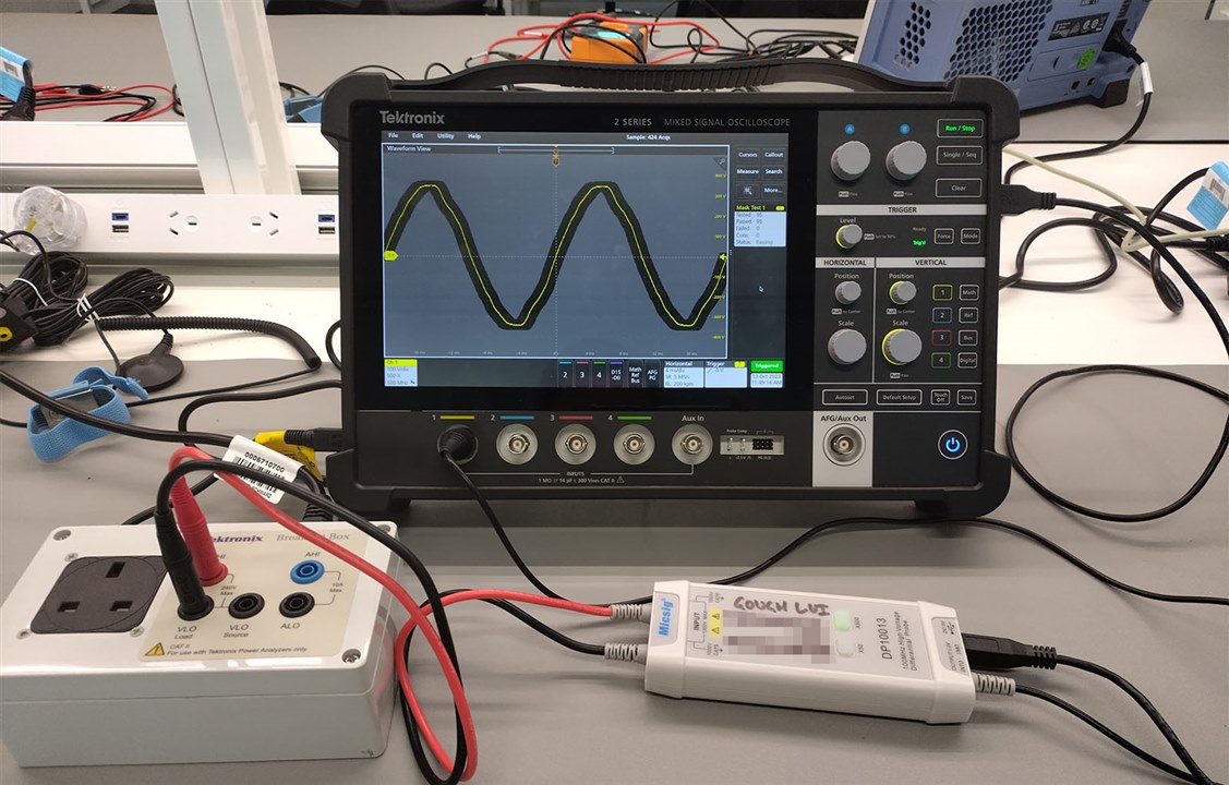

While there, I also decided to investigate the mains power as there have been reports of flickering lights. Using the break-out box from the PA1000 and a Micsig high-voltage differential probe powered from the USB port on the Tektronix 2-series, I left it to perform mask testing throughout the day as I attended to my work.
I found the best way to define a mask in this circumstance was to use the waveform tolerances option in this case, in part, because the 2-series doesn’t have a power analysis option. Then I set the “on event” to dump a screenshot and a waveform file to USB when the mask is violated.
It seems that not many anomalies had occurred, as even with the tight mask, the waveform barely ever budged.
Masks can also be defined by shapes – a silly mask drawn by hand can be seen above.
I also decided to grab an FFT of the waveform (and saved the data as .csv) before I left, because that mains waveform is quite non-sinusoidal in a consistent way! Flattening of the top is quite common, but this one also seems to have some “permanent” wiggles!
