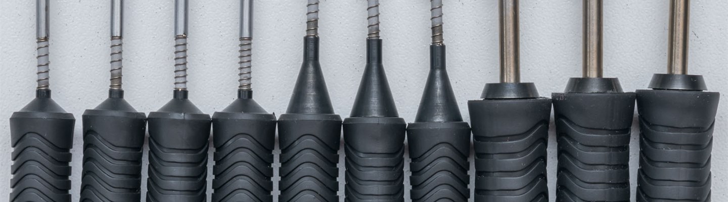

Another key benefit for existing Weller customers is the potential to protect your existing investment in Weller equipment, as the WX-series irons and accessories can work with the WXsmart base unit directly. Because of the mix-and-match philosophy, it is possible to start by upgrading the parts that are necessary and expand the system later on to meet greater needs. For example, the WXair unit doesn’t have to be purchased immediately if the user doesn’t require hot air or vacuum tools at the point of upgrading to the WXsmart system. But if the need arises later, it can be purchased and plugged in, integrating nicely onto the bench.
It also supports the latest technology irons, such as the WXMPS MS and WXUPS MS with new smart-tip active heating technology for best performance (including compliance to mil-spec). It also supports the new smart desoldering tweezers WXMTS and WXUTS with active heating technology. These promise improved responsiveness over previous-generation irons.
