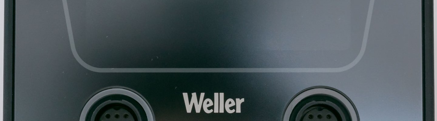

WXsmart (WXS) Base Unit
The WXsmart base unit forms the heart of the system, being the key piece on the bench that connects to everything else. The unit has a very nice, matte glassy front with a capacitive touch, ESD-safe, colour LCD for its user interface. Two channels with a total power rating of 300W combined allows for running up to two soldering irons or one with a hot air pencil or desoldering tool. These connectors are surrounded by an LED ring light to indicate status. A hardware power switch is located on the bottom left.
While the unit looks modern from the front, they have not eschewed the traditional Weller colour scheme. The right side of the unit has a USB port that can be used with USB storage for firmware updates and loading of settings or with a USB QR barcode reader. The unit is quite heavy and solid – looking through the cooling vents on the side, a toroidal transformer can be seen in the base. This explains why the base unit comes in distinct 120V/230V versions.
The base and rear are cast out of metal, acting as a heatsink. On the rear, Ethernet and serial connectivity are available. A fused IEC power outlet is also present along with a grounding connection. A Wi-Fi interface is integrated inside the unit.
A non-slip mat is placed on the top of the unit where additional tool and accessories can be stored.
The nameplate is placed underneath the unit, which is Designed and Engineered in Germany, Made in Mexico. Rubber feet keep the unit from moving around on the bench.
