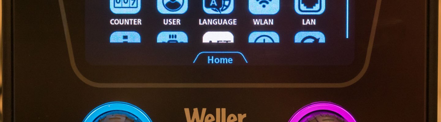

Swiping down from the home screen opens up the settings screen which consists of many icons. Blue-labelled icons can be pressed, while white-labelled icons are locked out. This may be because of a restricted user account, not having appropriate devices connected or because it is a paid option requiring licenses.
Individual menus often follow the convention of a scrollable left half with a list of options and the right-half being used to show and manipulate values. The station keeps a track of a lot of variables and is quite configurable!
