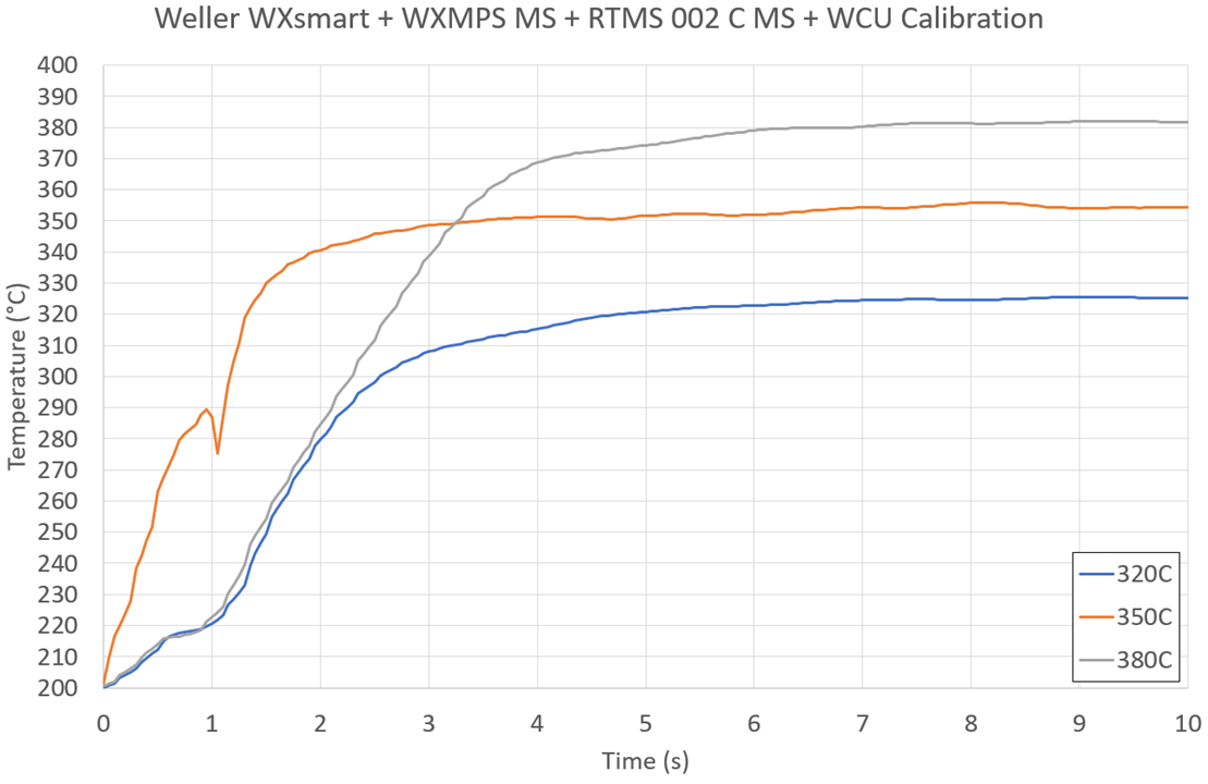

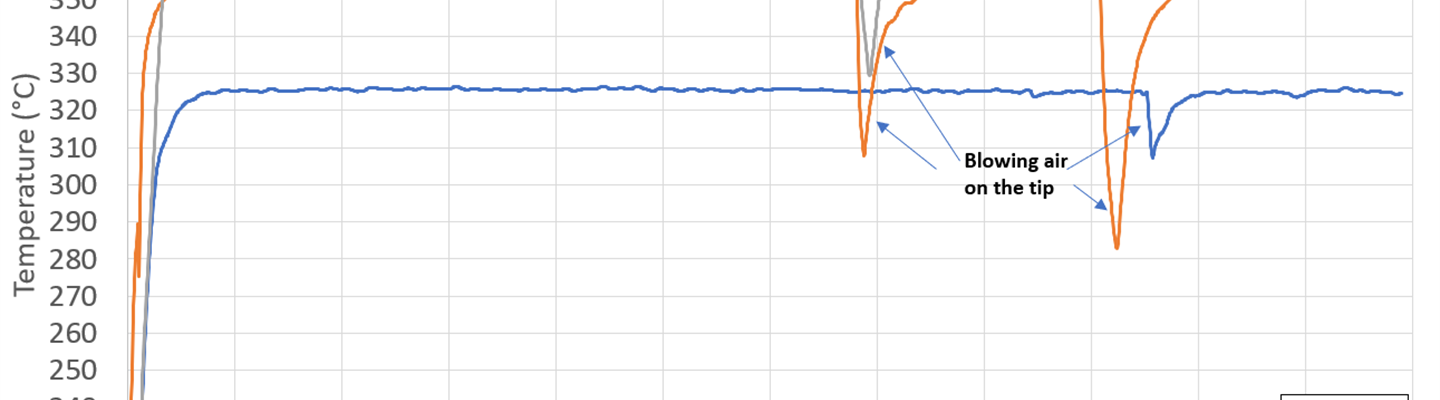

As a result, I decided to borrow the thermocross on the WCU and connect that to the DAS240BAT as the sensor. This allows me to get much better time resolution of temperature. I opted to test an RTMS 002 C MS and RTUS 016 C MS tip to demonstrate the capabilities of the WXMPS MS and WXUPS MS handpieces.
The sleep temperature was set to 180°C, however, measured at 200°C for the WXMPS MS + RTMS 002 C MS combination post-calibration. Nevertheless, I shook the sensor to bring it up to temperature at 320°C, 350°C and 380°C. The temperatures achieved are fairly close to the requested temperature (within 6°C) and showed no measurable overshoot. Blowing on the tip to perturb the system did not provoke any overshoot and the temperature returned closely to the set-point.
Zooming into the initial warm-up, it is clear that the warm-up time depends slightly on temperature selection (and perhaps also residual heat in the tip). Regardless, the curves suggest that the tip reaches temperature within five to six seconds normally.

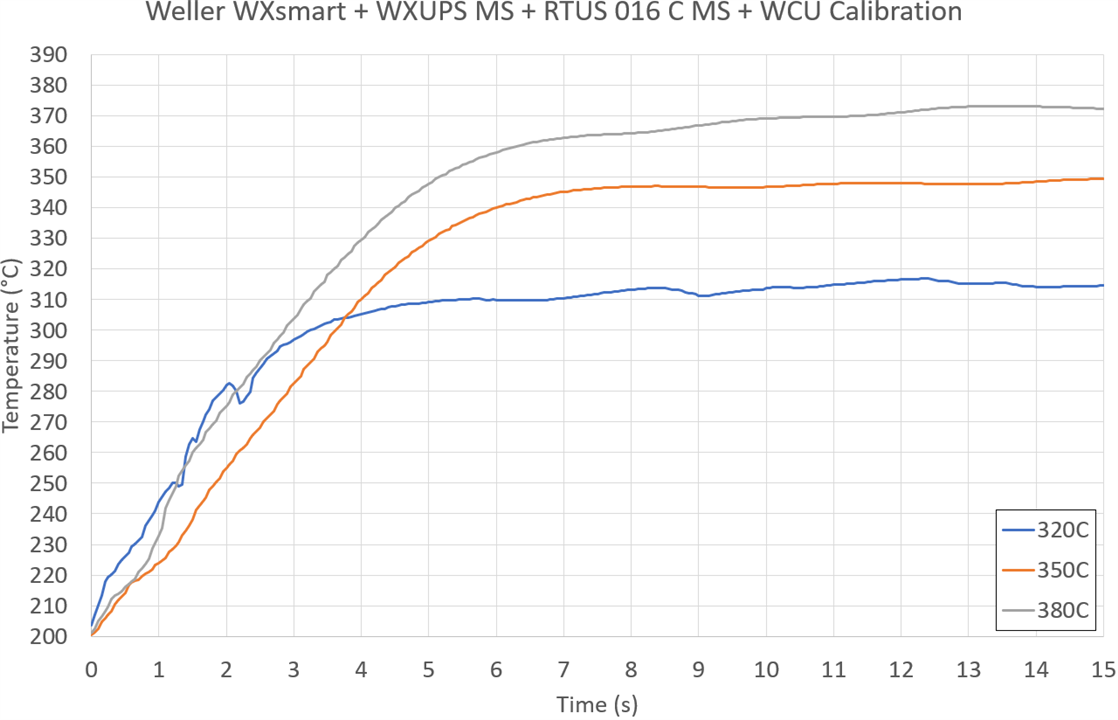

Repeating the same with the WXUPS MS + RTUS 016 C MS combination post-calibration showed temperatures which were slightly below the set-point by up to 10°C and may have been due to the specific calibration. Nevertheless, this figure is close to the ±9°C specification.

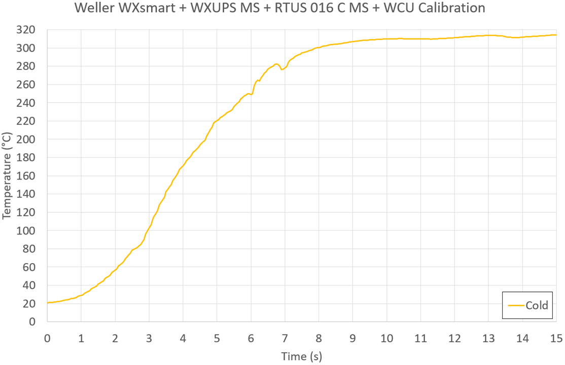

As a larger iron with bigger thermal mass in the tip, it takes a little longer to reach temperature, but this is still a very speedy six to ten seconds.
A start-up from cold to 320°C takes about ten seconds, or about four seconds faster than from the standby temperature of 180°C, making this a very speedy iron indeed!

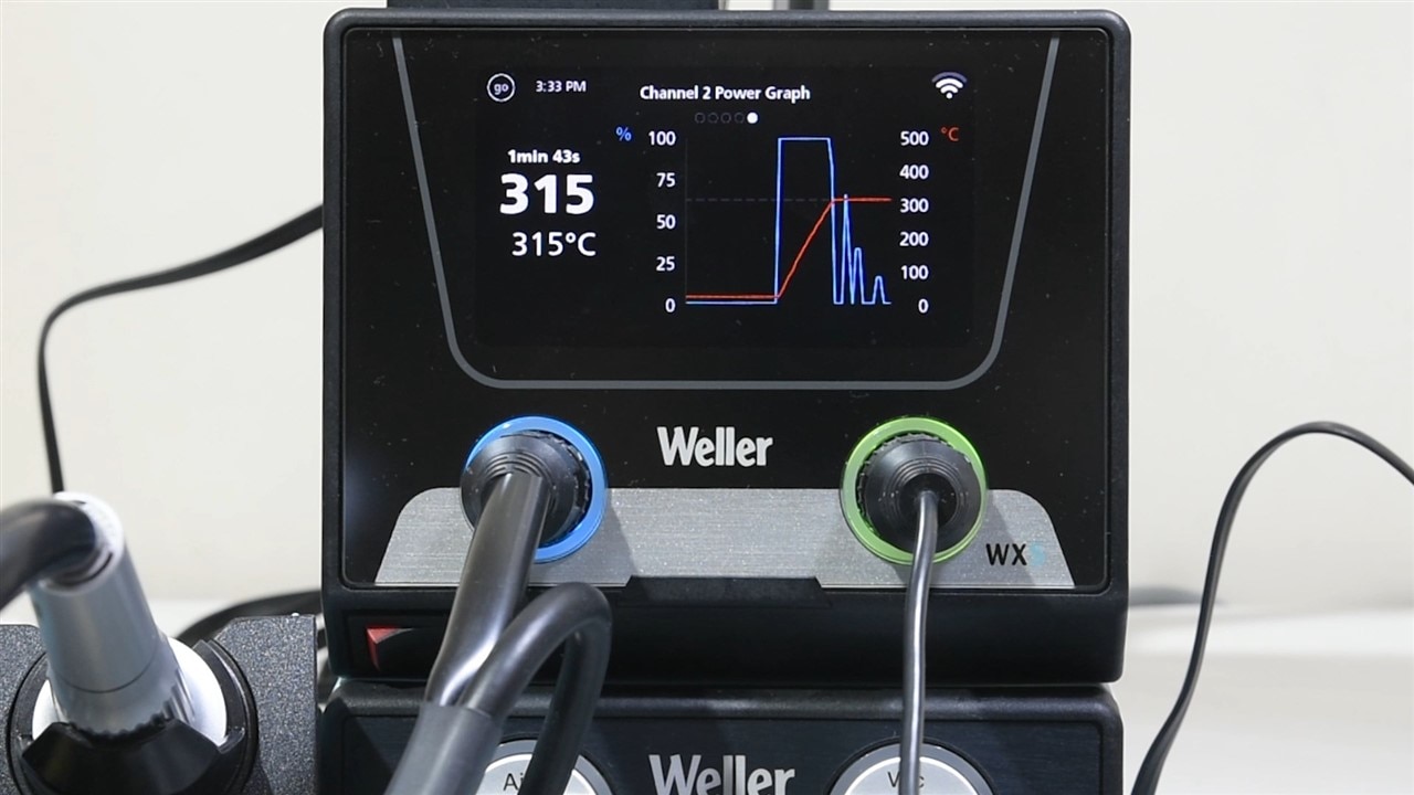

    Gough Lui over 3 years ago in reply to dougw
    That is an excellent question - from the video summary, I did show the on-station power and temperature curve for a WXUPS on a 9-ish second heat-up run to 315c:
    It seems that the PID control is very tight on this, it whacks full power in until it is very close to the set temperature and backs off quite quickly.
    I know some readers may not be so fond of a station's own reported statistics and would prefer a "third-party opinion". Unfortunately, the Tektronix PA1000 Power Analyser that samples the mains only does so at about 2Hz so it won't provide much useful data. Perhaps if I find the time, I will intercept the "smart-tip" interface which seems based around 3.5mm TRS plugs and do some measurements that way assuming I can identify the power connections.
    - Gough
