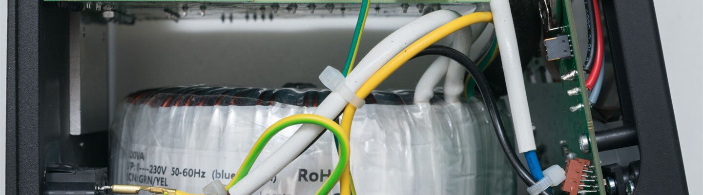

Removing a few screws allowed the top cover to come right off, revealing the insides.
The thing we are greeted with is a rather large PCB, but with very few components. The AC from the toroidal transformer enters in on the mid-left and goes out to the front-PCB on the bottom left. The input is fused and surge-protected. The Ethernet jack is on the board in the top right, but it seems to be wired through to the ribbon cable that links this board to the front-PCB.
The top-left corner of the PCB is dedicated to serial communications, which appear to be transformer isolated and optically switched in some way.
The middle-top portion of the board is where the “heat” is generated and conveyed to the heatsink. A row of four STMicroelectronics STPS20H100CFP 2x10A 100V Schottky rectifiers seemingly from two or more different batches (D5 is noticeably different in coding, D6 has a different moulding mark) may be providing rectification of AC to DC.
No, you’re not imagining things – there is an Espressif Systems ESP32-WROOM-32D in here. I’ve built a few things using this particular module, so it’s a familiar sight to me and it’s here providing the Wi-Fi connectivity with its onboard antenna.
There are electrolytic capacitors on the board and while they are Nichicon products, they opted for the VK-series which is 85°C rated which is perhaps not as premium as the 105°C capacitors that are relatively commonplace nowadays. Then again, as they are smoothing mains-frequency ripple, perhaps this is not as demanding as switch-mode applications.
A view from the side shows how the top PCB seems to be supported primarily by the heatsink attachment to the insulated TO-220 packages. This arrangement may be prone to sensitivity to vibration and shock in transit – it would be nice to see more support. The bottom-half of the unit appears to be dominated by the toroidal transformer.
A view from the other shows how some of it is wired together. It is a tight fit inside for the front-PCB and that brown programming header sticks out precariously at an angle to the board.
As expected, the transformer is appropriately rated at 300VA, this being 230V rated. The 120V version of the WXsmart is likely to have a different toroid.
