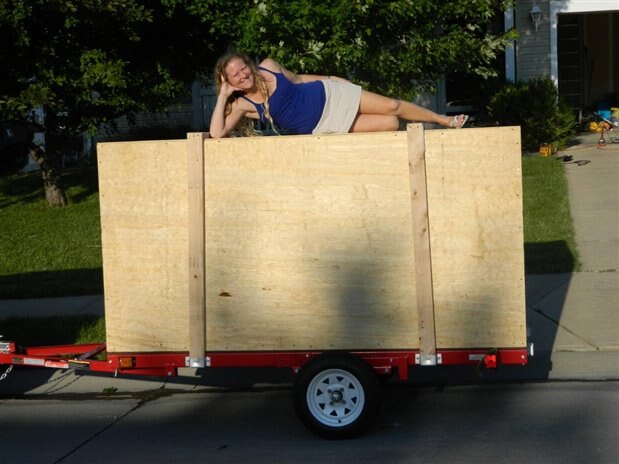

This is an early picture of my trailer, before I straightened out the side beams.  The trailer has advanced quite a bit this stage an in my next post I will show better pictures.
