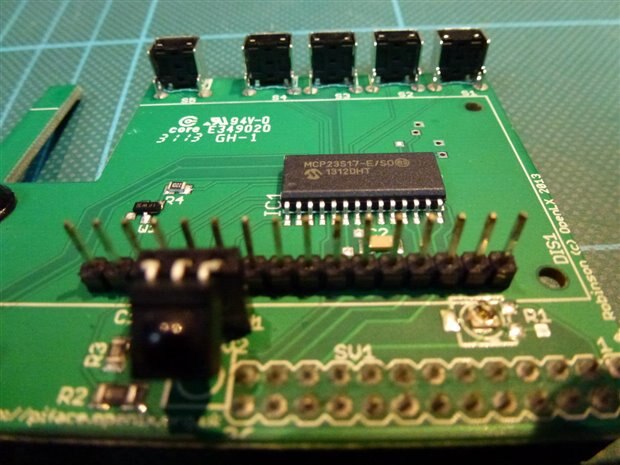

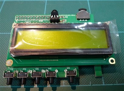

Currently involved  with the rather fun PiNoir & Santa Catcher Challenge one
of the main Components for the Challenge Kit is the PIFace Control & Display

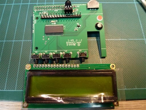

We wanted to know what's inside and what's connected to what but unfortunately
the 16x2 LCD is soldered to the main PCB. Fortunately I have a good de-solder tool to hand
and a few minutes latter we had this.
First thing you see is the 16 bit SPI port expander from Microchip MCP23S17

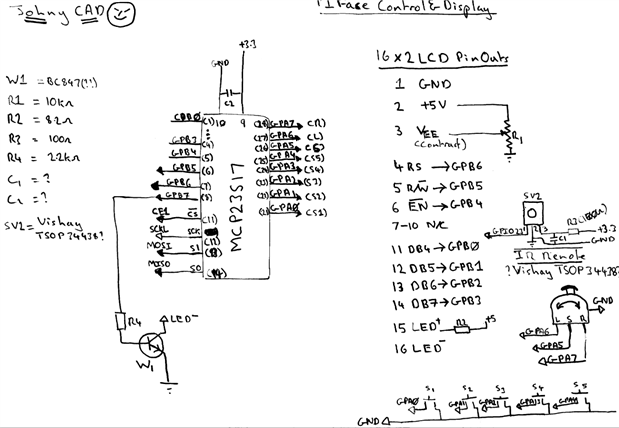

From a set of very close photos I'm taking an educated guess the IR Receiver (SV2)  is a Vishay TSOP 34438.
Take a look at the data sheet and the drawing below to get an idea of how it's connected..
I've done a check over with the multimeter and checked the continuity and values where appropriate and I feel they are
more or less right .. please contact us with any comments or corrections ..cheers
Here's the Johnny CAD drawing image and yes I know I can't draw !!

    Problemchild over 12 years ago in reply to smile123
    Nice Mod there Adriaan, that interface is indeed a defacto standard and 40x4 is about the largest one that supports that interface. Inside of course the 16x2 has a 40 byte per line memory so you have the same logical interface as well!

    smile123 over 12 years ago
    Inspired by Problemchild and this topic I disassambled my Piface Control and Display too. I wanted to know if it would be possible to change the LCD. I soldered connector pins on some other LCD's and created a cable with connectors. So my LCD is connected with a cable to the base PCB of the Piface.
    Now I have a 40x4 LCD running. (Therefore I needed to modify lcd.py as well.)
