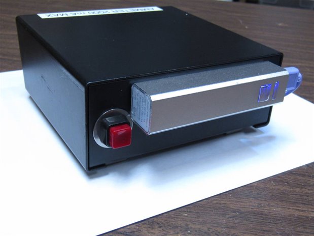

I hooked the raw finished meter up and ran some trial tests to compare it against my other moderately accurate test equipment. It worked very well displaying one more decimal place than I had on the Fluke 177 and it seemed to be consistent over the 0 to 2000 mA range. Many of my little experiments utilize a mA meter and I suddenly had a memory flash from the past of the meters we used to use in High School Physics Class when we played with electricity.
Why not make a modernized bench digital Ammeter in the same spirit as this moldy oldie? I looked through the selection of salvage cases from various dental equipment and found one that used to be part of a monitor for a Sterilizer. It was perfect except that it was constructed of 1.5 mm thick steel. An hour and a half later with lots of drilling, sawing and filing I had finally cut the 4 X 7 cm hole needed for the meter. The holes for the binding post were easy and I had the meter mounted and soldered to the binding posts.
My next decision was how was I going to power the meter. There was lots of room inside the case. I think they call meters like this lunch boxes for all the extra room. While it would have been very easy to put a small AC to 5 volt DC power supply into it I decided that I didn't want to add the need for another power wire to my experimental setups. Since the unit runs on 5 volts my attention was pulled to a small cell phone auxiliary charging battery that I had on the bench charging my cell phone.
I checked the mA hour rating on the battery and it said 2200 mA hours. My guess is that this is a gross exaggeration but even if it is half that amount in reality it should power the 35 mA draw of the meter for 30 hours which is more than adequate for my convenience. Further more all I have to do to recharge the batter is plug it into a telephone re-charger. Here are a few pictures to show you the final product.
Here are a couple pictures of the inside.
Finally we have the meter monitoring a current through a power resistor:
Not counting my time (hint: not worth much at this stage of life) the meter cost $12.00 including the battery. I had a good time putting it together and I anticipate the pleasure of using it in my next experimental setup requiring the monitoring of a current.
