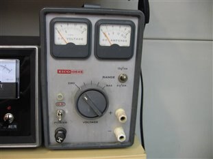

     Sometime in the mid 1960s I bought an EICO 1064 Battery Eliminator Power Supply Kit. This kit was a very basic power supply and was rugged enough to charge car batteries if necessary. It was built around a variac which output 0 to 20 volts AC. The output of the variac was rectified, filtered and fed unregulated to the output terminals. A switch was available to cut the voltage in half and double the current. In those days we still had a fair number of cars with 6 volt electrical systems. At the time I was servicing a lot of audio electronics and as a result there were many car radios and stereos coming across my bench. I even had the opportunity to service some car radios that had tubes and mechanical inverters. The EICO served the purpose of a bench power supply for this type of equipment very well. Almost nothing was very voltage sensitive  so I would hook up the equipment and crank up the variac until the meter said 12 volts and proceed to track down the problem in the circuitry.
     Fast forward 45 years or so and while the EICO still has some good uses it falls short of a cheap modern bench supply. For example if I dial up 12 volts on the EICO and put a 3 amp load on its back it promptly drops to 8 volts. Of course I can turn up the variac to compensate for this but why should I.
