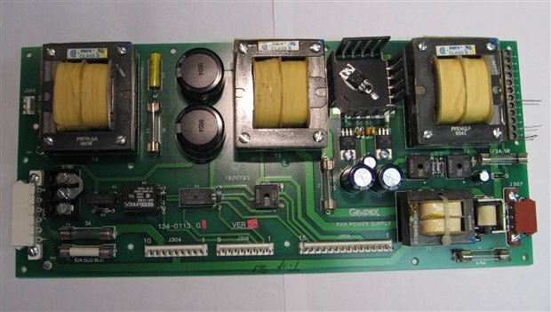

A few days ago I mentioned I received a box of scrap circuit boards. I have chosen one that came from a Gendex Panoramic X-ray Machine. This x-ray machine which was still perfectly functional was thrown out before its time, due to obsolescence. Technology is racing ahead so fast that equipment does not have time to get old and wear out before it is obsoleted by new technology and new regulations. In this case the Gendex X-Ray Machine was designed to work with film and presently the new technology machines produce better pictures with much less radiation by using a digital sensor and computer processing. This board is only one component board of the power supply for the x-ray.
The first challenge is to figure out the circuit well enough to power up the board. I begin with the individual components. The section on the right had 2 power transformers, a relay, 2 bridge rectifiers, a couple fuses, some capacitors, and 3 linear voltage regulators. This was obviously a linear power supply and from the compliment of regulators it should have plus and minus 12 volts as well as 5 volt output.
In the middle of the board there was another transformer, bridge rectifier, and 2 large caps. Primary and secondary voltages were printed on all the transformers which is very nice and not that usual. Based on this I suspected that there was a source of 30 plus volts available from this middle section of the board.
The far left of the board had still another transformer but the secondary of this one left the board on one of the headers and was apparently intended to power a different circuit board.
After tracing the input power circuit that would feed the primaries of the transformers I discovered that the board was equipped with a low voltage (12 volt) circuit that would turn on mains power to primaries of the transformers. The source of this 12 volts is the smaller transformer which is designed to have power to its primary continuously so that the machine can be turned on and off.
I was now ready to power the board and continue the process to decide if any part should be repurposed or if I should just disassemble it for parts.
Powering a board like this can be very dangerous as the voltages involved can easily kill a person who does not follow good safety practices. I like to use an isolation transformer so that the voltage while still potentially lethal does not have a circuit to ground. I am careful and respectful of the danger. It is always a good idea to get help from an experienced person if you haven't been trained to work with mains voltages.
The board when powered up had plus and minus 12 volt supplies, a five volt supply , and a 35 volt unregulated supply. I had an application for the 12 volt and 5 volt outputs but not the 35 volt one. Most of the components on the left end of the board proved to be associated with other boards and were not needed. I decided to remove the un-needed parts and modify the right third of the board to accommodate my need for a +/- 12 Volt , 5 Volt supply.

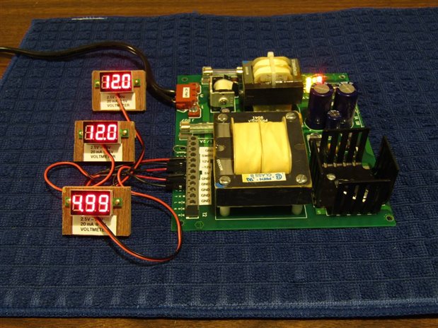

Now all that was left was to hook it up and test it. My little breadboard meters will not read negative voltage but if I hook them up with revers polarity I can trick them. In this next picture the middle 12 volt reading is really a negative 12 volts with respect to the ground. Sorry the camera does such a poor job with the LEDs They are really quite clear to the eyes.
As part of the test process I also hooked up the outputs to an electronic load. The main 12 volt regulator has a small heat sink and seemed to be fine with delivering 1.5 amps continuously. The negative 12 volt and 5 volt regulators however were just attached to the board and it was apparent that 1 amp draw from them could not be sustained for more than a few seconds. They did however perform and stabilize with a draw of 500 mA. This could probably be doubled if small heat sinks were to be added. Fortunately the application that I have in mind for this power supply, a signal generator kit, will be more than happy with the present current capabilities. Here is the finished board complete with labels:

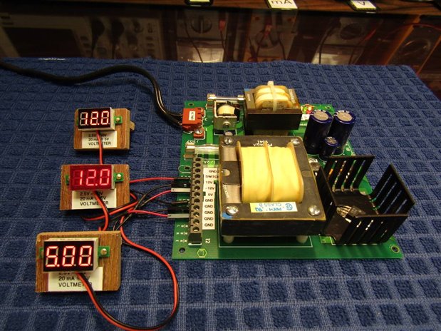

    A separate blog post has me playing with the camera and trying to improve my pictures. I was particularly unhappy with my picture in this post where the Displays of the little voltmeters were hard to read. I have determined that I will need better control of my lighting as the camera doesn't quite have the capability to cover the full range of conditions with my present fixed intensity lights. Here is a replacement picture taken at an exposure of 1 second.image
    Jan Cumps over 10 years ago in reply to jw0752
    For the display readability, you have to put a red filter in front of the displays.
    A transparant sheet of red plastic helps. Even white tracing paper improves the readability.
    mcb1 over 10 years ago in reply to Jan Cumps
    The filter improves the contrast which may help but because these type of display tend to be multiplexed, they are only on for a portion of the time.
    While the human eye will fill in the gaps, the camera won't, so a longer exposure helps.
    In john's previous image there was appropriate light for the rest of the image, but the displays became unexposed.
    Again the human eye has a huge exposure (and depth of field) range while cameras (film and digital) don't.
    I've resorted to double exposure (either in camera or with software) to overcome this problem before.
    A simple method is to use the tripod and take two images, one with lighting and one that shows the display.
    GIMP does a great job of overlaying the two and bringing the image showing the display through using a mask.
    If you think LED displays are hard, try a backlight LCD. image

    You nailed the solution for this application. I started to look for some red filter material that I could experiment with and then I remembered that the Automotive Supply stores sell a red tape for temporary repair of tail lights. I bought a small roll for $2.63.
    I started by placing filter material on only the center display:
    I would rate your idea as an unqualified success. Compared to the upper and lower displays the center is very readable. I next proceeded to put filter material on the other two displays.
    I love simple elegant solutions. Now all I have to do is spend the time to put filters on my dozen or so displays.
